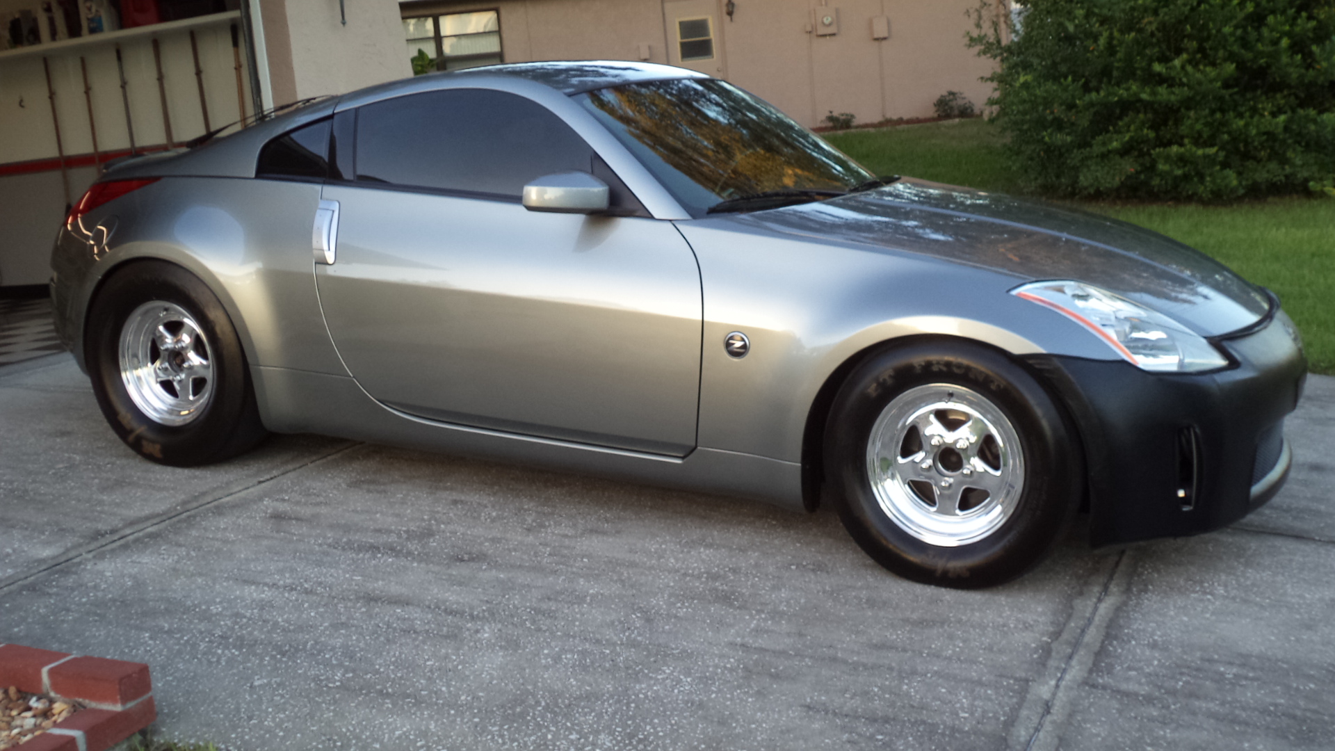

I don't know if the HR brake are different from a standard 03 350z, but I used weld Prostars 15" x 4" with 1.75" BC and a 1/4" spacer with 1/4" longer Lug nuts. And for tires I used MT ET Front 27.5/4.5-15, Hope this helps...
