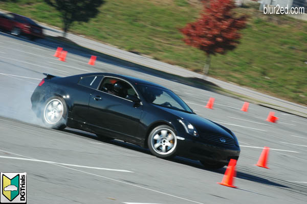

Here are a some pics from this past weekend...

thanks chops! pix are so clear I can smell the smoke. do you know what size rears that #2 coupe is running on?
He is running on 350z Track rims, not real sure what the tire size is, but I would imagine it's the stock tire size for the Z. The tires were Bridgestones, thats about all I know.
Old Dec 11, 2004 | 12:48 PM
OvaYahead's Avatar
OvaYahead
Posts: 142
From: CA
thanks chops, but I meant the G with the "2" on the rear passenger window. Those don't look like 350z rims to me.
Old Dec 11, 2004 | 02:58 PM
chops's Avatar
chops
Posts: 117
From: Atlanta
Ok, I know all about that car, because that's me!
19" BBS RG-R's with black diamond finish
front 8.5" rim with 245/35/19's +16mm offset
rear 9.5" rim with 275/35/19's +23mm offset
tires - Bridgestone Potenza SO3's
The tires were almost to the end of their tread life, so thats why I decided to give the drift thing a try. I definately could have used a cheaper/harder tire.
I should have put my stockers back on, oh well live and learn.

as long as we're posting pics of me here's another one.
I let Tony Shultz drive my car and he said he liked it, it was very predictable.
nismo sways and tein s.tech(350z). I think the stiffer rate of the 350z springs is actually fighting me when I'm trying to drift. They seem to have dialed in more push than I'd like. I guess when I get some coilovers, I'll need to get softer springs for the back.
