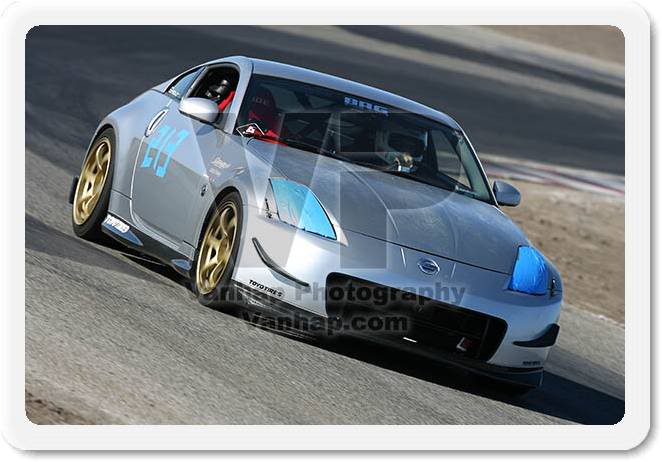

waddup waddup thats my car in those pics when it was still chrome silver yeah the latches are made from Sparco... theyre like $35 or $40 but work wonders for the track... just make sure that you put a hose or something between the spring and the fender because i already scratched my new paint job
