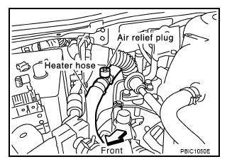

Old Apr 1, 2005 | 03:20 AM
westpak's Avatar
westpak
SFZCC
Posts: 7,420
From: Lake Worth, FL
Burp the system, just turn the plug and let air out until bubbles stop.
