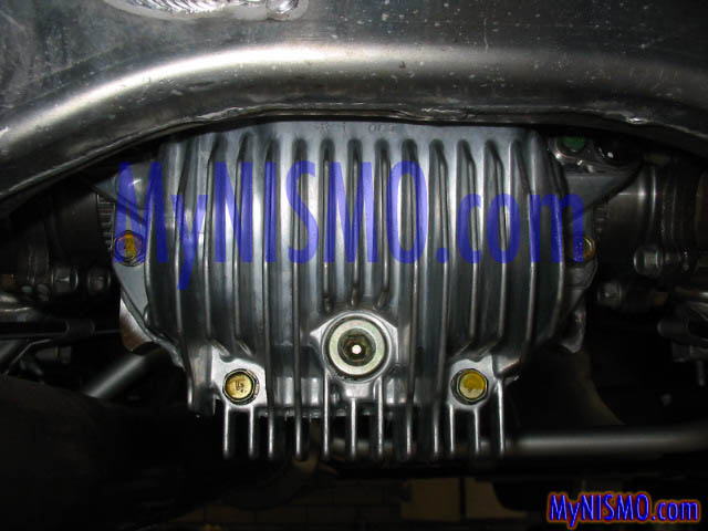

2) Nismo Rear Diff Cooler - $111 shipped from Performance Nissan - looks great, has had good reviews, and comes with all new hardware, which was a plus... I definitely recommend this if you are doing this swap or any kind of aftermarket LSD/FD swap...

So all in all, I have under $700 invested in this and I got both an upgraded final drive AND an LSD at the same time - not bad if you ask me! And let me tell you, the first time you get on it, you will instantly feel the difference - it doesn't feel like I'm driving the same car! it is MUCH quicker off the line and in just about every driving situation and the LSD, though not wonderful, is a great improvement in traction in just about every situation - I've seen people that have ran before/after at the track and saw over a 0.5 sec reduction in 1/4 mile times - and I don't argue with it at all - not only does the car come off the line quicker, the revs also stay higher between shifts, almost making it seem like the shifts are performing faster than before... regardless, this is DEFINATELY a worthwhile mod that anyone with a 5AT G35 or 350Z that doesn't have the VLSD should really consider... if you have any other questions, just let me know! I'll try to post pics of what the diff cooler looks like under my car later on today or this weekend (below is a picture from Performance Nissan's website)
