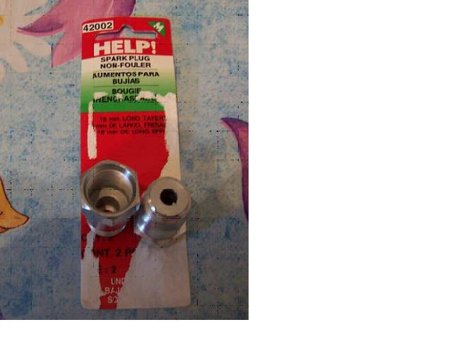

found the help method on another forum. This work and you don't have to splice any wires...cheap too...only $5 for each pack and you need to packs.
http://www.msprotege.com/forum/showthread.php?t=66426

yeah I meant the non foulers
you don't actually use them as they were originally intended with spark plugs
the alternative involves soldering some wires - note the nissan engineer said the same thing. This method can be undone easily and doesn't require soldering.
ONLY DO THIS IF YOU EITHER HAVE TEST PIPES OR TONS MORE AIR FLOW THAN STOCK - TO THE POINT WHERE YOUR CAR TRIPS SES OR CEL LIGHTS
otherwise who knows how the car will react. It might start running really rich - which could be good or bad depending on where you live and what gas you run. It's up to you at your own risk to try it
here's a compilation of all sorts of quotes I've saved about them from users from all sorts of websites.
they are called spark plug anti-foulers. i have them on my msp w/ corksport exhaust. use the 18mm ones and just drill out the bottom of one of them with a 1/2" drill bit (do not cut it off) and screw them into each other. it creates a chamber outside the main exhaust fow for the o2 to get a proper reading. suby guys have been doing this for a while with no cel/mil.
The heat will make the O2 active, but since it's out of the more laminar flow, that means less poloutants get to the O2 sensor, and thusly, it thinks the air is catalyzed.
i just went and got the HELP! Spark plug non fouler. Part 42002 for 3.99 from autozone.
Its a 2 pack, that you screw together, and then screw the open end into the o2, and the other into the bung.
This does require that you drill out the hole to allow for more flow to the o2, but thats pretty easy.
We datalogged the effects and it keeps it at the voltage where it thinks theres a cat there.
Never thrown a cel with this fix, proving once again it works

it's a proven method to make the ECU think the pollution/emissions are within spec because it won't throw a code and thus reducing power
however, if the MAF is saturated or beyond it's intended range, the ECU won't know to add even more fuel. It can only add so much fuel. It won't add more fuel than it was programmed to add.
does anyone know if you can run the APEXI and Emanage at the same time?
the APEXI alters the MAF voltage, the emanage adjusts the injectors
It might be that you need to be able to do both to REALLY control the ECU... or get a standalone EMS
