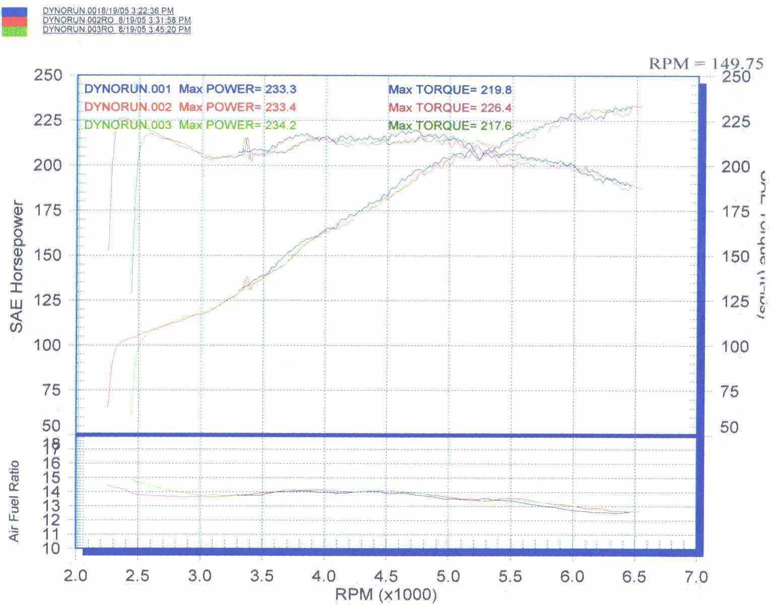

Here is a list of my performance mods and attached is a dyno on a very hot day here in houston (102F!)........can you guys comment please? Would you recommend a reflash to improve the a/f ratio?
2004 G35 Coupe AT
K&N Filter
ZTube
3/8 MD Plenum
10-Wire GroundKit
UR Crank Pulley
DC Headers (Ceramic Coated)
Crawford CATS
Injen Exhaust
Attached Thumbnails ECU relash: TS says 350zs run rich, AAM says lean! which is it-dynojet-8.19.2005-04.jpg

i'm not an expert, but it looks pretty good to me, leaner early, then mid 12 up top. they might be able to do something with your timing, tho.

Powerband looks good, as does AFR. In fact, the only places I see where it slightly dips down are between 2.0-3.5 and 5.0-5.5 (where the powerband and AFR dip down). That could use some slight leaning out, if you are really striving to improve it.

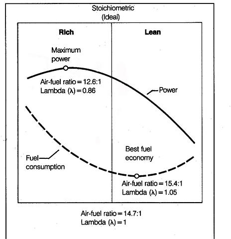

i found this graph helpful.
