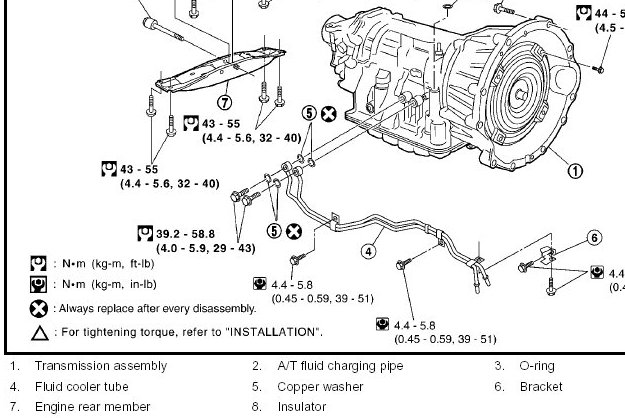

Hope this helps
Old Jan 28, 2003 | 11:45 PM
menehune's Avatar
menehune
Posts: 136
From: hawaii
Most likely trans cooler is integral of the radiator.
