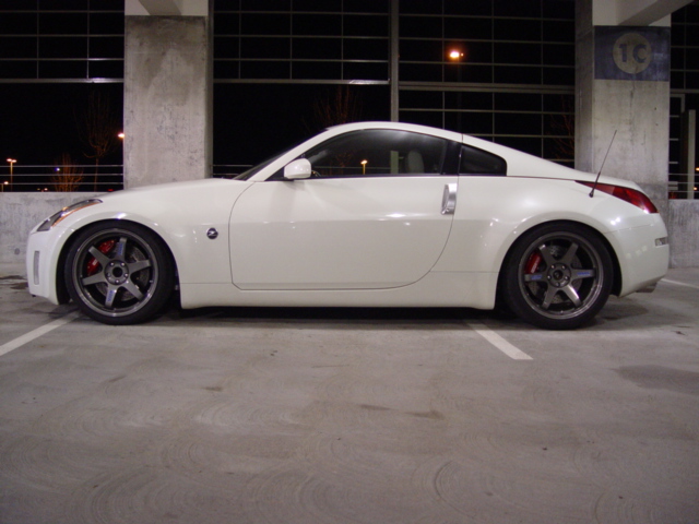

jran76,
stoptech does not do both cross-drilled and slotted.
you either get cross-drilled, or you get slotted.
how do i know, well i talked to bob and matt from stoptech personally.
i don't track much, so i got the cross-drilled.
wish they did both though.
john350z

Old Feb 26, 2003 | 07:27 PM
jran76's Avatar
jran76
Posts: 671
From: Plano (Dallas), TX
Ooops, sorry for the bad info, thanks for the correction.
Nice ride by the way.....
