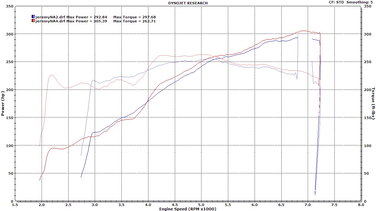

Can you post an overlay of the pre/post TS headers? I would like to see what it did to the system response.

yes i will overlay the pre post headers, some of it might have come more from the turbulance side of things more than the flow due to the headers.
with the ported heads, the stock headers really didnt match up well where the TS headers had a larger opening. also figuring out that the car made the most power at 11.8 to 12.1 to 1 helped out a bit
i really dont know if i would give the headers much credit. i think that there are still some weird issues going on with possibly cam timing causing some very consistent dips in places that i can get out.
let me do some overlays for ya.
thanks again tony, i havent received those headers yet but i had a loaner TS set to borrow.
also, "1cockyZ" if you send me your paypal address, i will send you some money for the shipping, i would like to try that throttle body out but i am sure i will need to match the plenum neck and the piping there for it to work at all.
thanks everyone, let me get some graphs.

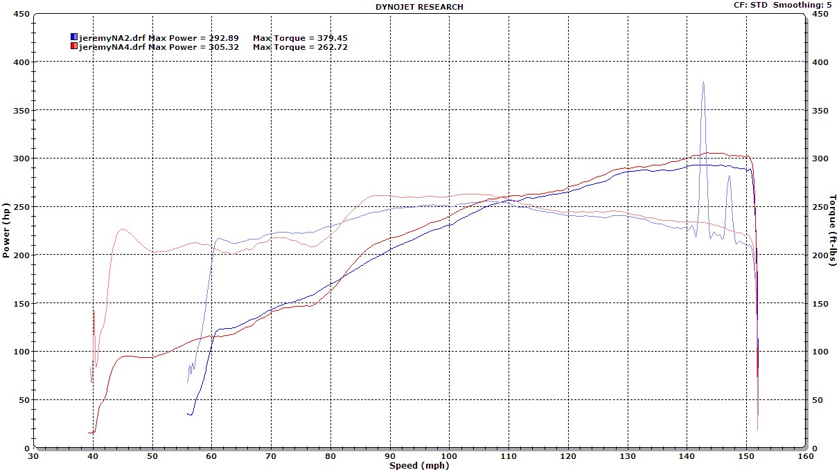

here are two graphs with overlayed on my best before headers and after headers. you can see some weird stuff happening under 4000 that can not be tuned out. its just weird with the headers, some kind of turbulence happening.
i have the speed and the rpms based dynosheets here. there is a blip at high rpms so thats why the tq jumps so high on the graphs.
but you can get the idea.
Attached Thumbnails 305 hp NA !!-jeremy-overlayed-headers.jpg   305 hp NA !!-jeremy-overlayed-headers-rpm.jpg

I suspect the wavyness of the graph is proably normal for these headers.
I saw the same thing when I tested them but in my case it was even worse (probably because stock cats were connected to them).
But overall it was clearly helpfull in your case.

Jeremy, are you running open headers? If so, that could cause issues with shorty headers because the collector is so close to the ports.

yeah, the shorty headers will be gone soon, long tube with a nice collector up next.
the car went 12.3 at 111 with the 292 hp. i am just running open test pipes right now, i am going to put a y pipe on for some backpressure and see what that does next time i have it on the dyno.
