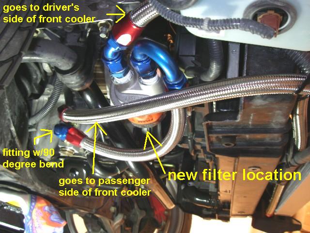

After all the main pieces were mounted I started the tedious task of cutting the braided lines. I did like Rickdogg said, using 1 layer of duct tape on the area I planned to cut. This keeps the braids from fraying. It also serves as a good smooth surface when your trying to get the fittings over the hose.
*note: Make sure to use WD-40 on the hose and fittings. It'll make it easy to slide the hoses into the fittings.
Also, don't worry about running out of hose. It seems like it won't be enough, but I actuall had about 10inches left over after everything was done.
BTW, if I hadn't printed out Rickdogg's picks from his install I would have had a hard time figuring out the orientation of the hoses and where they route to. The ARC instruction manual is a piece of worthless $hit! The diagram the provide is very misleading. I've listed the routing sequence in one of the following pics incase someone ever needs it.

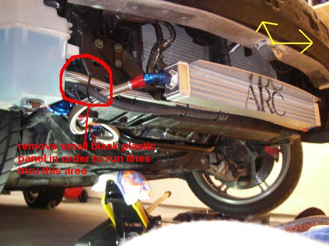

Last pic after everything was completed.. The red circle is the area where there was a small black plastic panel. This has to be remove.
I have a couple of questions if anyone can answer them. What do most people do with the black styrofoam(sp?) piece mounted to the aluminum bar? (It's indicated with yellow arrows.) I'd like to just trash this piece if I don't really need it.
Last question. Can anyone tell me what part# of oil filter I need to buy now to fit the ARC adapter? My old filter's diameter is too small now.
What do you mean? Most people I know keep it if at all possible. I ran without mine for a year but decided to throw it back in to support my front bumper. I don't think it hurts to go without it, but it doesn't hurt to leave it in there.
Basically, most I know keep it unless they have to dump the bumper brace for a greddy intercooler or something.
I ended up keeping it to brace the front bumper if a low speed collision occurrs.
