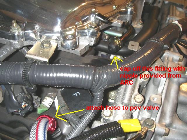

So for the catch can, the two ports for the valve cover (driver side and passenger side) get attached to the INLET port of the catch can and then the intake tube is attached to the single OUTLET port of the catch can?
No, only the port from the PCV valve gets attach to the 1st inlet of the catch can. The 2nd inlet port of the catch can is fed from the port located under the throttle body. The exit port of the catch can feeds to the intake pipe.
My TurboXS catch can has only two ports. I wonder if I can tee the PCV valve port and throttle body port into the inlet and connect the outlet port to the intake pipe.
Anybody try this?
Anybody try this?
what do you currently have ported to the inlet of your can?
I haven't installed it yet but I was going to have just the PCV port connected to the inlet valve.
that's what I would go with if you only have one inlet...

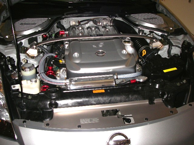

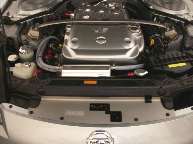

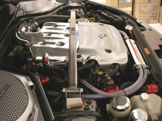

Default Strut Bar Installed....
Last night's install was a nice change of pace compared to the other installs. I wish I would have kept the instruction manual so I could take a picture of the instructions for you guys. Mind you, the manual was about 4 or 5 pages long and the last page is where the instructions were at. They went something like this:
1. Uninstall factory strut bar for front.
2. Install strut bar.
I was able to shoot a few photos this morning. Jason from Prestige Motorsports will have the body kit painted by tonight and ready for pick-up. I'm going to install the kit tonight after work. I'll post a few teaser pics after I'm done. Next week I'll try to get a professional photo shoot in with Chris Reeno if weather permits, then post some nicer pics for you guys..
