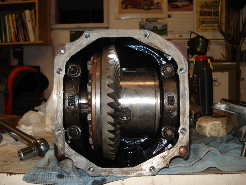

That is not a Nismo lsd. That is the stock vlsd. This is what the Nismo lsd looks like.
Nismo lsd
stock vlsd

Time for an ebay dispute.
Oh yeah, it should fit up w/ no problems.
