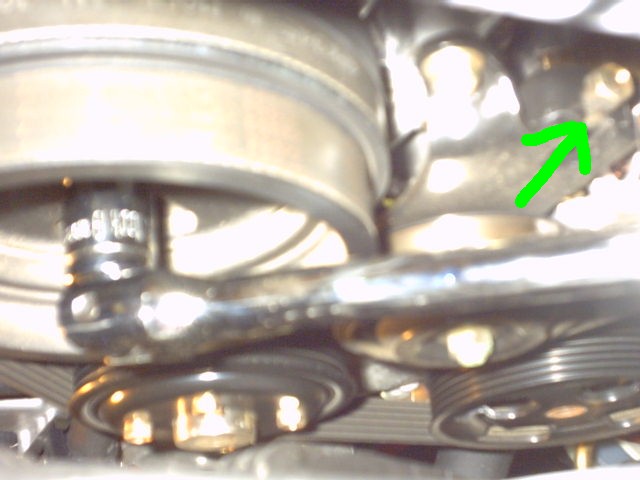

Here's some pics of my UR crank pulley install. Took about 30 minutes and was very simple. Here's the tools i used:
10mm socket (to remove the underbody)
19mm 1/2 6pt socket (for the crank pulley bolt)
14mm socket (for the tensioner bolt)
12mm socket (for the tensioner adjustment bolt)
18'' 1/2 breaker bar
1/2 torque wrench
anti-seize
two jack stands
I used the belt sizes recommended by UR in their instructions and they worked great. Your local auto parts store will have them in various brands.
Place the car in 6th gear. After you put the car on jack stands, take the underbody off and when you look up into the engine compartment this is what you'll see. Get a buddy, girlfriend, wife or whatever to sit in the car and press the break HARD!!!. It's gonna take a lot of force to get this bolt off but it will come off with the breaker bar. So, with the breaker bar and 19mm socket on the bolt at the red arrow pull hard! The engine will turn but the bolt will come off (it may take a few readjustments of your breaker bar).
Next, loosen the 14mm bolts signified by the blue arrows (sorry, my camera couldn't get all three in one photo but you get the point). These wont be nearly as tough as the crank bolt.
Attached Thumbnails UR pulley install instructions with pics!-crankntens2.jpg

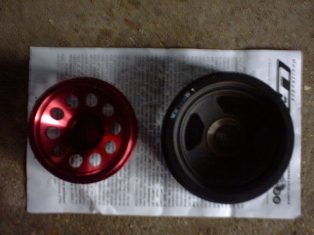

Here's the difference in size. I didn't weigh them as i don't have accurate scales. But i can tell you that stock crank pulley is HEAVY. The new one is significantly lighter. I'll weigh the stock one as soon as i can find some suitable scales.
Attached Thumbnails UR pulley install instructions with pics!-side-by-side.jpg

Another of the size difference.

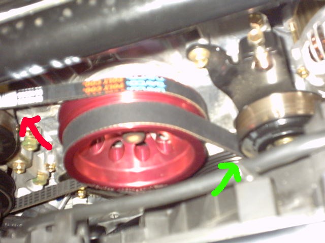

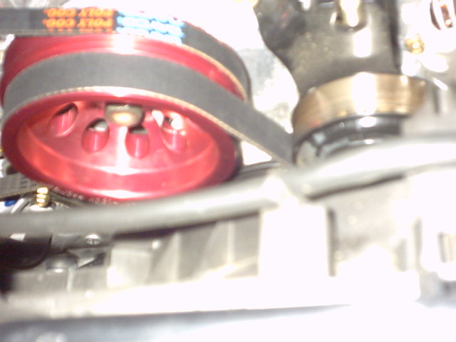

The new pulley on the car. It's hard to get a good photo because of the tight space but here ya go.

The new pulley on the car. Both belts go over the tensioner (like the one at the green arrow) not under them (red arrow). Just thought i'd throw that in for clarification! Enjoy your new pulley!!!
Attached Thumbnails UR pulley install instructions with pics!-pulley-on-car.jpg
