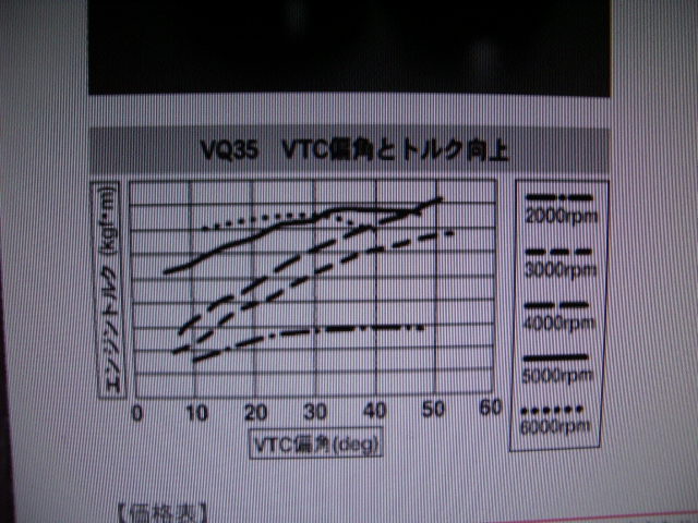

40,s all your going to get & that 35 confirms what I what I was saying.
Check this graph.
It shows a huge increase in Tq from 40 to 50deg advance in the 3K & 4K scale no increase @ 5K and at 6k it looks like 25 is the best but not critical.
Based on this graph which I think are the Spec2 cams, a good place to start @ 6.5k would be 20 & reducing it a little as the revs climb
