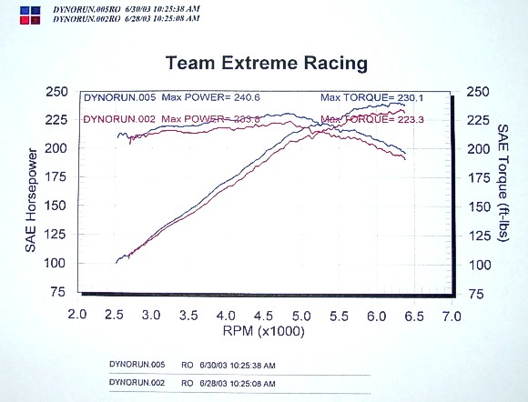

Okie dokie... Good news is we gained rwhp and torque; bad news is that it's not quite as much as I had hoped it would be (I was hoping for 10 rwhp). For the max numbers, we gained 6.8 rwhp and 6.8 torque (the torque gain is very nice). The torque increase is relatively even from 3,500 rpm through 6,400 which I really like -- love torque! We've also got a nice steady rwhp gain from about 4,000 rpm through 6,400. Overall, it's a nice gain because it's pretty even in my normal driving rpm range.
For the techno folks, the runs were 48 hours and 30 seconds apart. They were done on the same Dynojet 224, the same operator, the same time of day, and on the same tank of gas. As many variables as possible were reduced in order to have the same conditions. For comparison purposes, the charts are SAE corrected. A little over 200 miles were put on the car after the exhaust installation, with over a dozen triple digit runs in 5th gear (the gear for the dyno runs). A lot of heavy accelerations to redline were also done. Mileage was 3,775 for the baseline and 3,990 for the Borla run. The car has a completely stock air intake. These runs were done at the 1:1 gear ratio -- 5th gear as opposed to McDuck's 4th gear runs. The installation was DIY, and there are no exhaust leaks.
Nice. That data is consistant with Importriders dyno.

Oh yeah... I forgot to add that the ECU "detune" is another "urban legend". If you take a second to think about a Z running around on top of Pike's Peak and another running around the Everglades, you'll know why it's an urban legend. Anyway, my dyno numbers prove that it's a myth as well.

Thanks for they dyno! even though the power is not as much as Borla claimed, but not too bad.. Guess our stock exhaust is pretty well designed already....

Based on your description, it doesn't look like you reset your ECU... could that be the big difference? Also, ultimately, it looks like Tere's and my final numbers where about the same... maybe somebody had stuck a banana in my old exhaust to restrict flow...

Beats me why it's there -- my experience is they put a note if it's run in a gear ratio other than 1:1. I guess you'll just have to ask your dyno guy what it means.
I was going to reset the ECU, but then I decided that if it can learn how I drive once, it can learn how I drive again without resetting the ECU (it actually seems to make the adjustments rather quickly). After all when you drive your Z up and down mountains, you don't have to reset the ECU for it to make air/fuel adjustments on it's own. I can always go back and reset the ECU anytime. I think though that there has been a ton of misinformation put out on the ECU, and we need to start putting all those myths to death.
