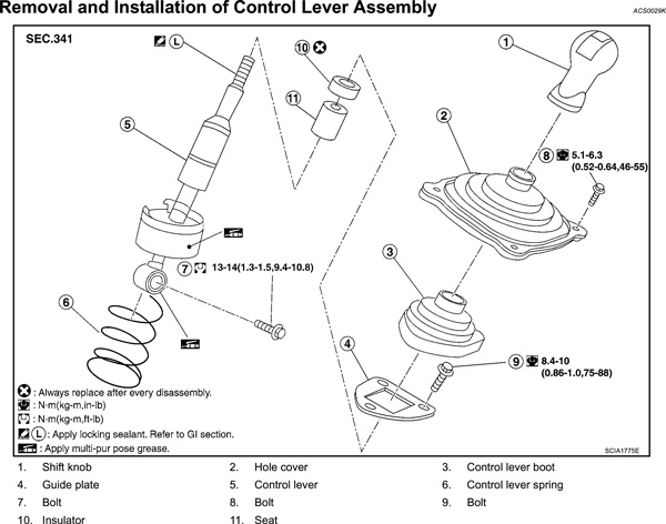

As all of you know by now, I have had some problems with “noise” issues with the Q-Shifter on some cars, but NOT on all cars. I had a hell of a time trying to get rid of the noise, and it took me longer than I expected. (I do have a job and life besides the Z)
One of the major contributors to this noise is “harmonic vibrations” created by the engine at 4200 – 4400rpm and than another one (but smaller) at 6100 – 6300rpm. So by no fault of mine, it is picked up by the solid shifter.
Now this vibration is Nissan’s issue, but it was transmitted by the Q-Shifter. It has nothing to do with my design.
Also the shift “****” internals will contribute to the noise/vibration if they are not tight against each other and the shift **** (metal seat and a rubber insulator #10 & 11 on the picture bellow). So component #’s 1, 5, 10 & 11 have to be tight against each other. The rubber insulator has to be replaced every time ( according to Nissan ) you remove the shift ****.
I have come up with new bushings and a modified socket that will eliminate/absorb (mask) this vibration to a great degree. I have sent out the bushing already to most of the effected clients to solve the noise issue – got some mixed results – for some it worked great , for others it helped a bit only.
So to put this issue to bed once and for all, all “Z” that are still experiencing noise issues will get a NEW “matched set” of a lower bushing, lower metal insert and a control socket, again.
Each one of these will be tested on a “Z” before shipping to make sure it does not create noise.
Hence it will take me a few more days to ship, as I have to perform this testing.
If it is installed properly, there will not be any excessive noise.
