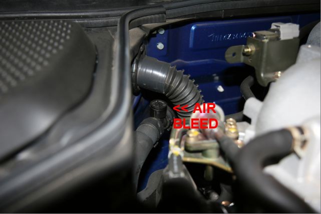

Is their a guide to installing the breather tank? as im about to install a new koyo rad 54mm and i thought better get a breather tank as i should have less problems with bleeding etc.

I also have the Koyo 54mm. You won't need a breather tank with that... Just bleed the loop per the FSM. Works like a charm.
