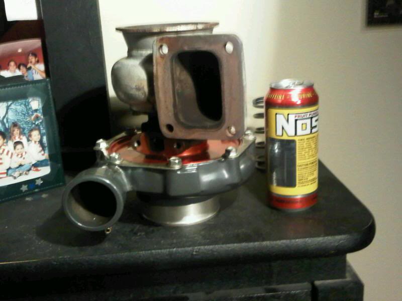

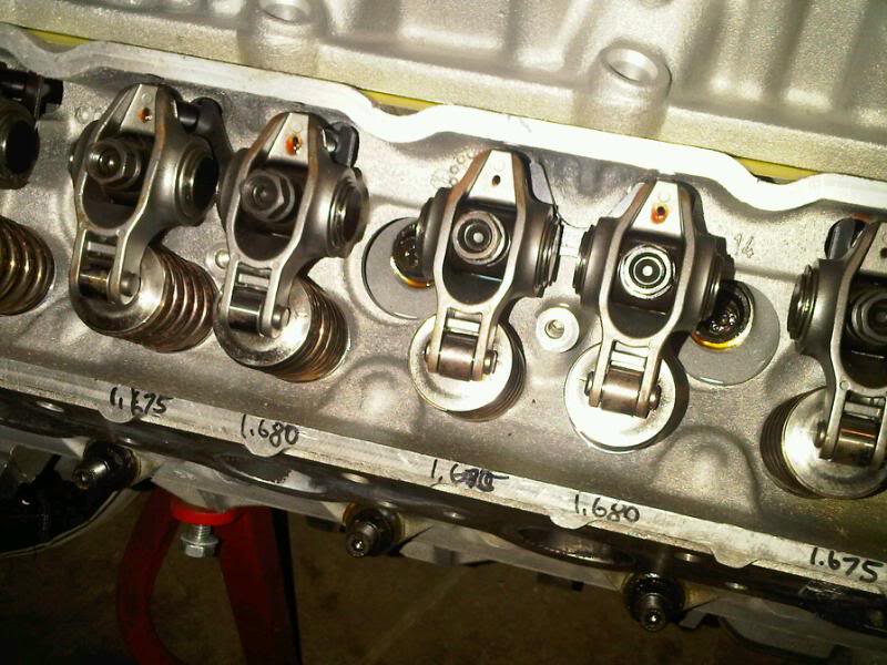

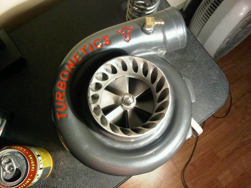

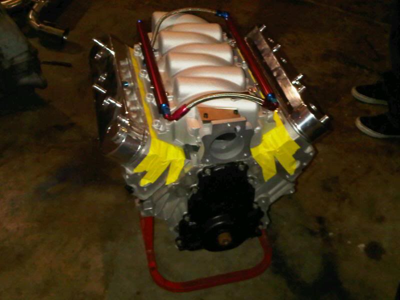

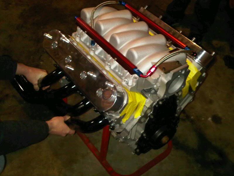

anyways got some goods
GCRE built low comp ls1/built heads, typhoon 85mm intake manifold/rails, built t56, and a turbonetics gtk1000

with sikky headers

lovely clearances

gtk1000, pretty small i must say

Coming together nicely! Are those the valve covers on Ebay? Link?
