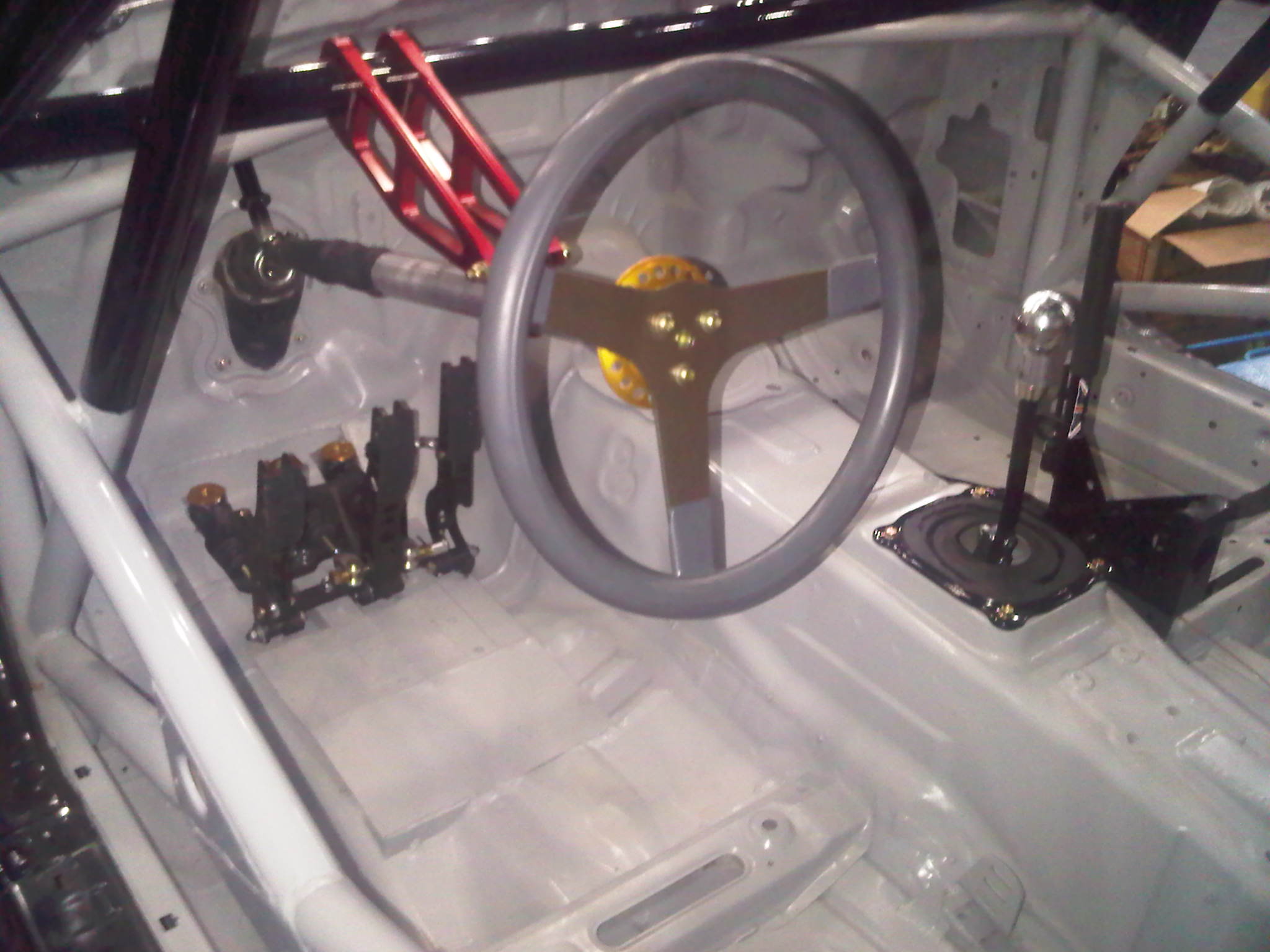

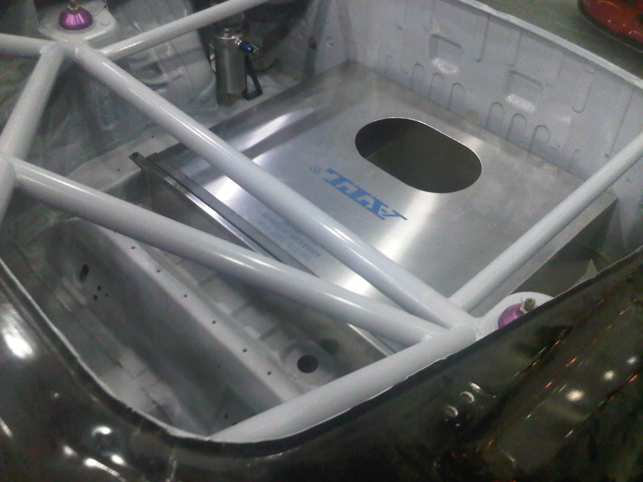

Some update:
Getting the pedals and Hyd. hand brake in in order to start working on the brake plumping and routing all of the connections.
Other than that, we will start working on the rear crossmember bushings and other suspension parts.
Az

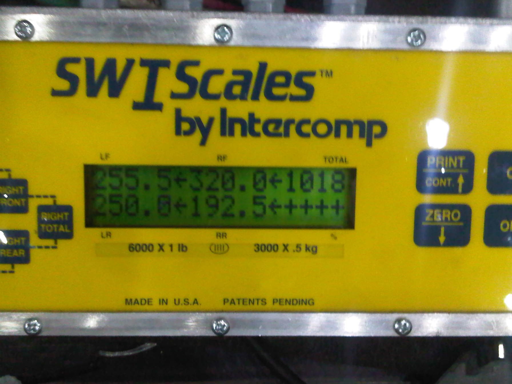

We weighted the car today and we found that the total weight would be around 1150kg (2535lbs) with everything and wet. I think its a good start.
The cross weight and weight distribution is all over the place, because we did not setup the suspension hight and corner balance the car yet

- The fuel cell balder is ready to be installed in the shoe box. Now it has an in tank FRP and filter (returnless system) and will have an inertia shut off switch in case of an collision.
- I'm currently trying to figure out the best way to mount the GT wing. We have already welded two bars from the rear shock towers to the rear of the car to be used as the base for the wing as I'm going to use a carbon fiber rear hatch. Any ideas is very much appreciated
