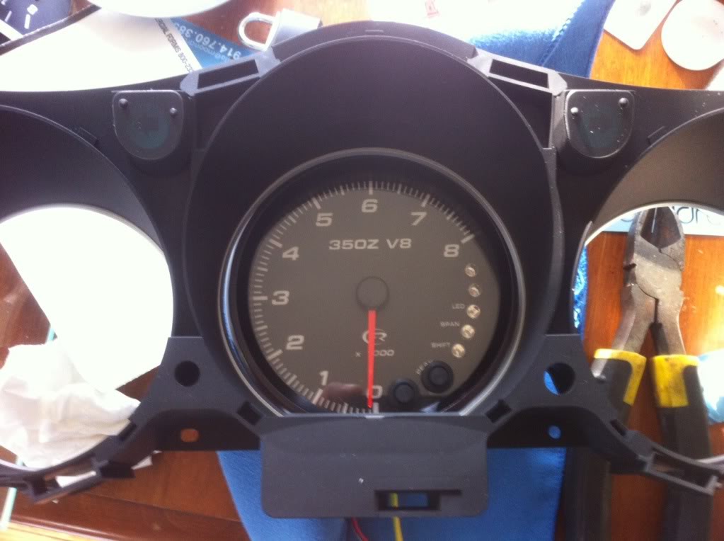

Just a quick bump!
The engine doesnt even look like it has 28K miles
n trying to work on the cluster ( thanks quamen! )

looking good. are you going to do a write up on the wiring the 2 wire harness up? cause there is not any wiring info from all my searches.

^please do! also how much trimming does that speedhut tach require?
