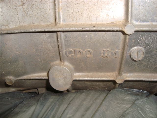

OK, there is like a little metal badge on the passenger side of the transmission, I am guessing this is not where I could find the 'cd' number. Where might I find the cd nomenclature on the trans?
Old May 20, 2011 | 11:33 AM
spent's Avatar
spent
Joined: Oct 2009
Posts: 70
From: FL
CD0 #1 on drivers side... time to get new tranny

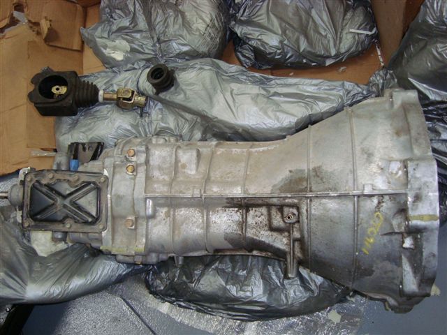

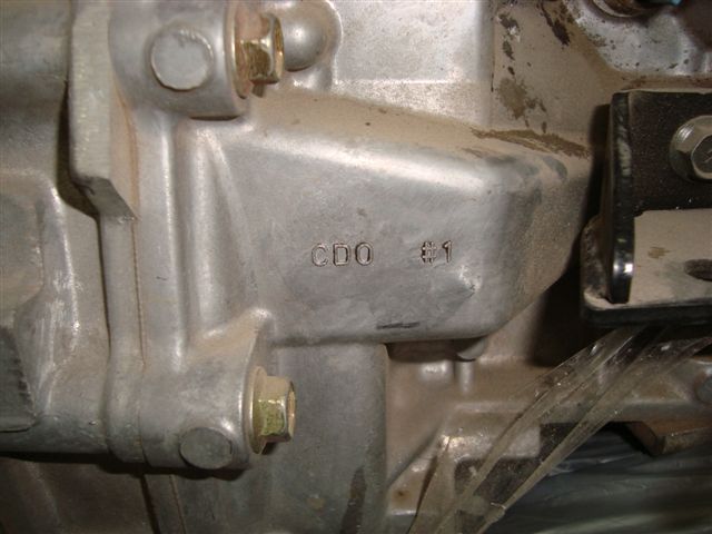

OK, so I bit the bullet and got a 6 speed from a 2005 350z. The actual castings in the tranny look just like mine, CD0 #1, on the passenger side. However, there is a sticker on the drivers side that says cd009? Think this is legit?

Regardless not ALL older trannies have bad syncros... just more of them do. Personally I've never had any issues with mine ('04) and I've pounded it at the track over a dozen times.
Old May 31, 2011 | 03:43 PM
spent's Avatar
spent
Joined: Oct 2009
Posts: 70
From: FL
Nevertheless, I didn't shell out cash in order to get an older tranny
Just trying to confirm that I was sold what I was told that I was being sold....
