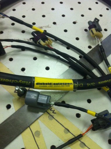

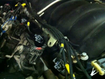

Going this route meow. I don't want to have to drive all the way back to VA in the spring to get the AC done and I don't know anyone local that can fab an AC system from scratch. This way I can have Franz make a nice trick switch to turn it on/off, he may be able to put it in like the stock setup. Franz may also take a shot at deciphering the CANBUS once the car is running. IF he can do that he said I can ditch the Nissan ECU all together since ViPEC can control it all.
The harness is coming together and looks incredible. He put all the trans sensors on a separate sub-harness with a single master plug so if I ever need to drop the trans for a clutch upgrade or something it is a quick single disconnect.
Also, he had me send him the stock VQ oil pressure sensor that he will mount in the stock LS pressure location. This will allow him to have the oil pressure idiot light functional like the stock system. It will also allow the ViPEC to put the car in a restricted RPM mode if this light triggers. The Defi pressure gauge will move to the remote filter head with a 1/8 NPT extension.

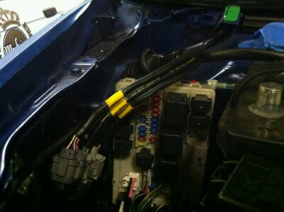

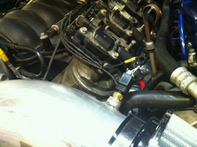

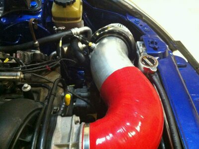

The harness is complete and has been test fit to the car. Franz is out of the country tuning for the bulk of this week, but if all goes well the car should be running shortly after he gets back. I have a few random pics of the harness on the car.

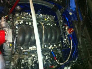

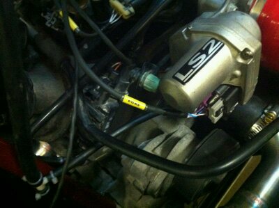

My SIKKY LS2 install thread-1316363176737.jpg My SIKKY LS2 install thread-1316363177582.jpg My SIKKY LS2 install thread-1316363177869.jpg
Next up is the AC lines and the switch for the compressor in the car. He also had to fix one of the coolant lines that JE did, it was pinching the hose connection shut.
