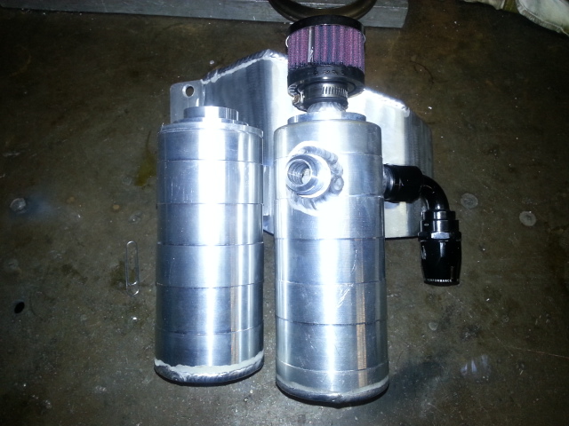

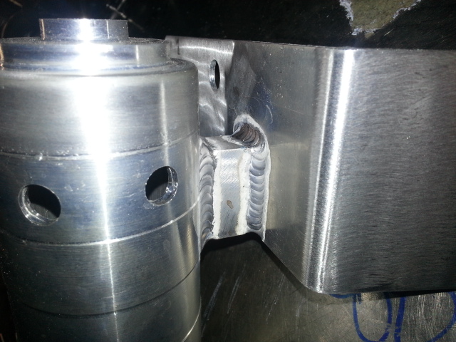

or, if ur zNOT a cheap *** (as referenced waaay earlier in the thread), have a properly built one custom made..SFR built one for me with a drip chamber in the upper end so that oil drips through "fingers" Tim cut in a plate he welded in the middle...the bottom is stuff with AL shavings....K and N filter allows venting.
Attached Thumbnails The problem with catch cans and the 350Z-20131029_182538.jpg   The problem with catch cans and the 350Z-catch-can-with-filer-attached.jpg   The problem with catch cans and the 350Z-catach-cans-mounted.jpg
