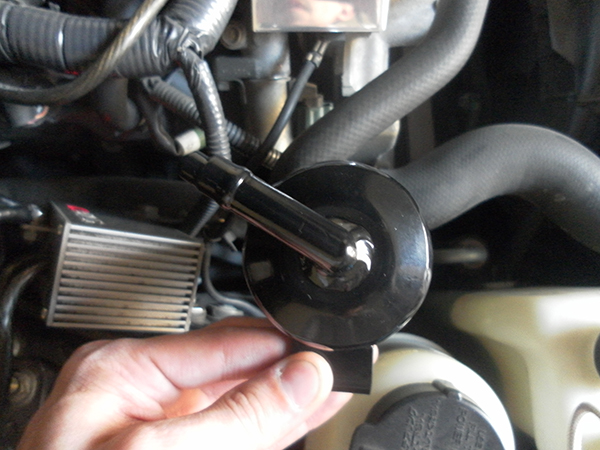

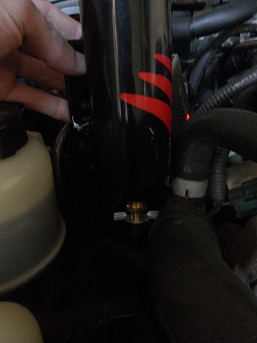

I did, I will see if attachment works tonight when I get back home.. it wasnt working before, and the server I put the pics on has gone down.
edit: see attached pics.. Coolant hose runs too close to power steering bracket to mount the can as specified.. that is why I have to cut the bottom of the handle and run over the power steering bracket and mount to the inside of the catch can handle... and I believe it will barely fit.. I have scratched it to hell just trying to test fit it.

So, i can't quite see where yours isn't fitting, but take a look at mine from another angle, i know the edits this needed, were, the mini can, the custom barb angles and a shallower bracket.

Yeah, sorry for the bad pics. Yours must be smaller than mine as mine would never fit like that. The company got back to me and said I need an alternate version and are asking me for specific specifications if I'd like one made. Maybe their 350z version is for an HR? No idea why it is so far away from fitting.
What is the diameter and length of your catch can? length out for the bracket? I understand if you dont have the time to measure, I appreciate your responses. It appears like everything on mine is too big.
They are saying I need to pic a different spot and maybe use some L shape/flat brackets... I will have to take a look because I am not sure where else to mount it and have it still work efficiently. Maybe I will take them up on their offer to make one to specs that will work out... or just try and modify mine to make it work. They seem like they are good ppl trying to help me find a way to make it work.

Yeah, kinda like that after I run the handle mount Over the power steering bracket.. so it still wouldnt fit mounted like that on the outside of the PS bracket.
Question.. I think I modified it enough to possibly make it work, maybe not... but man is the hose hard to get on the lower manifold hose.

So i'm going to guess that your 350z can didn't get the smaller bracket it needs.
Mine may well do, you've got air rushing through it, though i can't remember if mine actively does now. Check you've got the hoses on properly and clamped.

Yeah; I believe if the bracket was smaller, it would have worked out alright.
After a week of cutting thru the bracket so I could slide it over the power steering bracket, it squeezes in very tightly... but it will be a pain to empty it... and it is kinda rubbing against a coolant hose.
I double checked the lines and they seem tight, I believe this catch can just makes a faint air noise of air rushing thru it... my idle seems normal though so I believe it is good.
I will try to get a picture later today of it mounted... my braided hoses get pretty hot after a while, which I think is normal.
