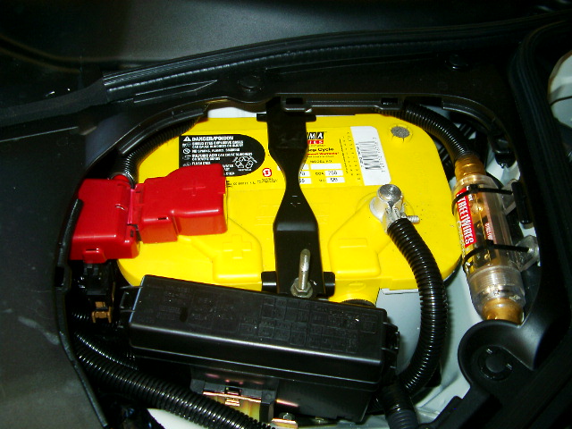

I have the Optima Yellow Top in my Z. It does not just drop in. I had to get my wires extended so the battery would fit correctly.
This battery is awesome for running high end stereo systems.
Wow, your poles are reversed. For the 350Z, you need the SC51RDA and you won't have to mess with the cables as they will go right on. Here's a pic of my car...
You tap your amp lead to the stock fused block? I thought you couldn't do that?
