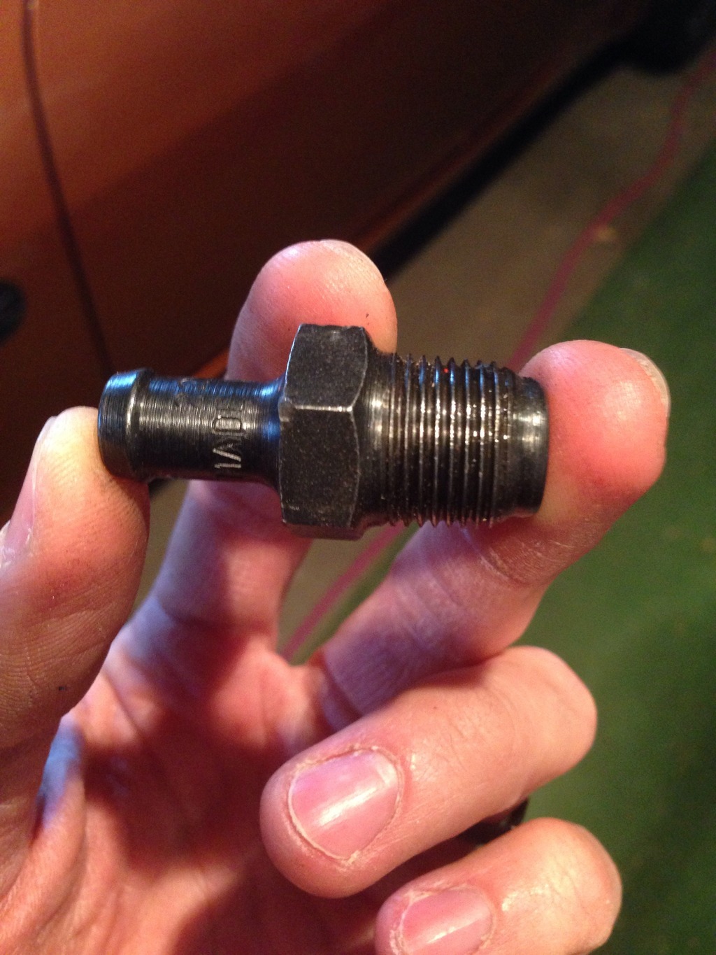

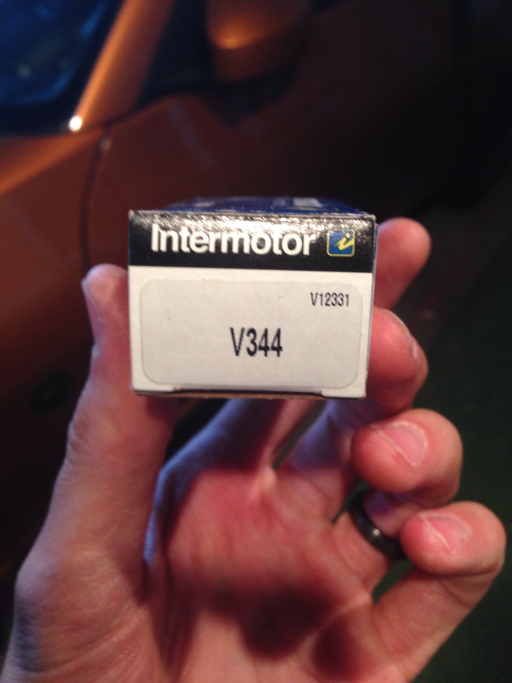

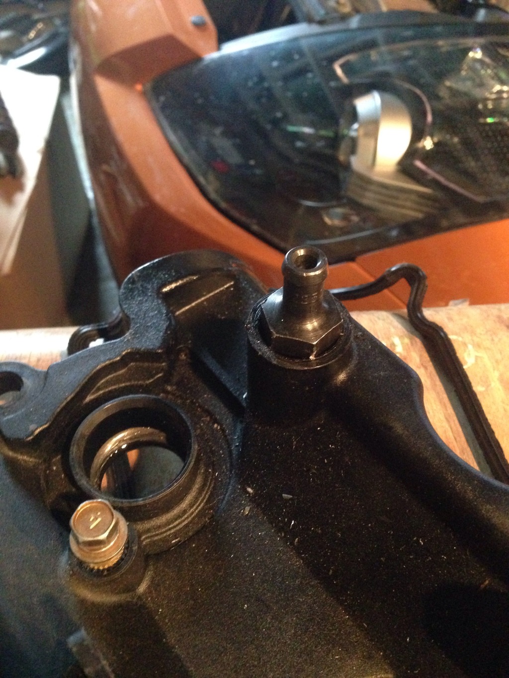

Hey guys. Finally getting around to working on this. Life just gets in the way sometimes, ya know? Anyway, my lovely wife turned up one of these. It's for a mid 90s Altima 2.4L. It's a little bigger, but I just forced it in to tap the valve cover. It didn't take much effort. I believe this is a 17mm compared to the stock 16mm. I'm going to throw some liquid pfte thread tape stuff at it and cross my fingers.
