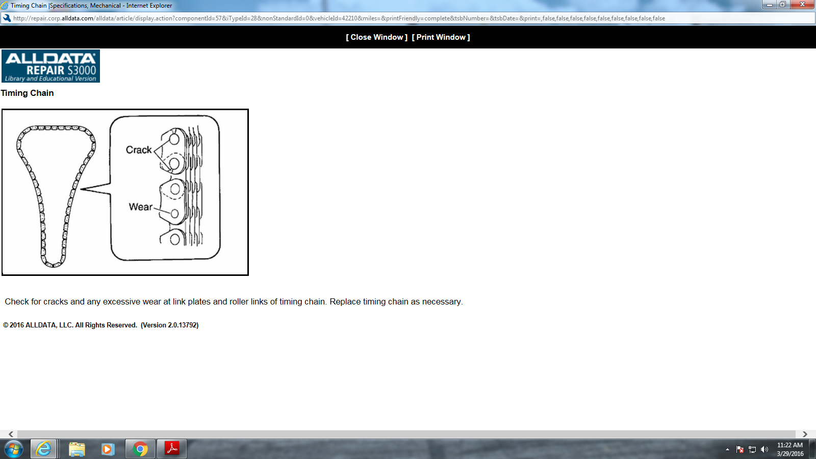

According to All Data:

Thanks. But that translates to "replace if needed" which tells nothing. If I paid someone to check my chain I would replace it anyway because opening engine up would cost me way more than a chain.
