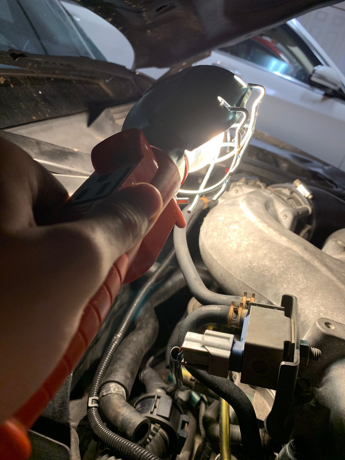

Hey everyone,
i was finishing up installing the motordyne plenum spacer and can’t find where one of the hoses it supposed to go back (I removed a few hoses to be able to fully remove the upper plenum) the hose is connected to the driver side valve cover, I just can’t figure out where the other side is supposed to connect to. Please see attached video for the hose I’m talking about. Thank you for your help.

The hose from the driver's side valve cover goes to the underside of the intake tube.

Videos not going through but l I’m able to get pictures to upload, here’s the tube. It’s not near the intake.

Looks like the coolant hose that goes to the port right around that area? Used to heat the TB.

Don’t know why but I can’t seem to find it! Any idea where it would be exactly? I don’t know how this is possible lol

Sorry I don't have the pic yet, my engine doesn't have it by the looks of it so my guess would be pcv. But I got a body of mine that will come over with his stock car so I can take a look.
So tommorow I can send you the image
It's connected to your valve cover right?

So I have figured it out. The hose needs to connect to your intake pipe bottom.
So other side of your engine
