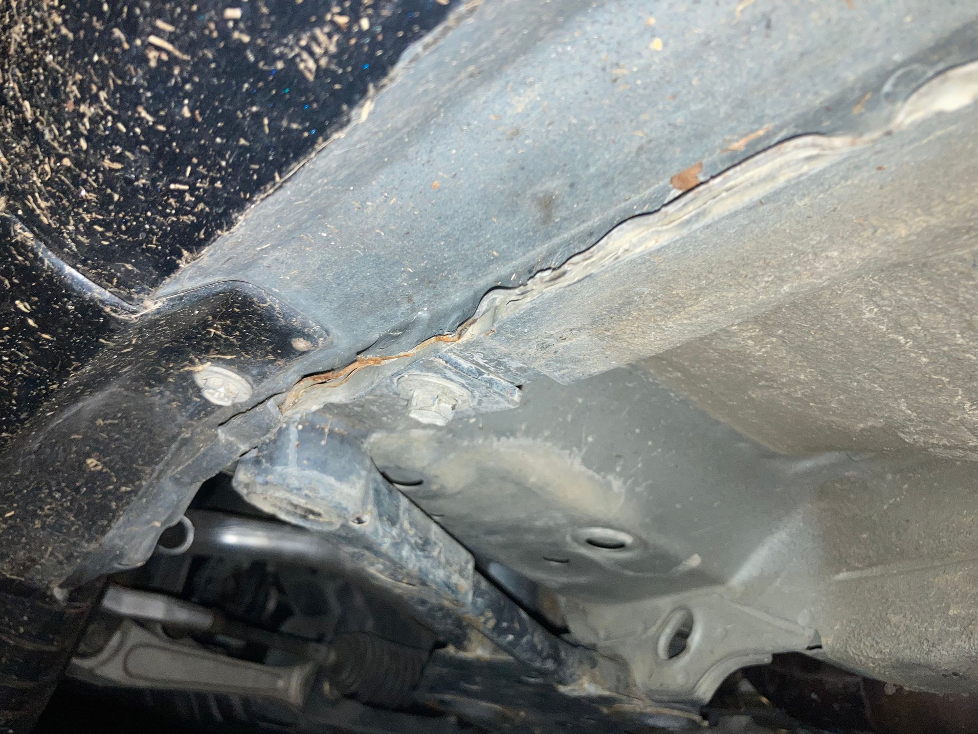

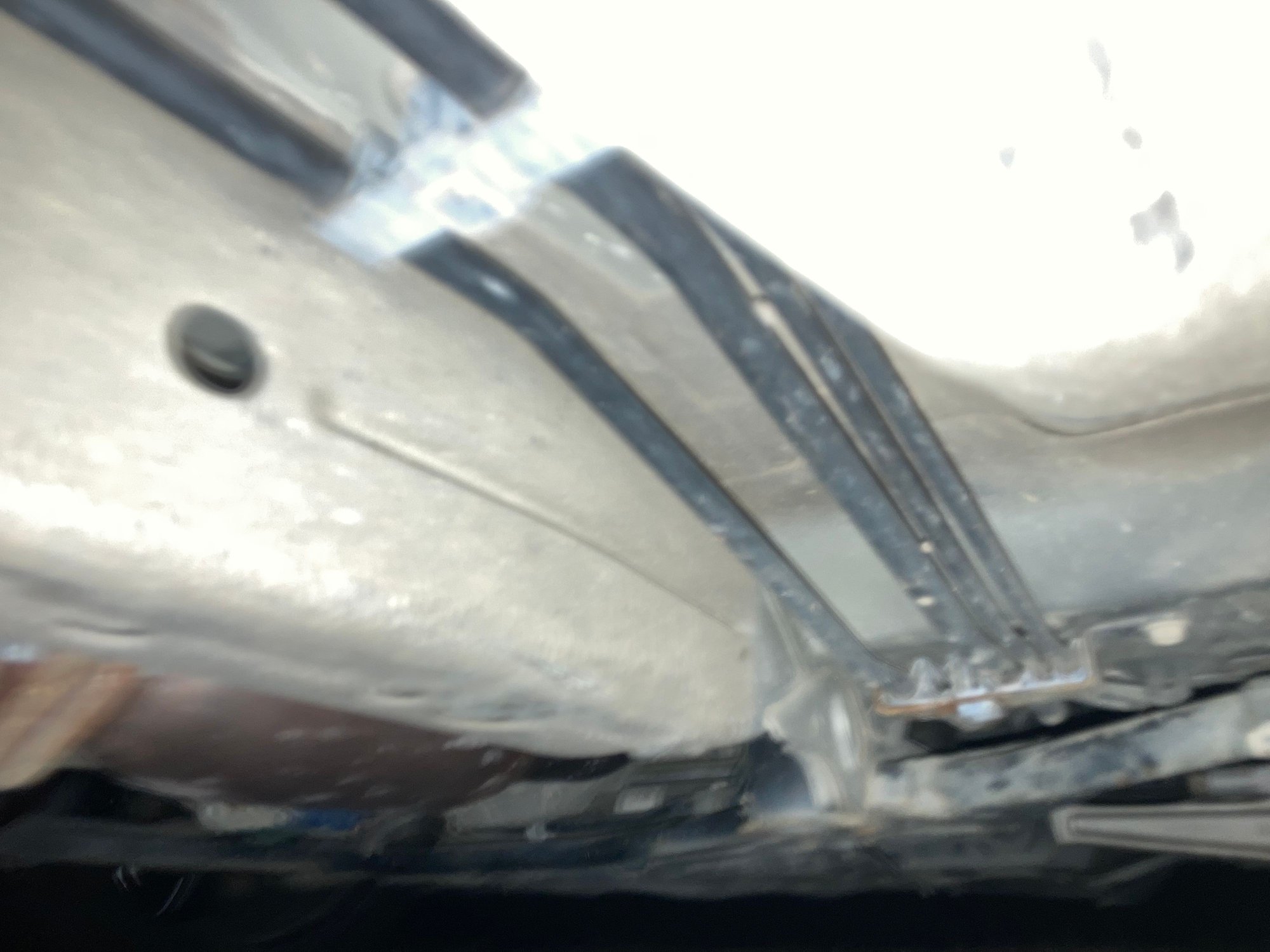

damn idk if i should make a new thread for this because of the section im in but it looks like they only have one aftermarket control arm installed. im worried, if i get these 1000 dollar bilstein shocks and plan to keep them for a decent little bit, can that put unwanted stress on them? i cant wait to take that exhaust off lol. it looks rusty, i hope its not spreading to my car. lmk if u all see any rust too i was convinced this had been garaged for ten years before the last year.

Red is lower tie braces, not rear camber arms. Def some minor rust. But....now add in rear diff bushings. See the black jizz on subframe? Bushing is blown
on rust. is there somewhere or way i can help get rid of and prevent rust. if i dont wreck it i want 300k miles on this body and i dont want it to fall apart.
and thanks! part ordered. thats strange its just one aftermarker lower tie brace. i hope i can ride like that for months on some nice shocks and not mess them up.

the rust you have is minimal. wire brush, rust neutralizer, hit it with black paint. i had the whiteline bushings, the one in the rear subframe is a pita, z1 has a tool to get it out i believe

Dude, chill with the rust. Those pictures show barely anything other than some numb-nuts who destroyed the jack points. Also, rust is not going to magically jump from your exhaust to other parts of the Z. If it was that rusty, the exhaust hangers would fall off and then you'd have a sweet underglow light show fireworks display.
