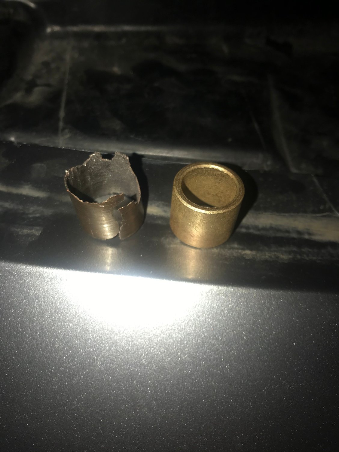

Old May 24, 2023 | 06:36 AM
piolo_z33's Avatar
piolo_z33
Joined: May 2023
Posts: 5
From: texas
Originally Posted by bsosa_12
so i had this exact same problem this weekend. I had the exact same problem you had. But for some reason today it started working just fine. If you find a solution lmk because we thought about replacing clutch, bleeding the clutch, and we thought about changing the trans oil. And I want to be sure it doesn’t happen again. we still don’t know why it happend.
just found out my issue for the clutch, turns out it’s either going to be your clutch thrust bearing or your pilot bushing, my pilot bushing was very thin compared to the new one but overall I got it fixed after taking the tranny out and taking a look.
Old May 24, 2023 | 06:11 PM
i8acobra's Avatar
i8acobra
Posts: 8,035
Likes: 1,340
From: Phoenix, AZ
Did you replace the bushing yourself? Did you soak the bushing in oil for at least 24 hours?
Old May 24, 2023 | 09:40 PM
piolo_z33's Avatar
piolo_z33
Joined: May 2023
Posts: 5
From: texas
no we slowly hammered it in with a 14 socket not to far in but far enough in
Old May 25, 2023 | 06:10 AM
i8acobra's Avatar
i8acobra
Posts: 8,035
Likes: 1,340
From: Phoenix, AZ
So, those bronze bushings are porous because they're meant to absorb and hold oil. That's why there's usually oil in the bag they come in. I usually soak them for 24 hours then use a trick I learned years ago where I place it in my palm, fill the center with oil, then apply pressure with my thumb to force the oil into the bushing. Hopefully yours had enough oil in it.
