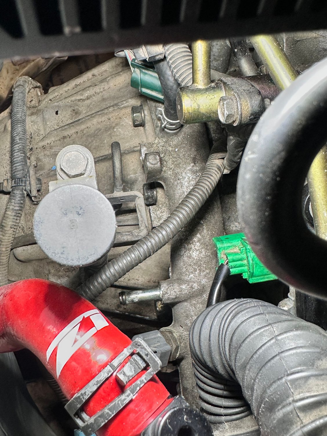

Does anyone know what hose goes to this fitting on the back of the engine right on top of the transmission bolts?

Looks like the air breather hose. Should just be a loose hose that connects to it. It's probably degraded or fallen off over time.

Isn’t that the one that goes to the intake manifold to heat it up

Nah, the one you're looking at is a bypass that goes to the radiator inlet hardline. The capped fitting on the right in my photo is the one that goes to the throttle body.
