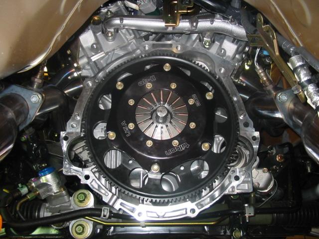

Tilton rally clutch and 8 lb. flywheel. Expensive but worth it. Barely streetable. Very hard to launch from a dead stop. Once you are rolling, it revs like a buzz saw. Incredible.
Attached Thumbnails Getting transmission replaced - Need flywheel / clutch advice-tilton-clutch.jpg
