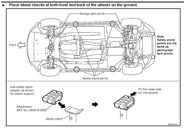

this may help

where can i get some of them safety stand adapters? it looks rubbery

noone seems to be able to locate them.. Nissan doesn't carry it as far as i know

not sure if these are the ones you would need, but summit racing has them for $14.39. unfortunately, there is no picture of what the product looks like
jack stand pad
good luck

The pads come from JCWhitney also
http://www.jcwhitney.com/autoparts/P...atalogId-10101

What material is this stuff (from JCWhitneY)??? ... hard rubber?
Edit: NM ... says Nylon
