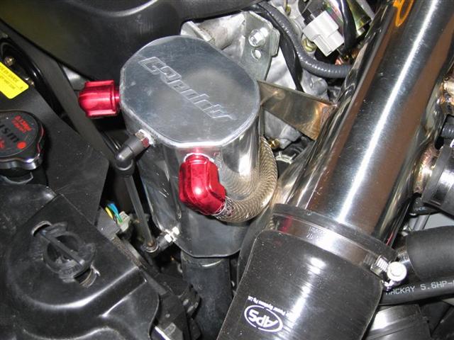

Originally posted by n1cK!
yeah, you're right. one hose would go on the crank case vacuum side, and the other hose would go into the intake, where the crank case vacuum hose went into. the catch can is in between. get it?
n1cK!
ps-oh, and nismo doesn't have a catch can, the one you see on e-bay is a knock-off.
Pic of Greddy oil catch can installed.

nice install. did you use the greddy t-bracket, or make your own. good spot to put it though. find any oil in there yet
