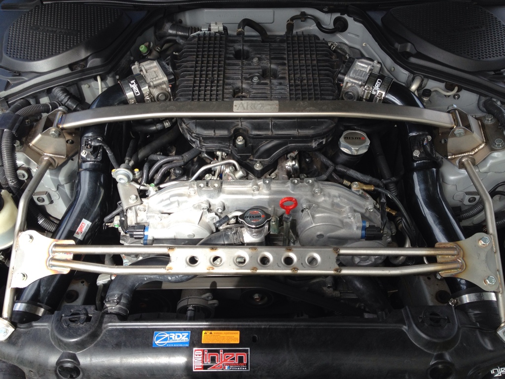

Drives fine! Idles however drop and rise a lot , I'm guessing a retune since I also installed the r35 injectors!
This is as far with the tucking and mild re routing of anything lmao!
Moar

If you drift and maintain your vehicle regularly, you may want to do your coolant line tuck in a slightly different manner than what everyone else is doing. The Coolant line tuck makes bleeding the coolant a *****....air typically gets trapped around the thermostat....or at least this has been my experience with the DE's
there is a bleeder in the back of the engine for coolant. did the same to this z as my twin turbo z I drifted for a year..never had a single issue thanks for the tip though.

better pics of the tuck in from far away i guess. Do not mind how dirty she is. lol

^^Thanks man. i did little things here and there, took the alternator ground wires and hid them throw the bottom, took the emission crap off that hangs off the plenum so it looks a lot cleaner. and the speaker for the alarm on the driver side i took it off so it doesnt look like i didnt do nothing haha. when i get a good pic i'll post
