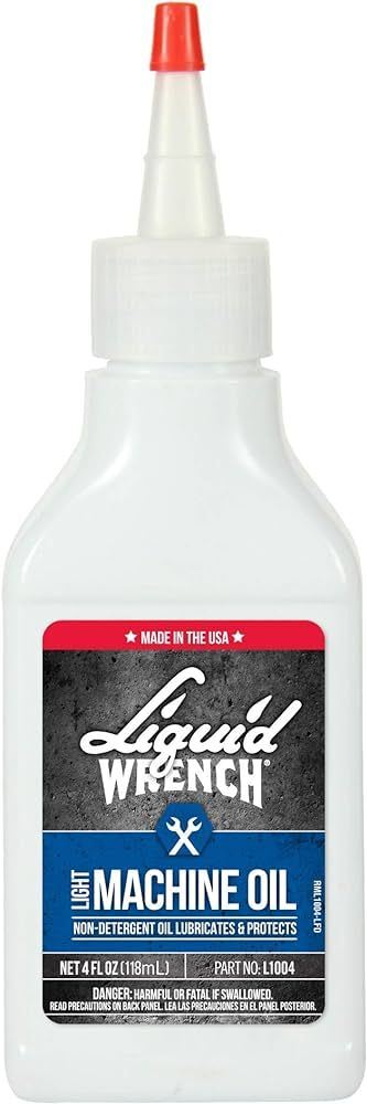

I'd be more concerned with the liquid wrench than anything - assuming you added this to the oil?
That being said, 2+ year old gas is going to be pretty rough to run on, especially in California - because everything sucks in California.

Understood. The car had less than a gallon in the tank. I added 3 fresh gallon to the tank.
Here is an image of the liquid wrench I used.
As an update. The xtool d7w now is giving me a multiple misfire and code 0300. Runing the older style Ultimate racing high flow cats.
I used only about 1/4 to 1/2 oz in each cylinder.
