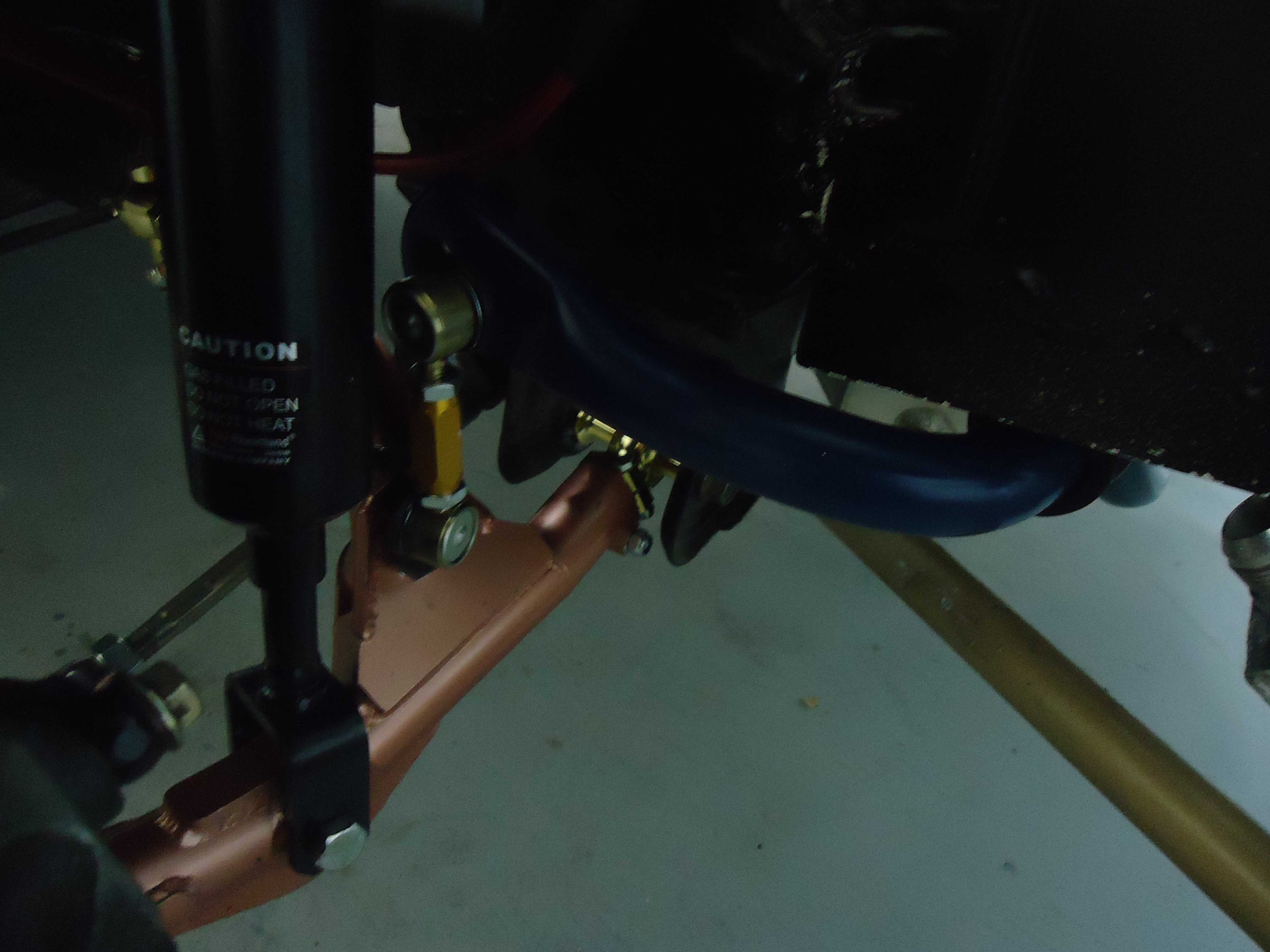

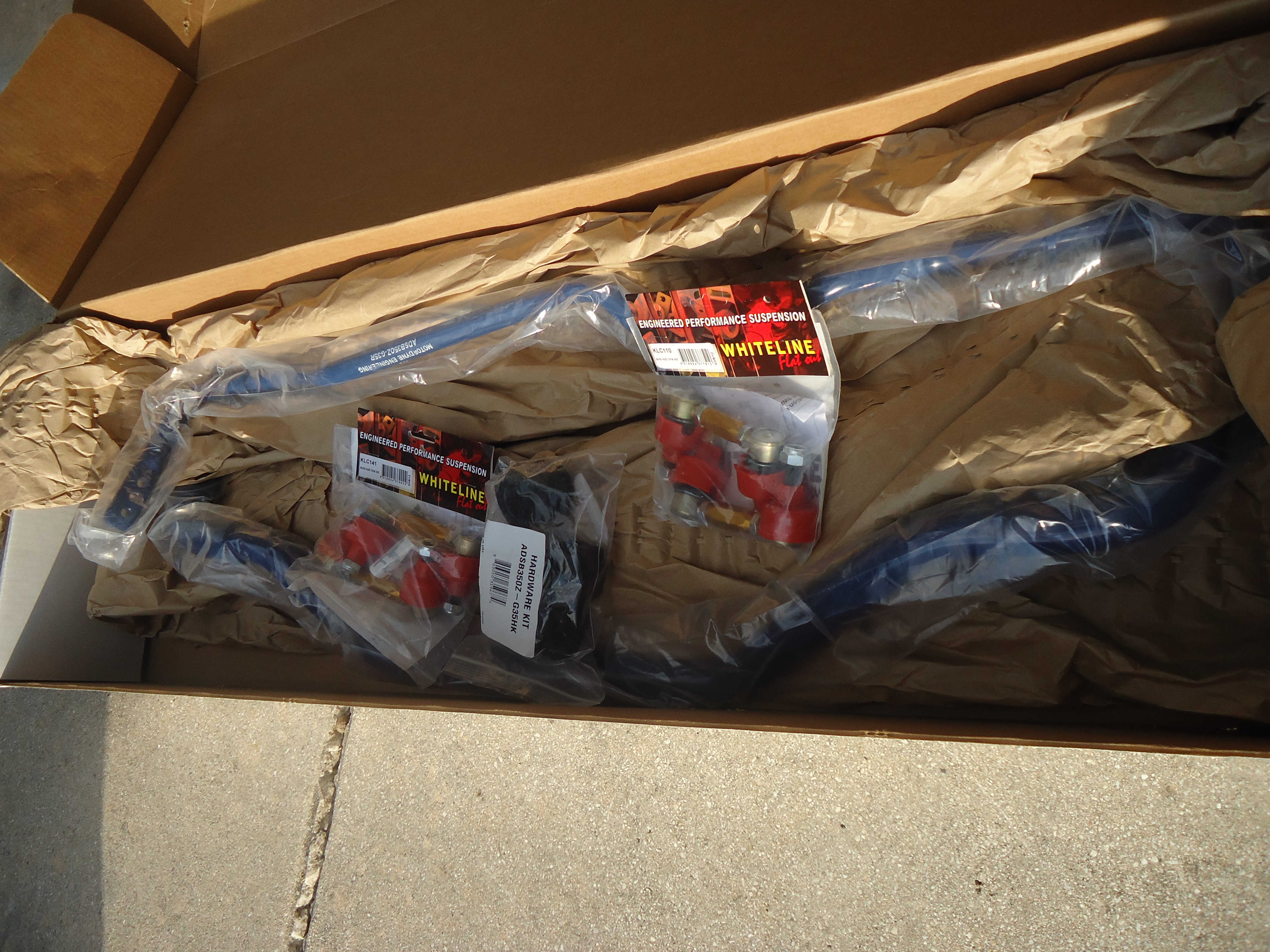

First up to bat were my new sway bars. Motordyne hooked it up with a nice setup sway bars I must say. The quality of these things are top notch.

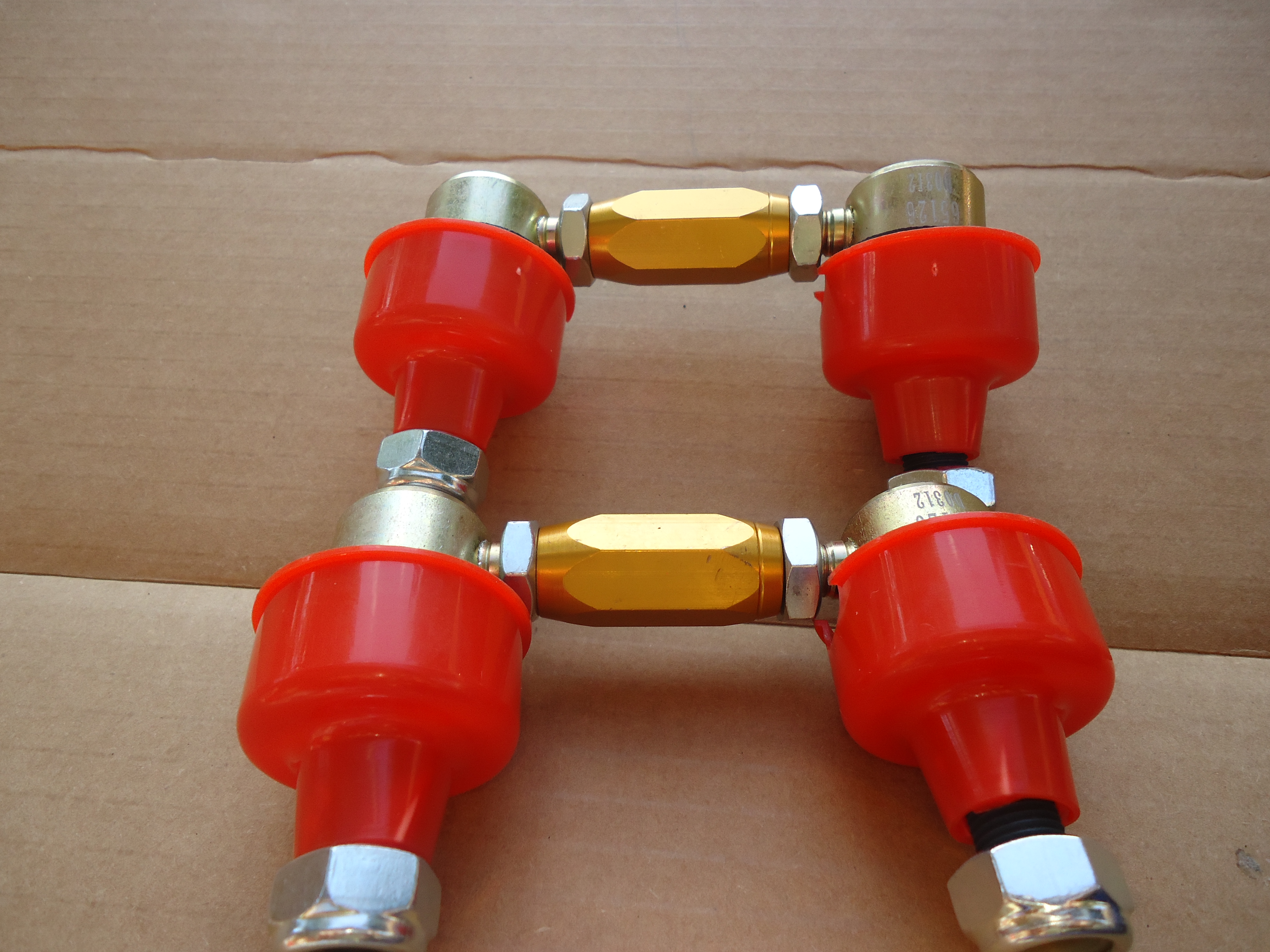

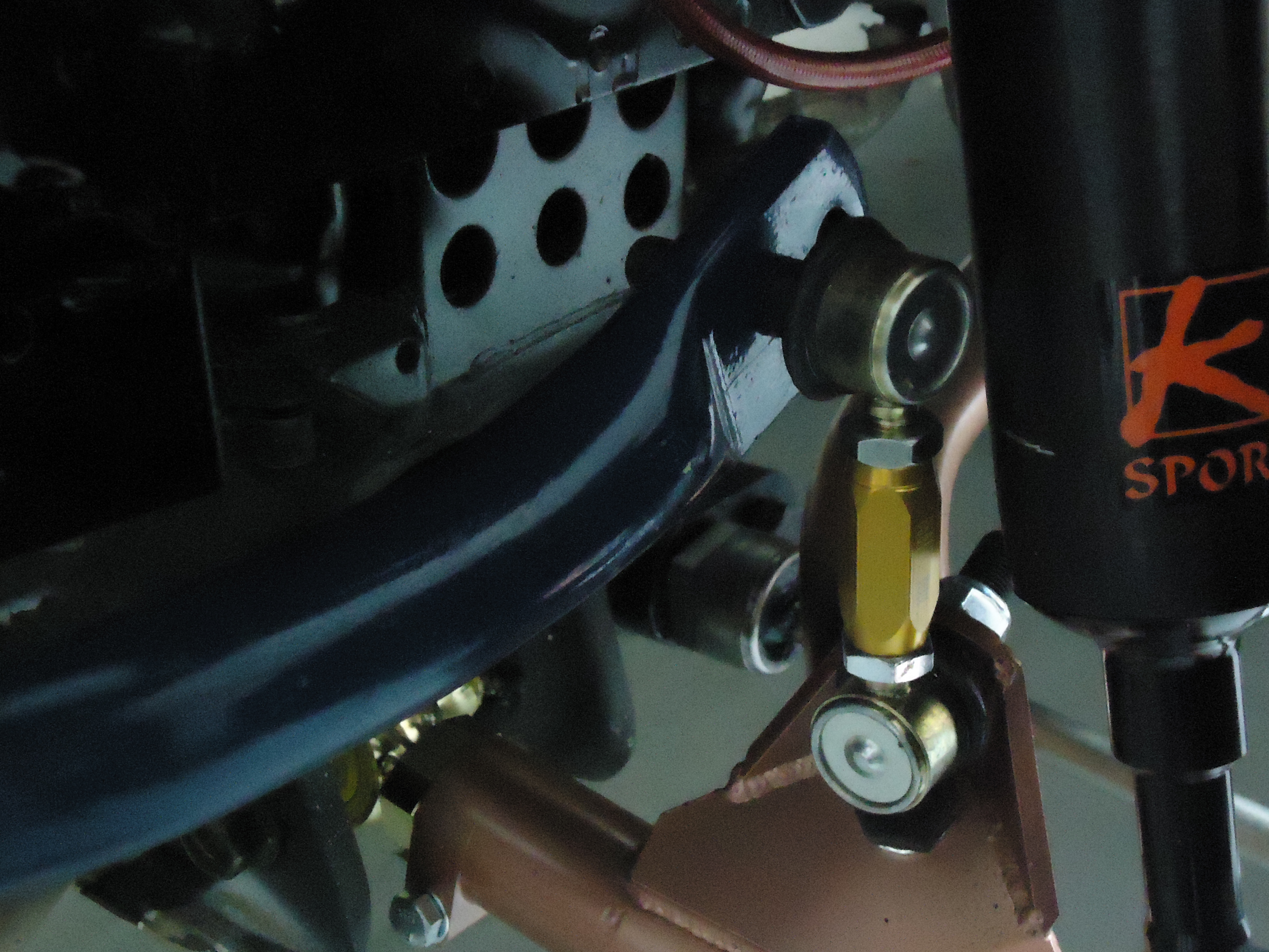

I paired the sway bars with some Whiteline endlinks.. Love the gold...lol

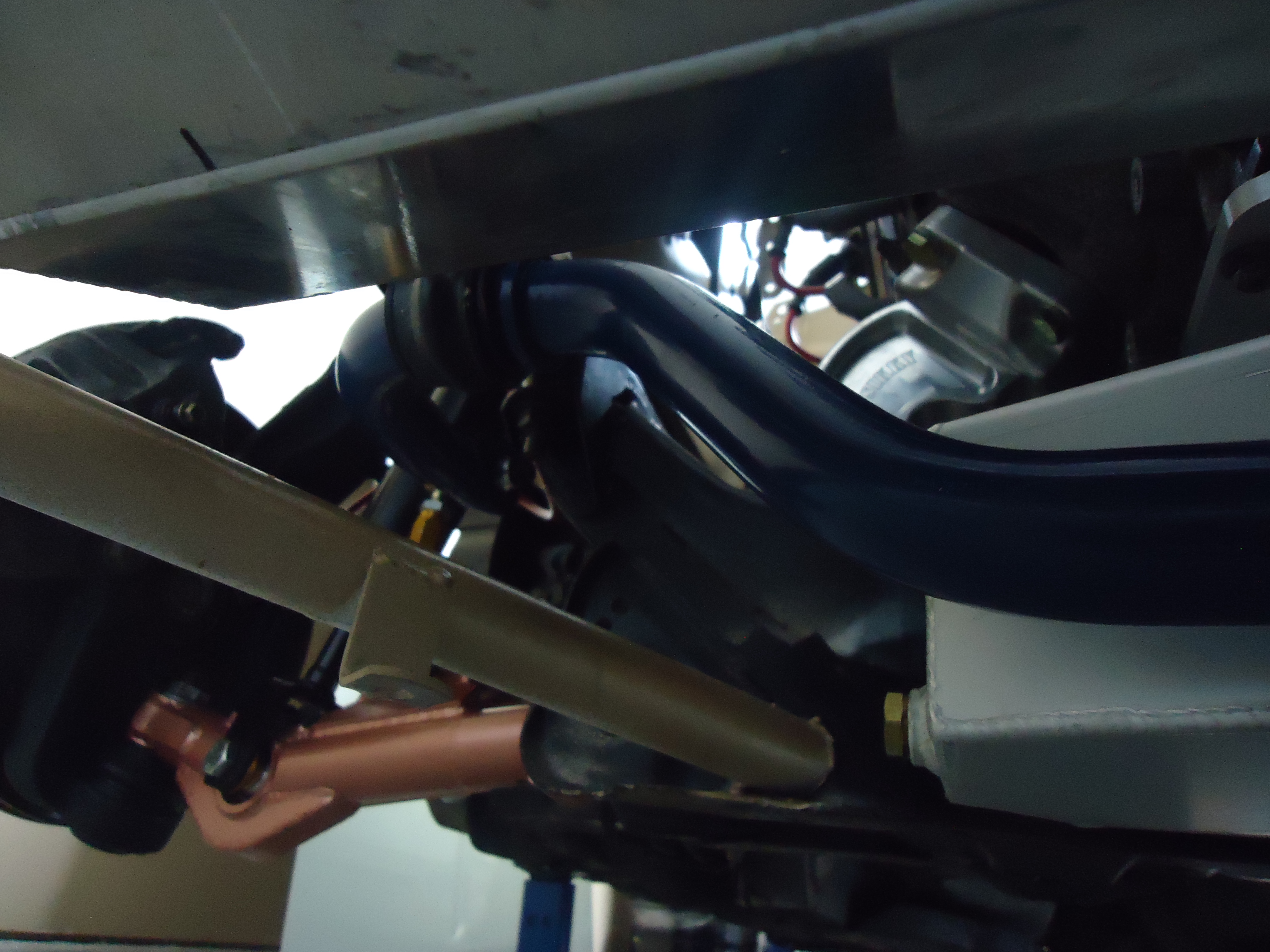

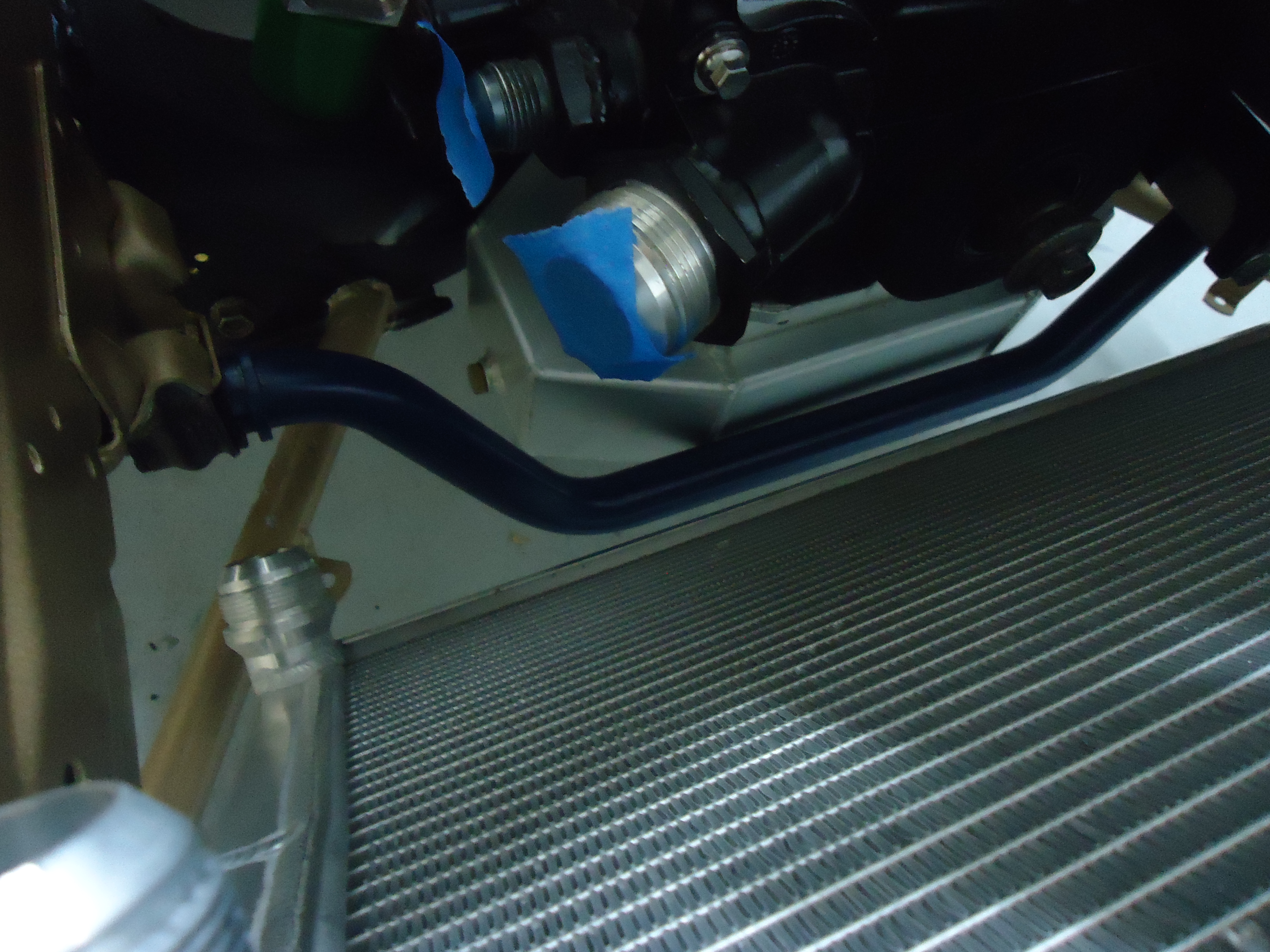

Fit is money, have to test my -20 AN fitting just to make sure it fits. I will post pic later when I do.

Good clearance..

I think these Whiteline endlinks just look so fresh.. I did how ever have to drill the holes out some to fit them, probably due to powder coating but they fit like a glove now.

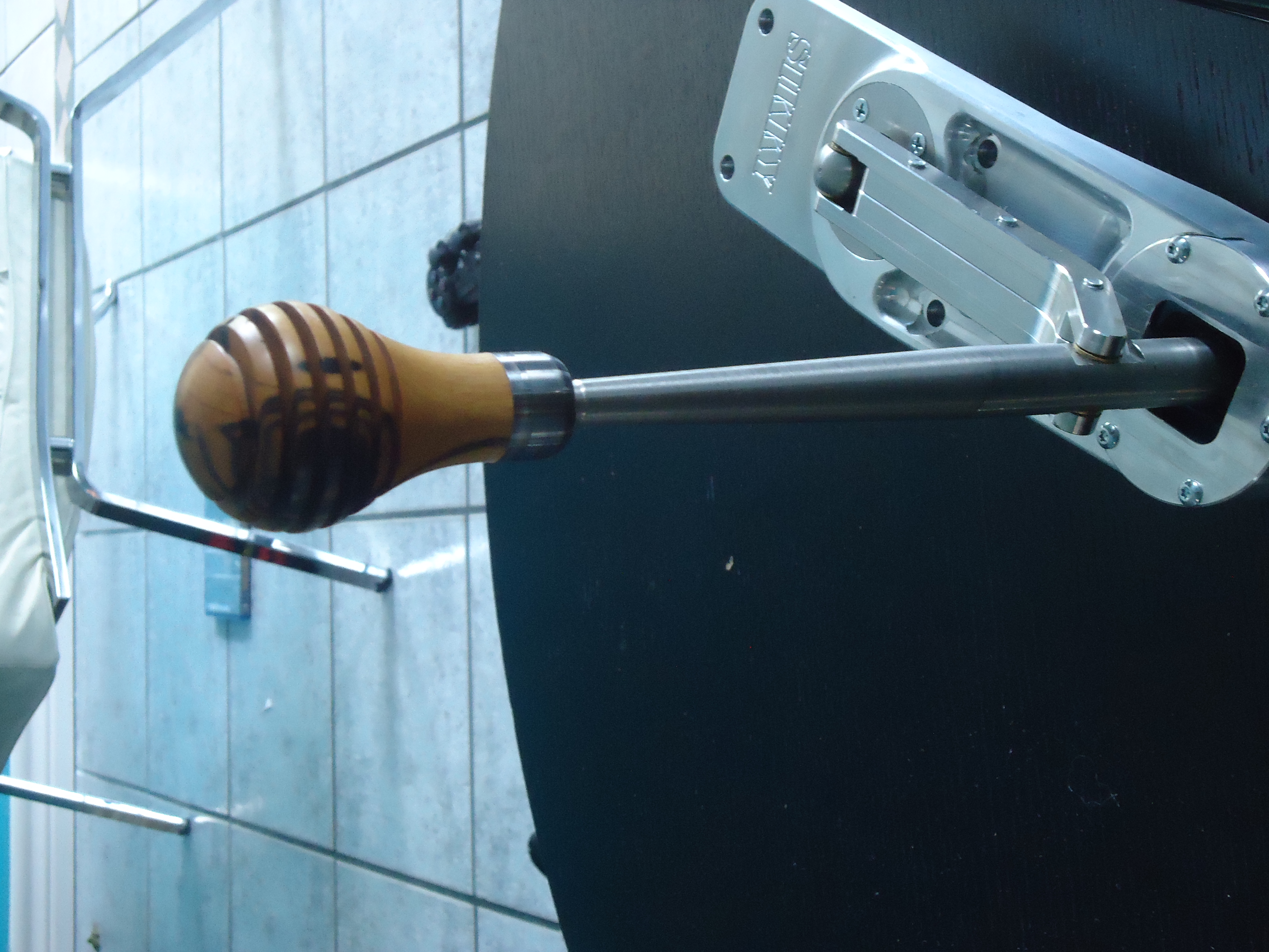

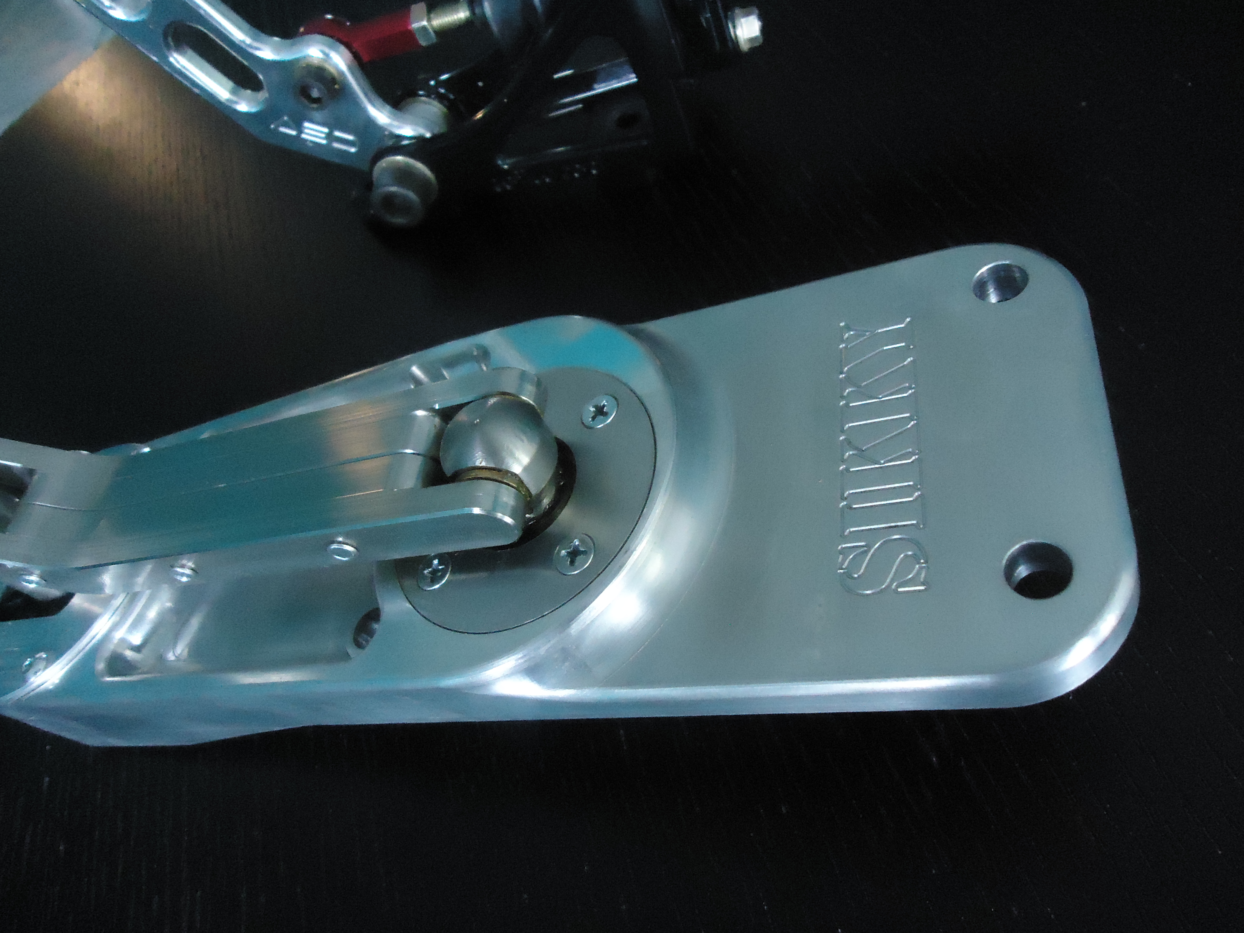

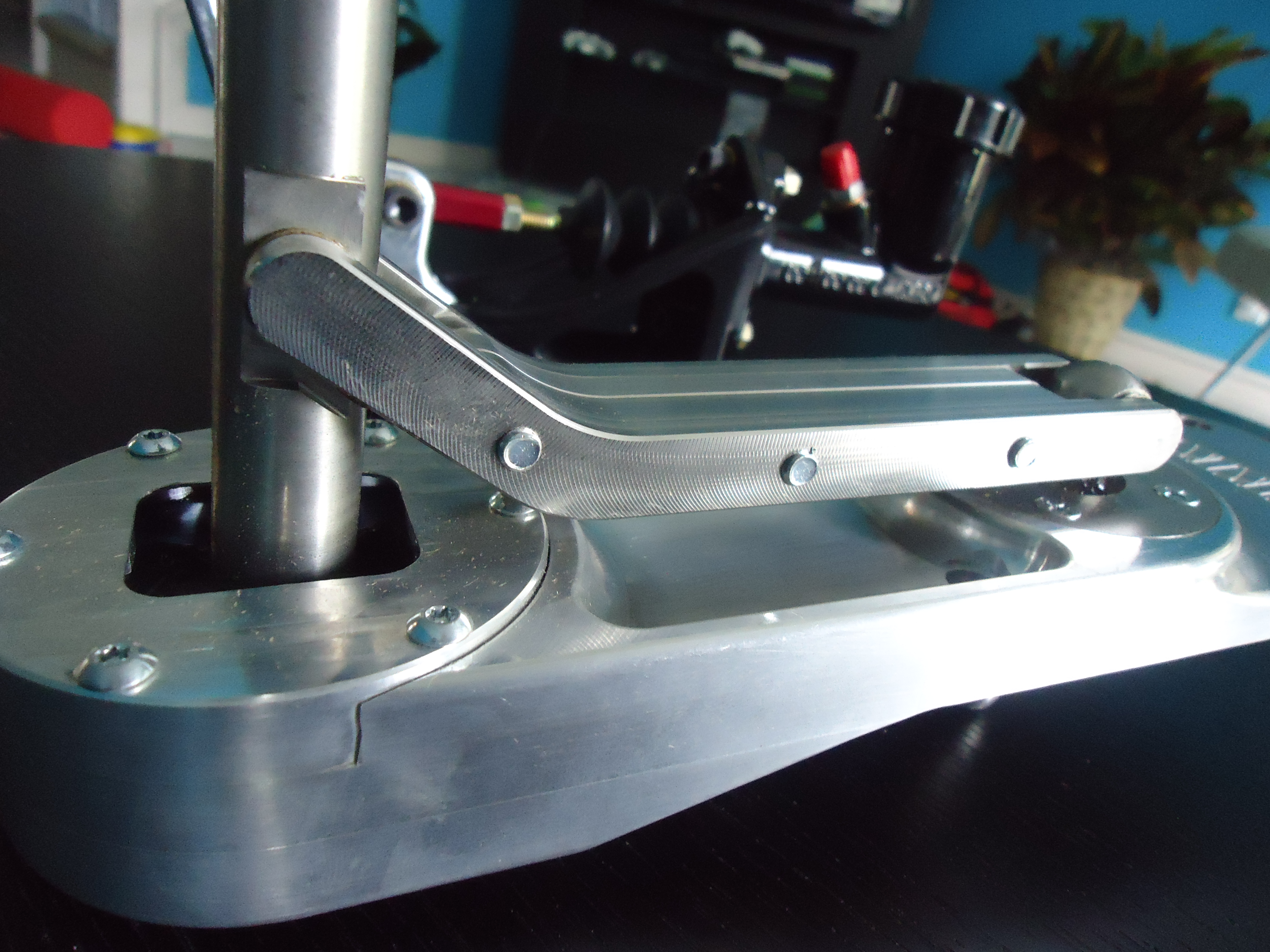

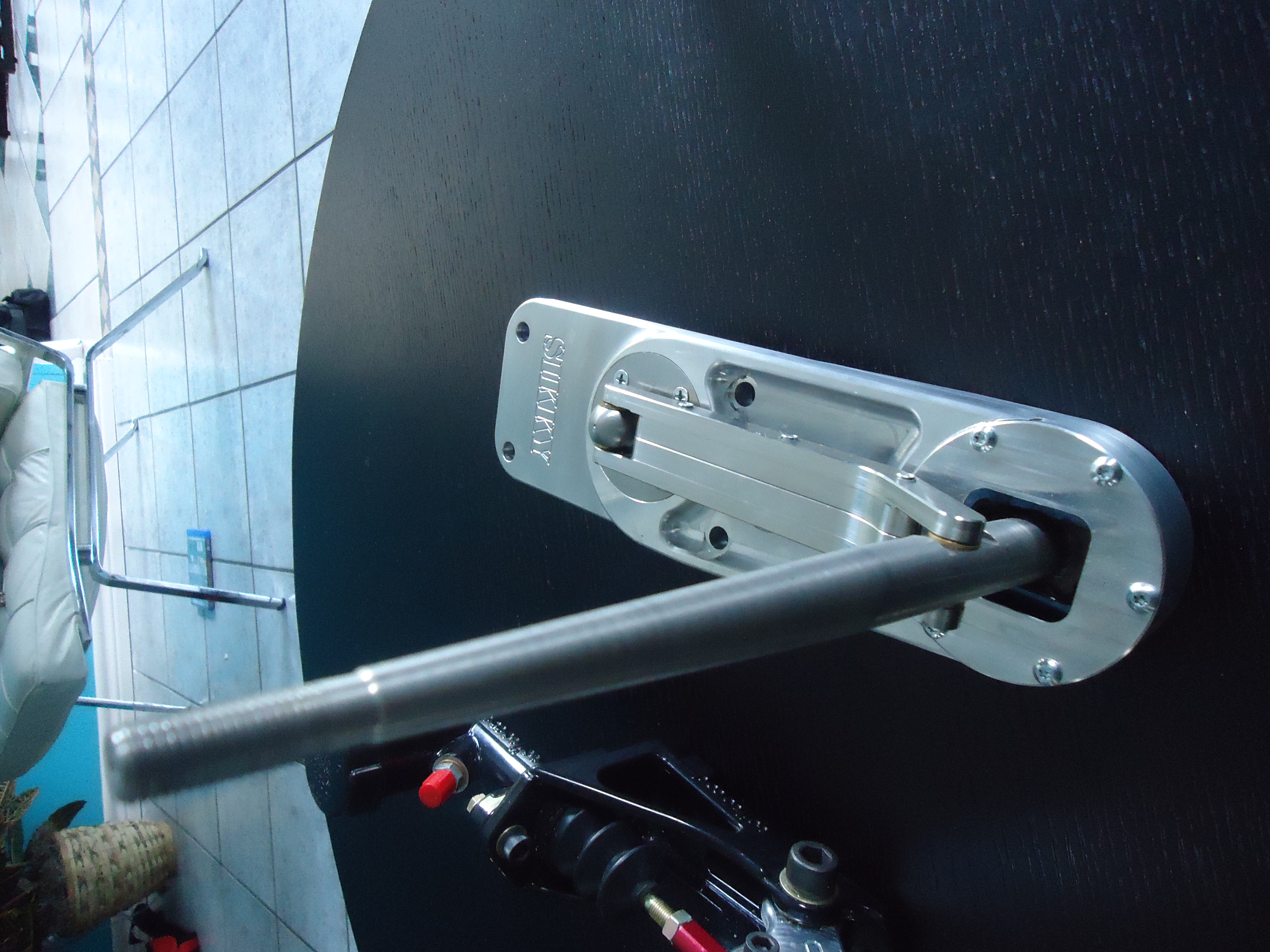

Now I don't think I have posted up the Sikky Shifter yet, so here it is.

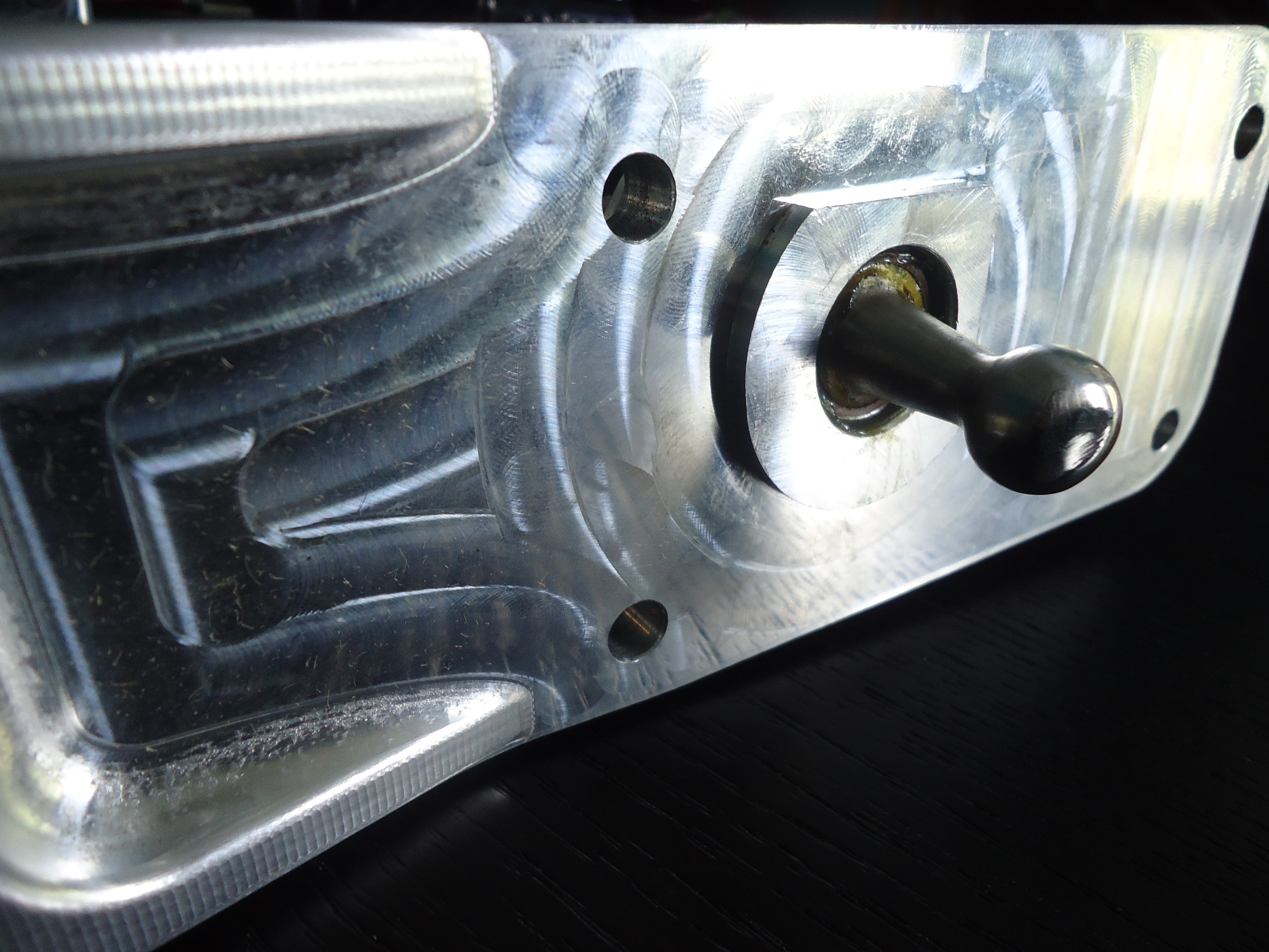

The quality on this thing is flawless in my opinion. I also love the fact that they made the thread work with Nissan 350z pattern.
The only down fall to this shifter is that they made it to work with all GTO T56 transmissions. Which causes some problems for guys running Camaro T56s. It tends to pop out of gear due to the difference in shifter location on the transmission.. To solve this problem you will have to purchase the new guild plate from a GTO and also mod the mounting points to make it work with your application. At the moment they are working on the solution for this and I will be sure to update my blog when they do.
Other then that I think this thing looks sick...

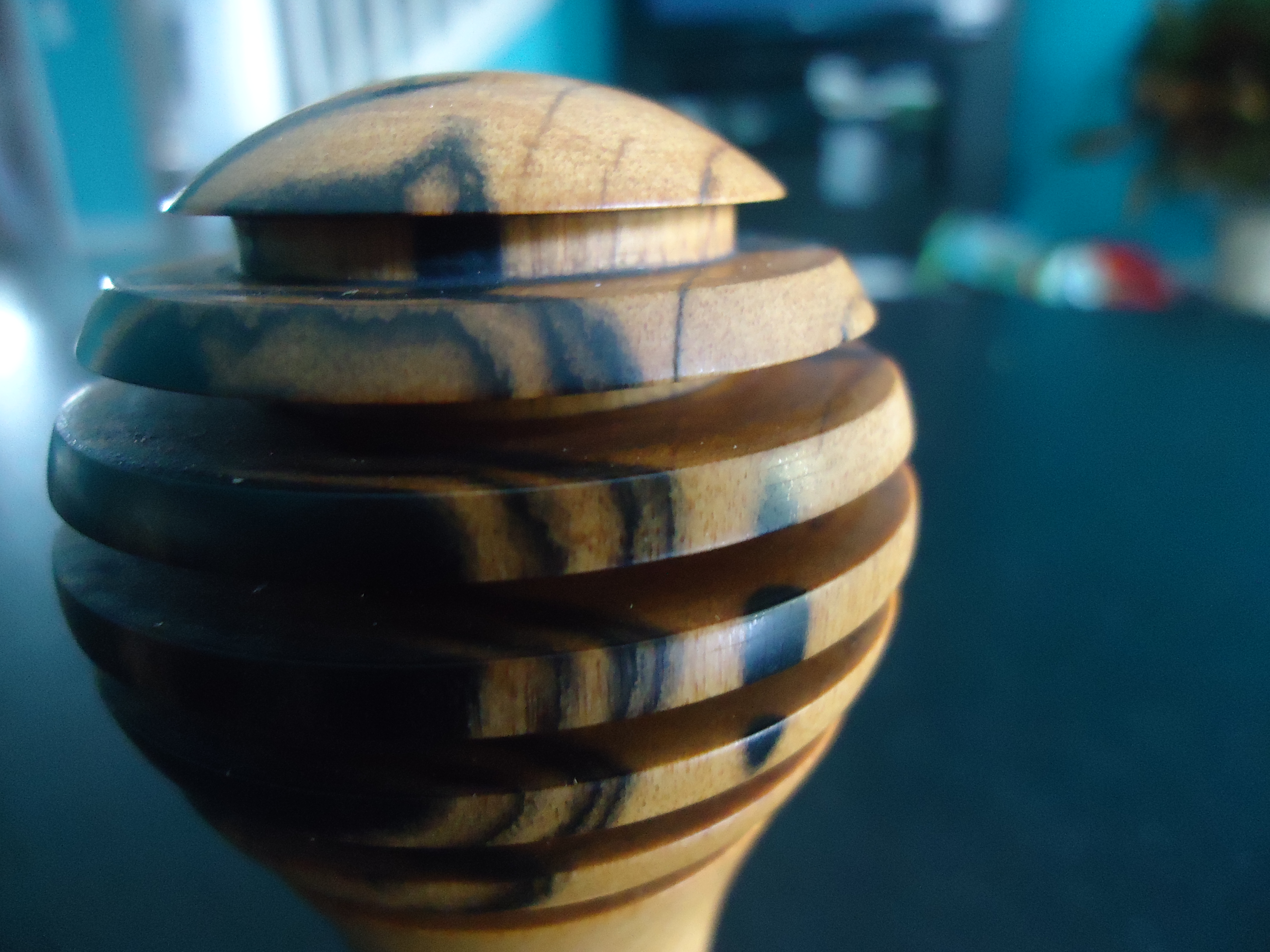

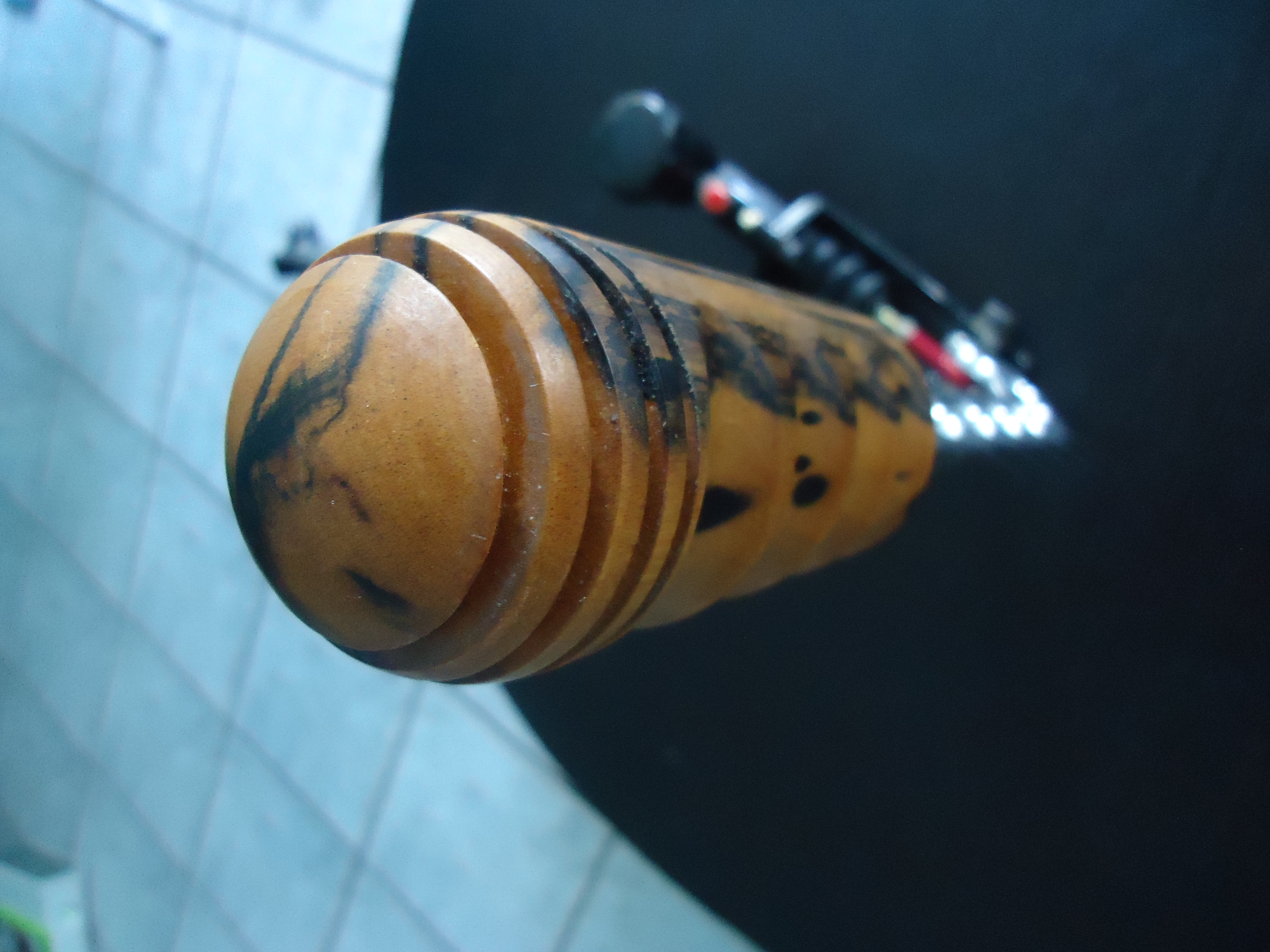

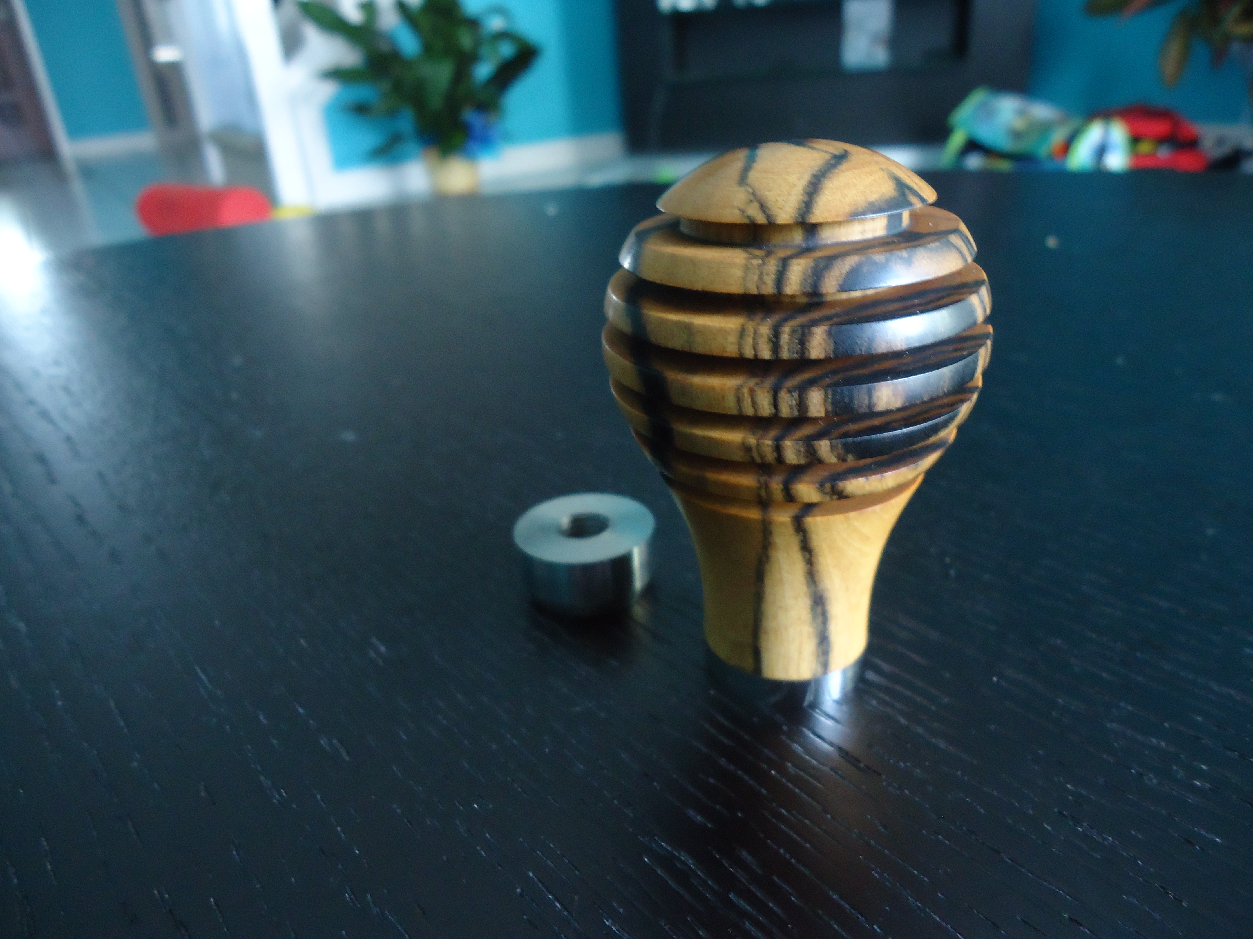

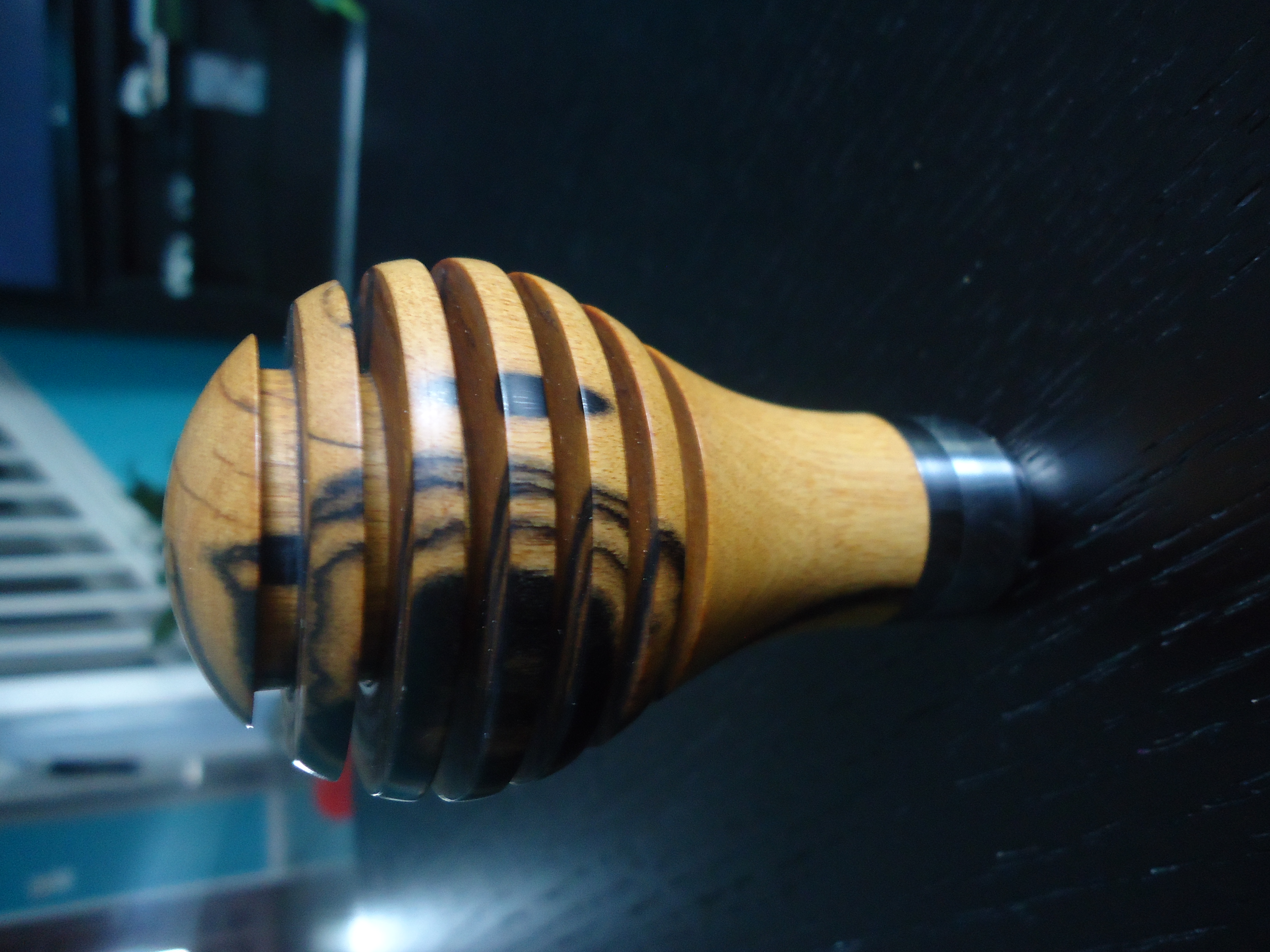

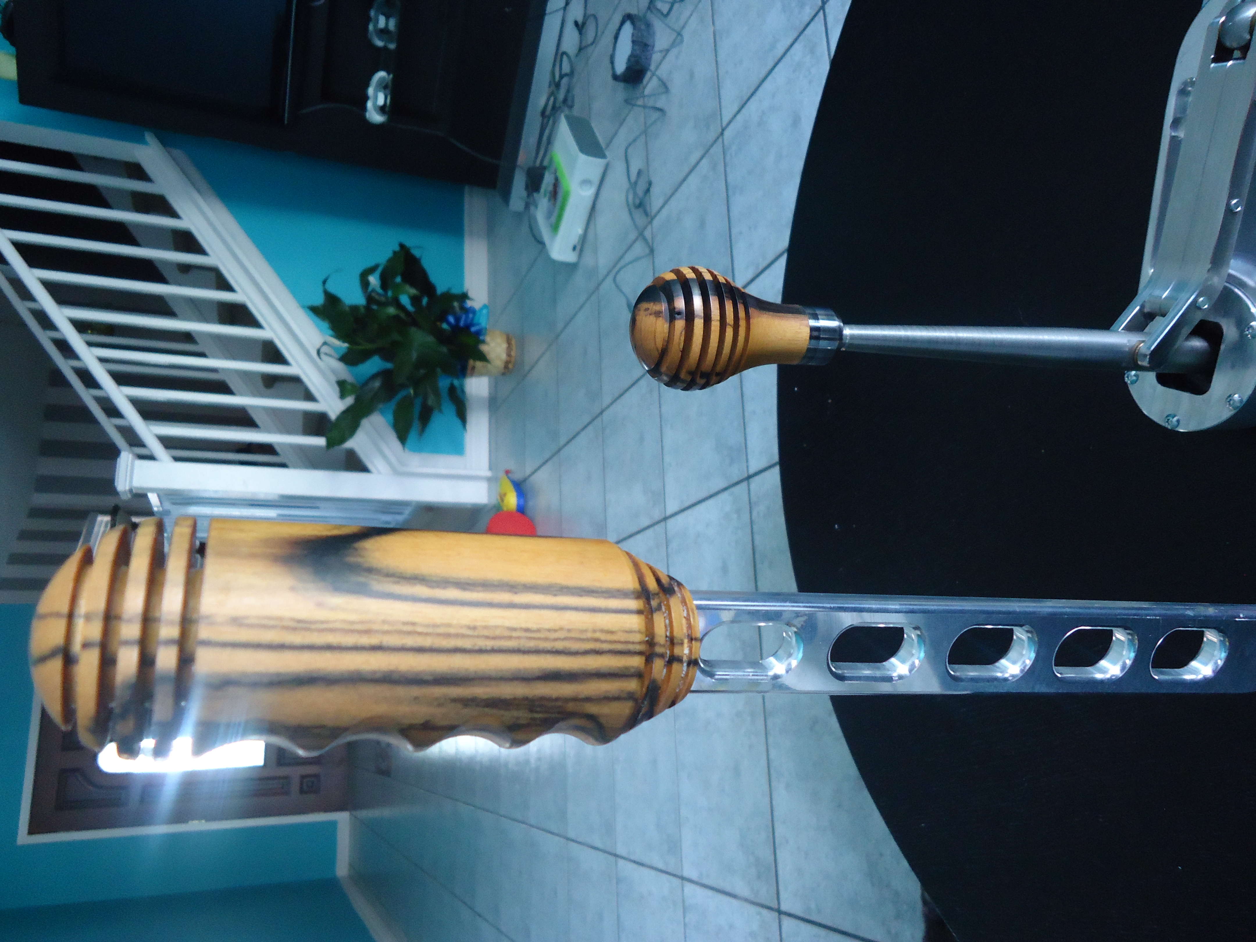

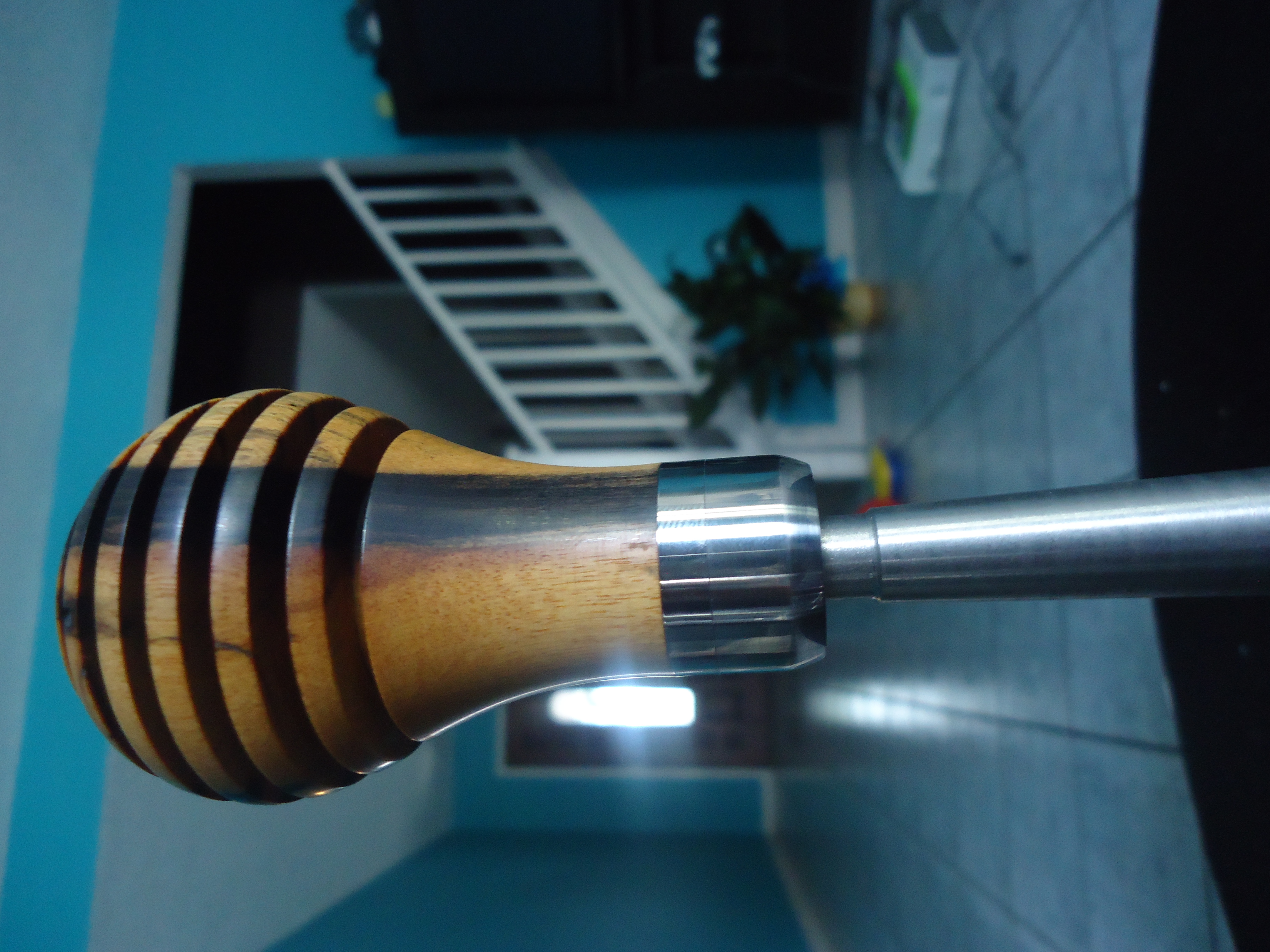

Next up is my new custom Ebony and Ivory wood shifter. Made by Andrew Martin. A work of Art this thing is, to me its the little things like this that make a car stand apart and the two pieces Andrew made me did just that in my opinion.
I mean look at the detail,,
Close up... So crazy to think something like this started from a block of wood.
Mounted on the shifter, it just looks like it belongs there.
No words...

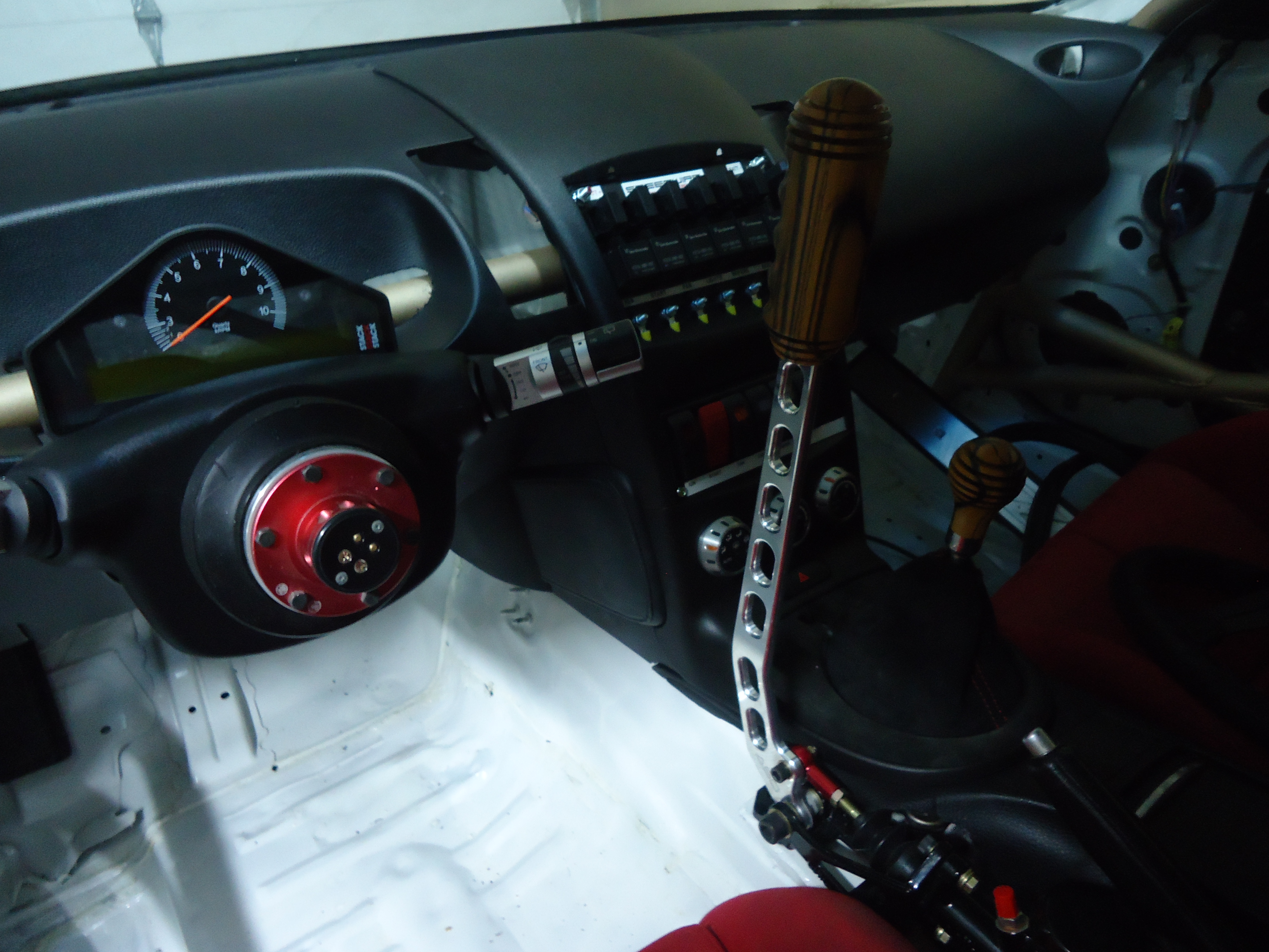

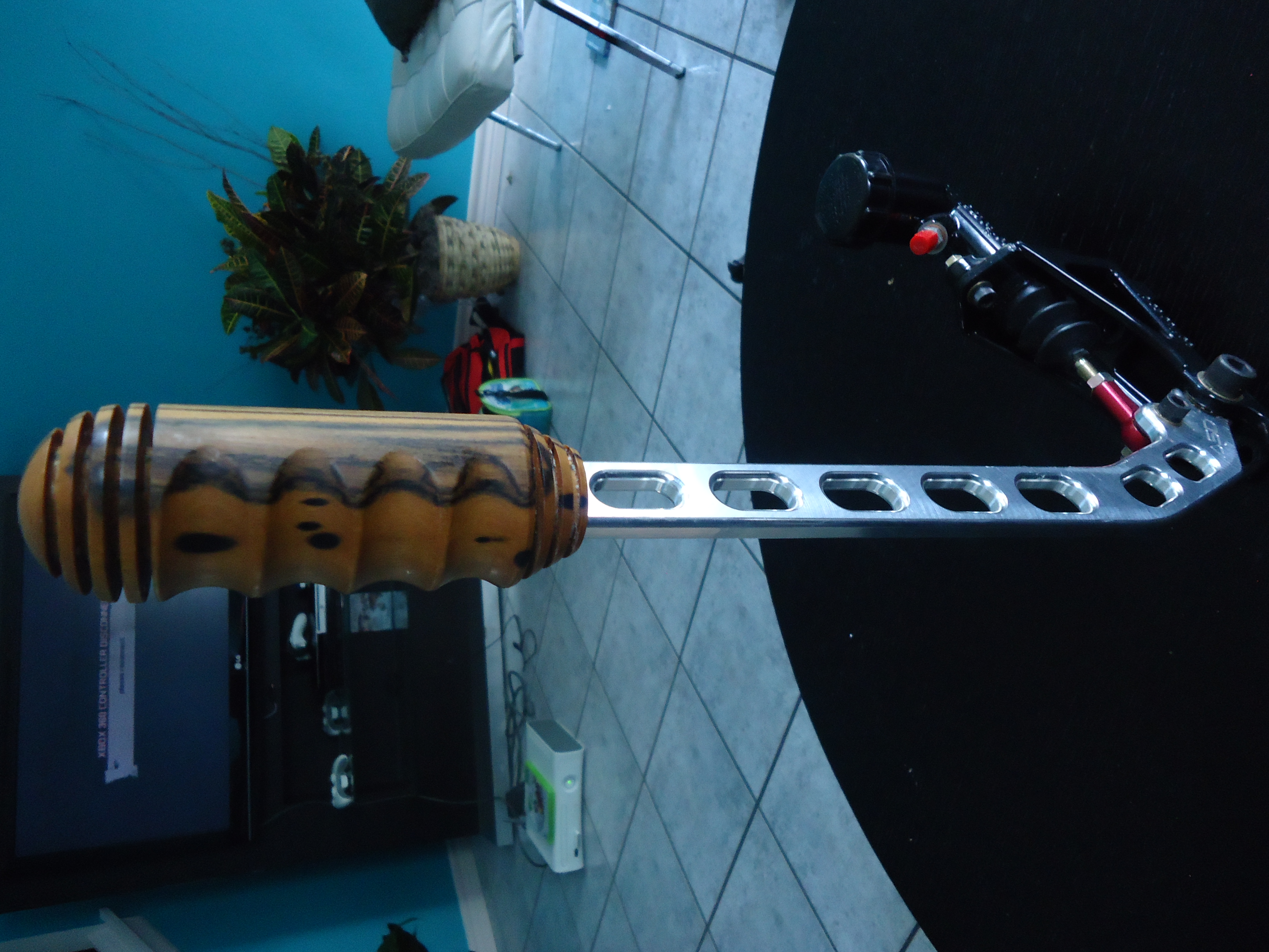

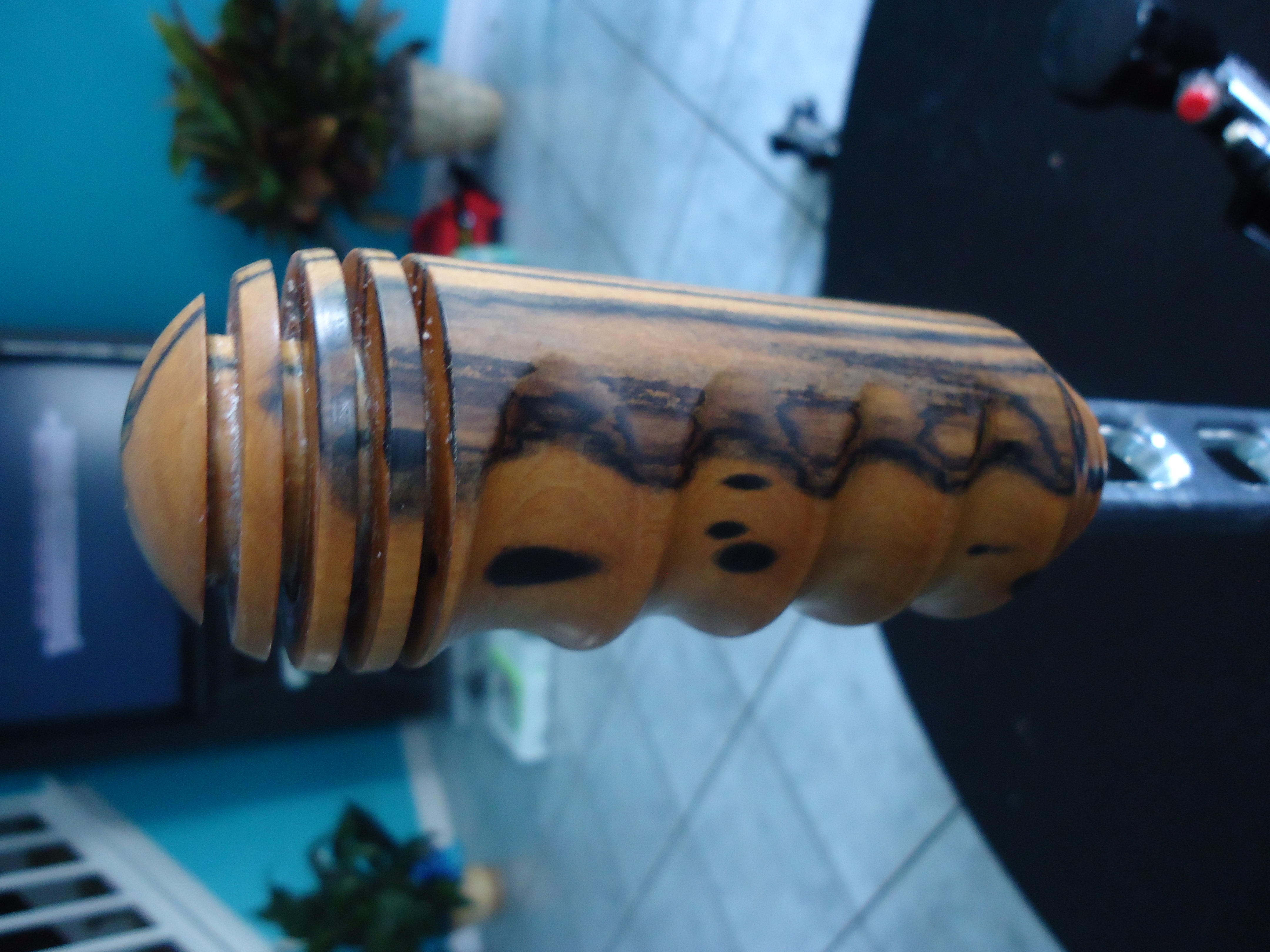

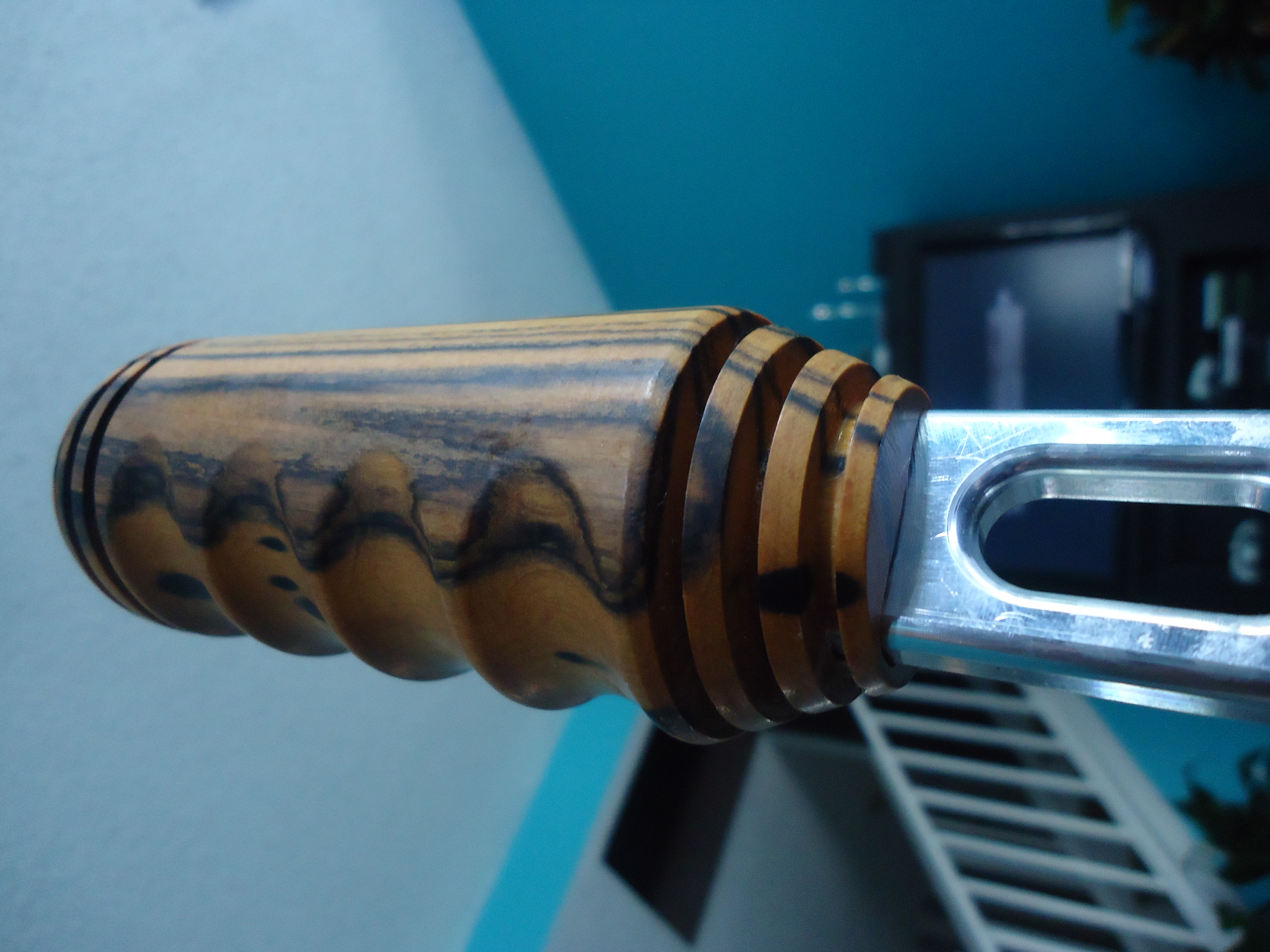

Next item Andrew made for me was my Hydro grip. I wanted it to match my shifter so Ebony and Ivory wood was selected again.
And yet again Andrew out did his self with this damn thing...
I mean seriously look at this thing...

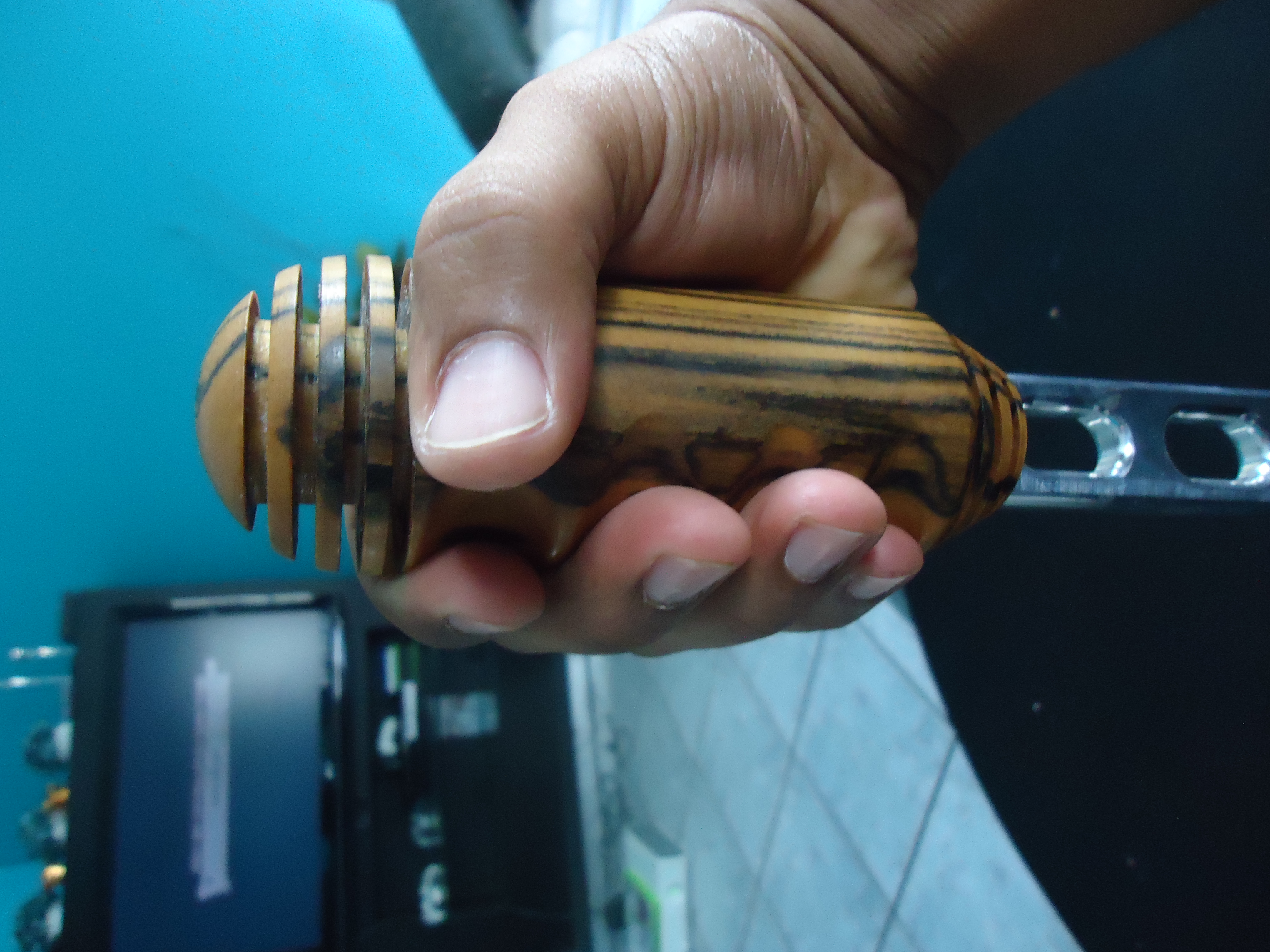

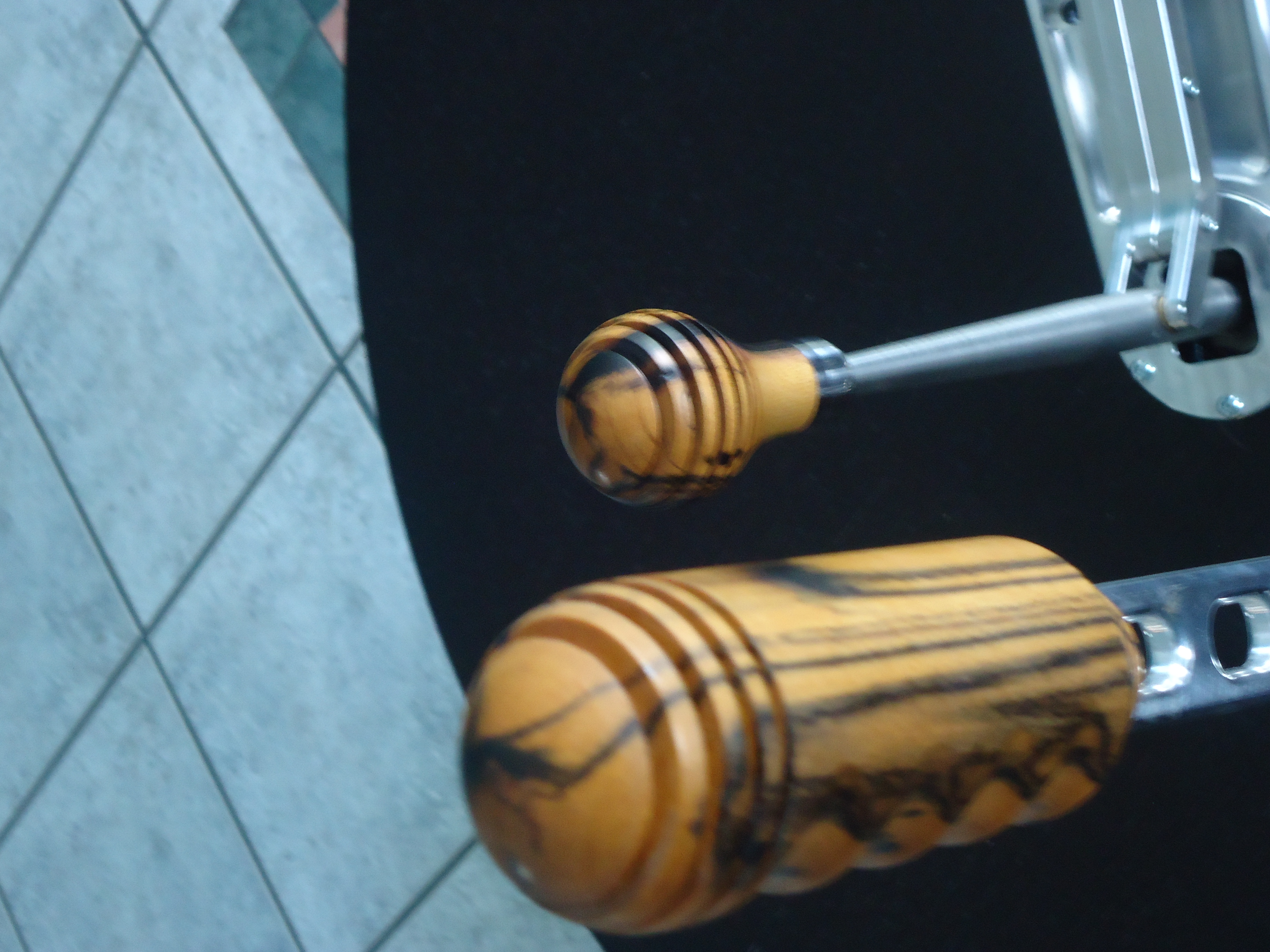

Here is a good pic to show you how big it really is. From pics it looks too big to grab but it fits my hands perfectly (that is what she said)... I know someone was thinking it....lol
Top view

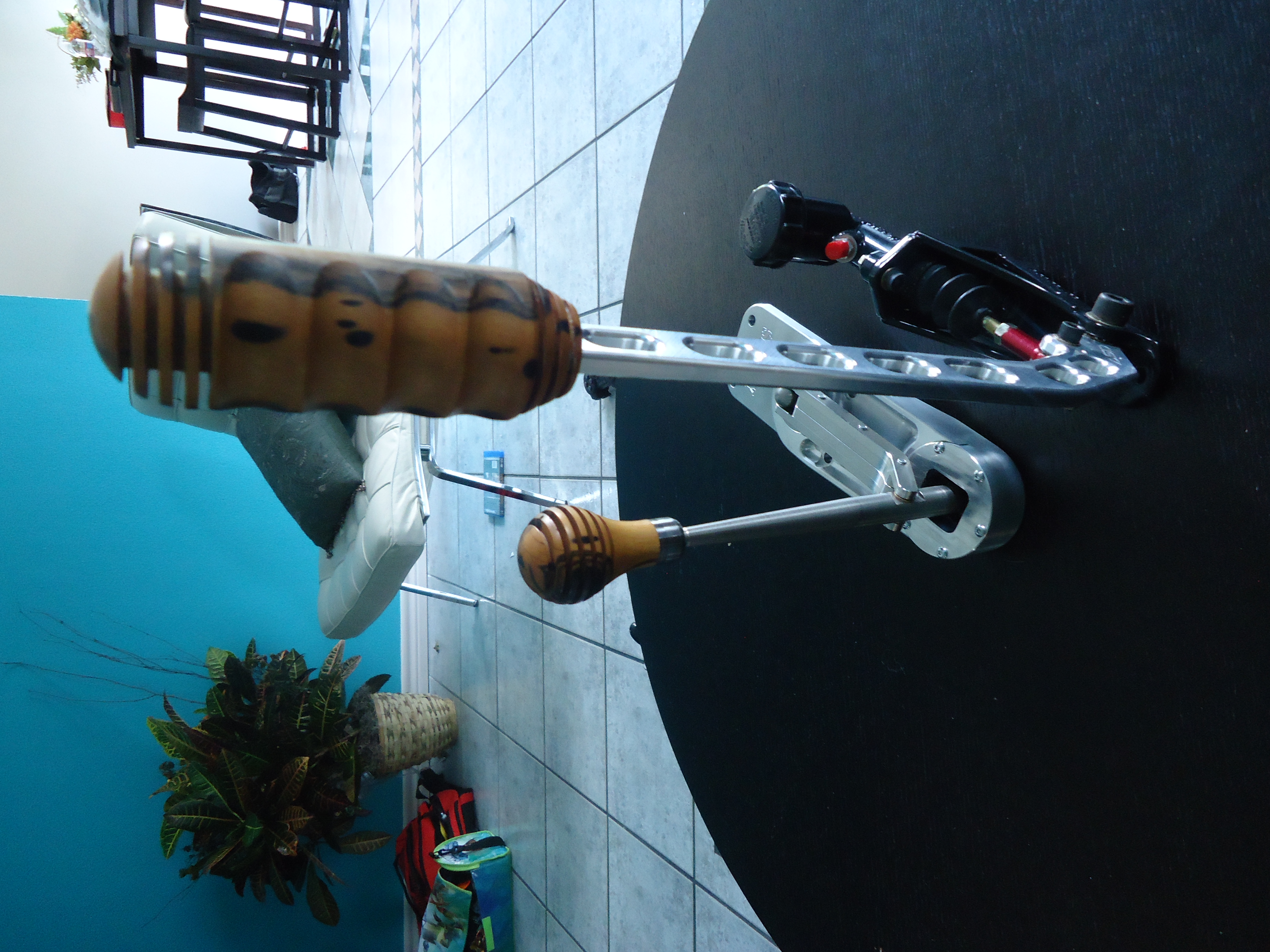

Side by side view of both
Perfect match up....

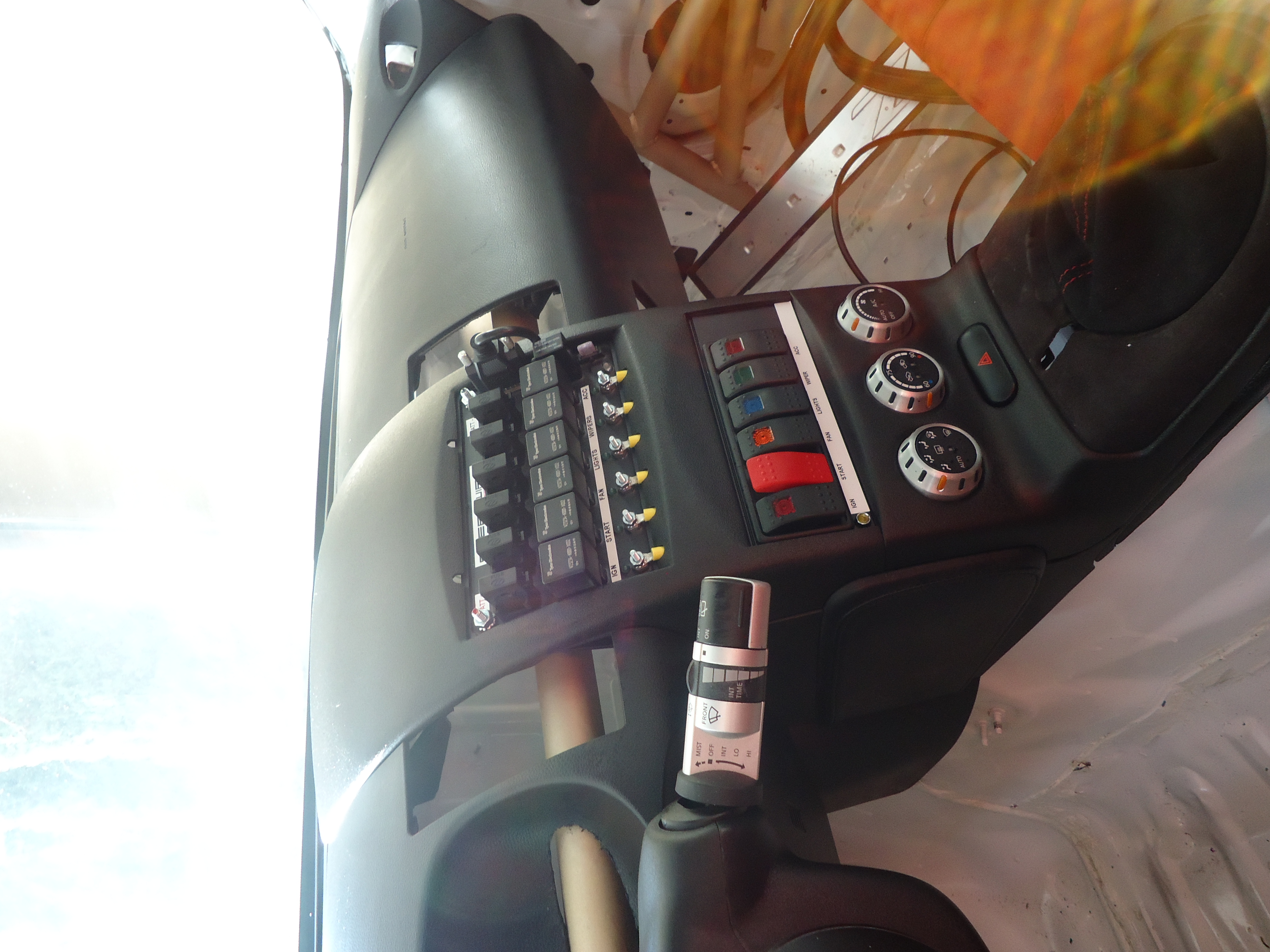

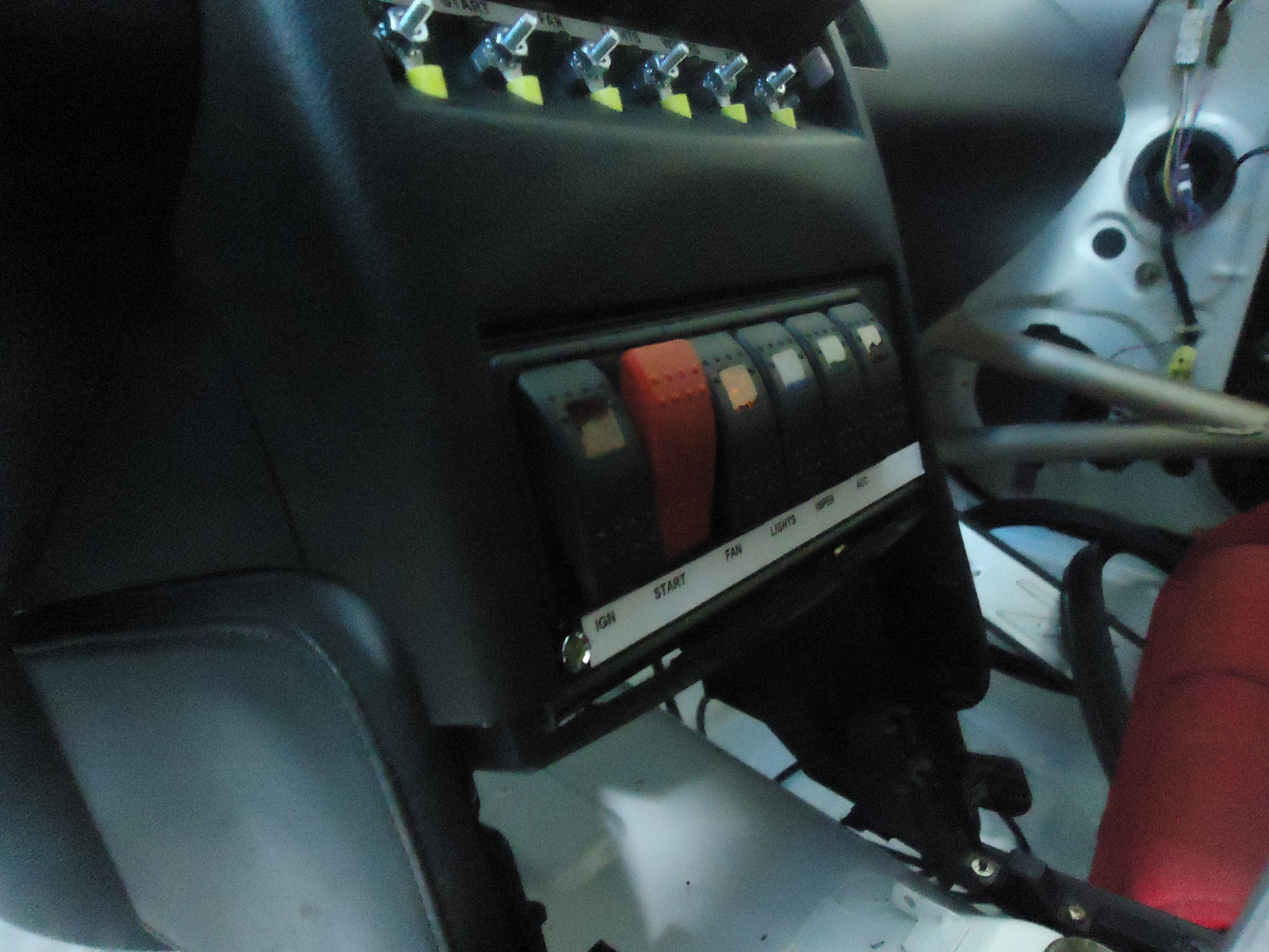

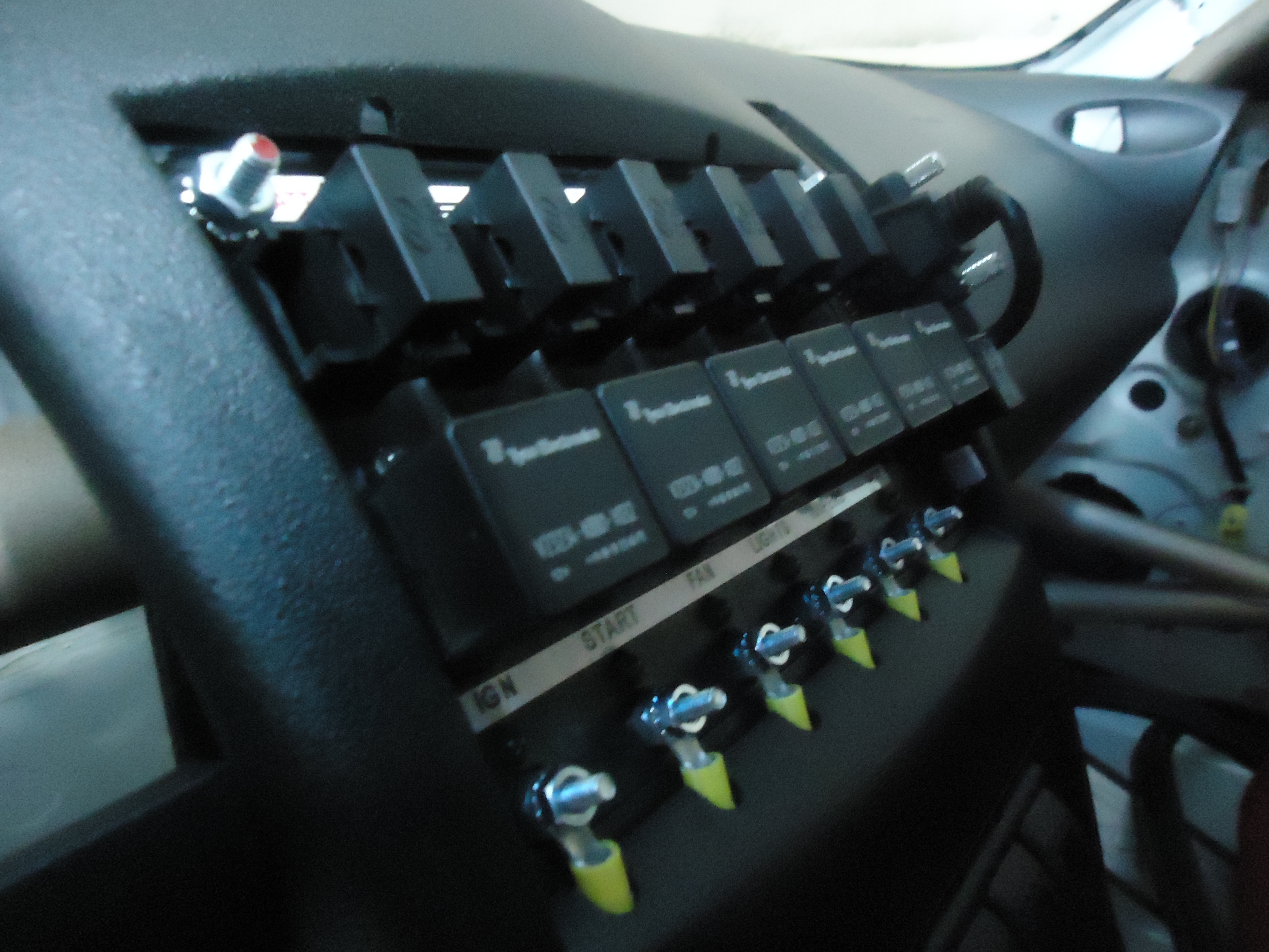

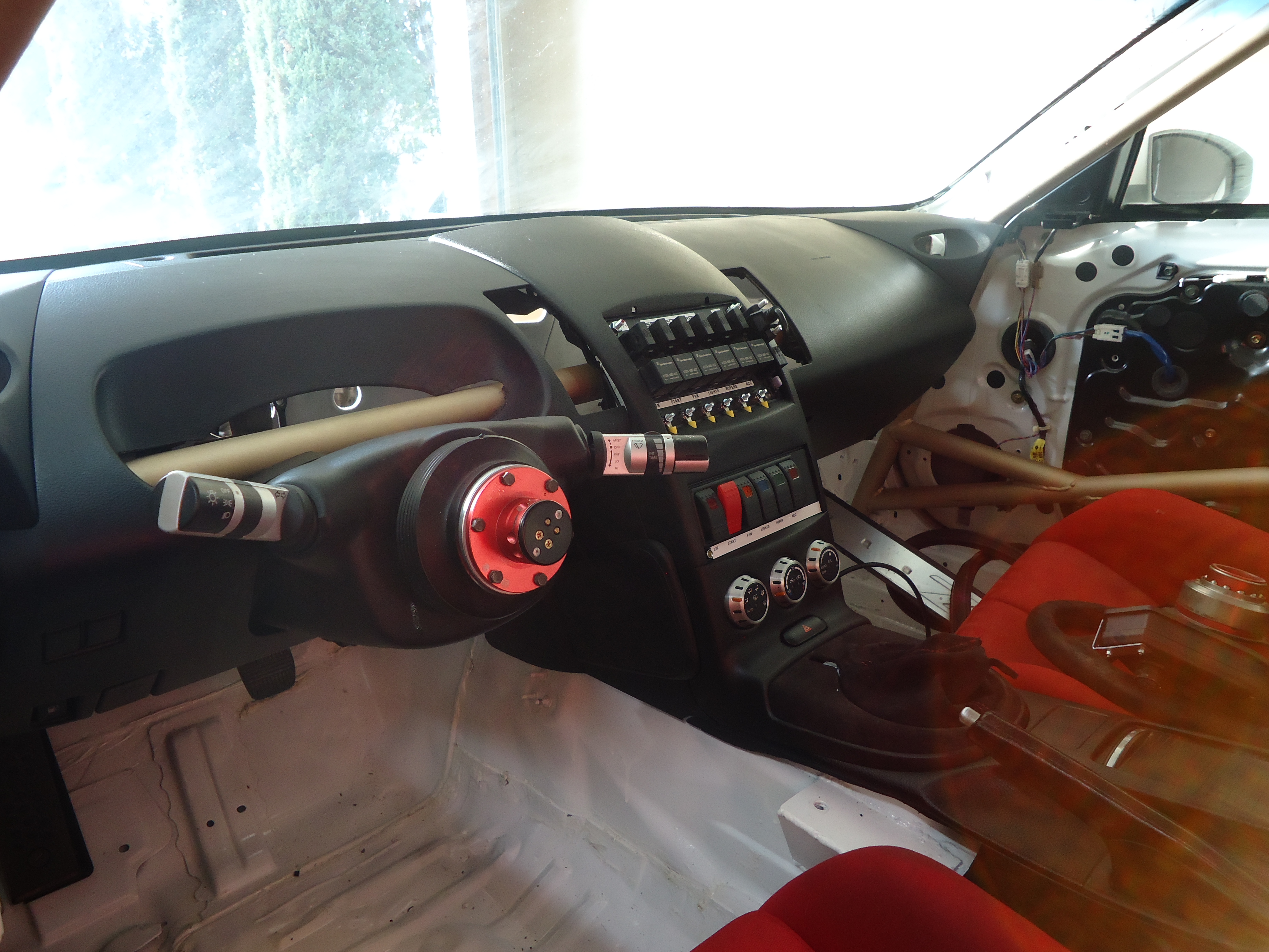

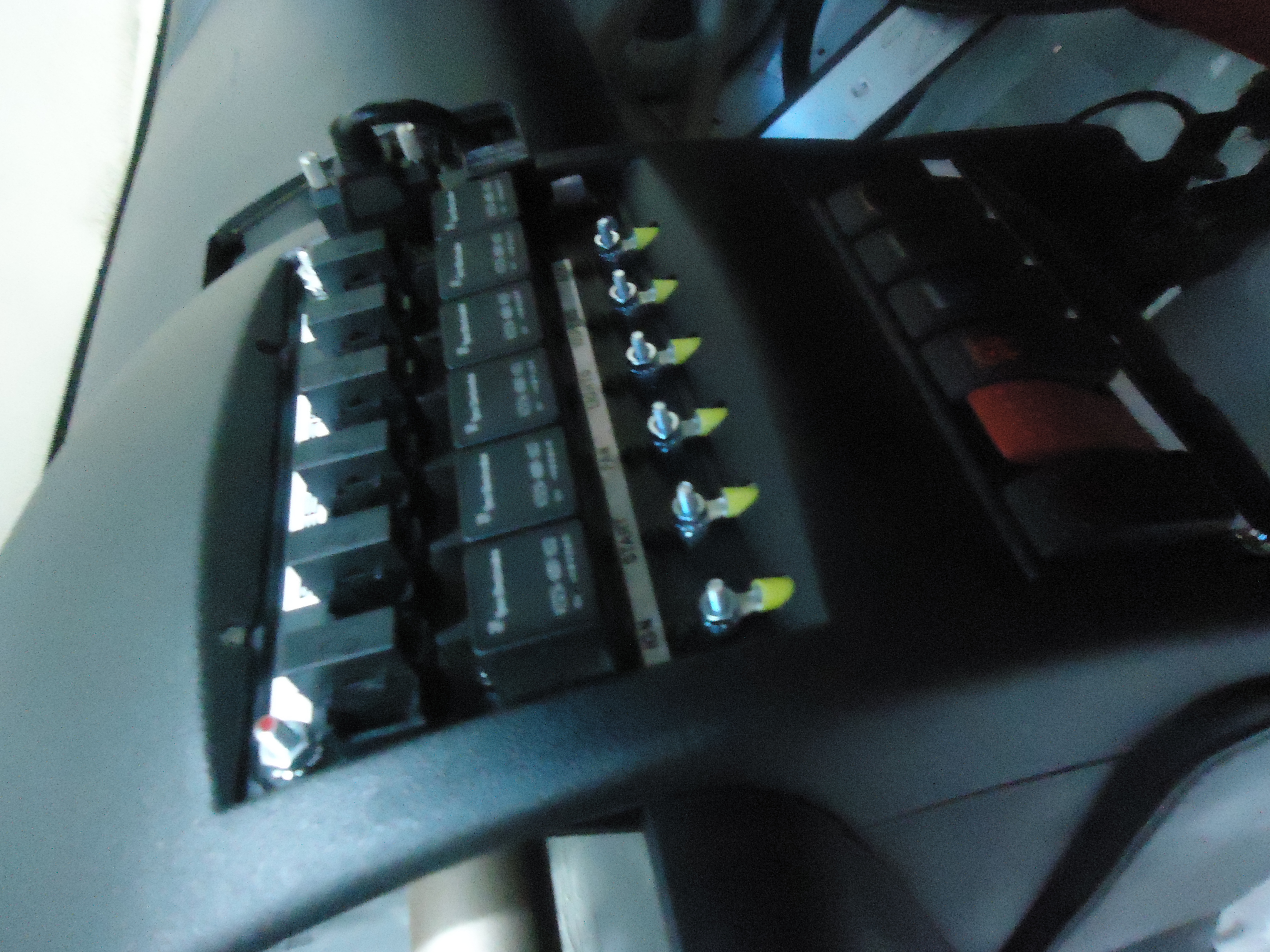

And the work that Tobby did on my dash just completed and complemented the look I was trying to go for. Clean and simple.
Tobby in my opinion makes nothing but art when it comes to his dash work. He takes on each piece like its his own and I for one can really appreciate that.
So thanks Tobby for making something I will use day end and day out..

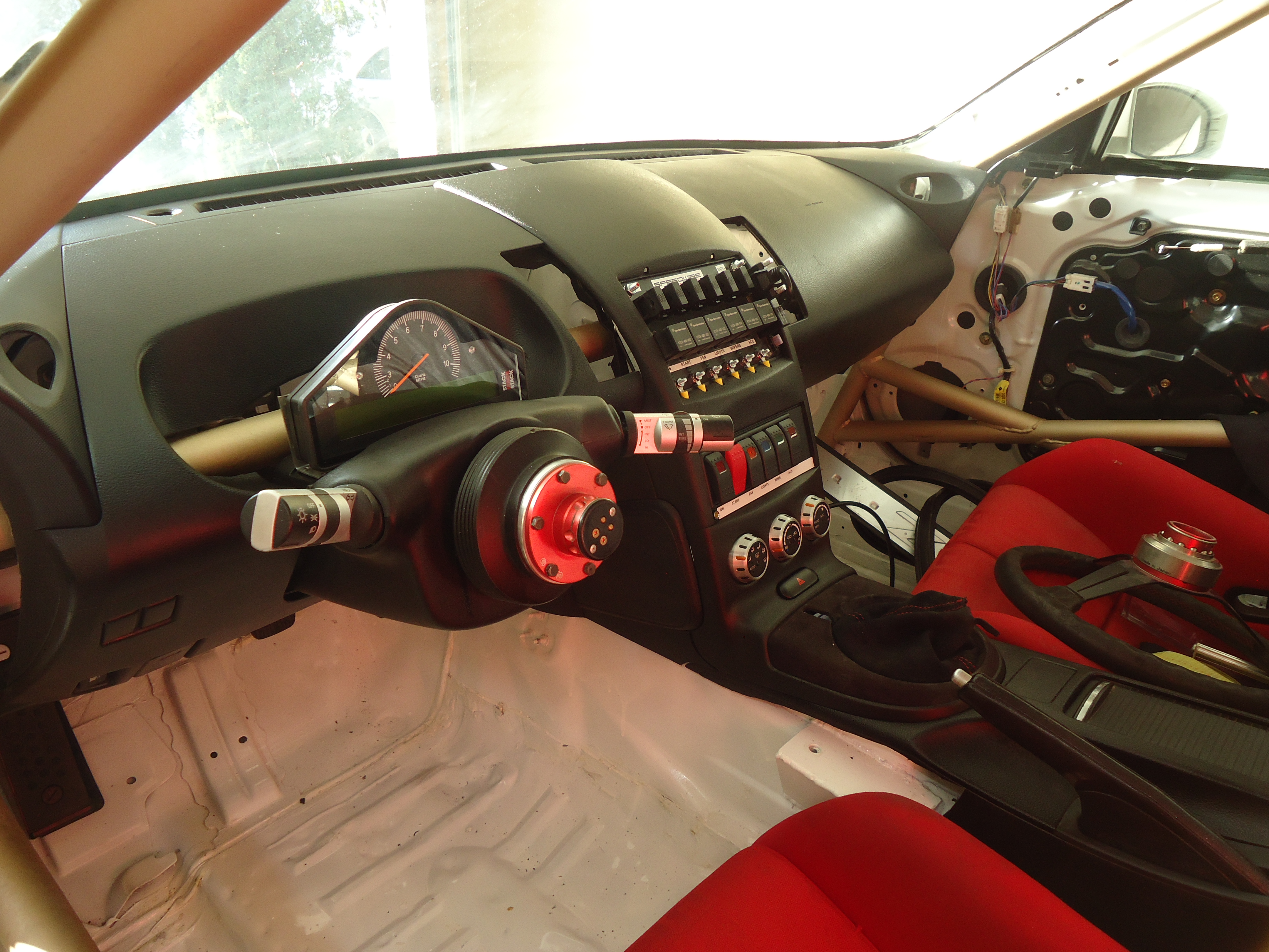

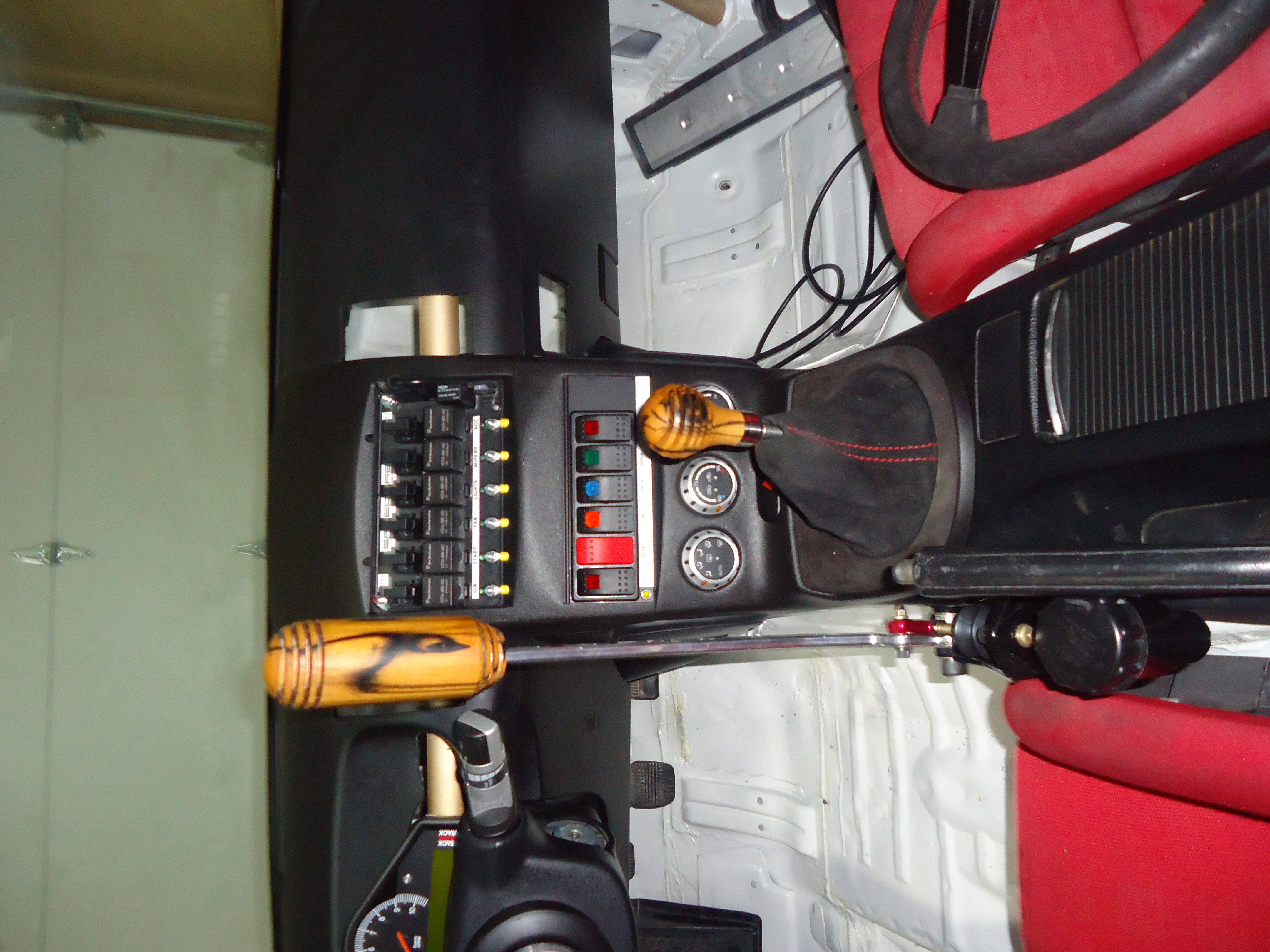

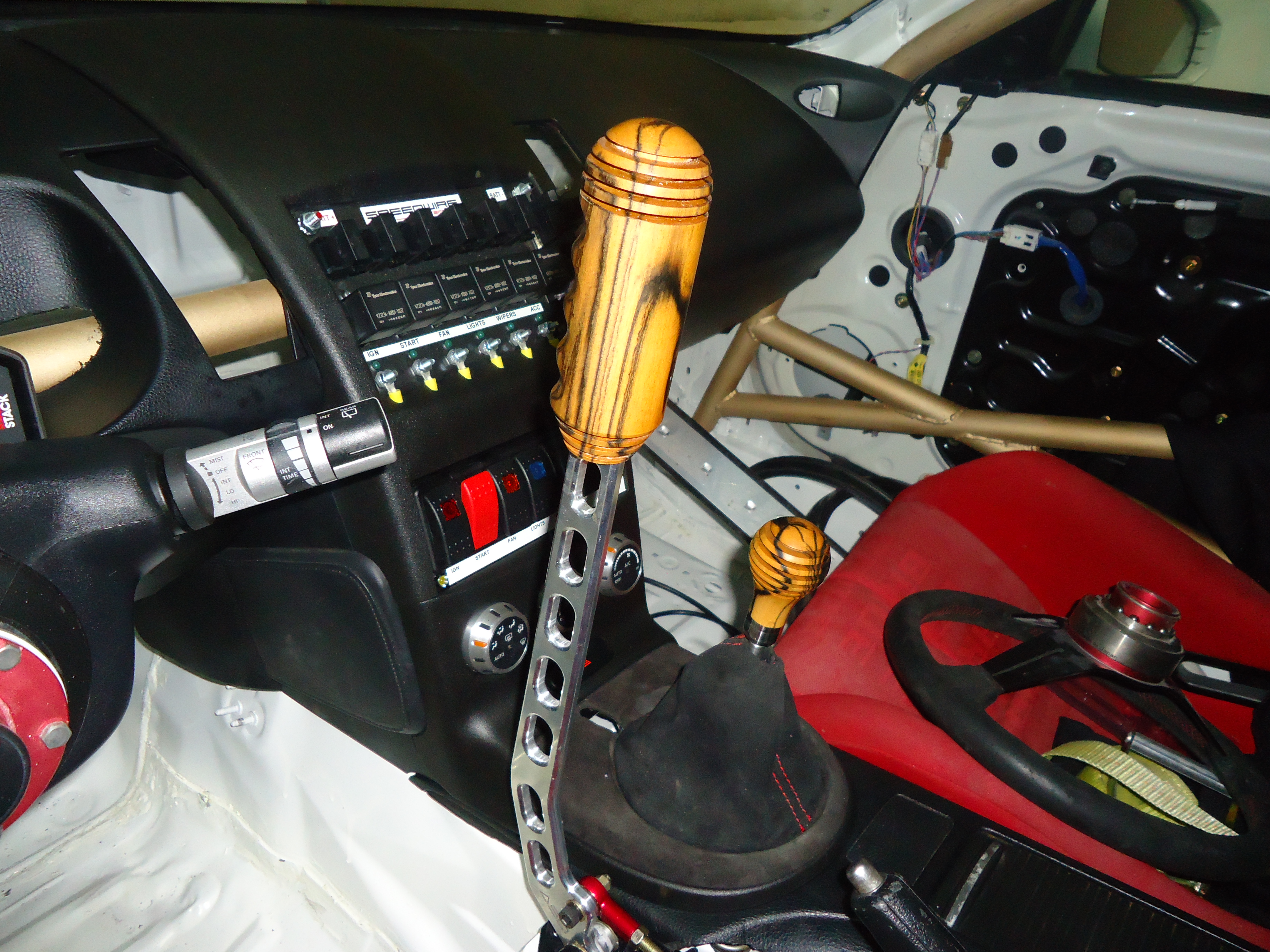

Here is a striaght on pic with my hydro and shifter mocked up... Looks good
So before I can call the interior done, I have to do a few things like: re-wrap my shifter cover and fix the whole that I have there now. Which was used for my old CNC hydro. And also clean up all the edges I cut to fit the dash or and center console

I had to have my aftermarket endlinks machined to make them slightly smaller (shorter) to keep the Cusco front sway from hitting the oil pan. Not sure how your stance will sit, but you may want to keep an eye on it.

^^^ I think I might have to machine mine as well. It is way to close now and its not even on the ground.
