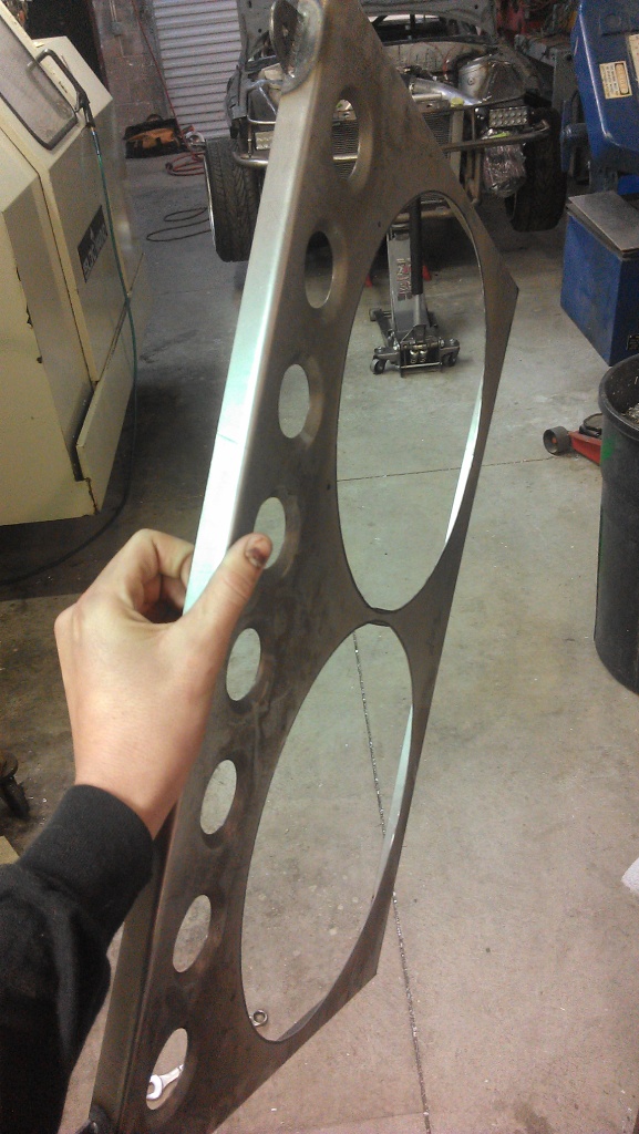

So a little progress on the Stack housings and my Fan Shroud that Blake is making..
Started by cutting the Fiber glass fabric needed for the mold.. Then it was go time to glass..
After the glassing session I removed the foam molding and BAM!!! you have your self a nice fiber glass Stack housing.. Still have to do a ton of sanding to make it look nice, then add some bondo and sand a ton more again. But you get the idea..
Blake has been working hard on his build as well as doing my fan shroud and other goodies I have coming.. So thanks again buddy. Here is his build thread.http://www.stanceworks.com/forums/sh...ad.php?t=18371

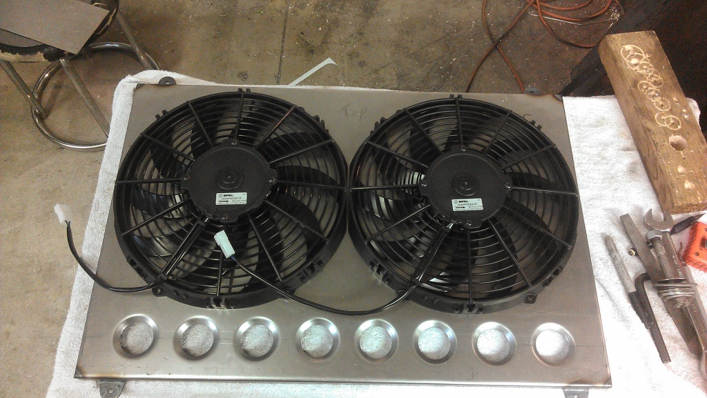

I am using two Spal 12" thin fans.. do to my space that is what I decided to run..

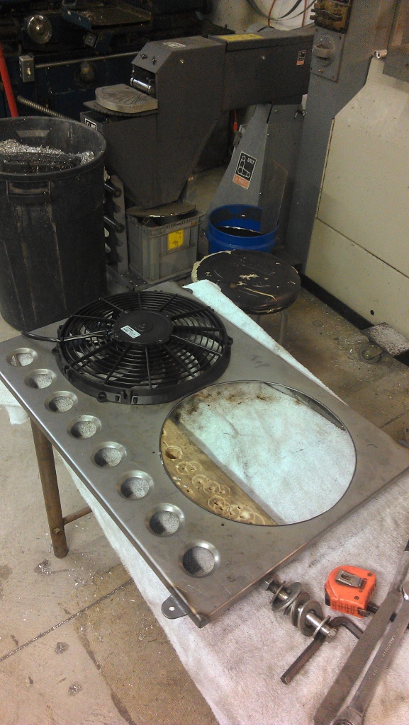

Holes cut

Nice update but why the same holes in the shroud? Wont that defeat the whole purpose of a shroud?
And have fun with the cluster. Bondo and sanding work sucks buy I'm sure it will b baller.

Added the gussets to the fan shroud to lighten and stiffen it.. And cause it looks badass
