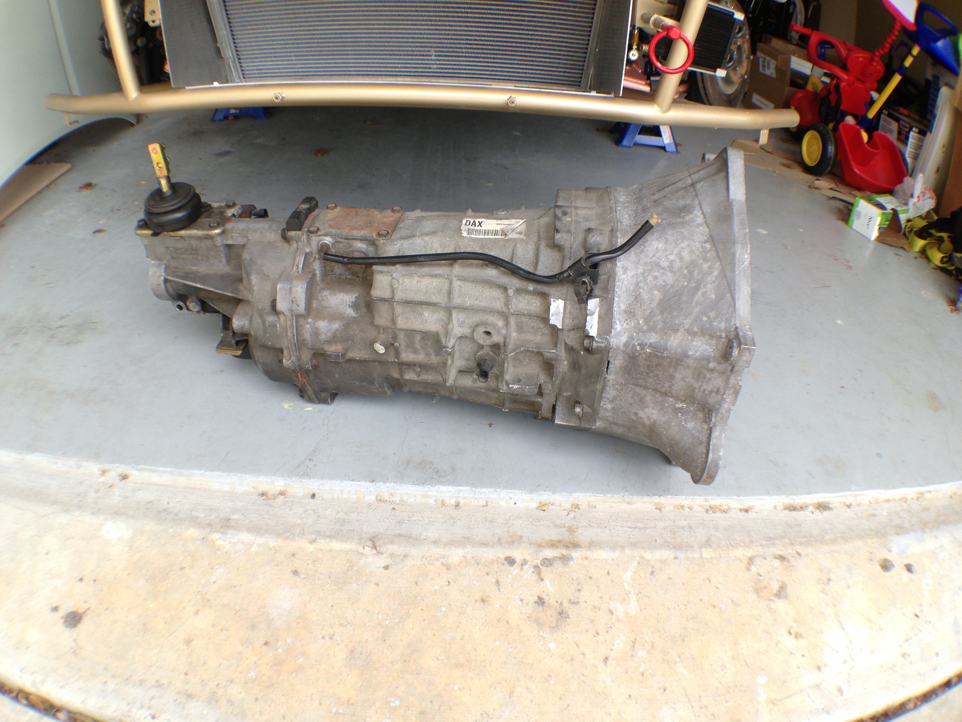

I begin this update with a little trip to Houston to pick up my built T56 tranny. Got all the good ready for the trip for me and the lil man.
I acquired the transmission from my good friend Evan. He owns D3 Performance Engineering and they do so sick work.. Only the best, they were the ones that tuned the Hennessy lotus. So needless to say they will be the ones that tune my car.

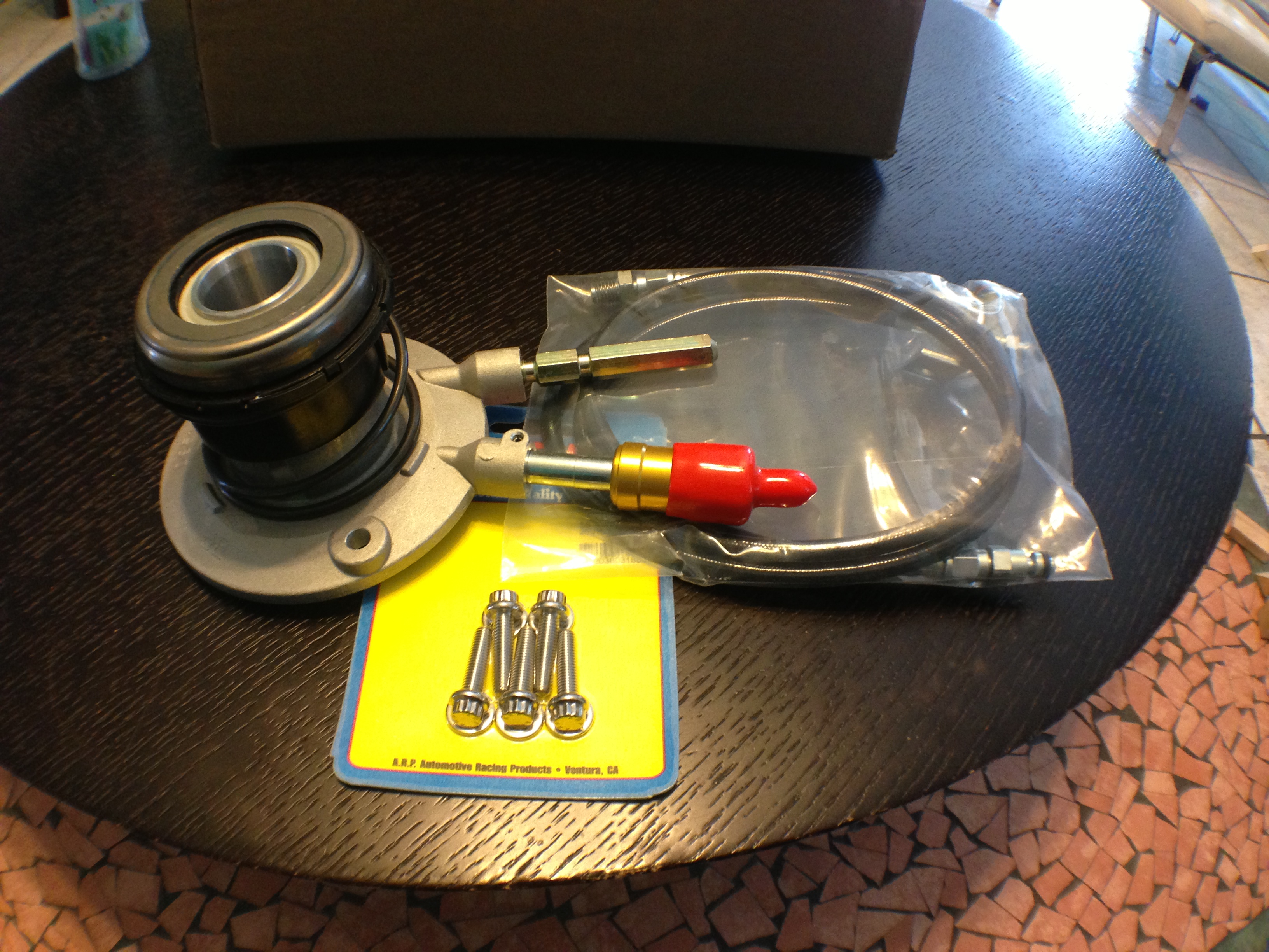

I also purchased some goodies for the T56. Monster Clutch was a no brainier and they were well helpful when deciding which clutch to go with.
I went with there 11" clutch with pressure plate and light weight flywheel package.

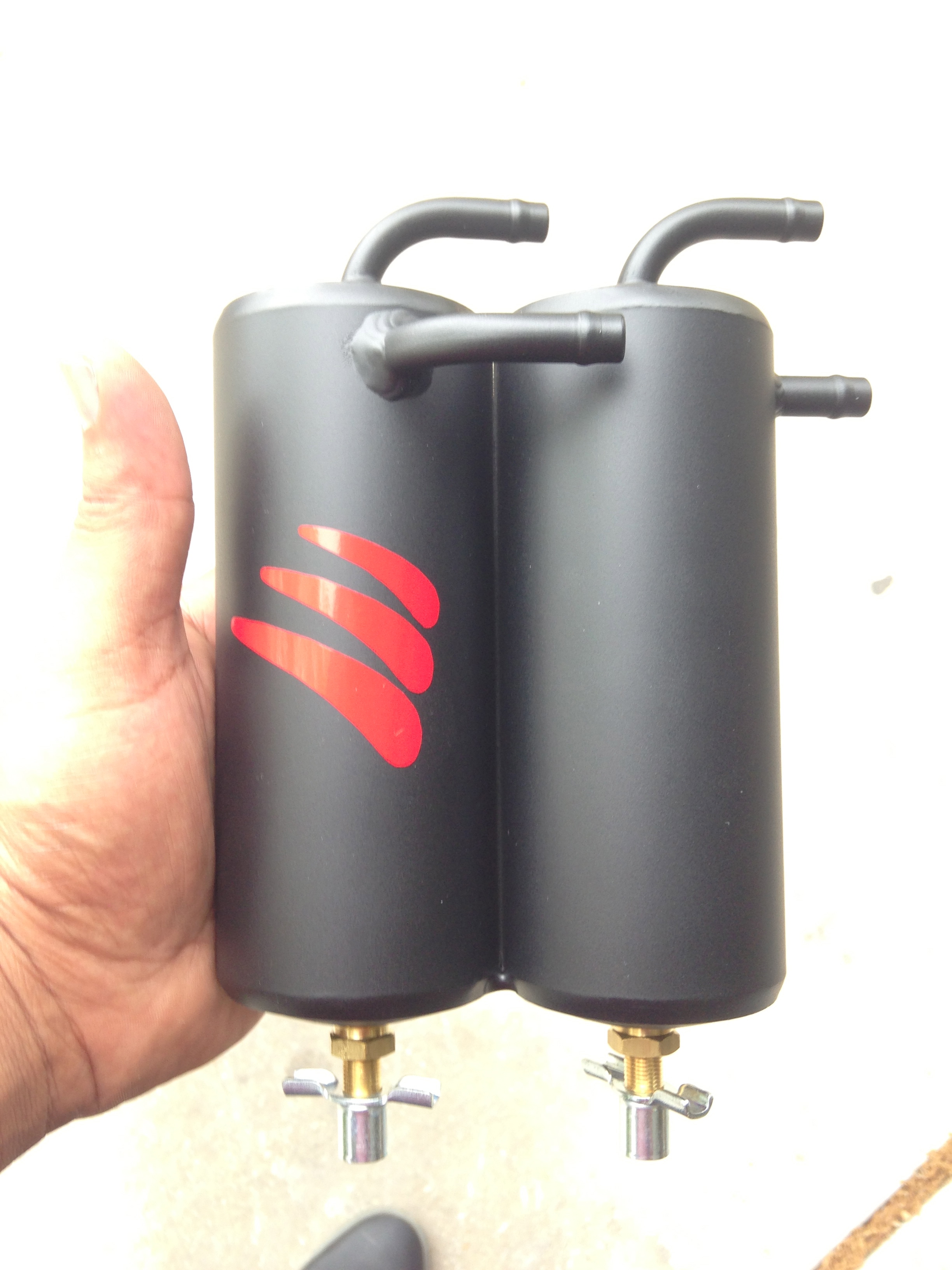

Also picked up my Saiko Michi Dual Catch can..
Love the look of this thing

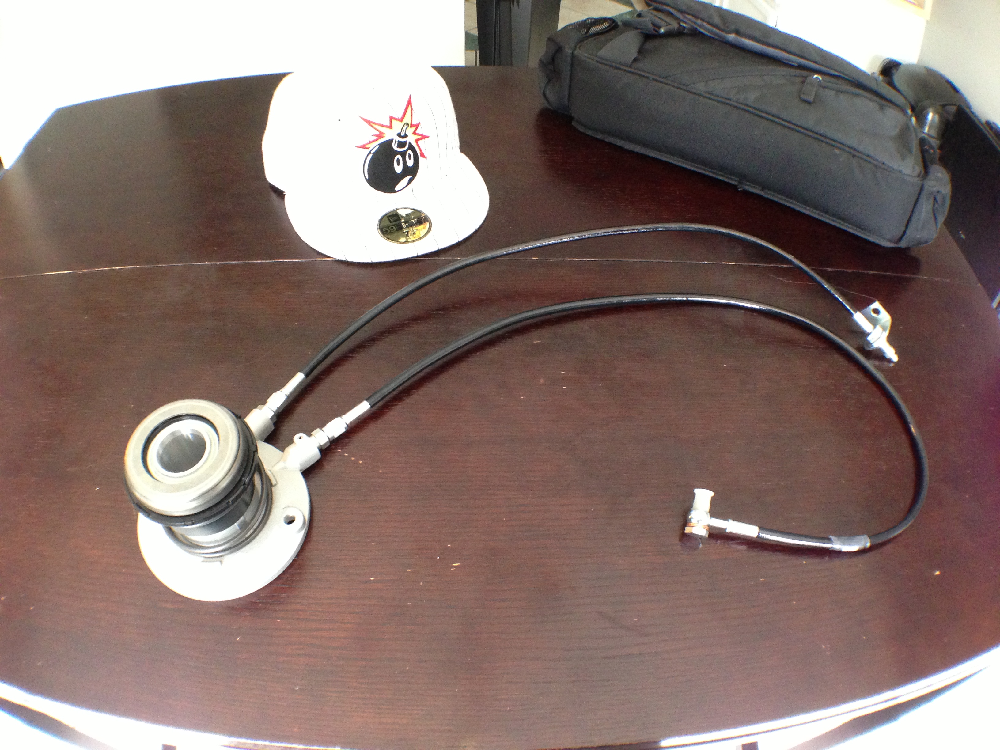

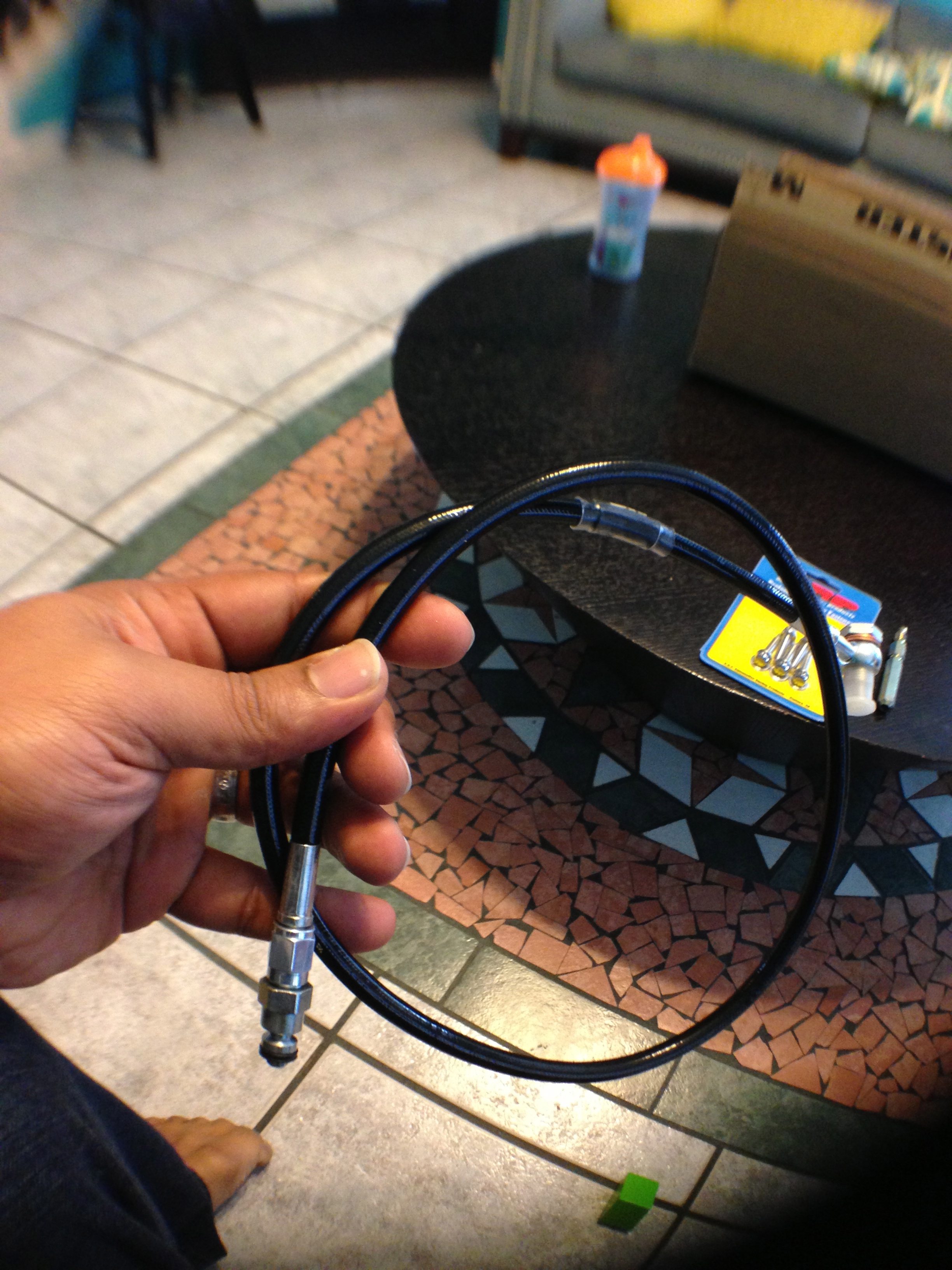

Okay lets start some installs.. I picked up a new Slave Cylinder. and a backup you never know.
But first I have to switch out the lines for my Chase Bays lines..
yup undo this....
removed
new bleeder line about to get installed
I think thats about right

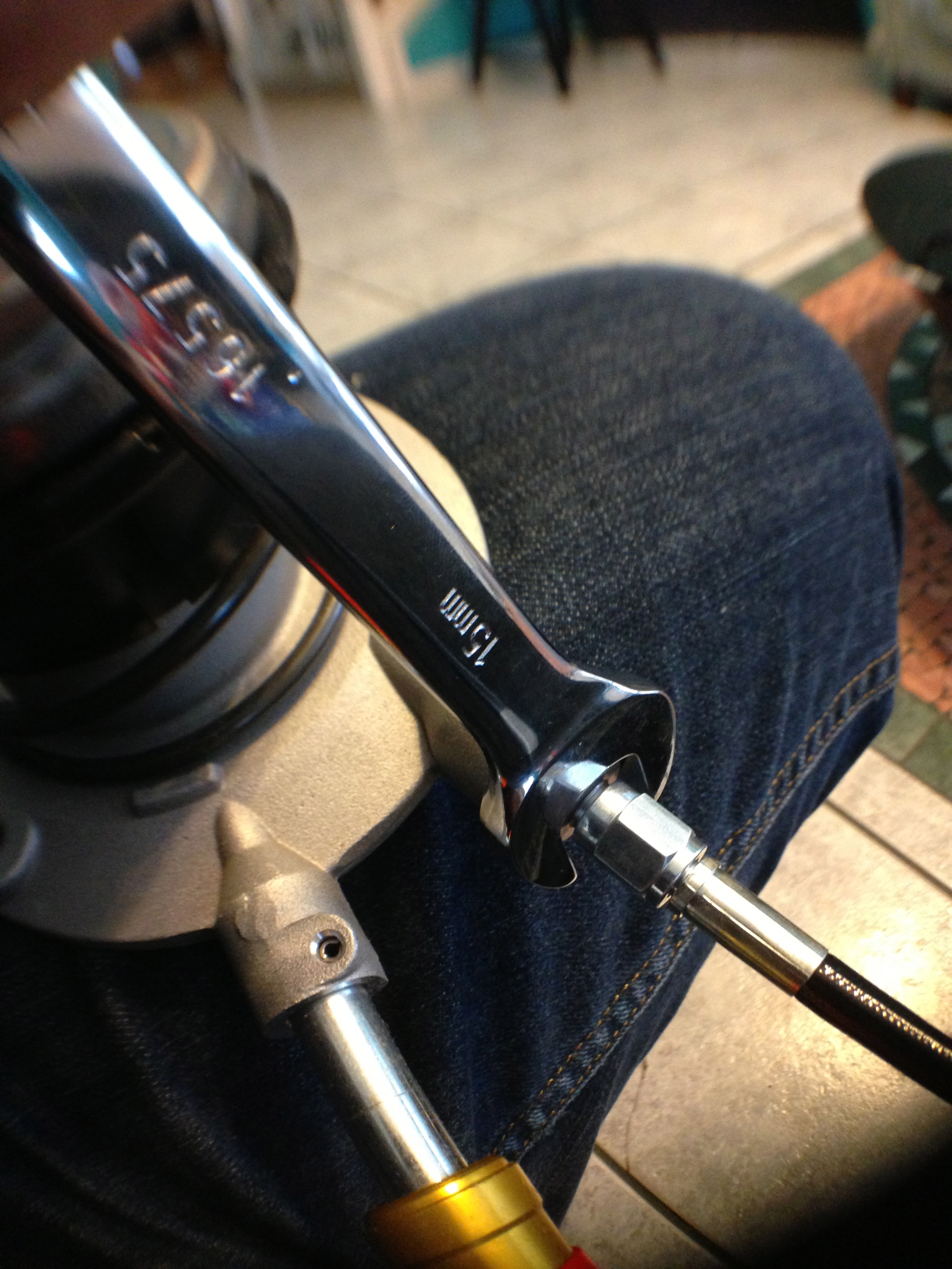

Tighten that **** up with some 15mm

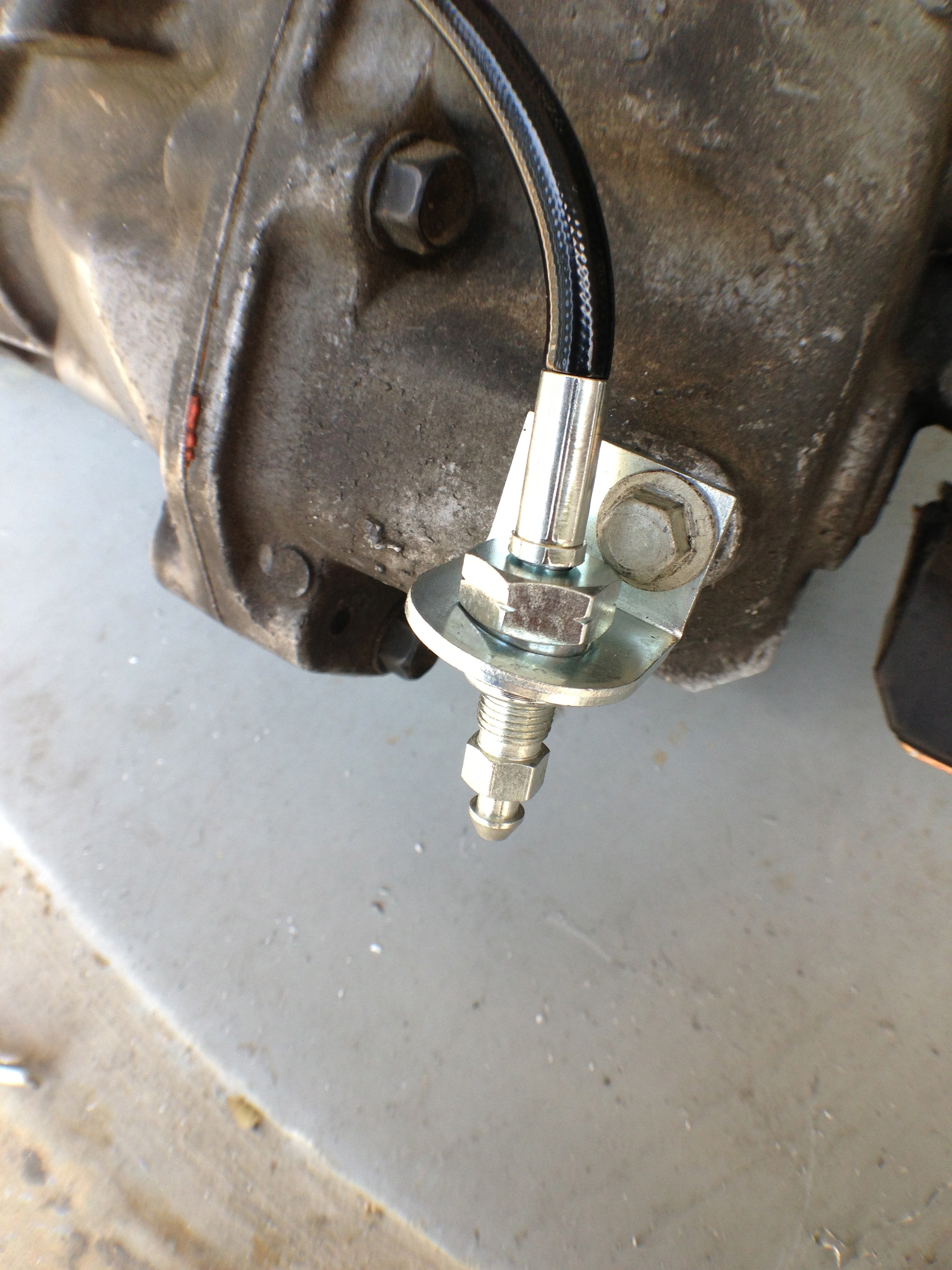

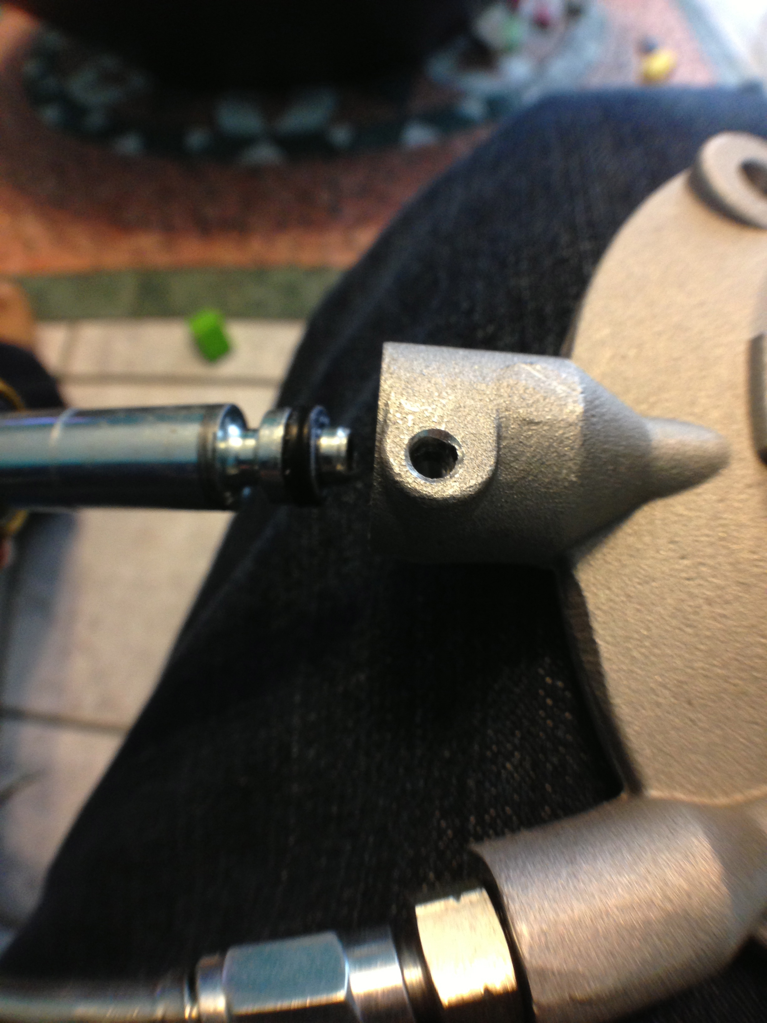

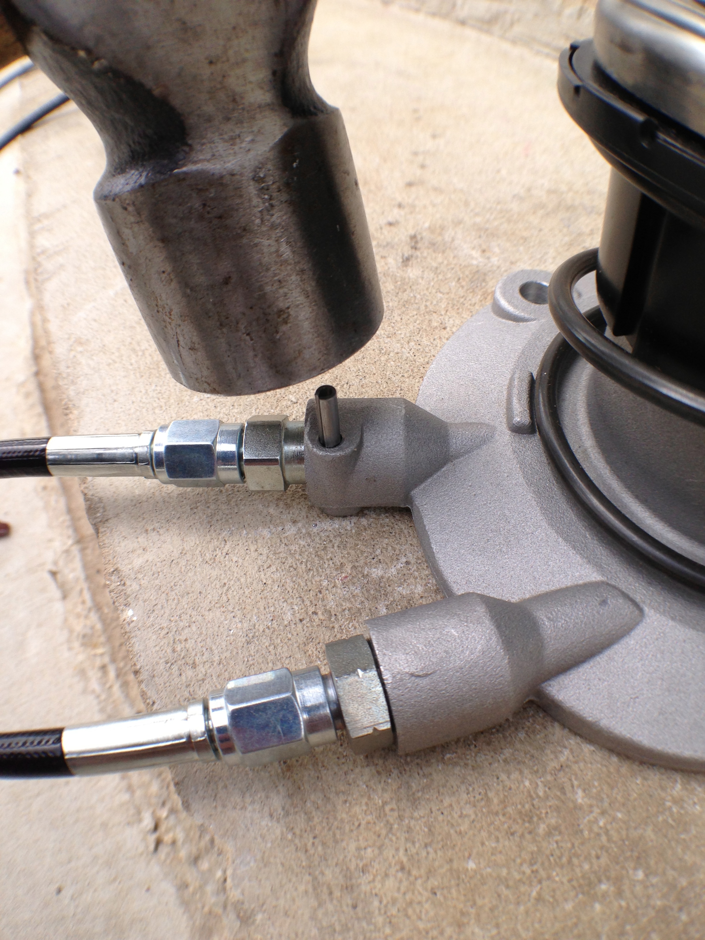

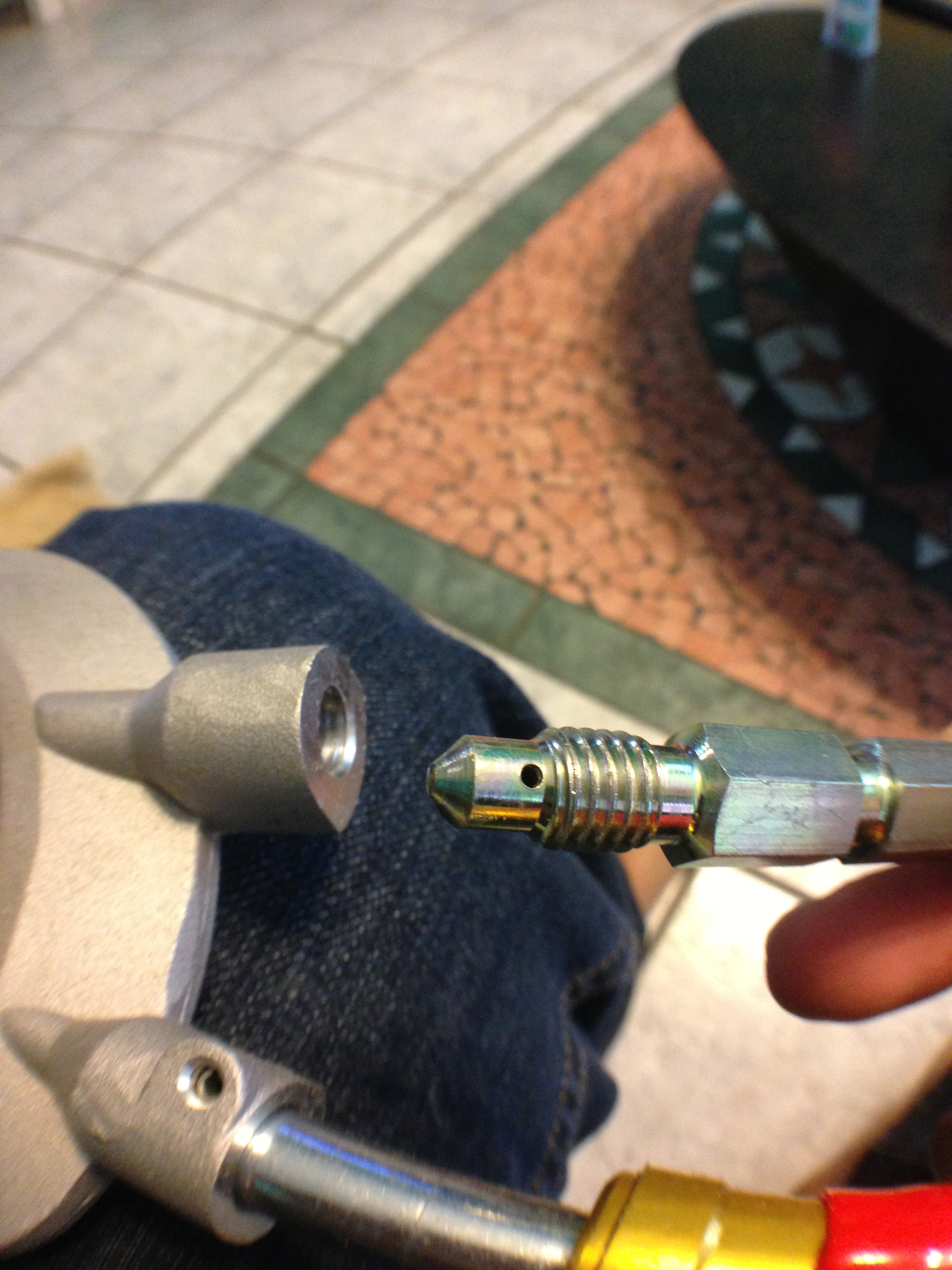

Next is the clutch line itself

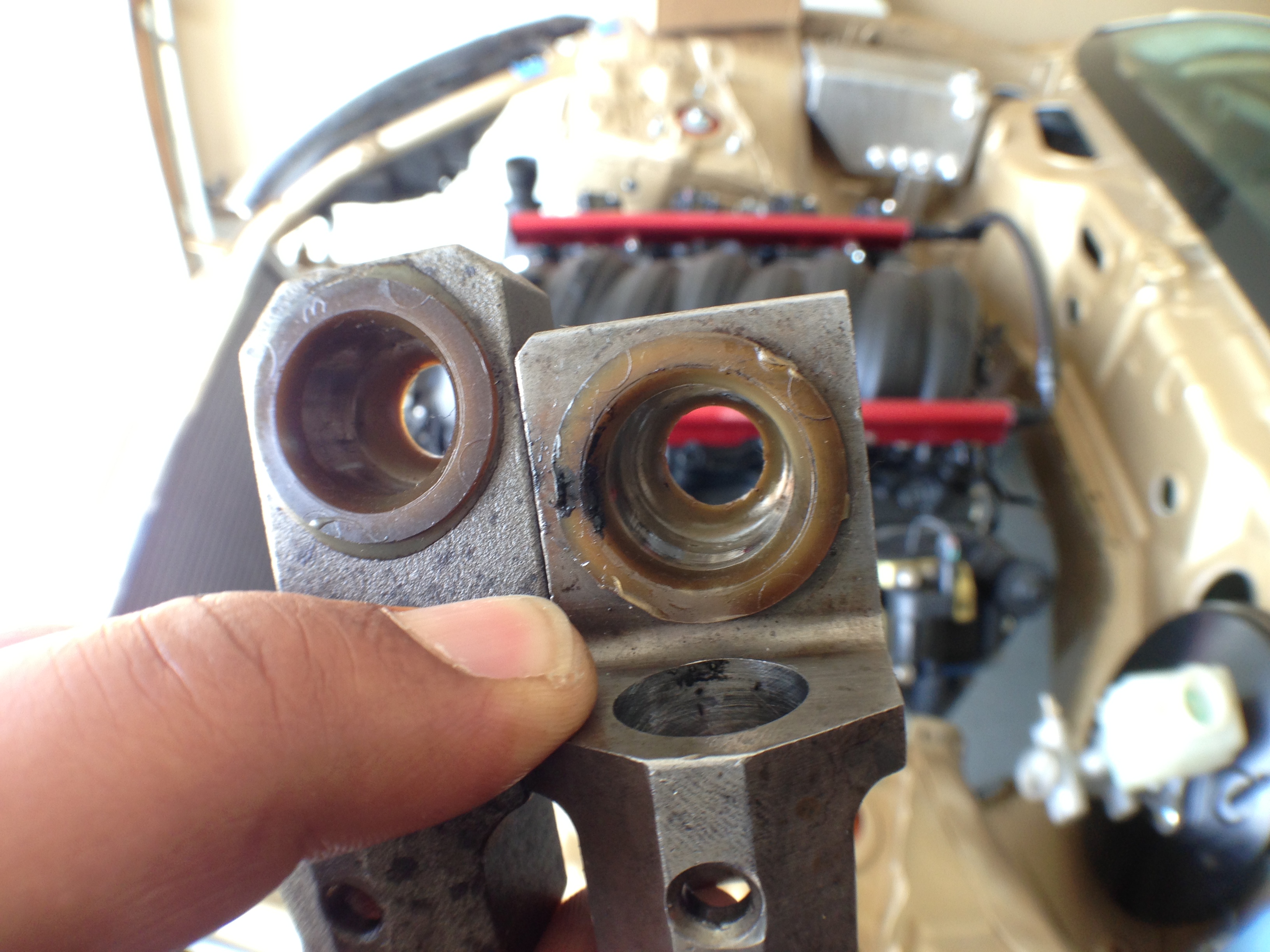

have to removed this, but what there is no screw

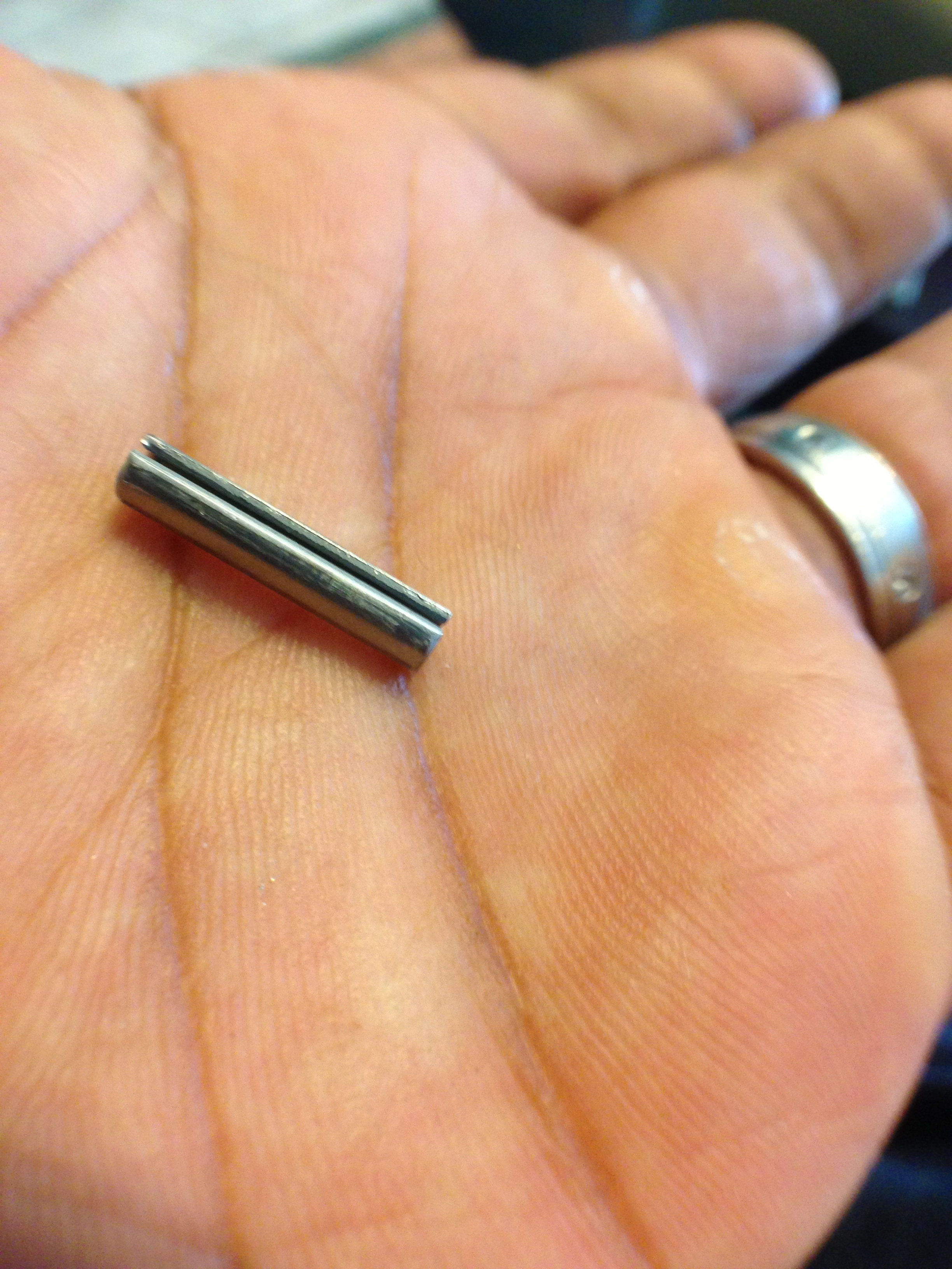

You have to knock out this pin
yup
Once the pin is knocked out the fitting should just pop off
view of the pin
Install the new line and insert the pin.. Hammer that sucker in..

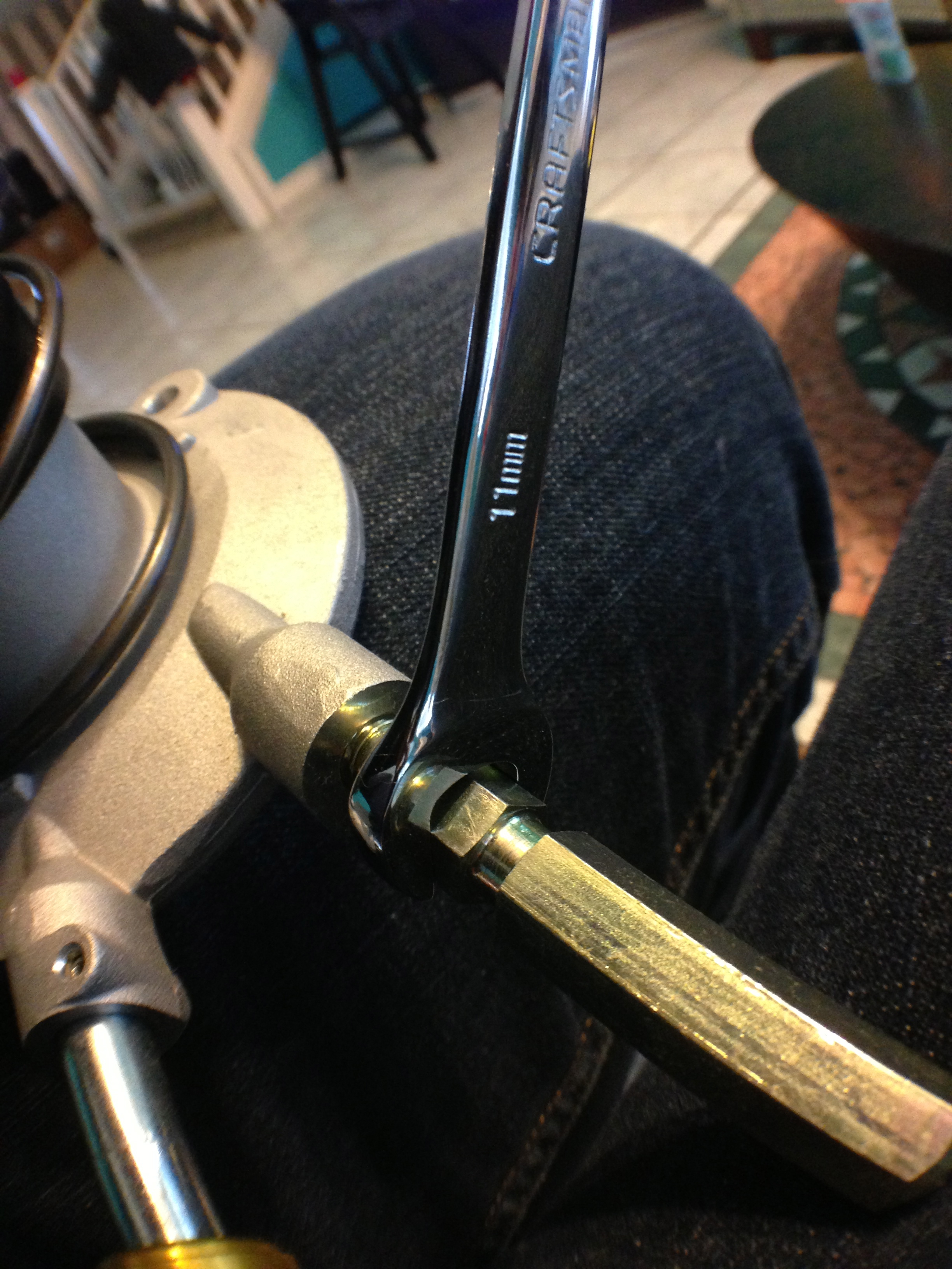

Next on the list is to remove this shifter level for a GTO one.
This can show you the difference in size between the two.

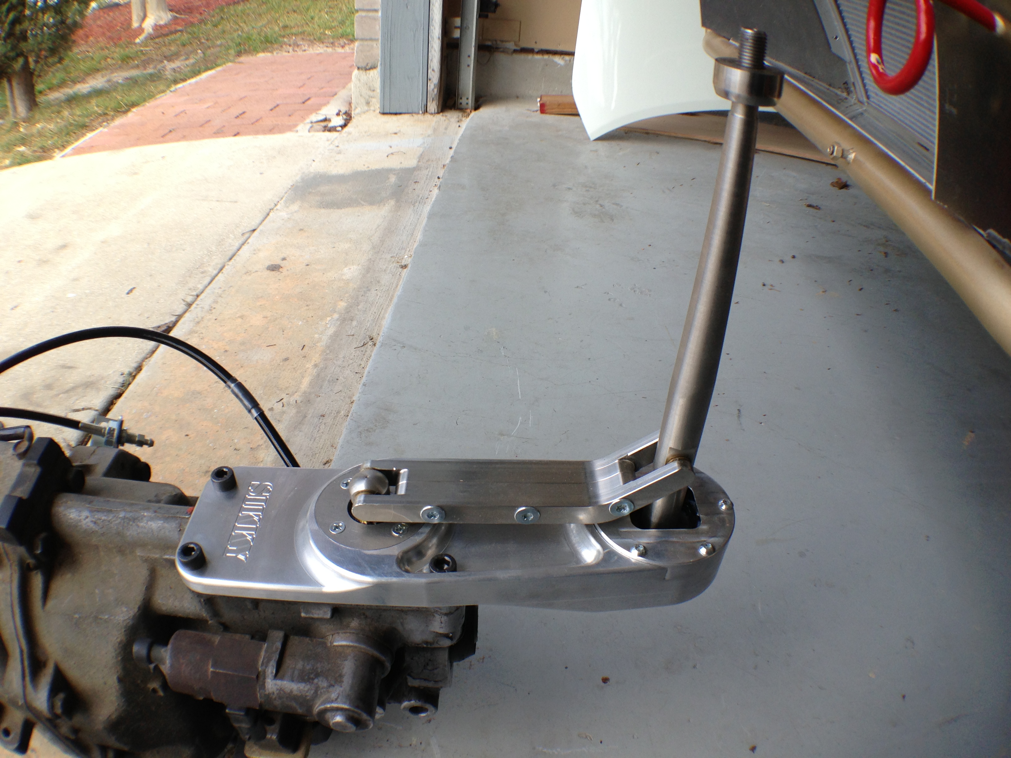

Now I could install my Sikky shifter

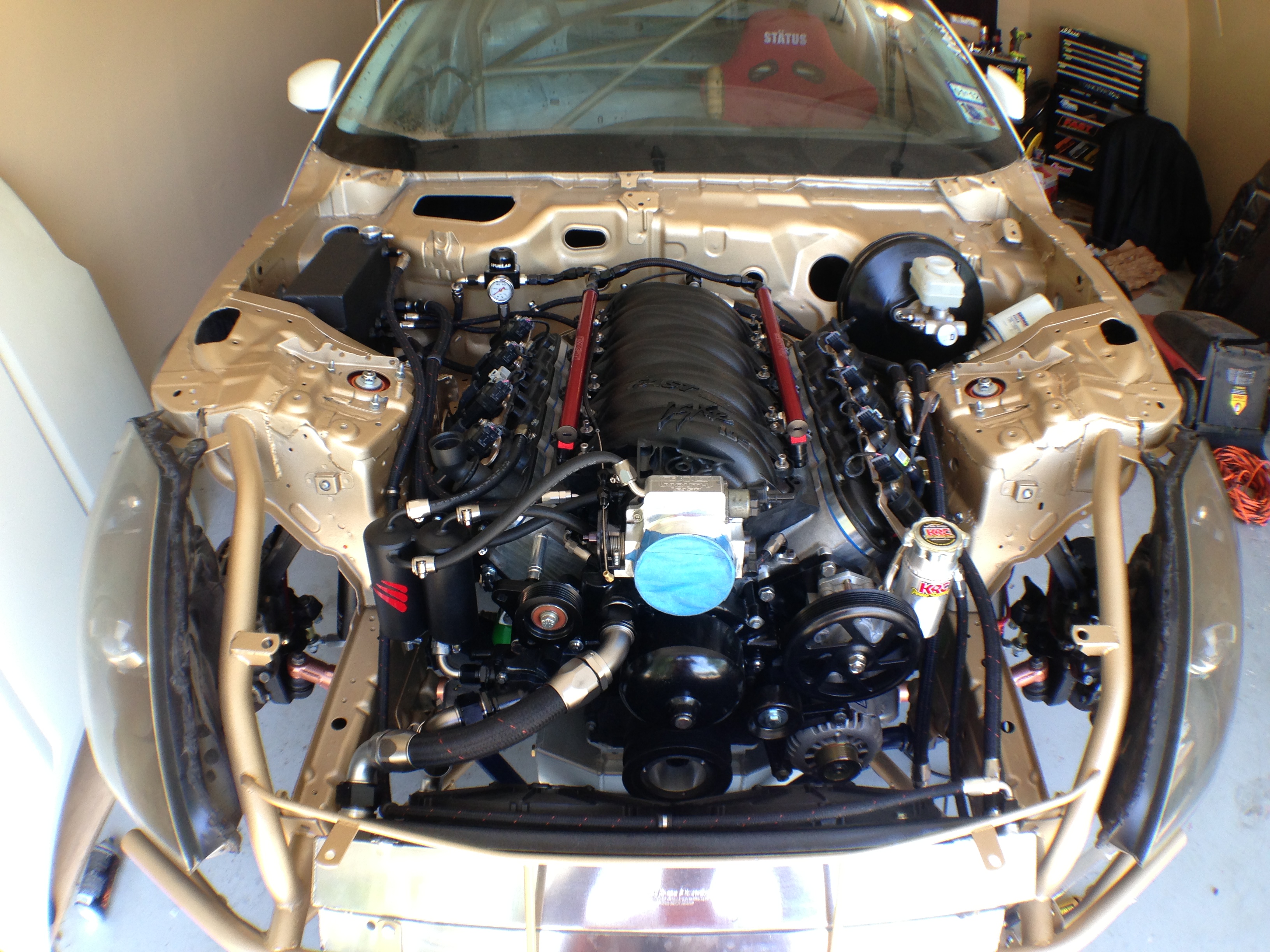

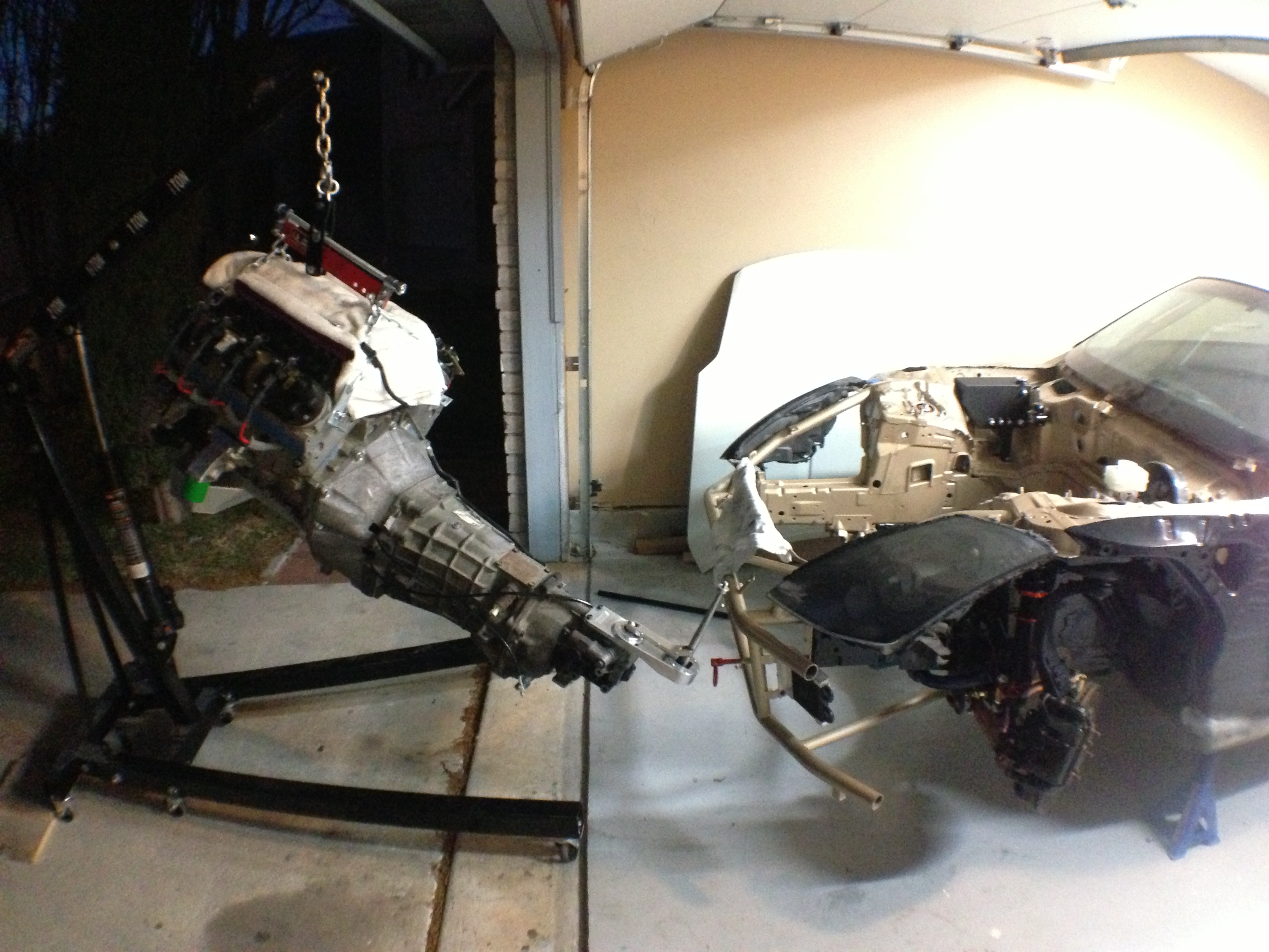

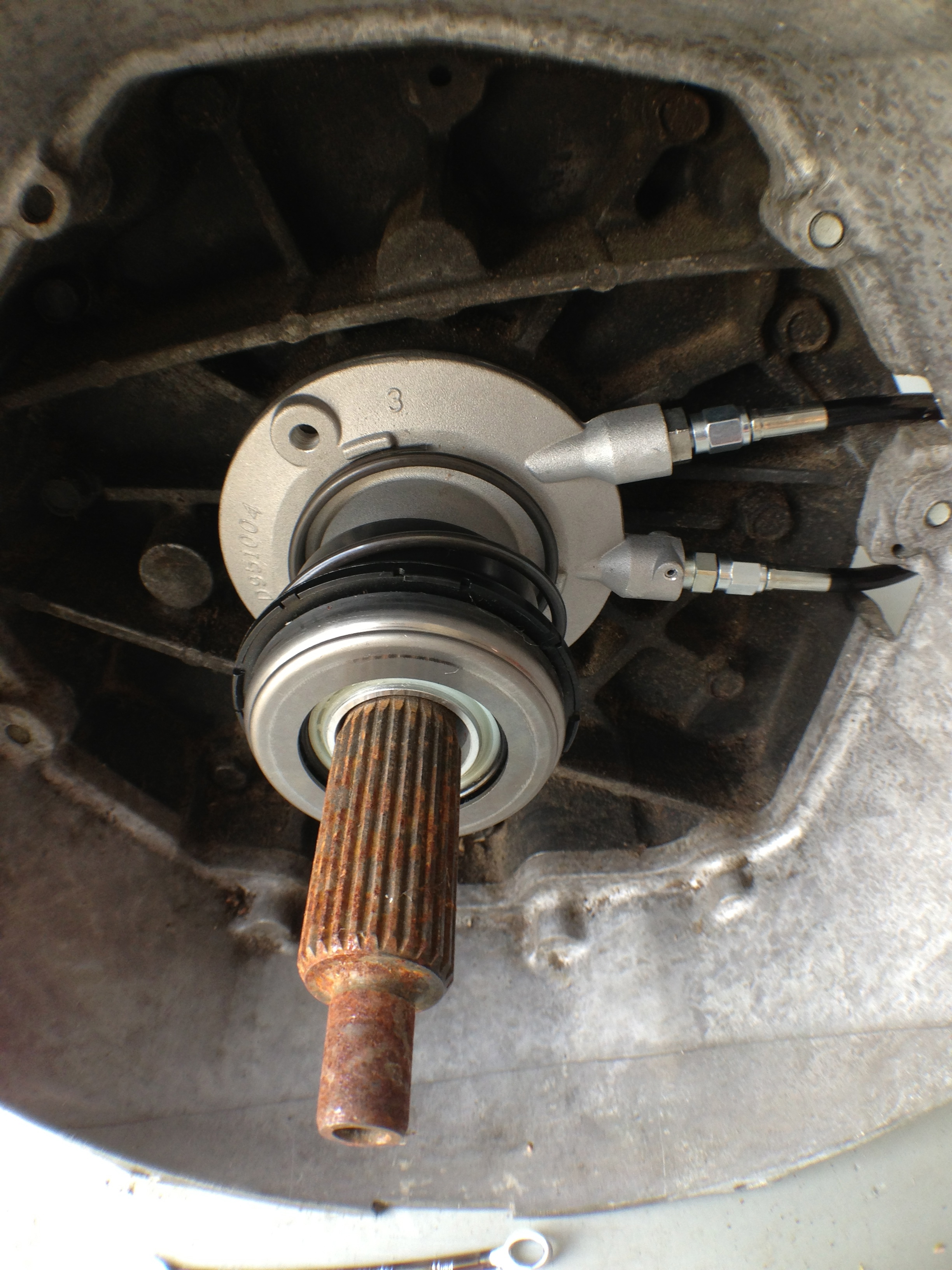

So removed the engine to start on the T56 install

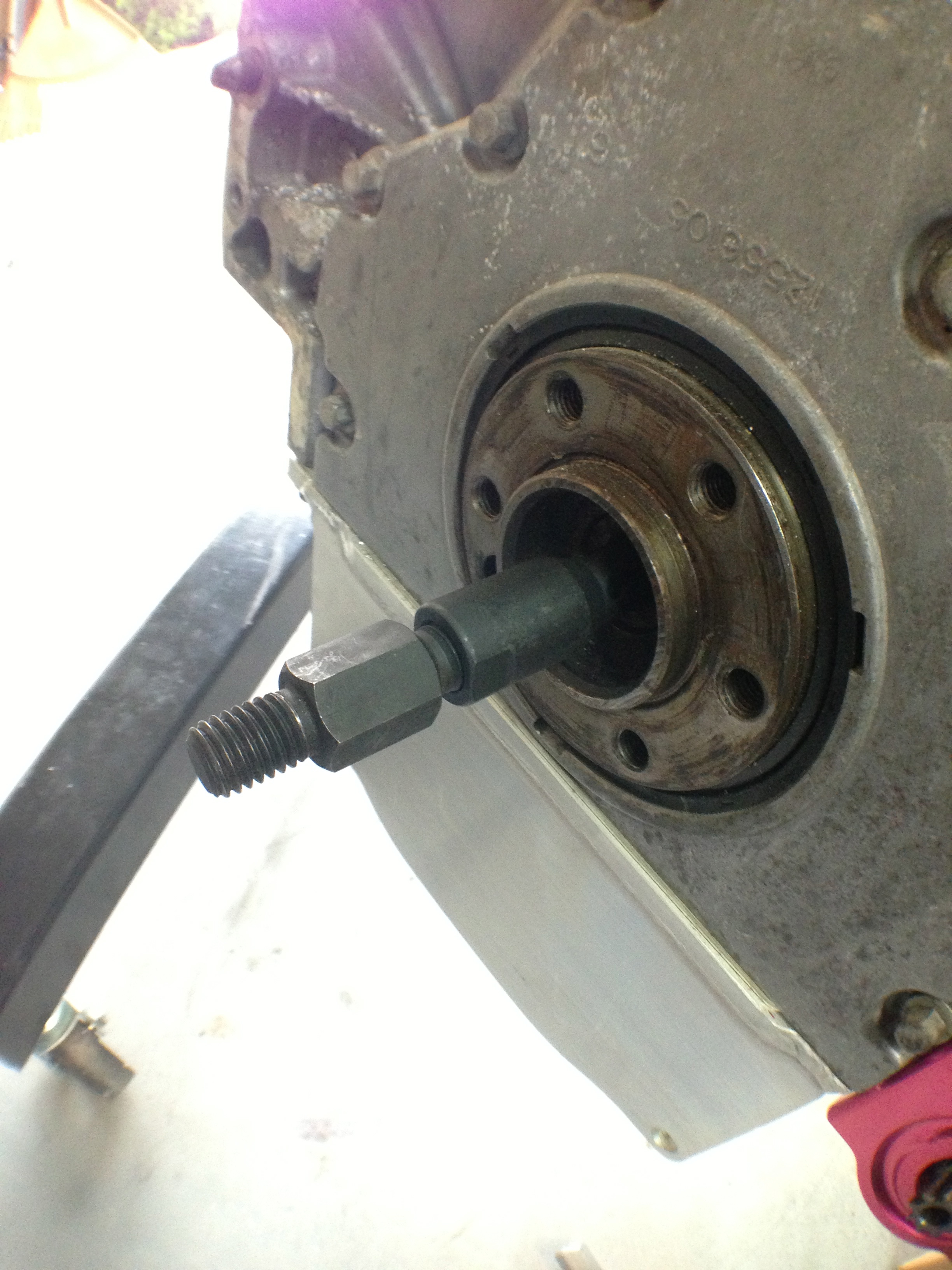

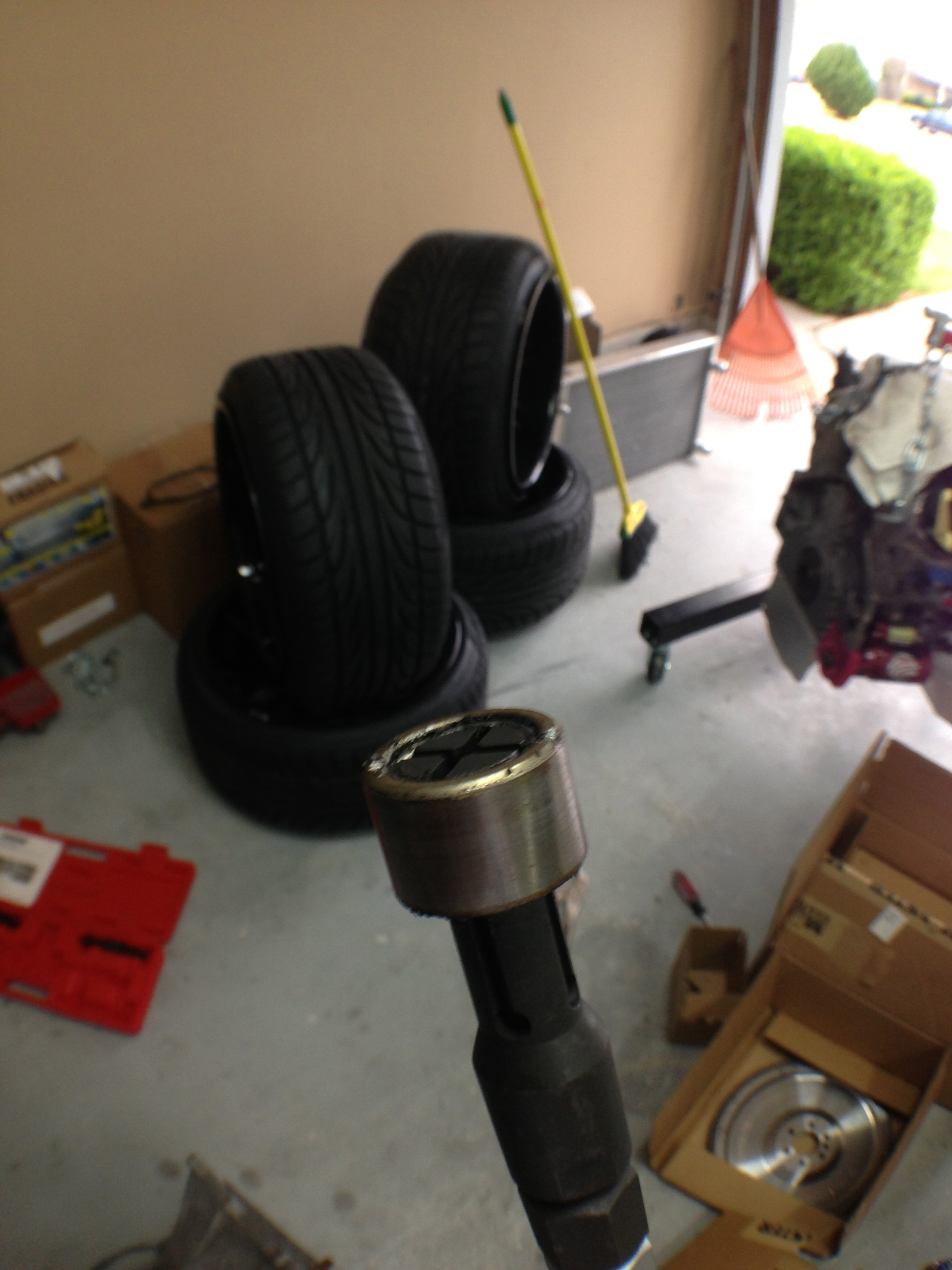

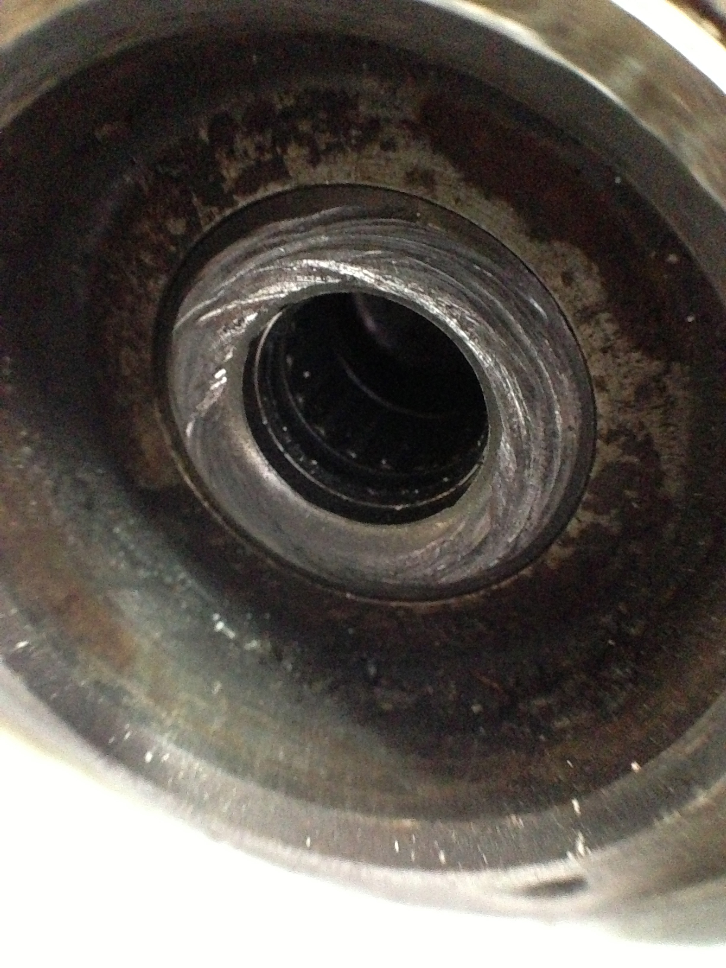

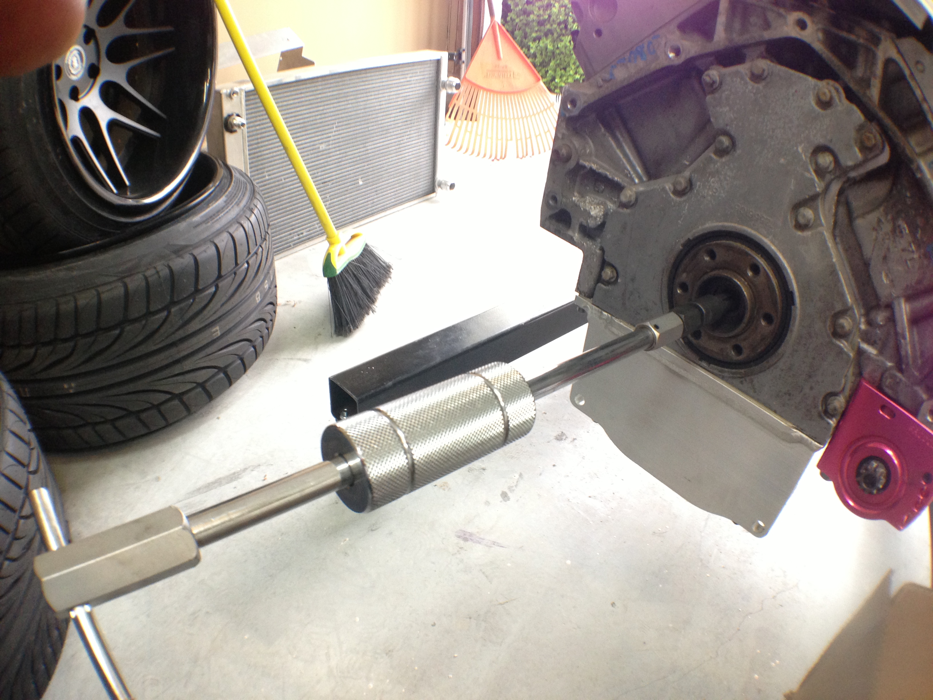

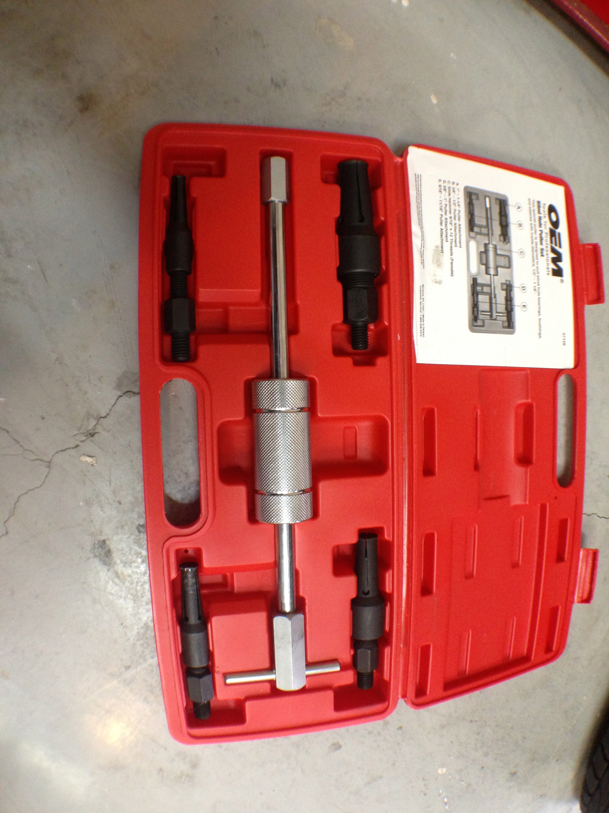

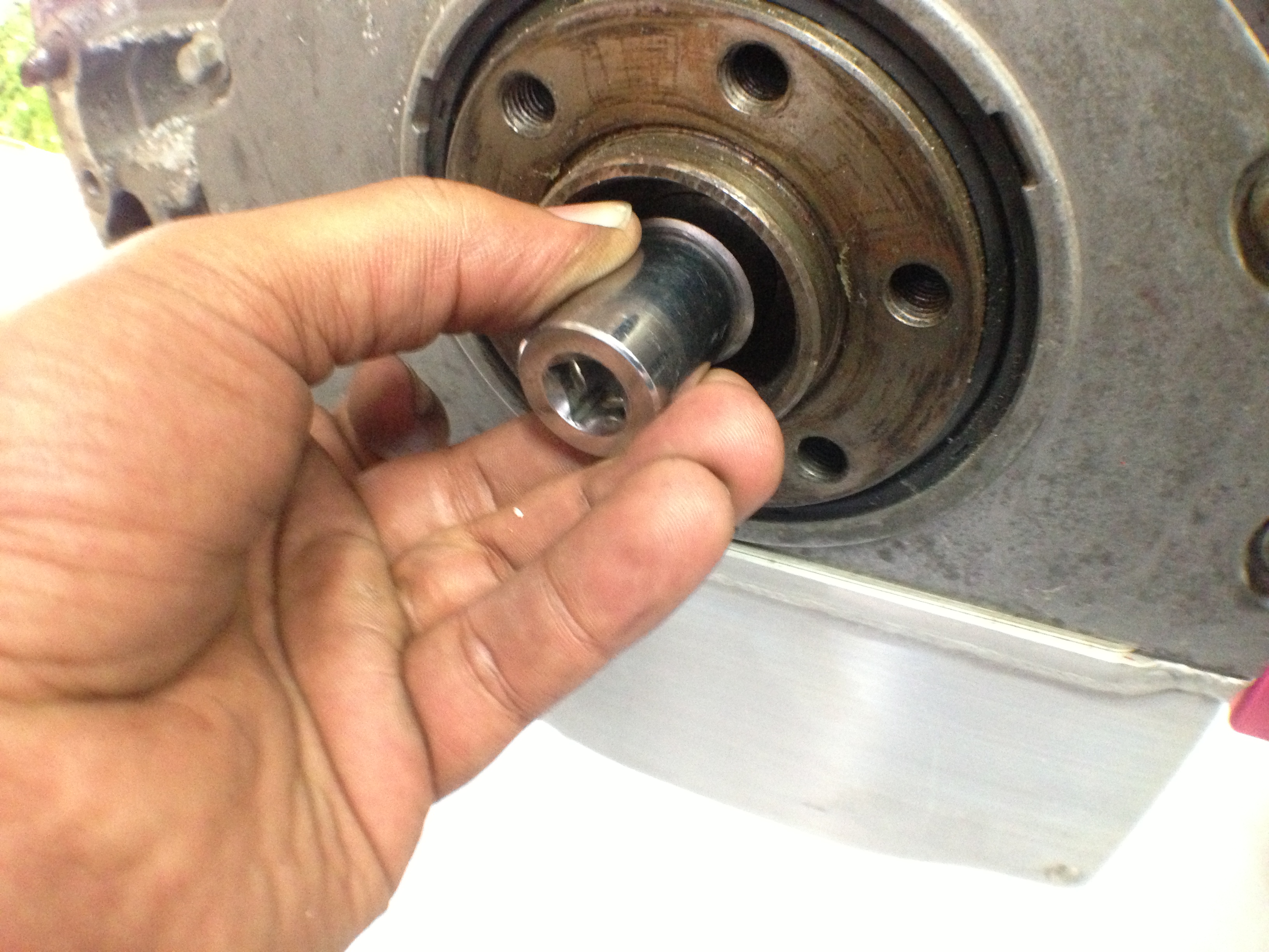

Start out by removing the old pilot bearing.. I rented this blind puller to get the job done..
Let's do work.. Took me about 2 min to remove.

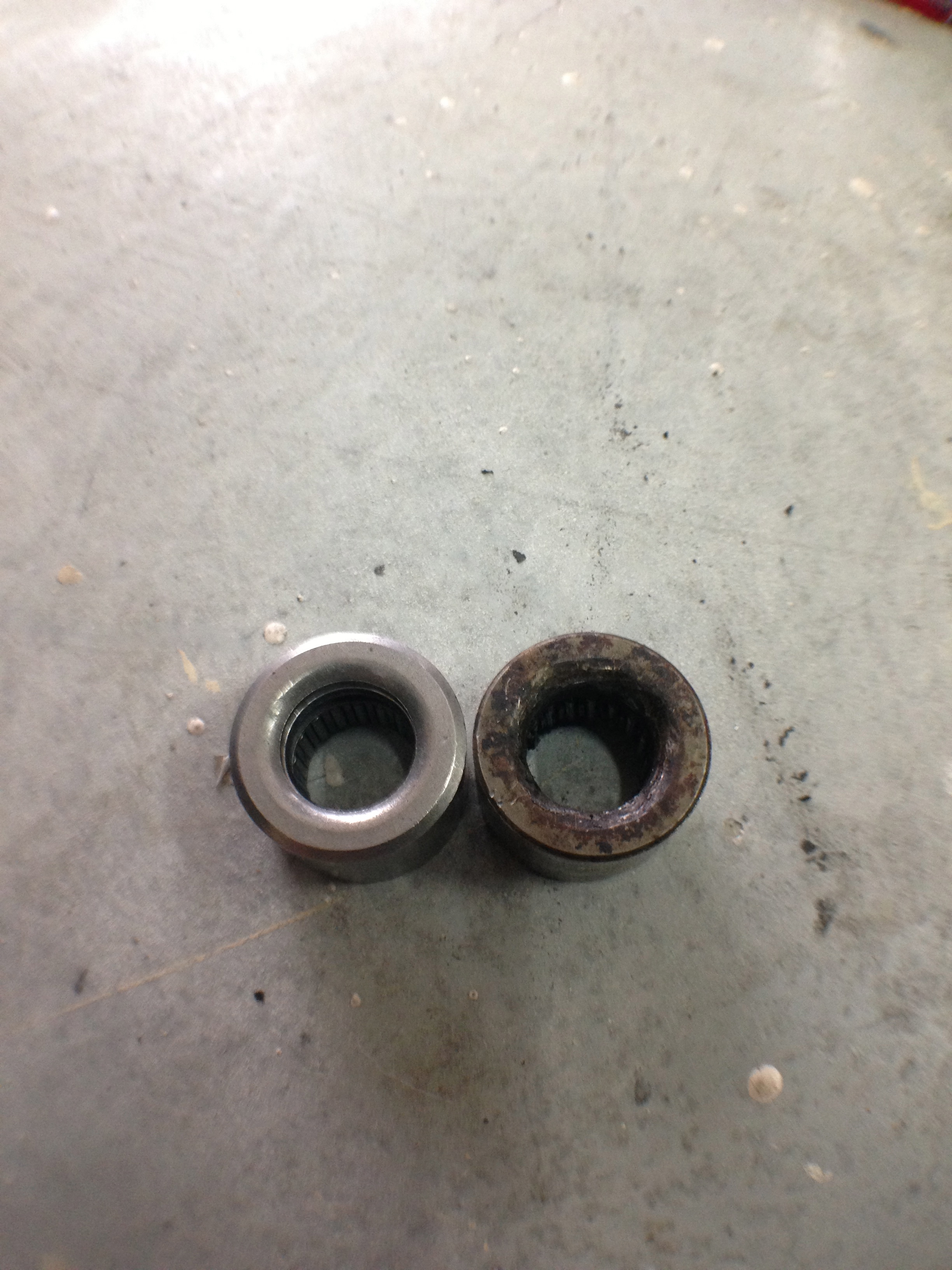

Out
View of the old vs New..

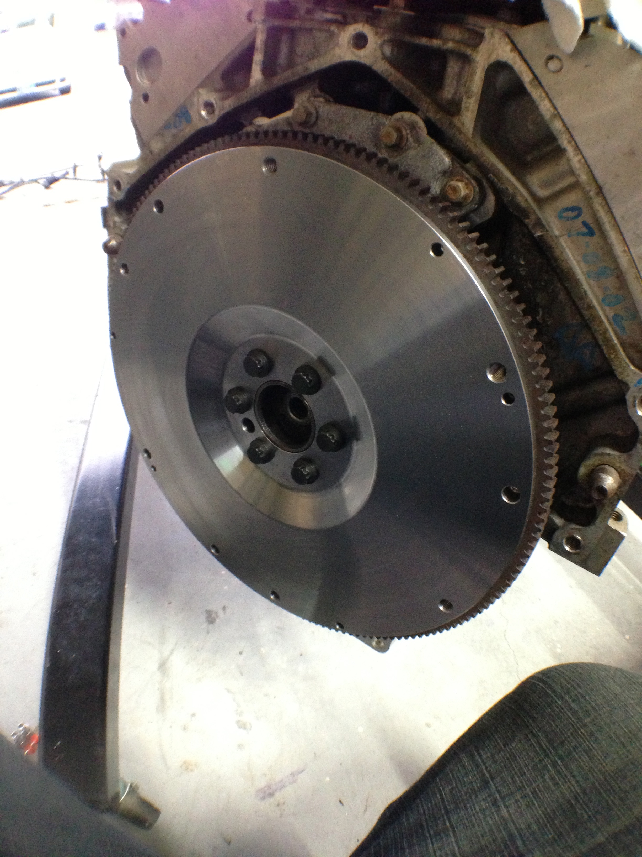

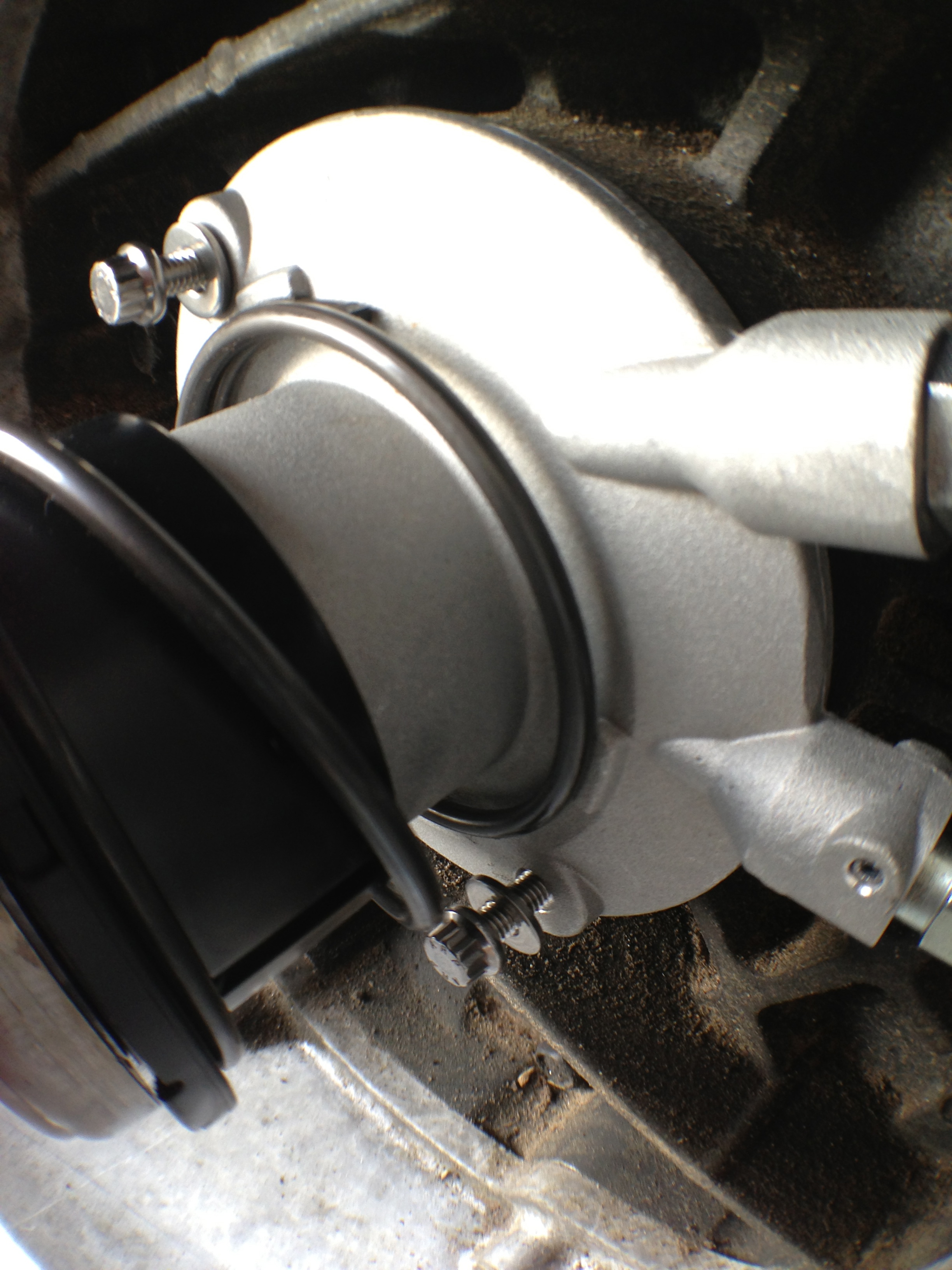

Flywheel going on.. Again ARP bolts are needed

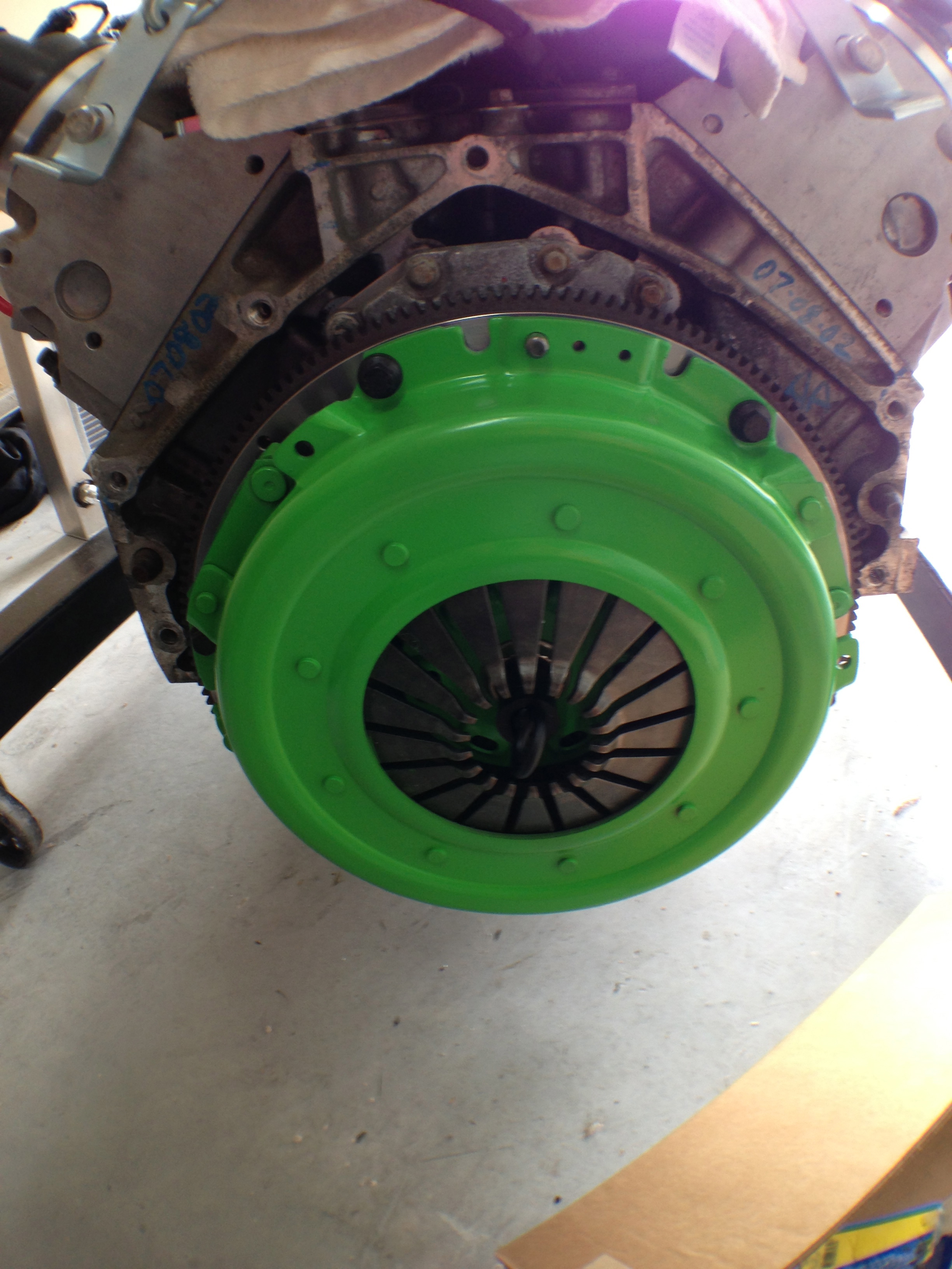

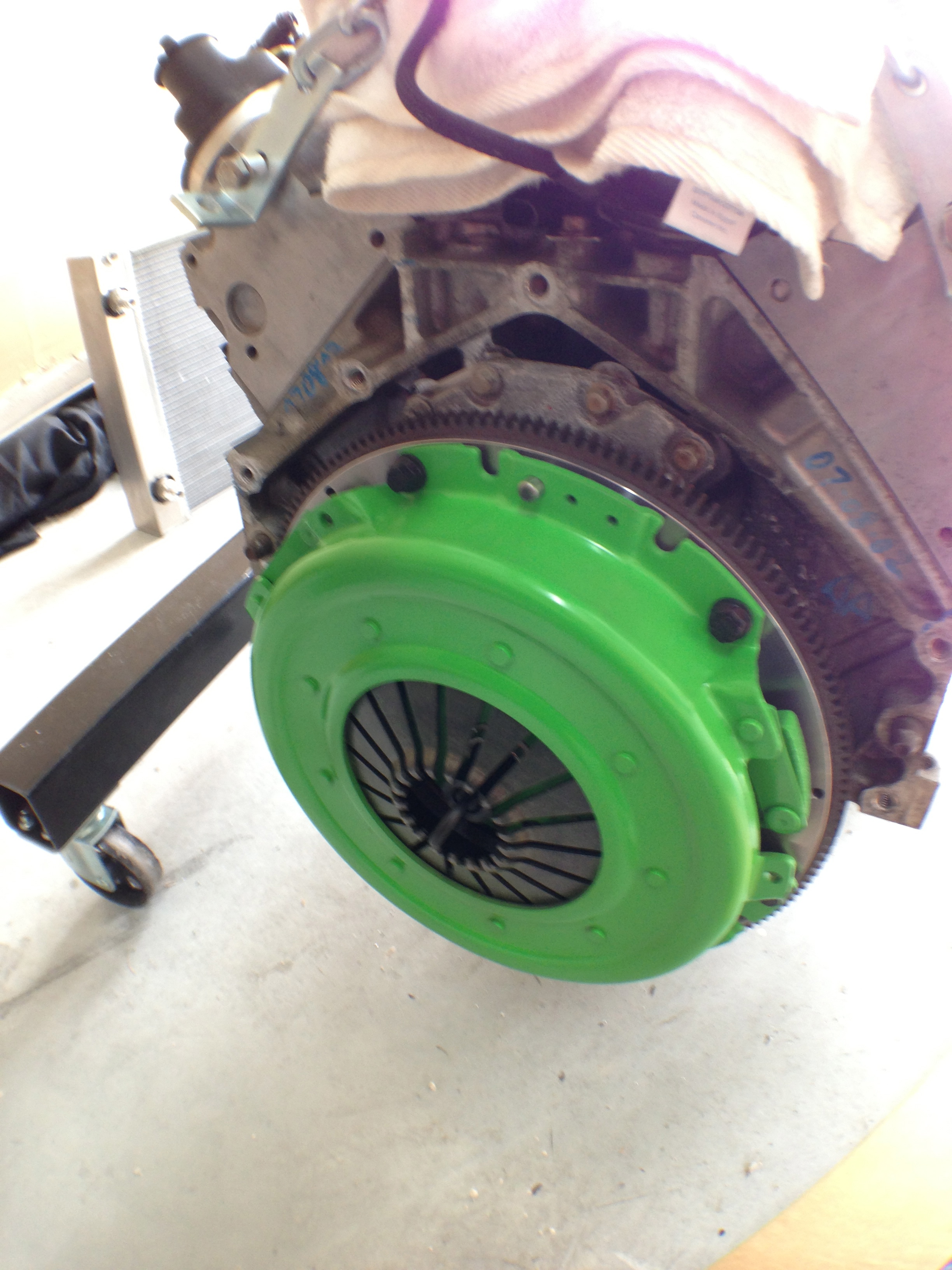

Clutch and pressure plate getting installed.. The green monster

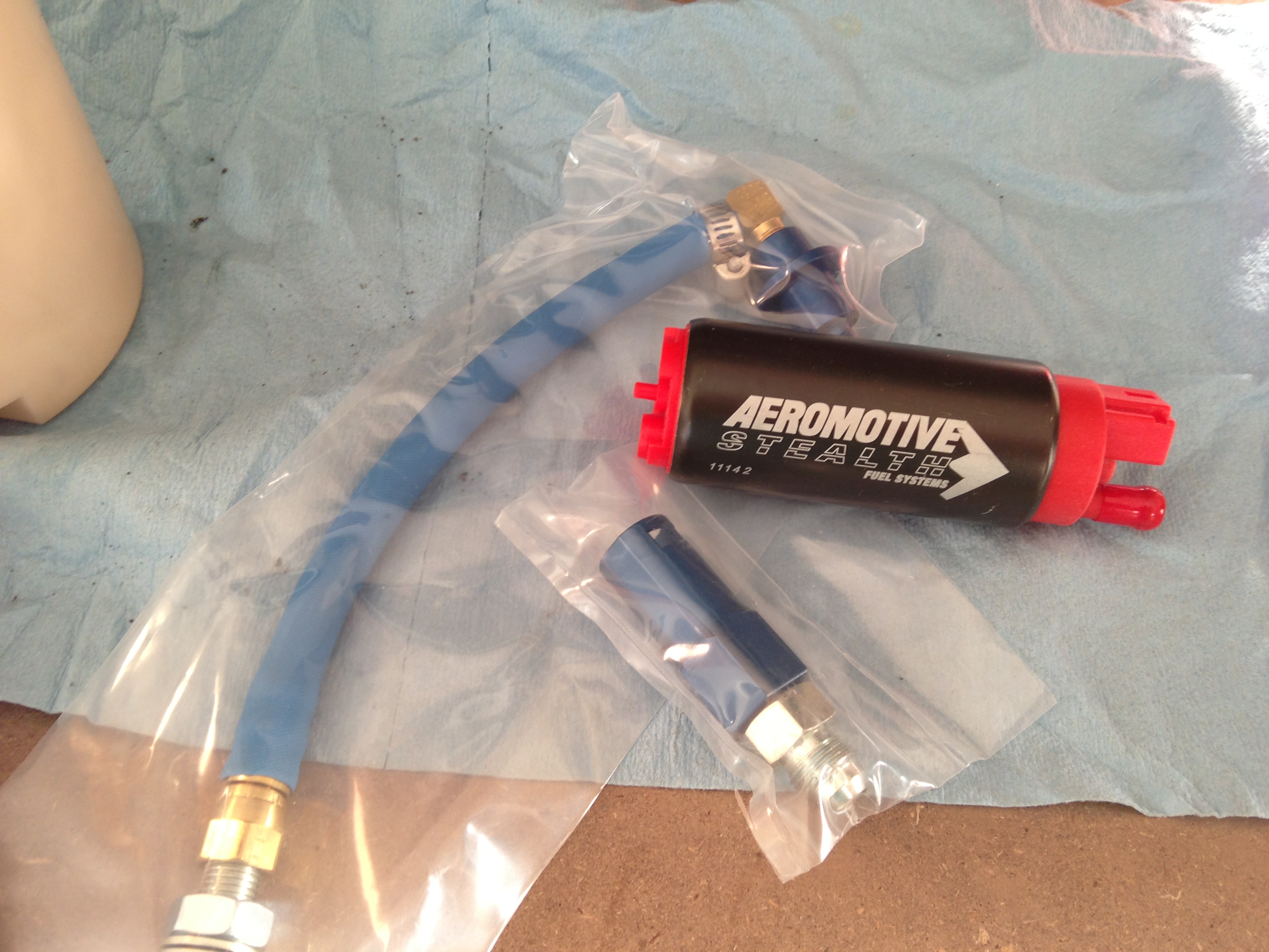

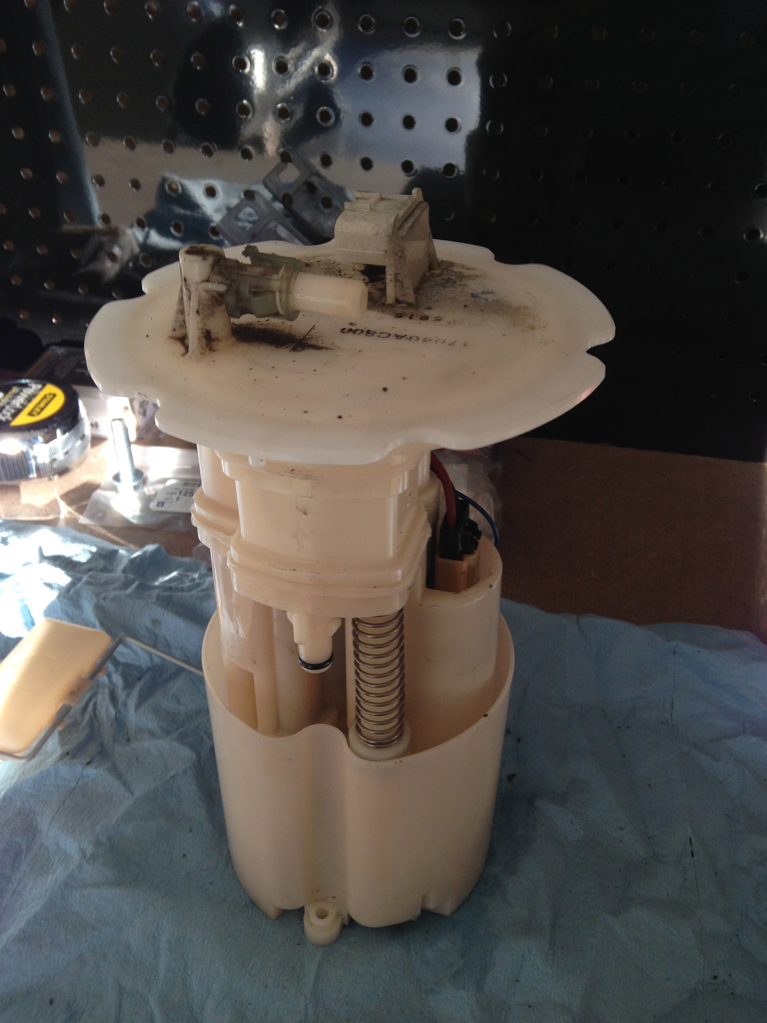

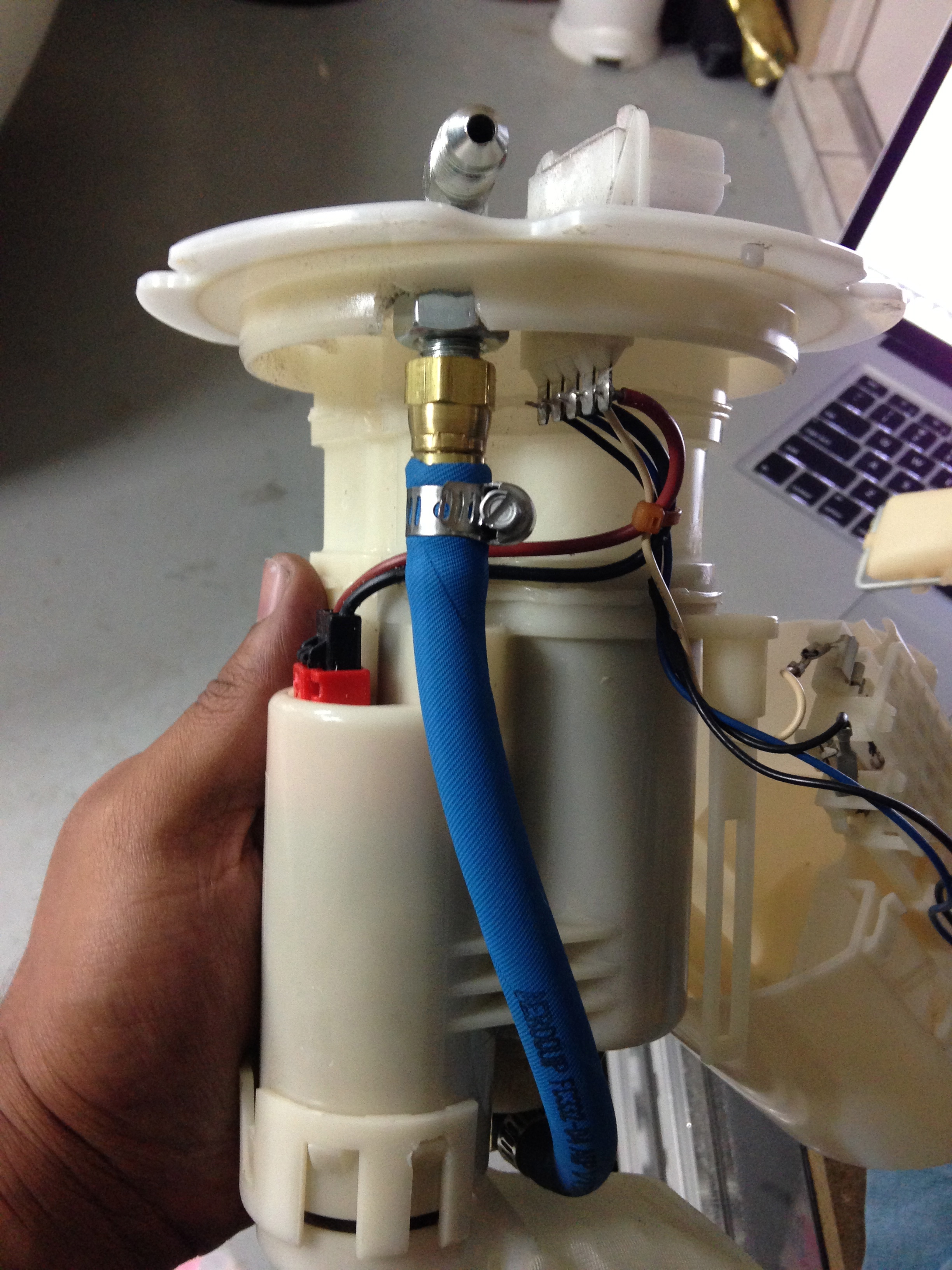

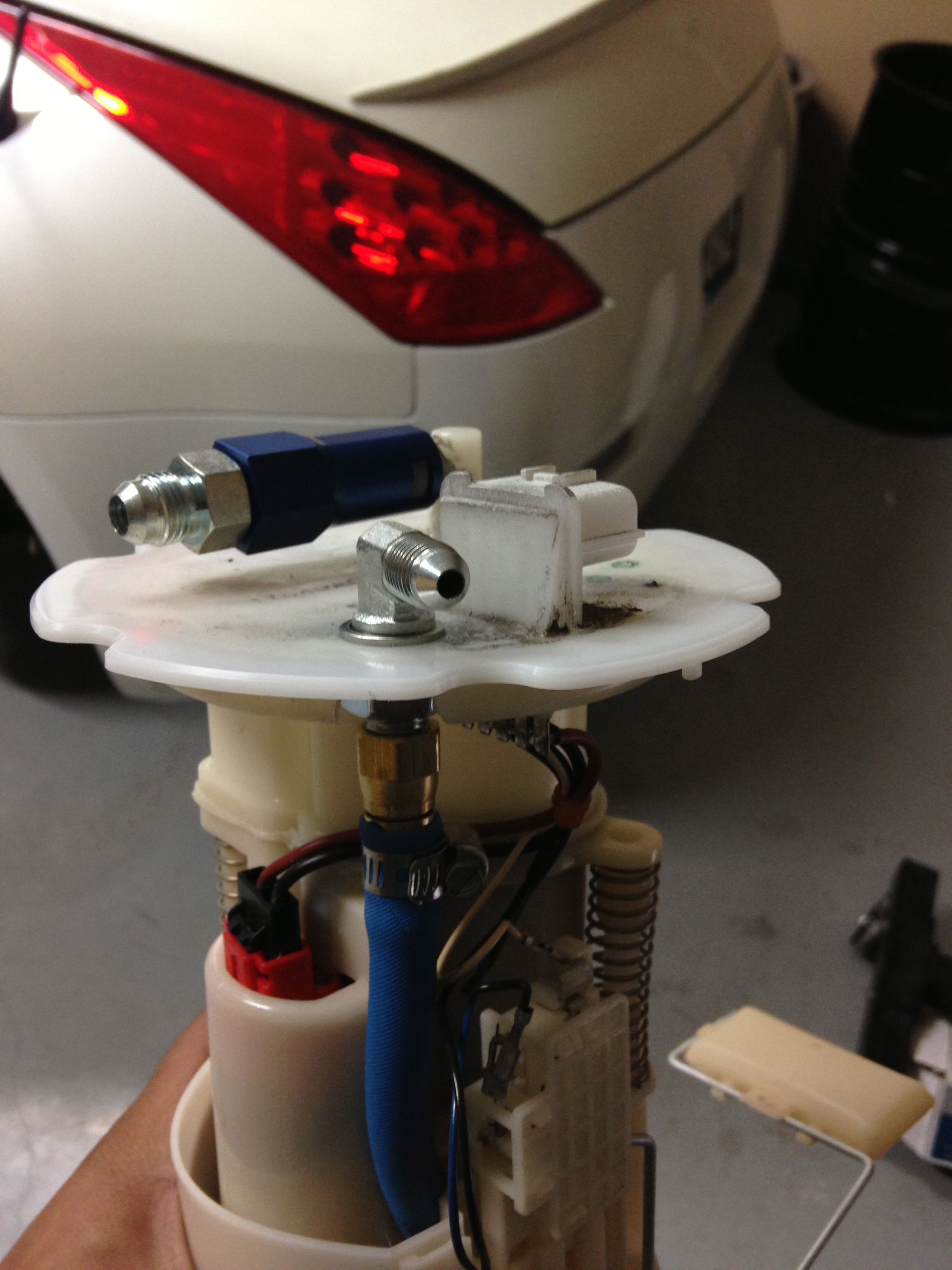

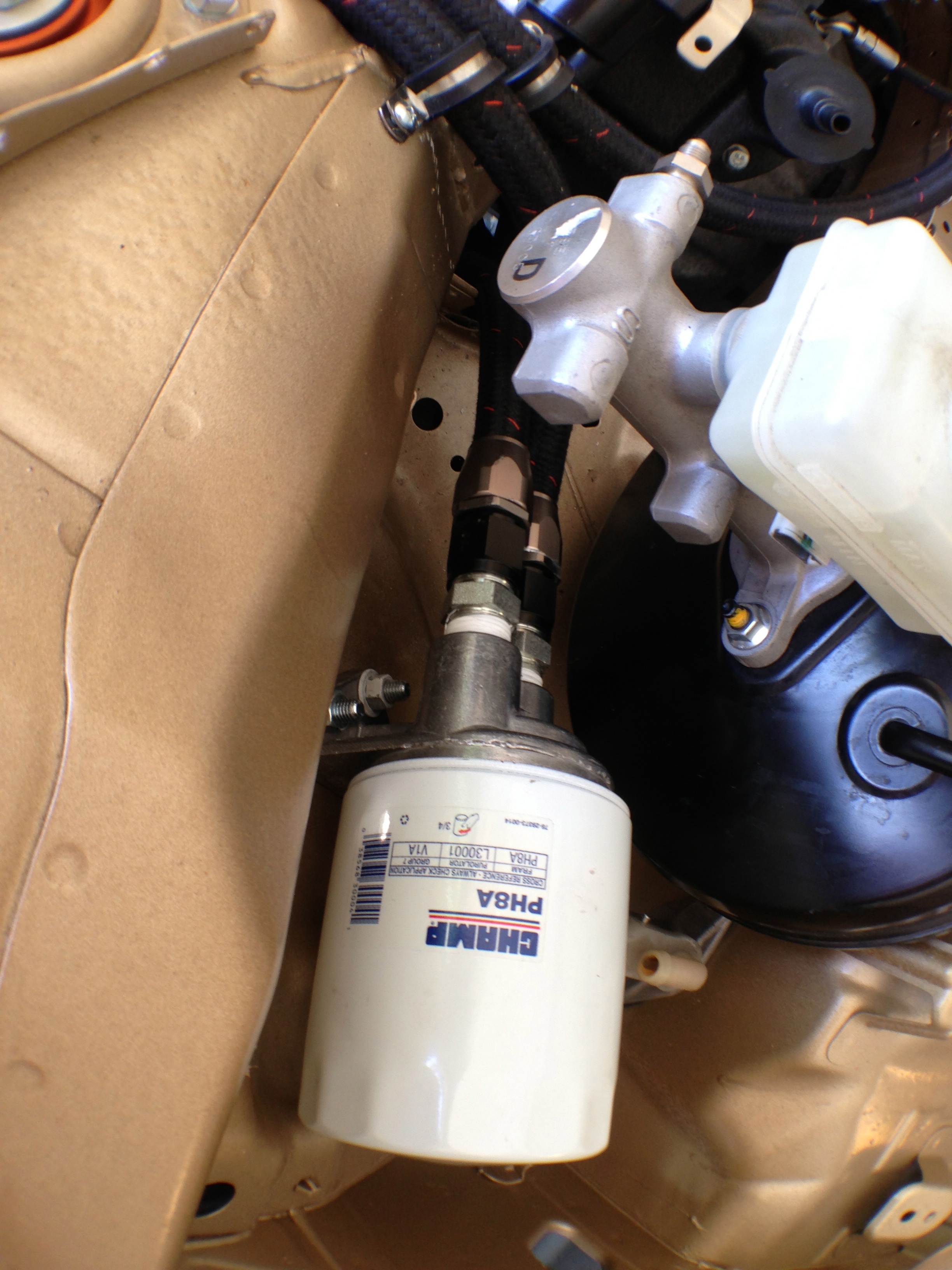

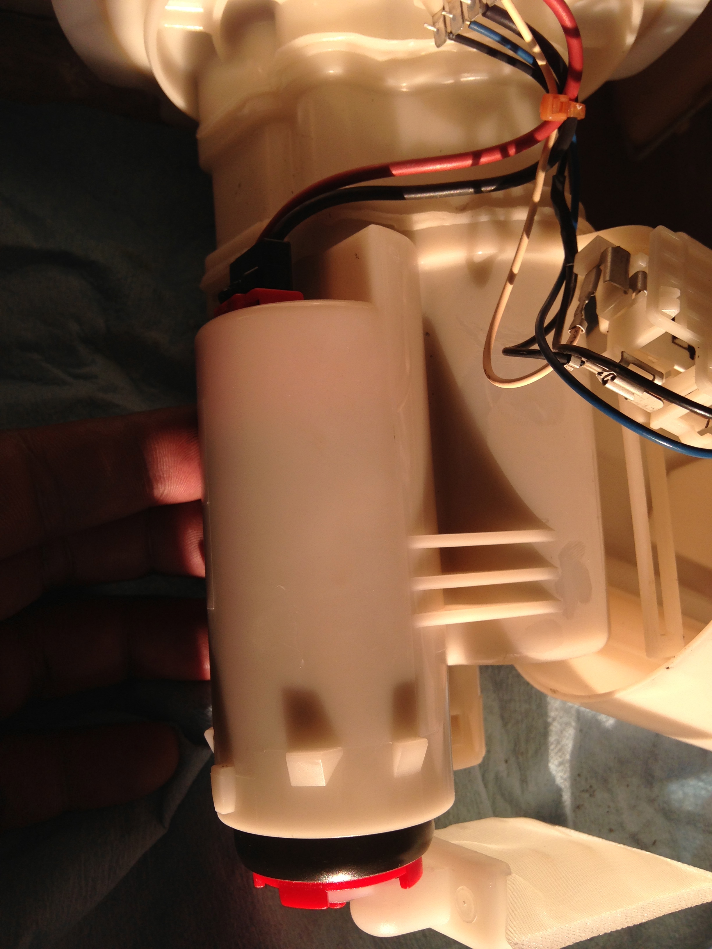

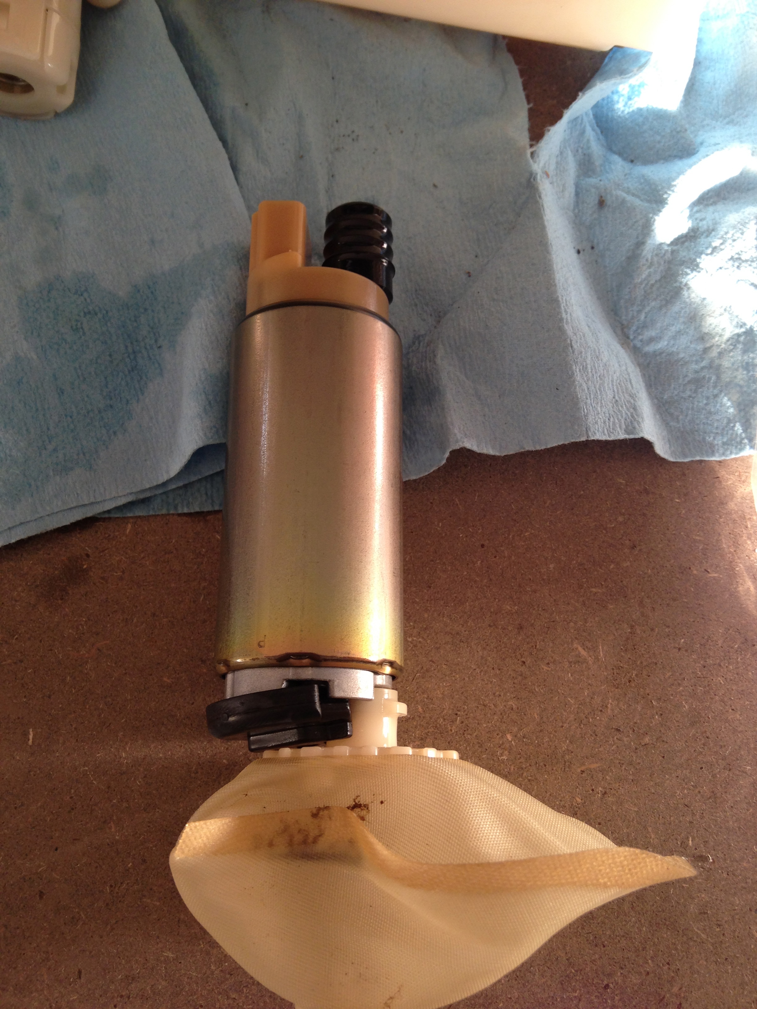

Next I had to tackle the fuel setup. Went with Aeromotive 340 pump and also hit up CJM for their OEM Pump To -6AN and Return Fuel Correction Kit..

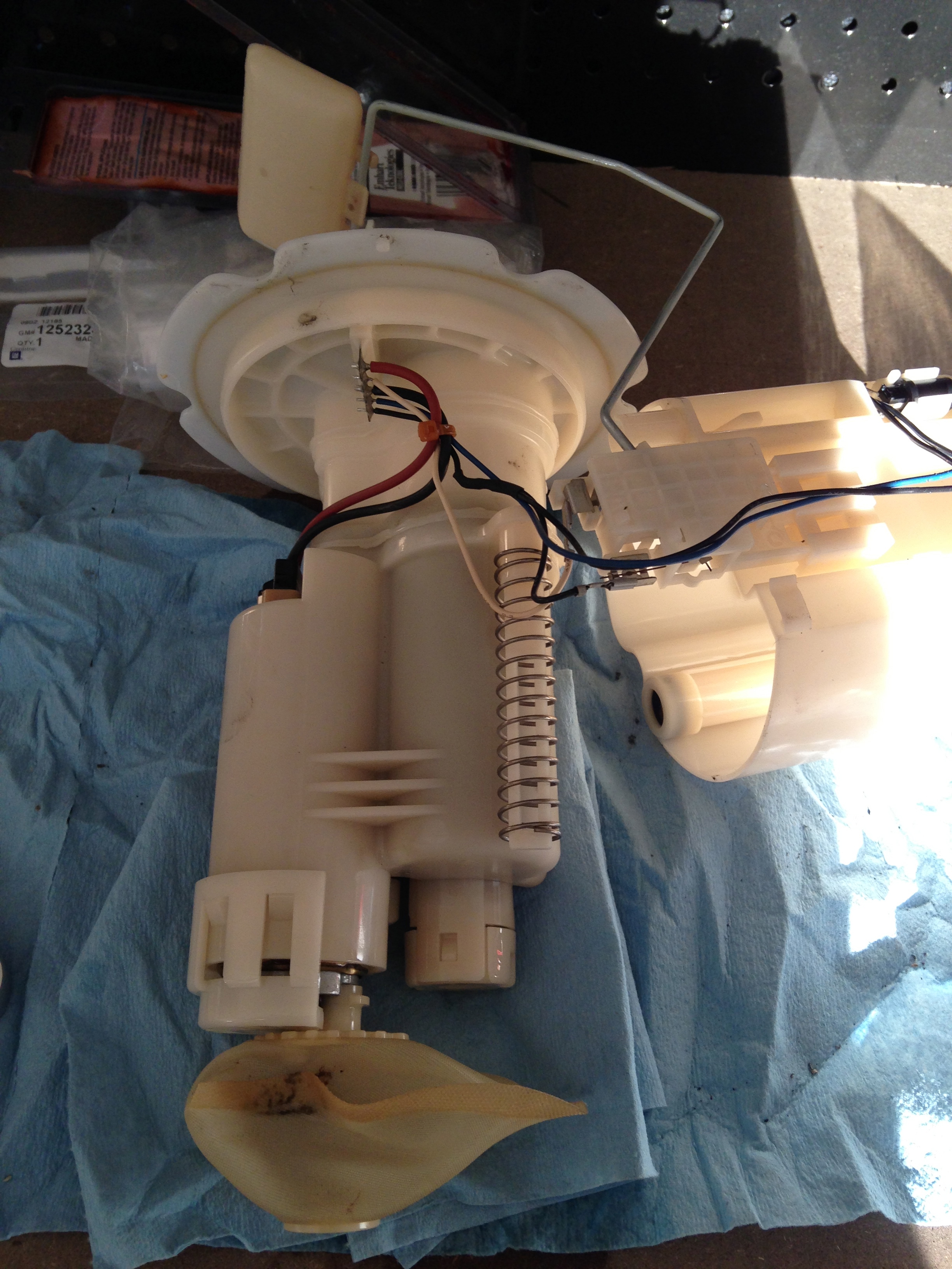

Took out the old fuel pump unit
Take it apart

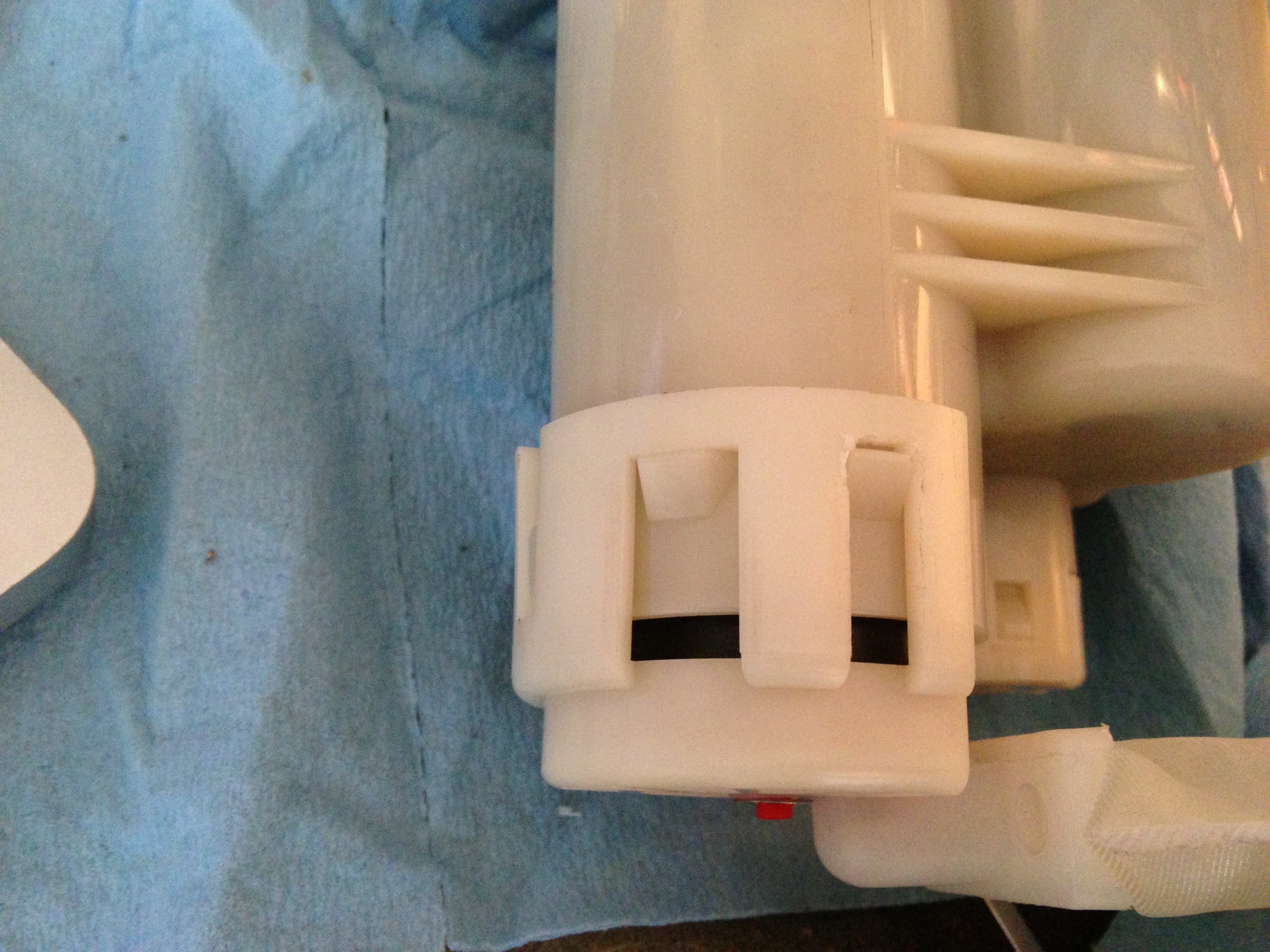

Pop this bottom cap off that holds the fuel pump in..

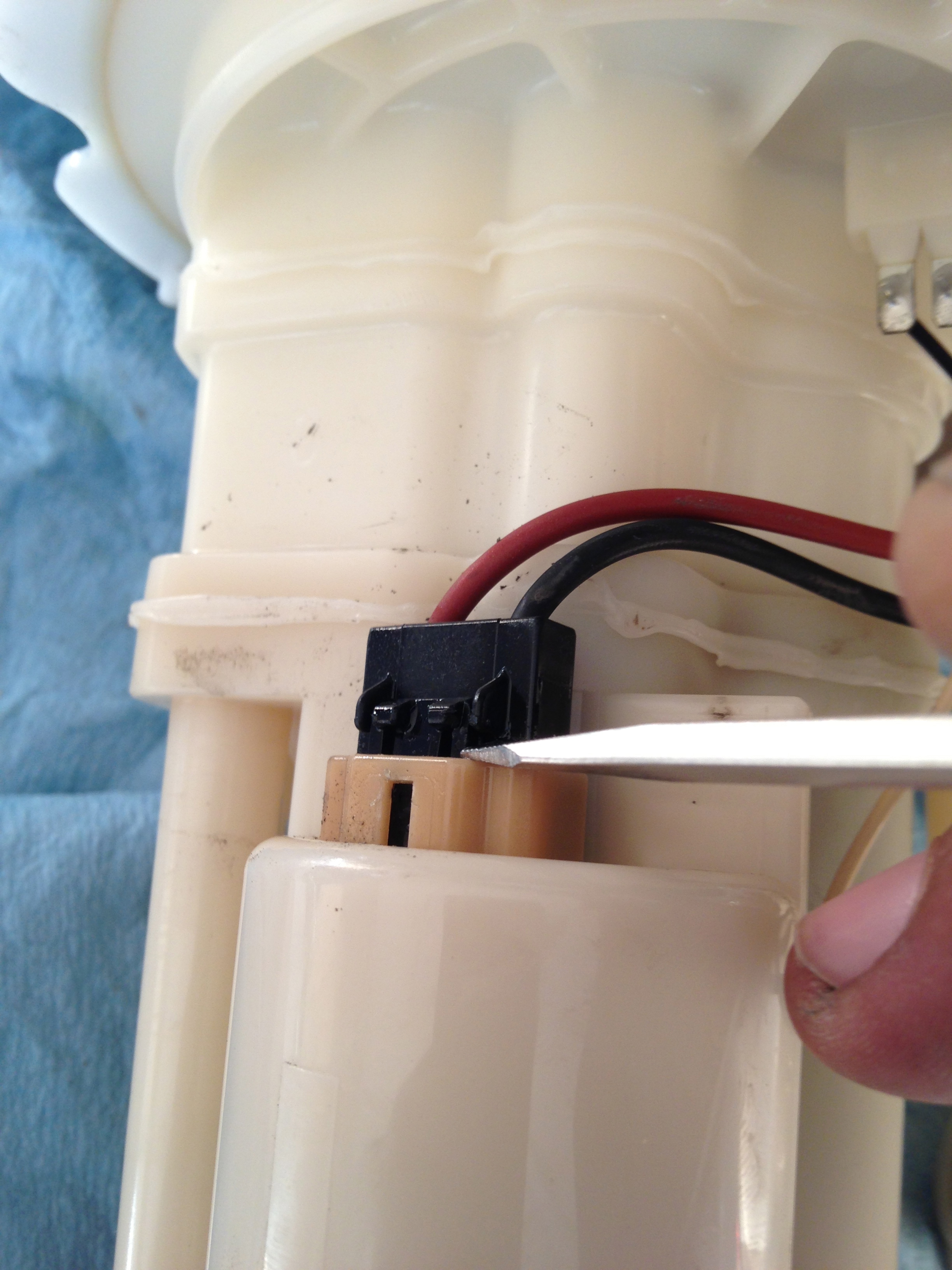

Remove the sensor
Out!!

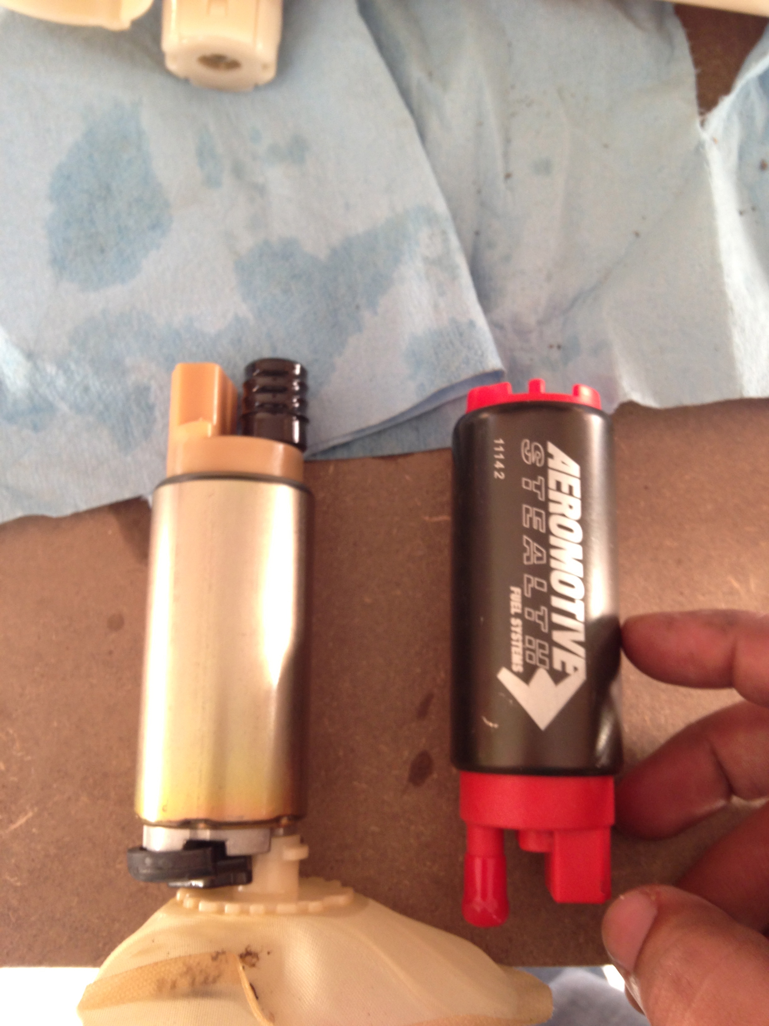

Side by side view

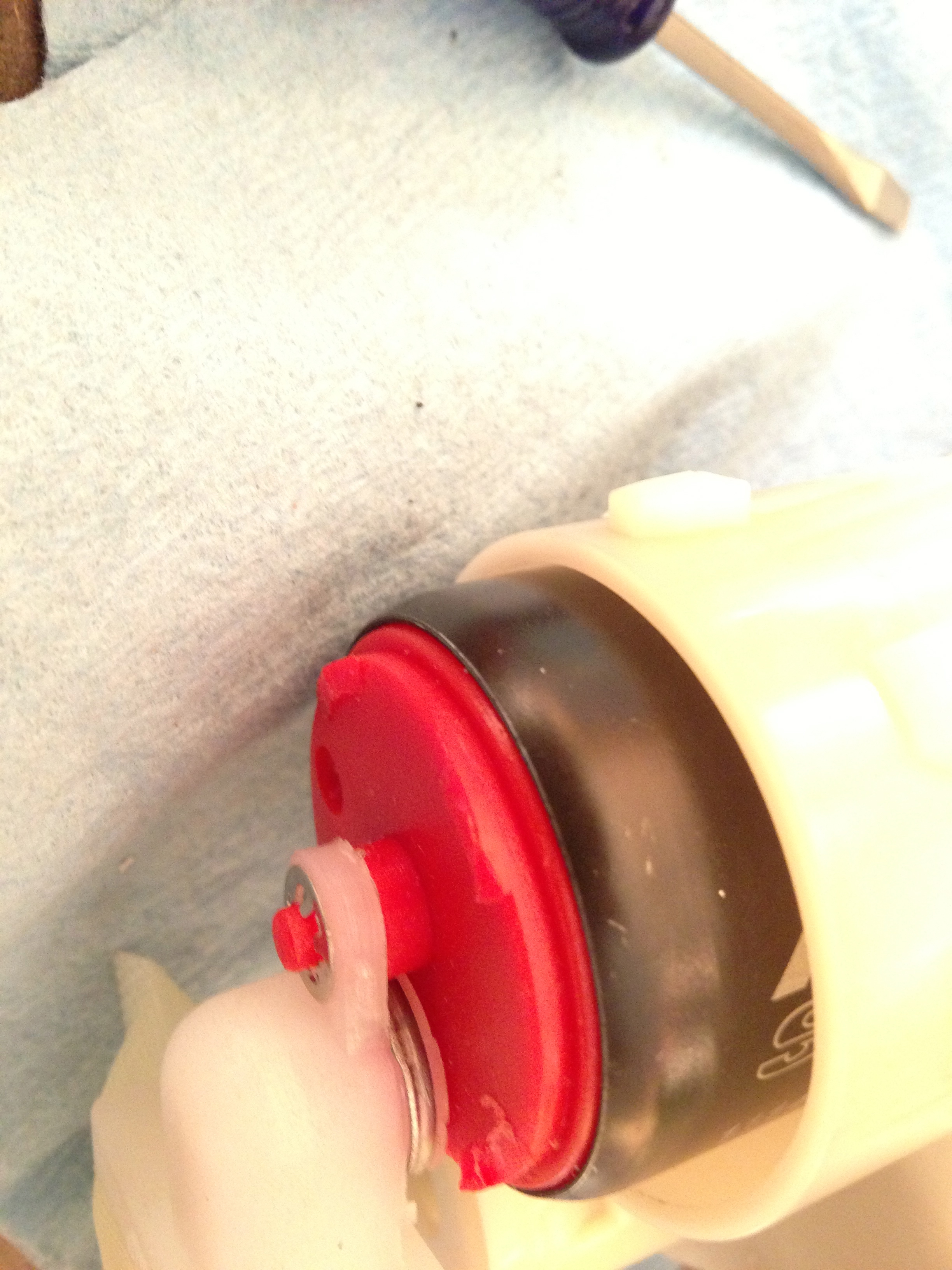

Place rubber cap

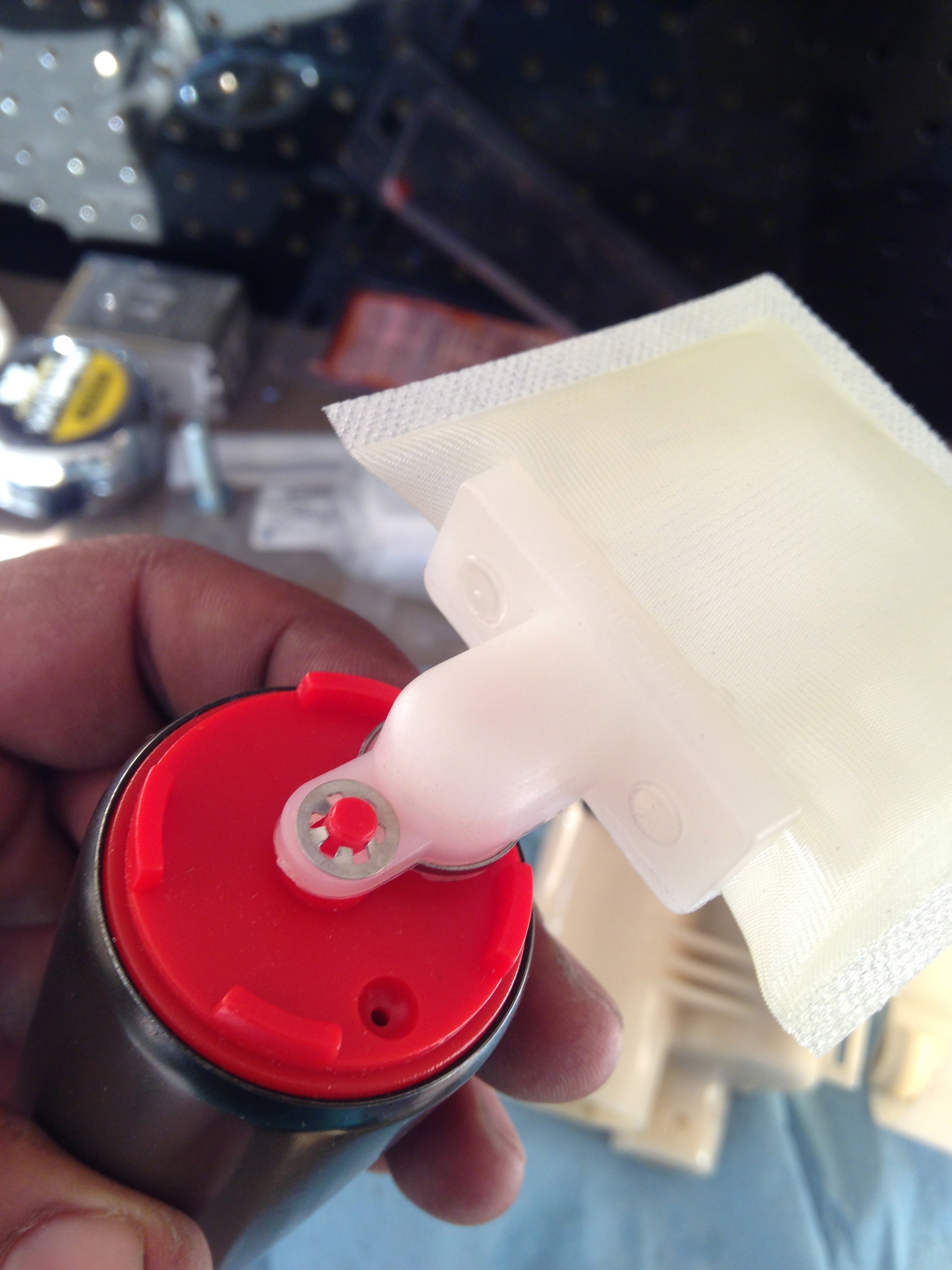

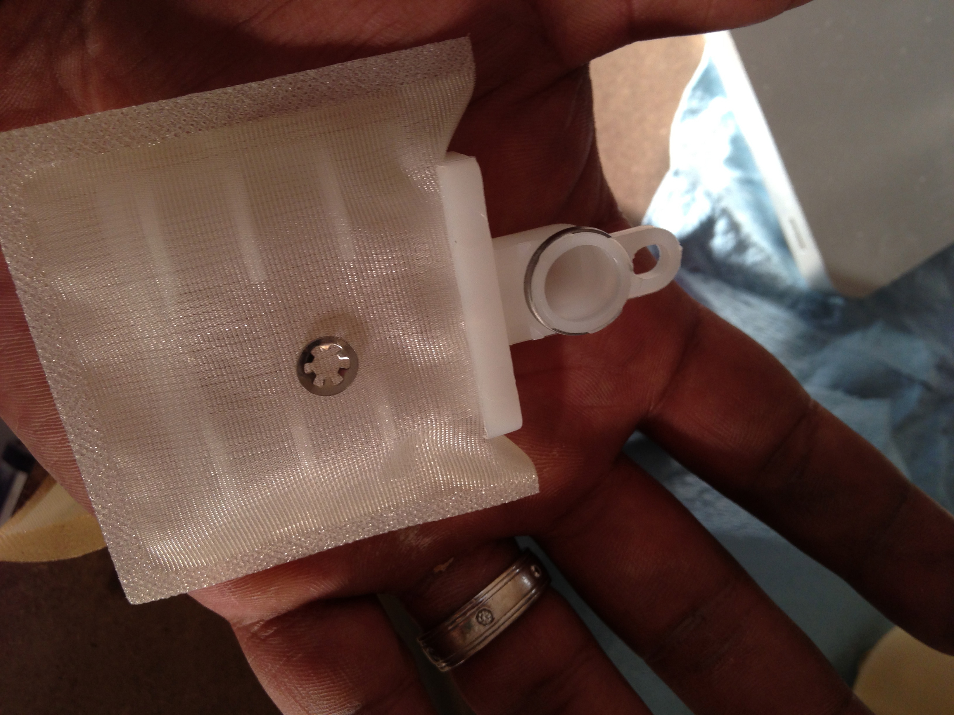

Install the filter bag (I think that is the name oh well)
Place back in

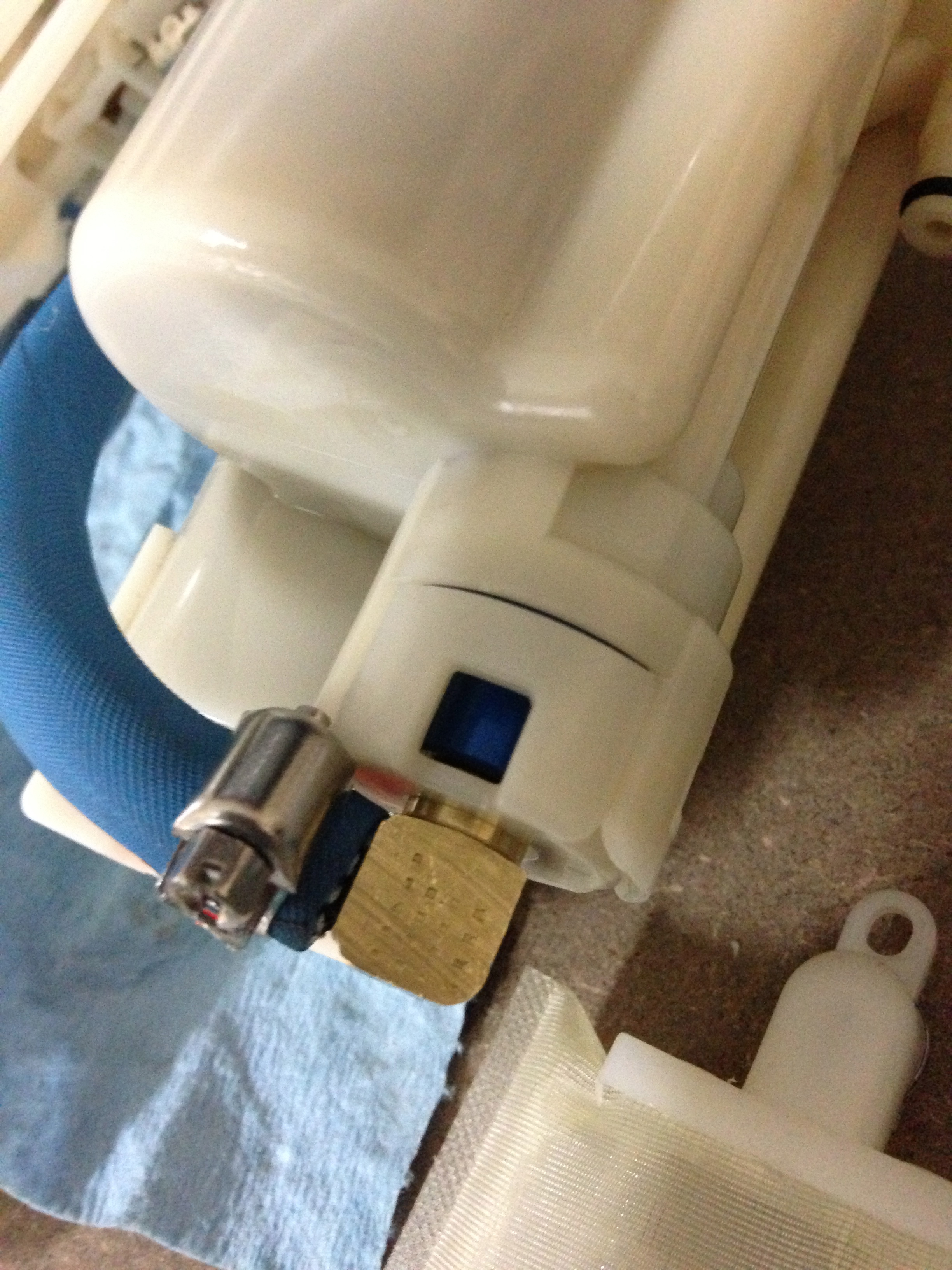

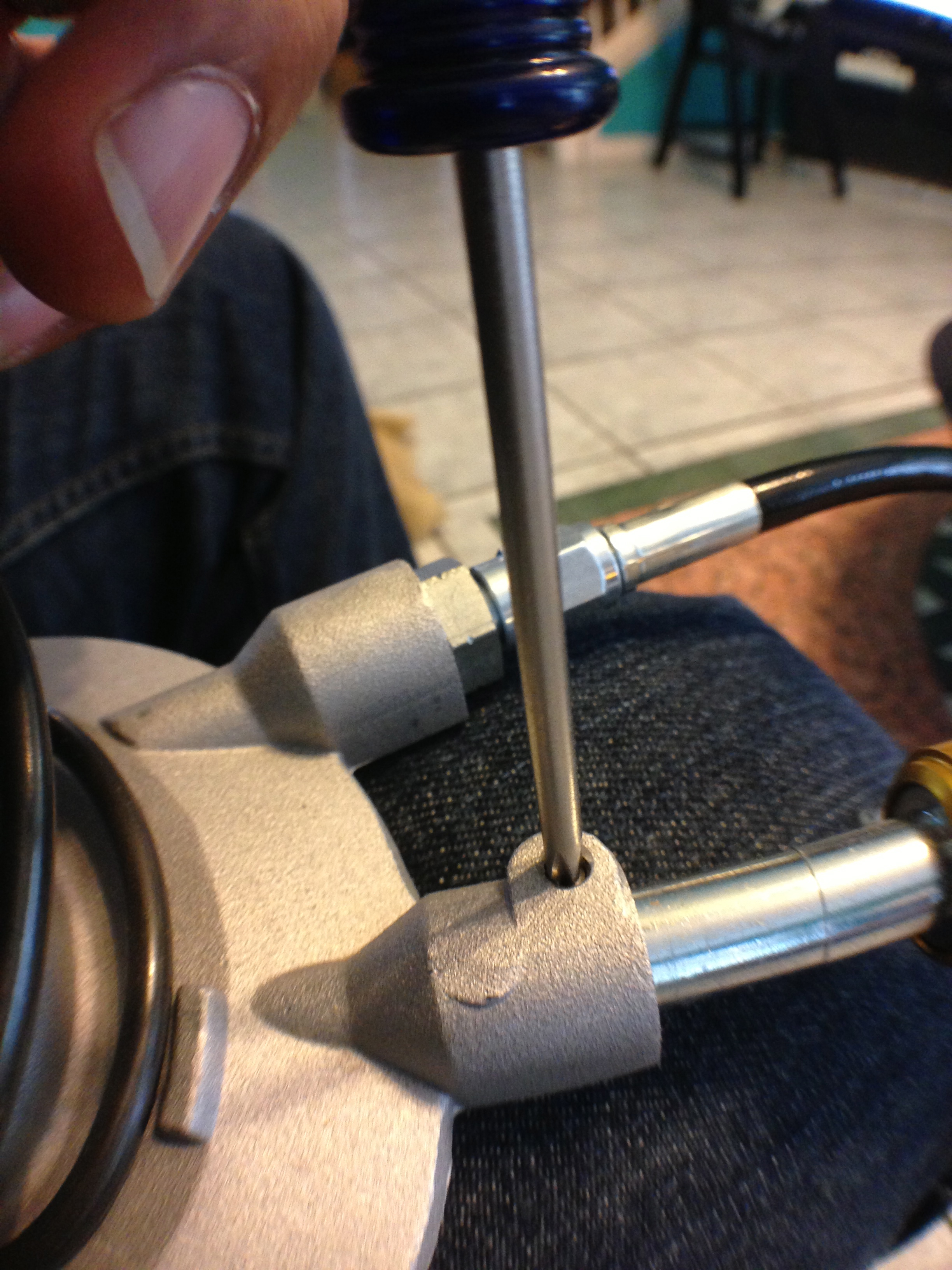

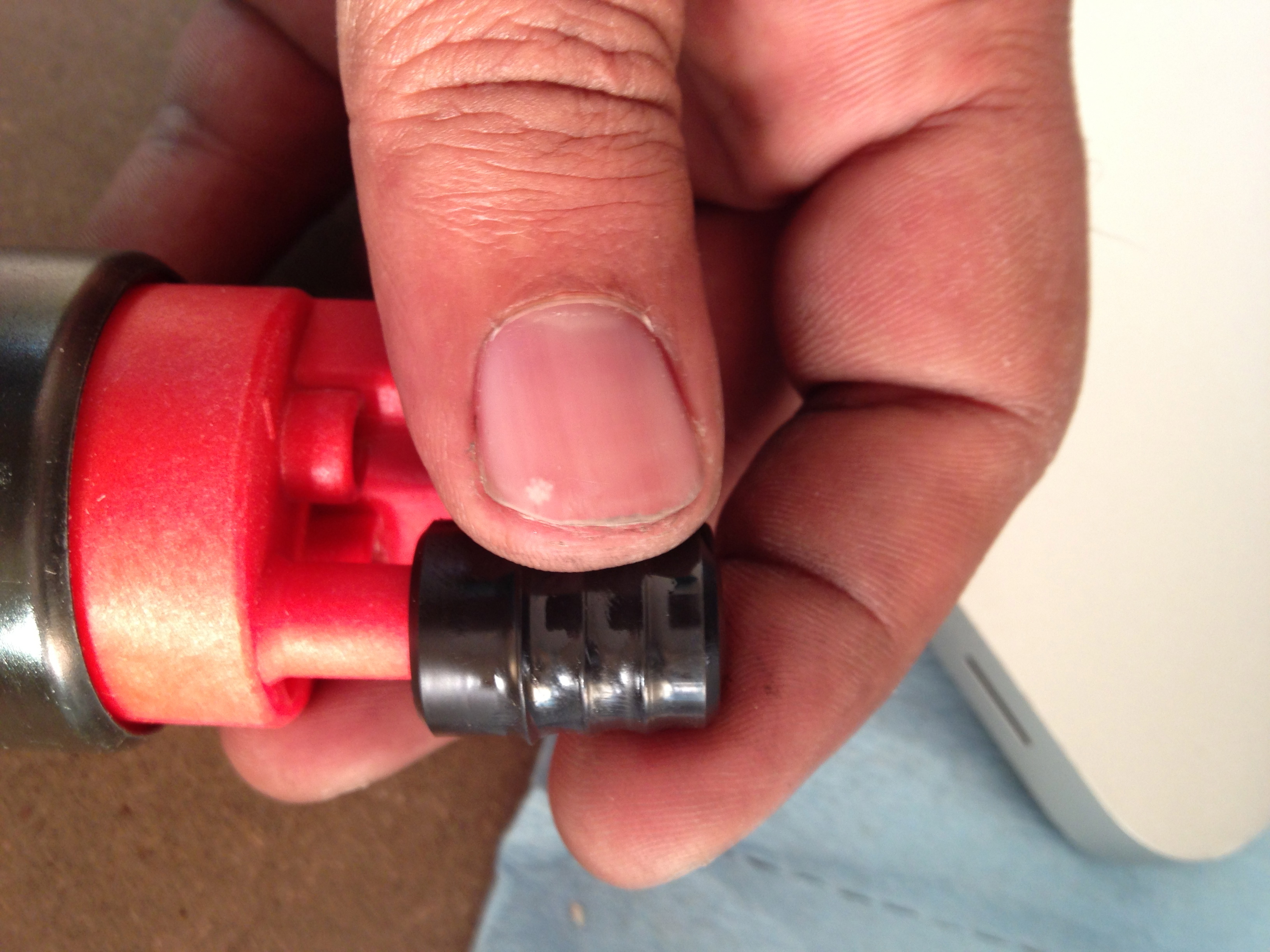

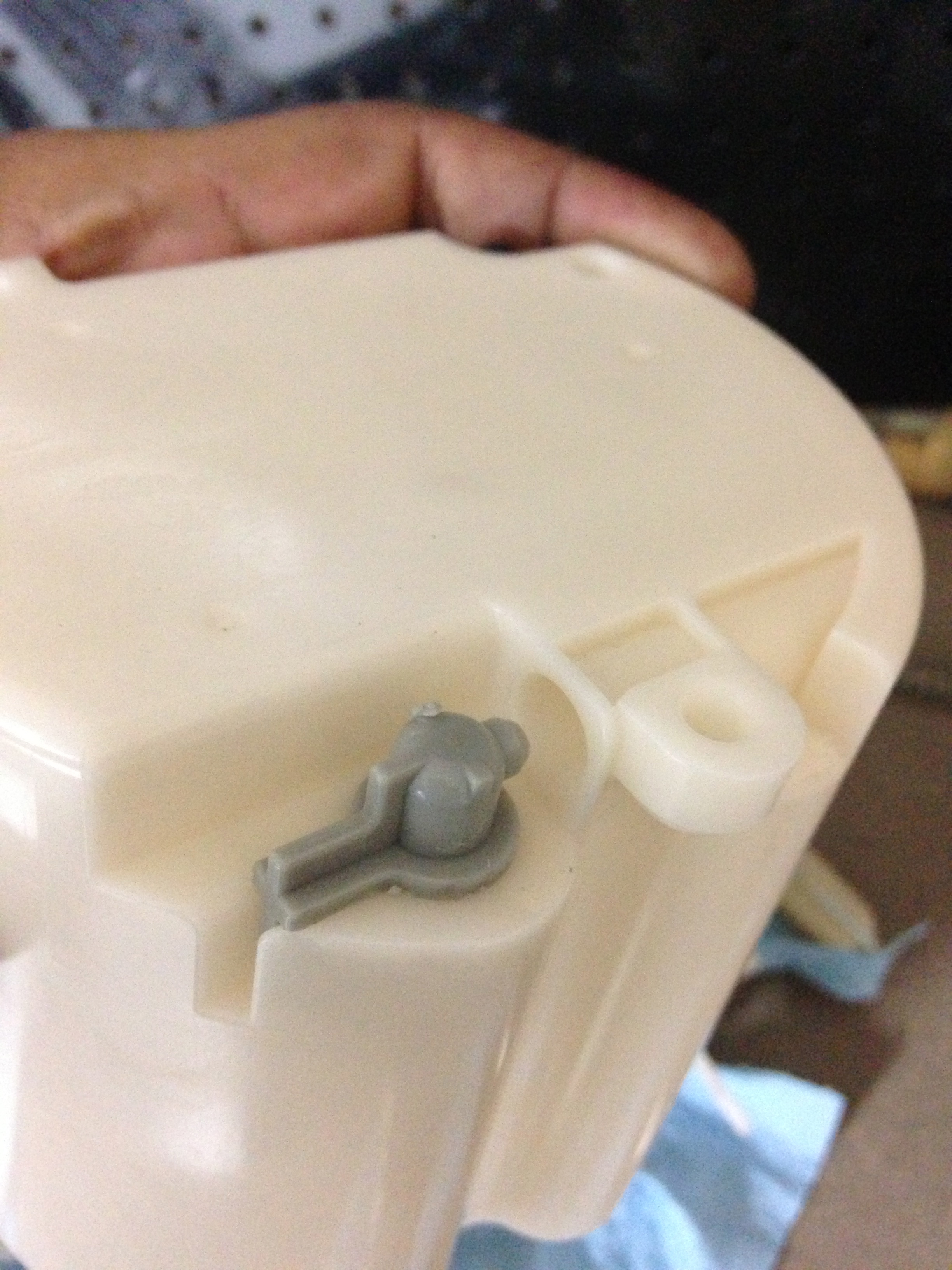

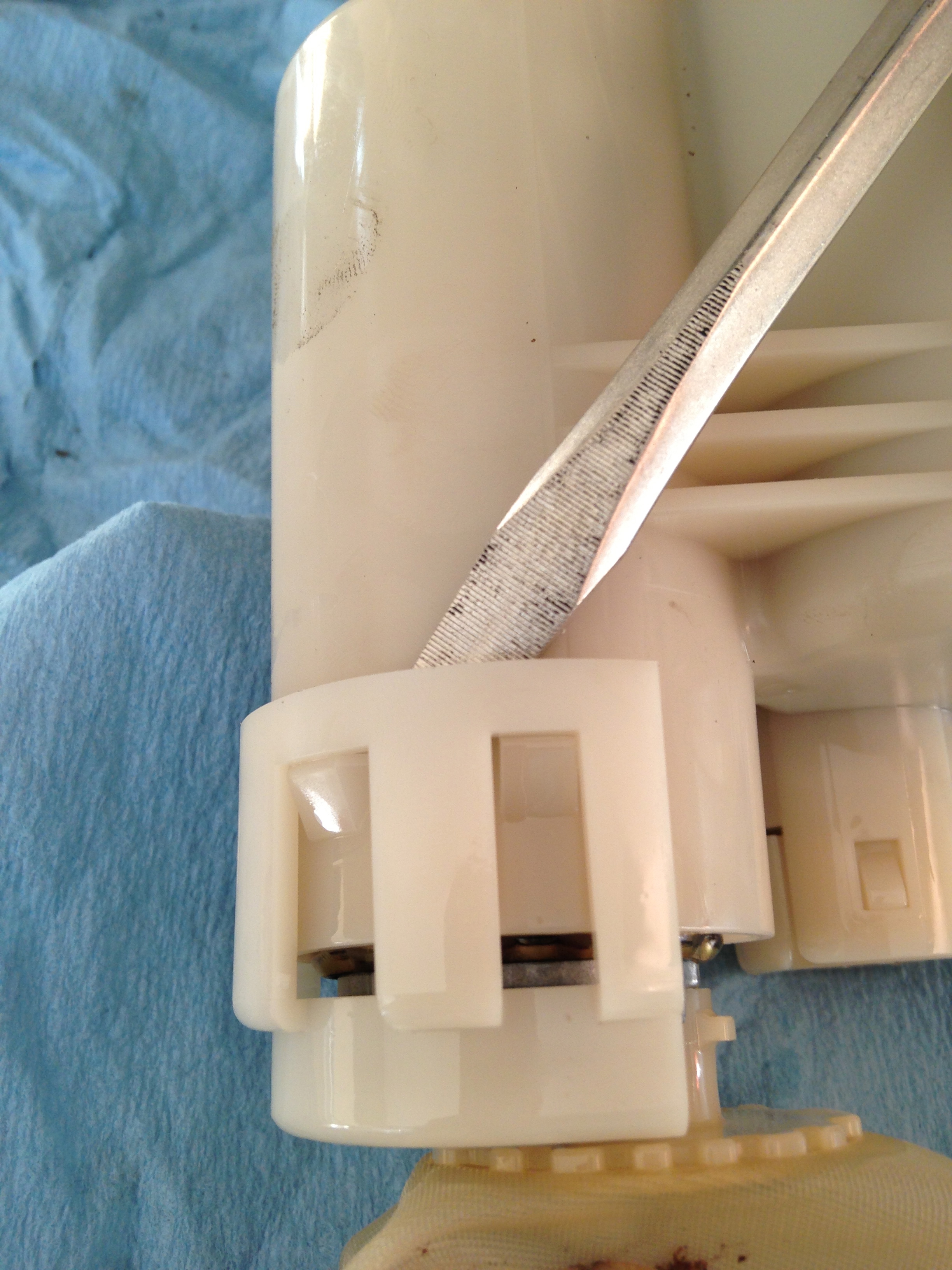

You have to shave done some of the cap to make it fit.
Drill this sucker, if not you will have a rough idle..

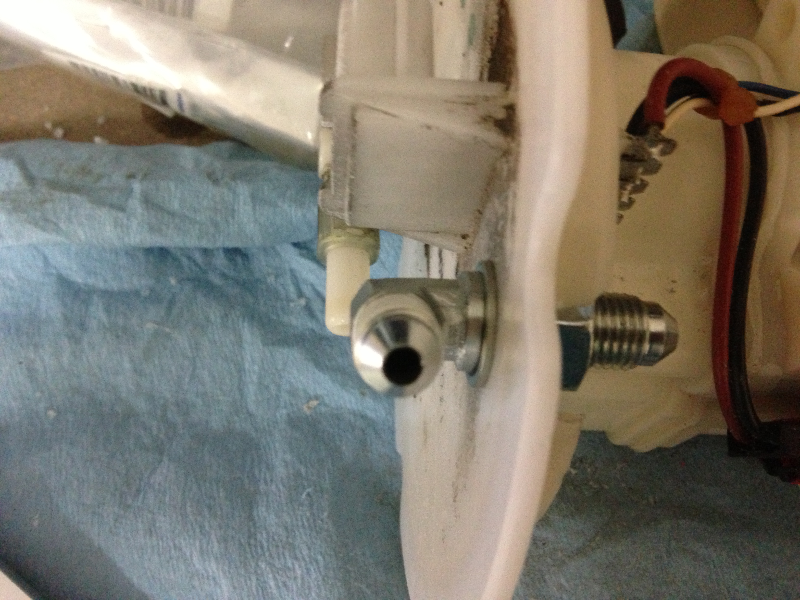

Pop back in
Time to install the return line.. Drill whole
install fitting
Another view from underneath

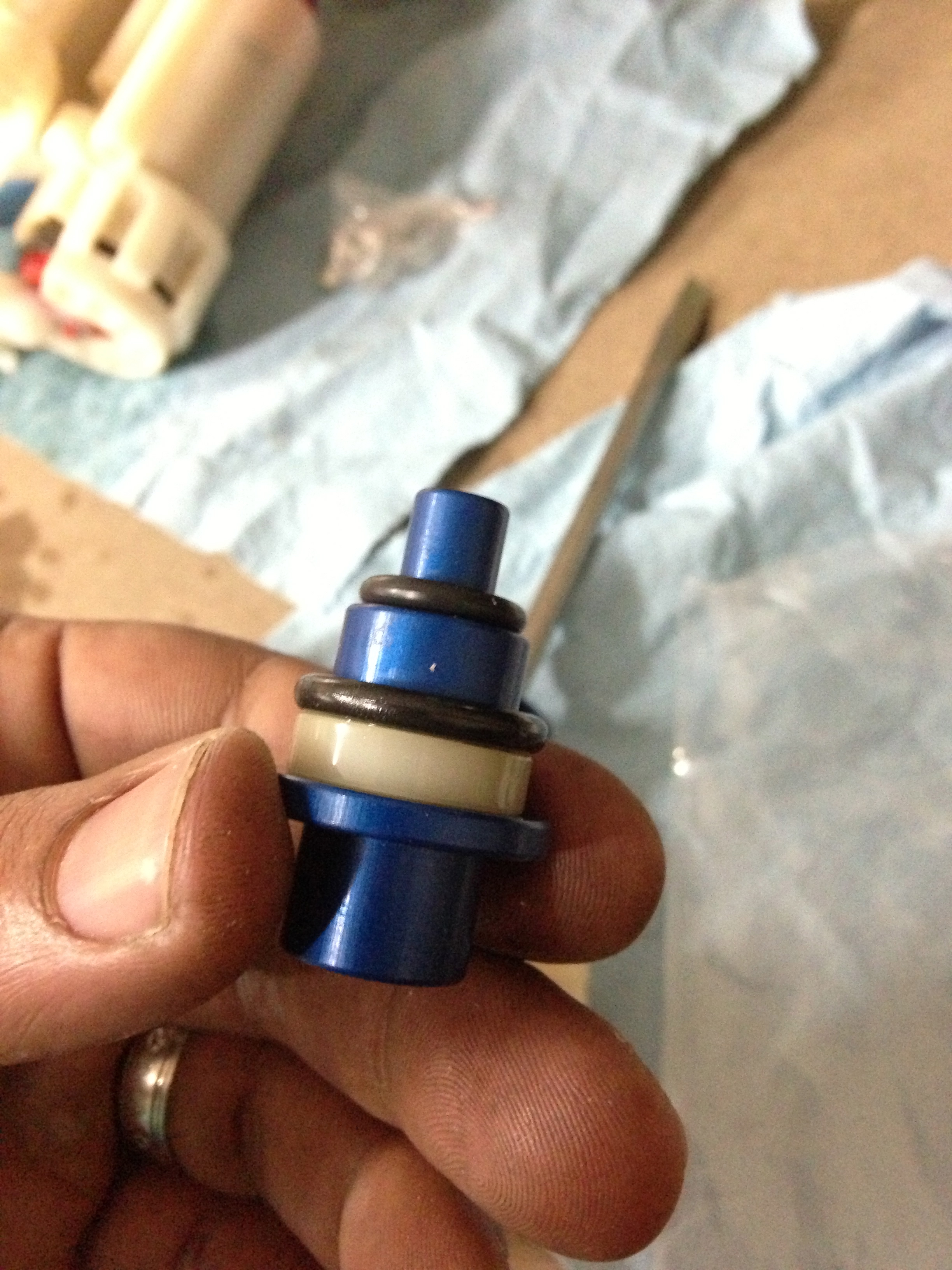

install this guy and make sure all the seals are in place

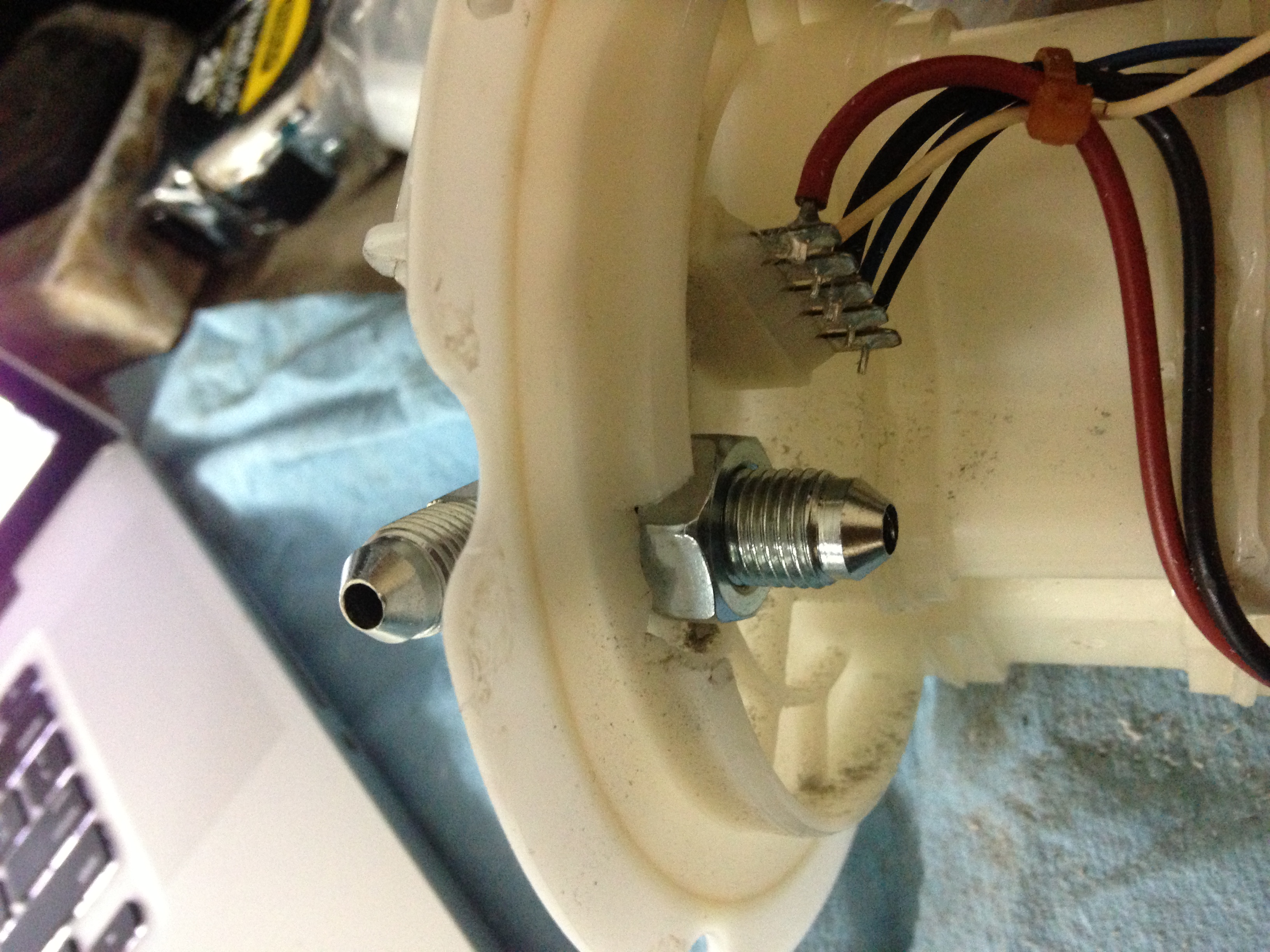

Install line to it

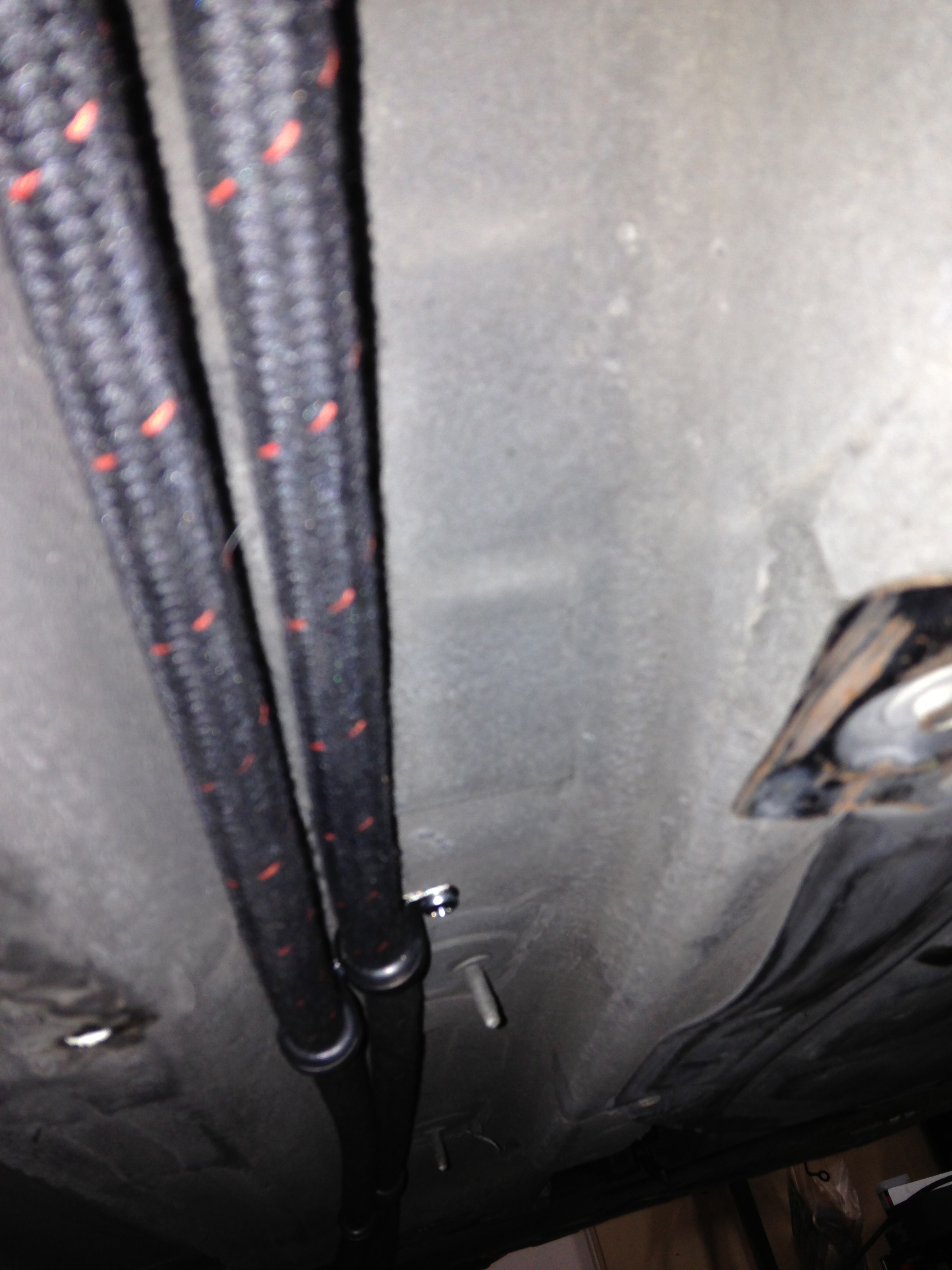

Run the line to the top

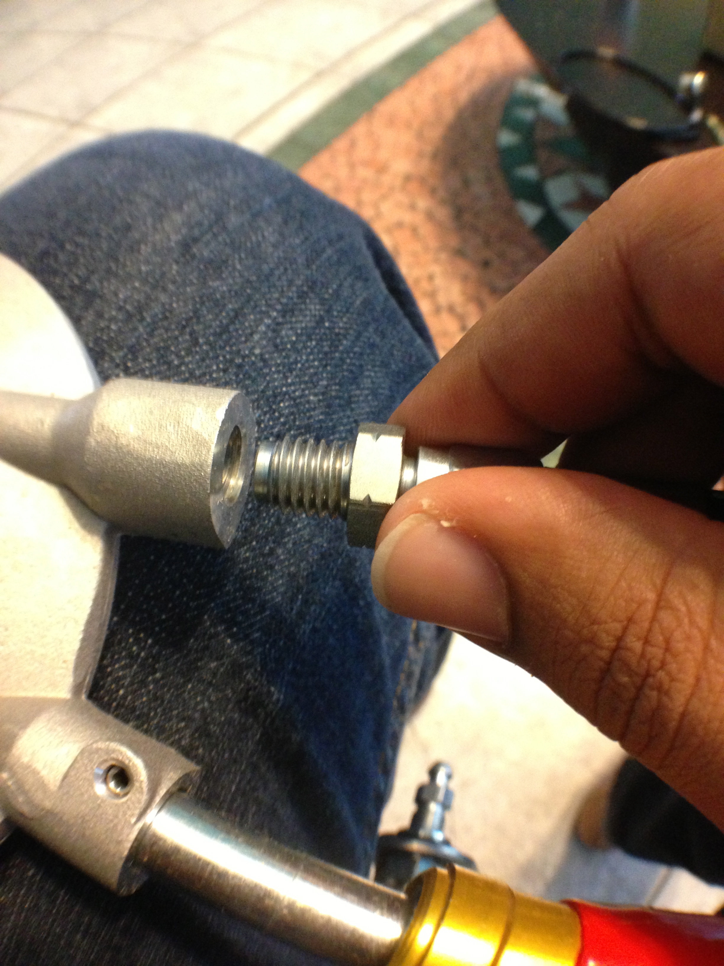

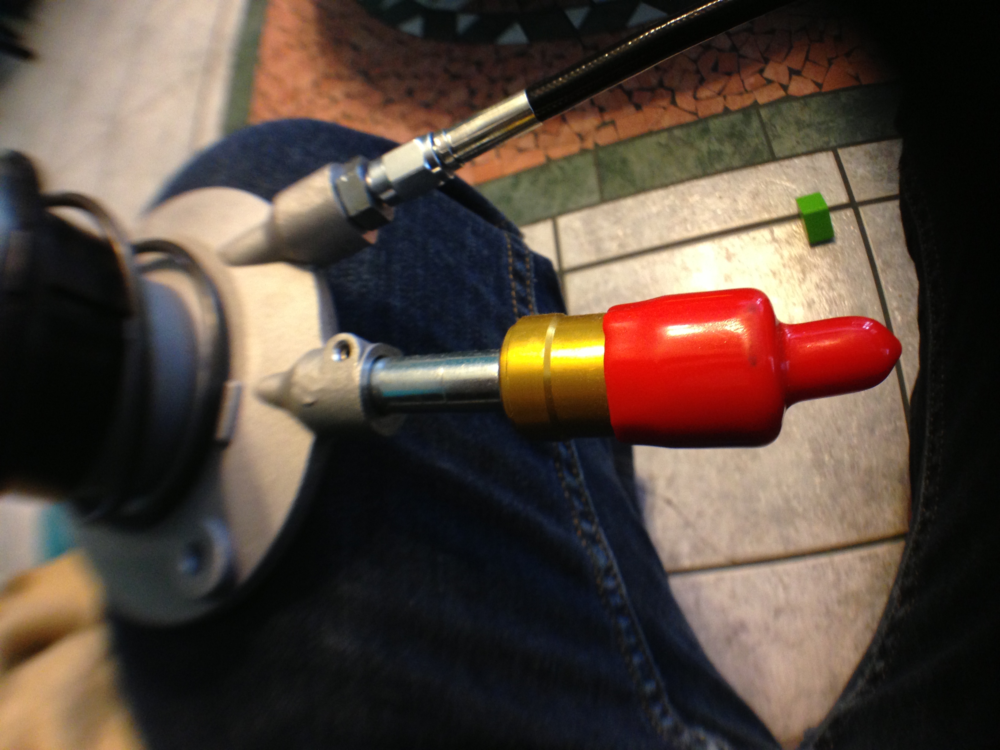

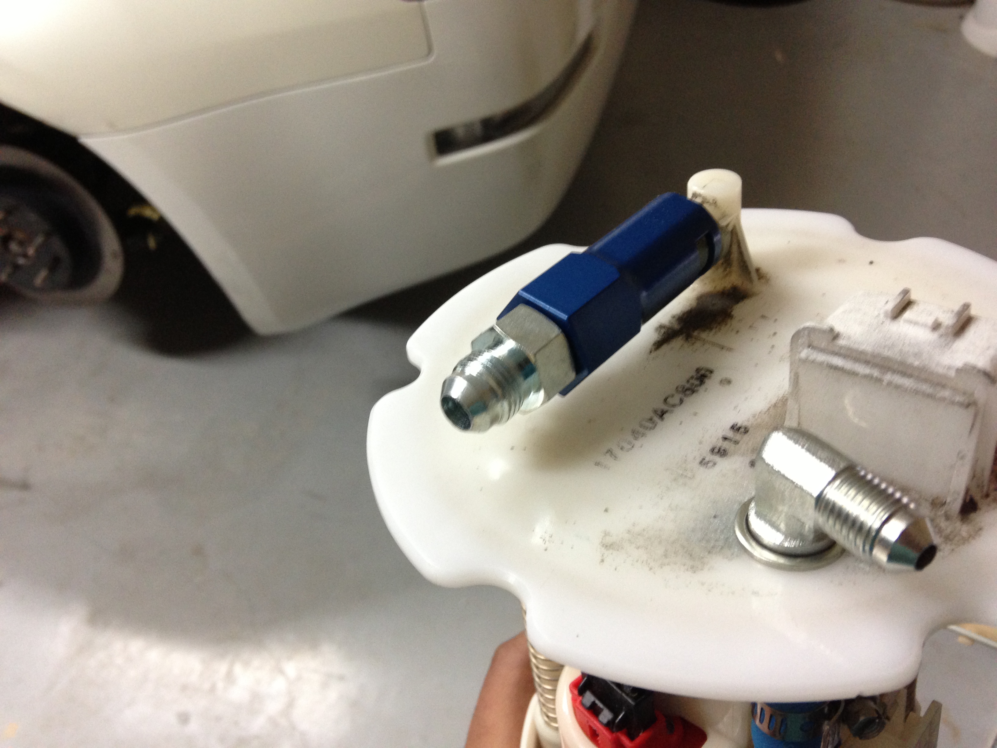

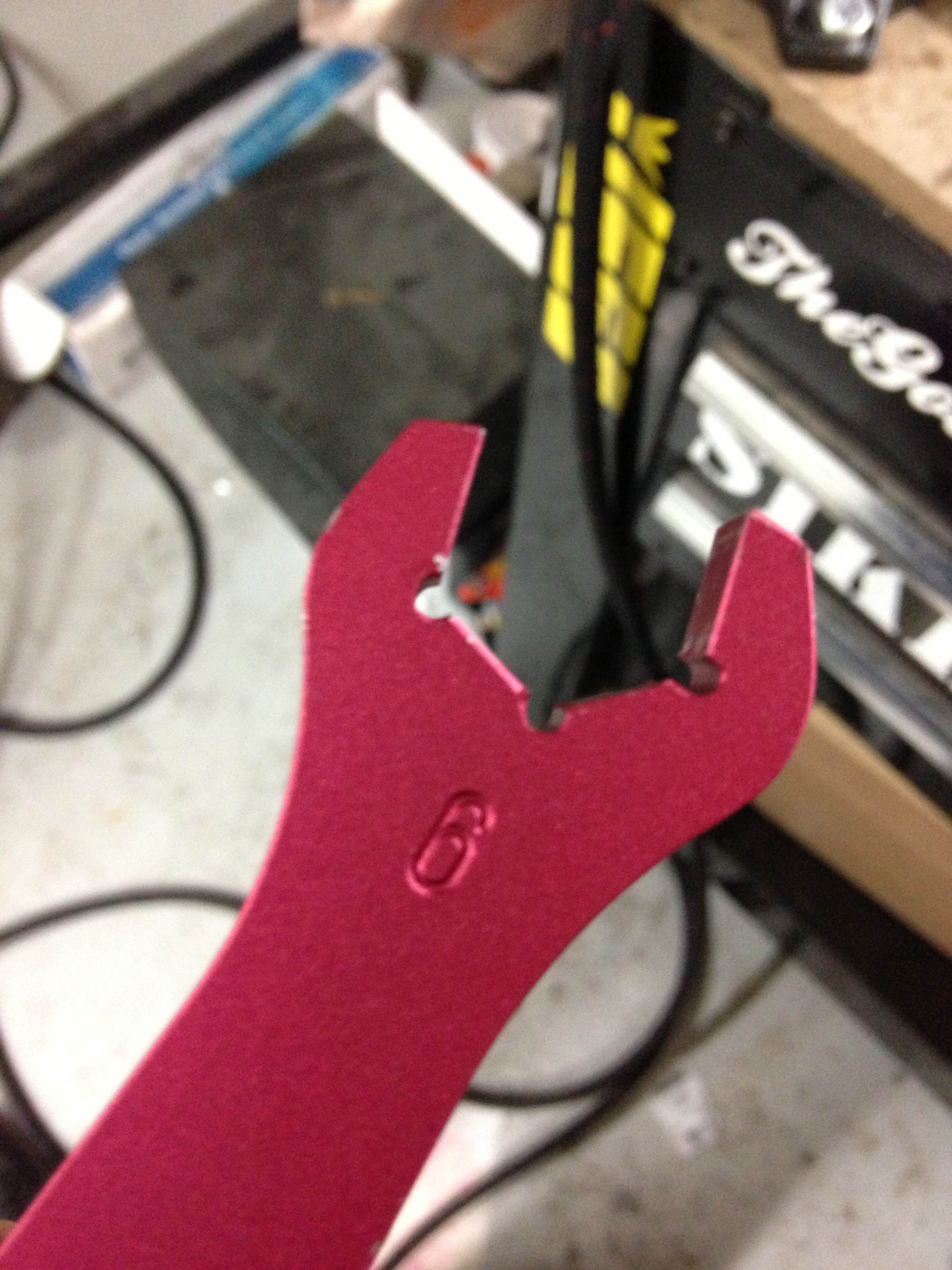

Next install the OEM Pump To -6AN..
Complete!! Now just place back in the car

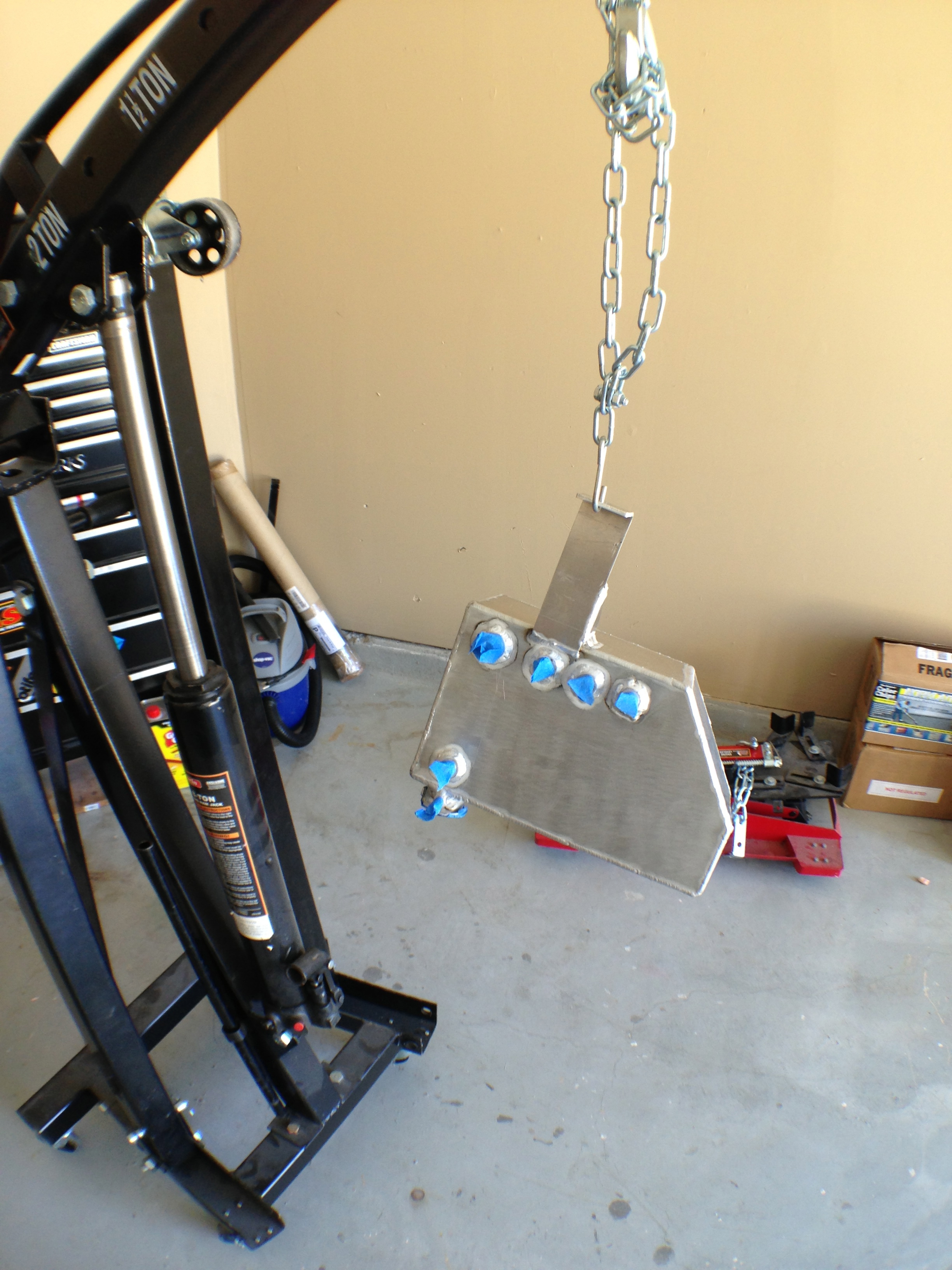

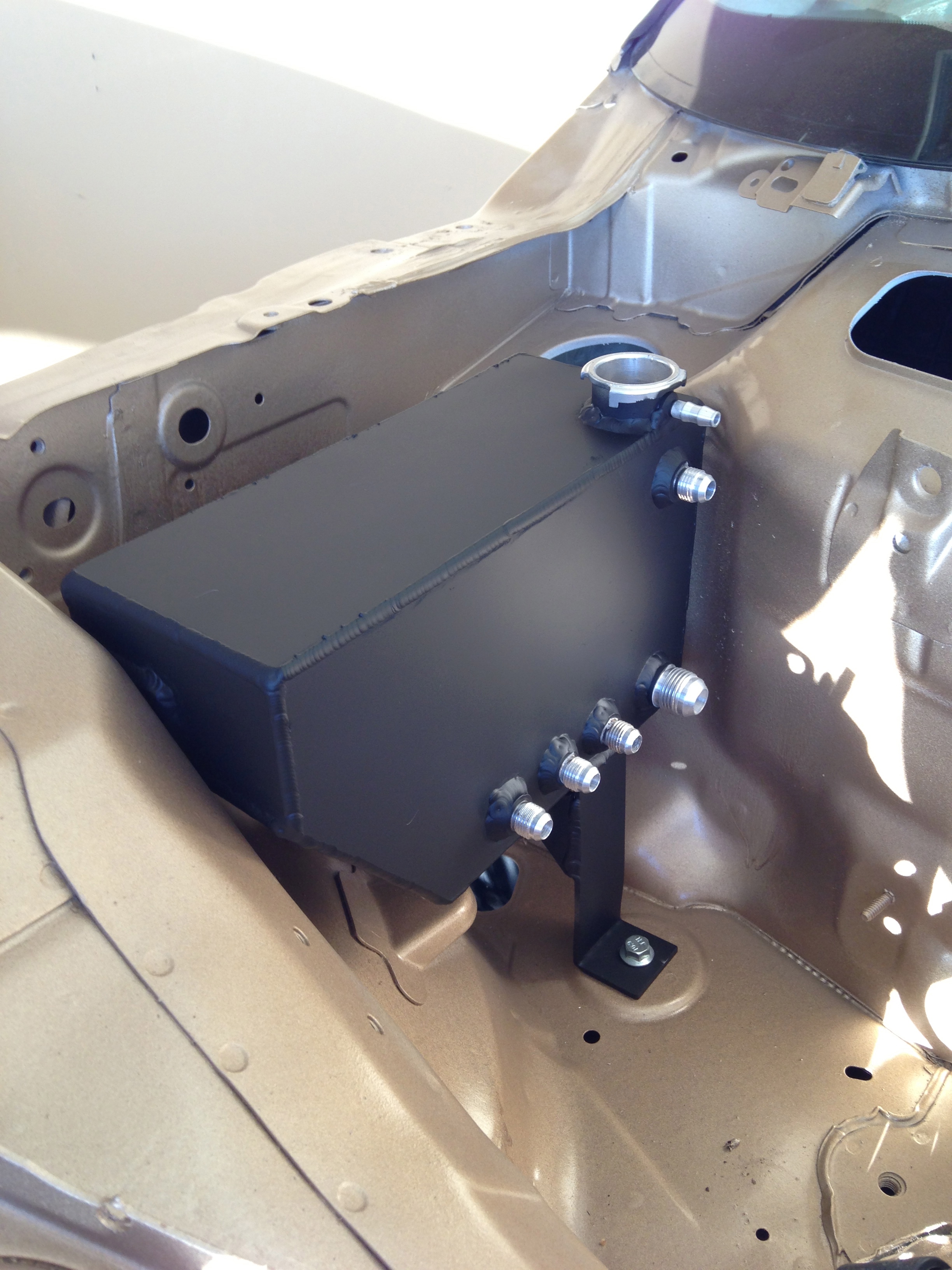

So painted my Coolant tank
And reinstalled.. I think it looks 10times better

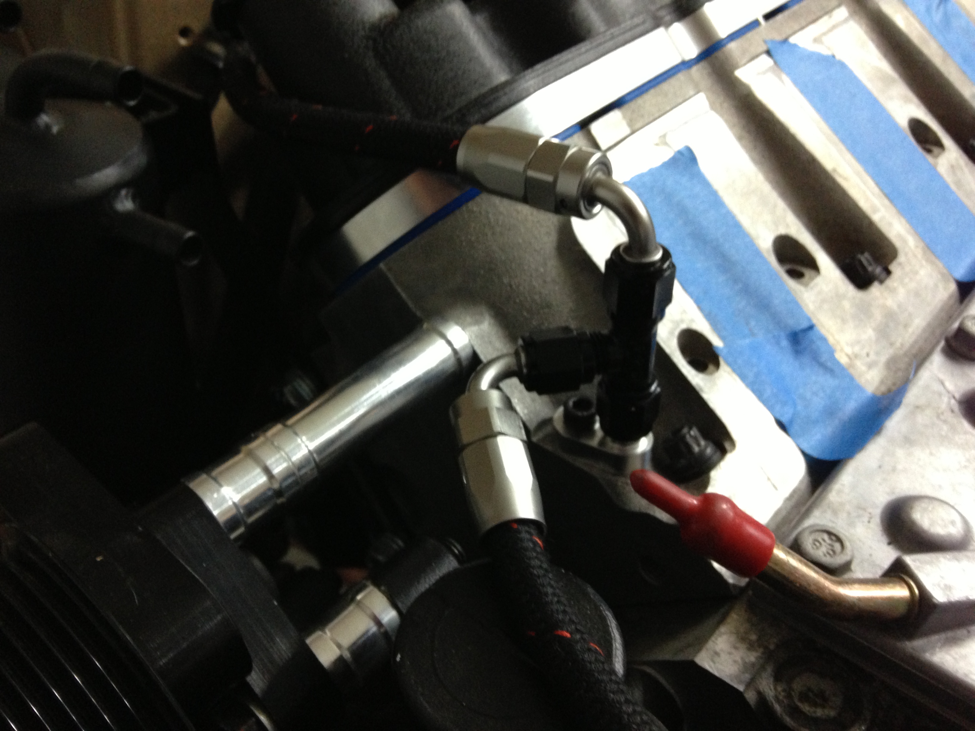

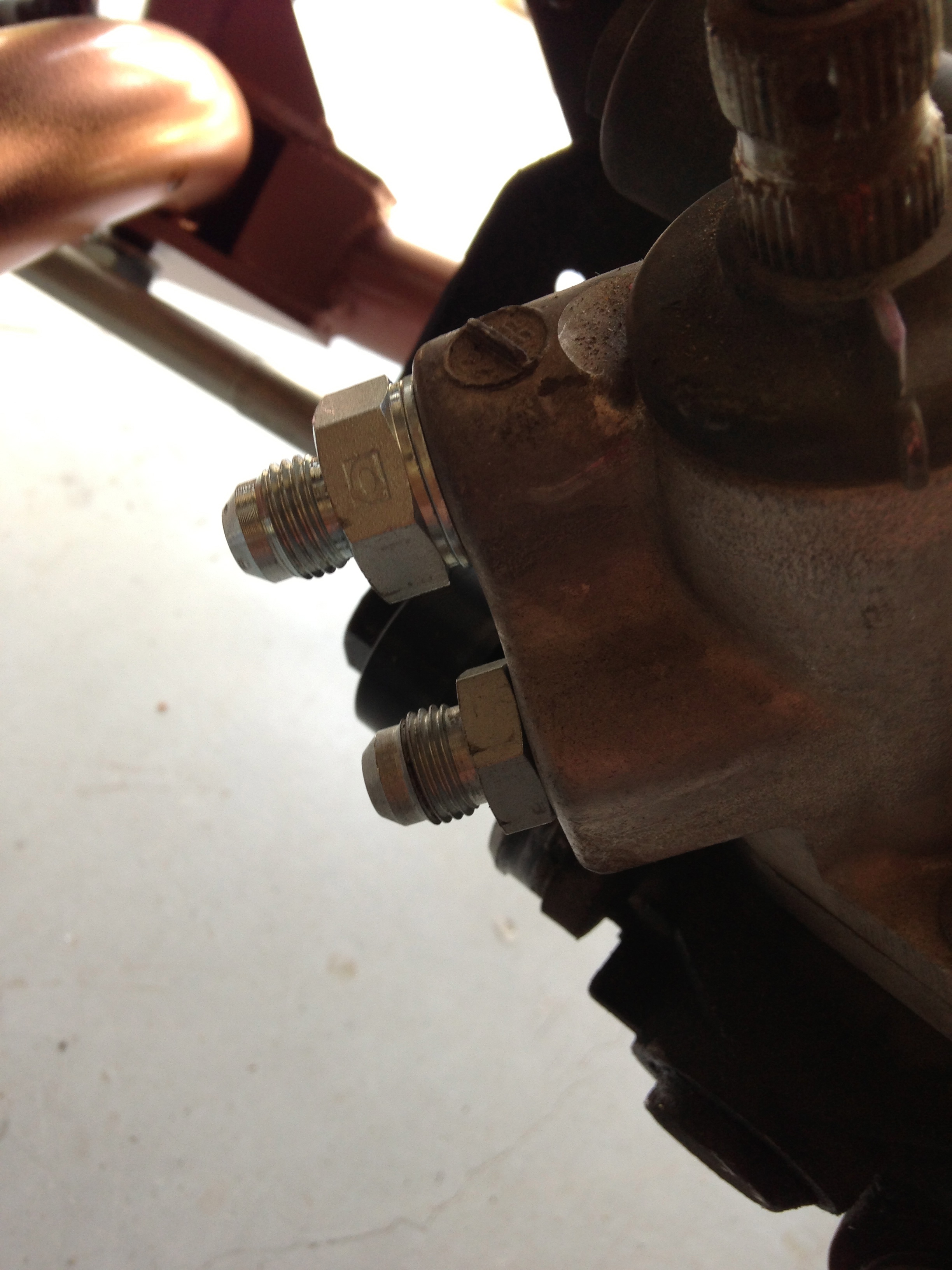

Also while the engine was out I installed my new fittings for my power steering rack

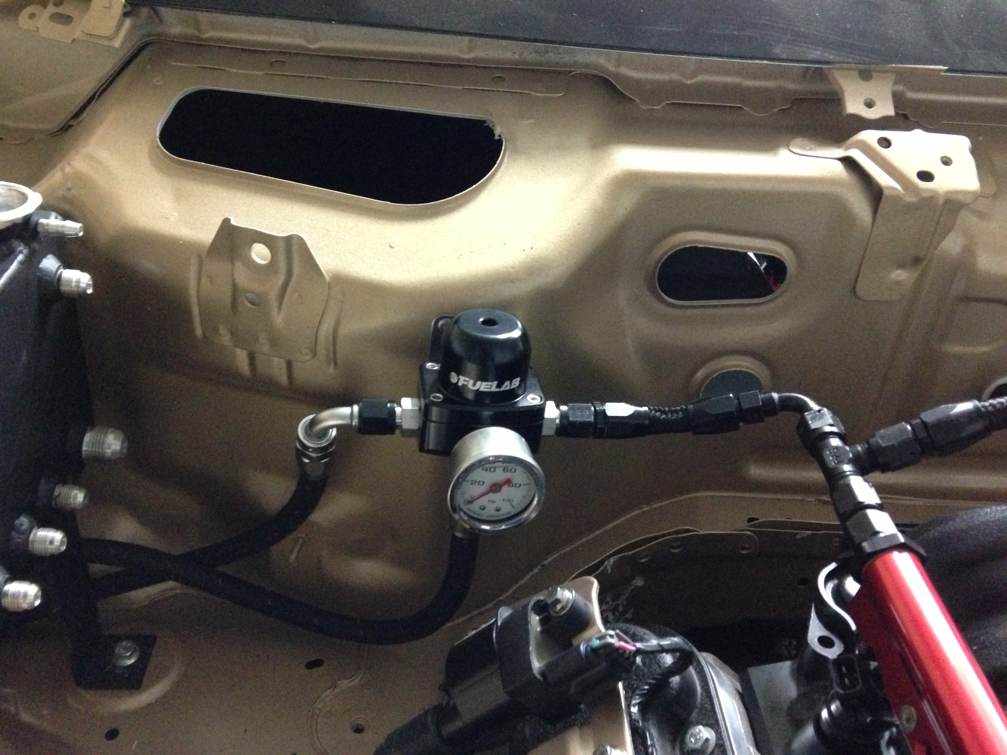

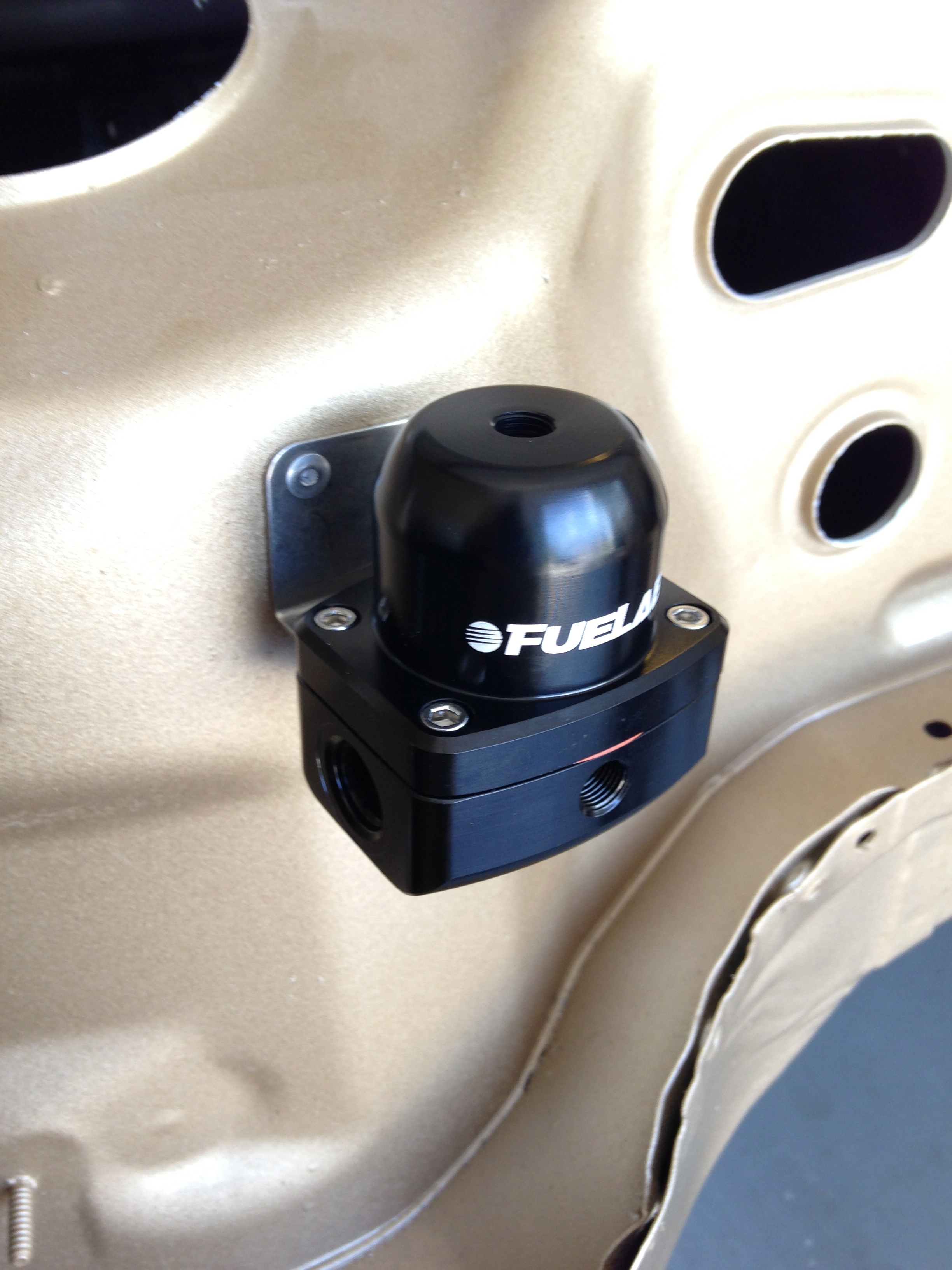

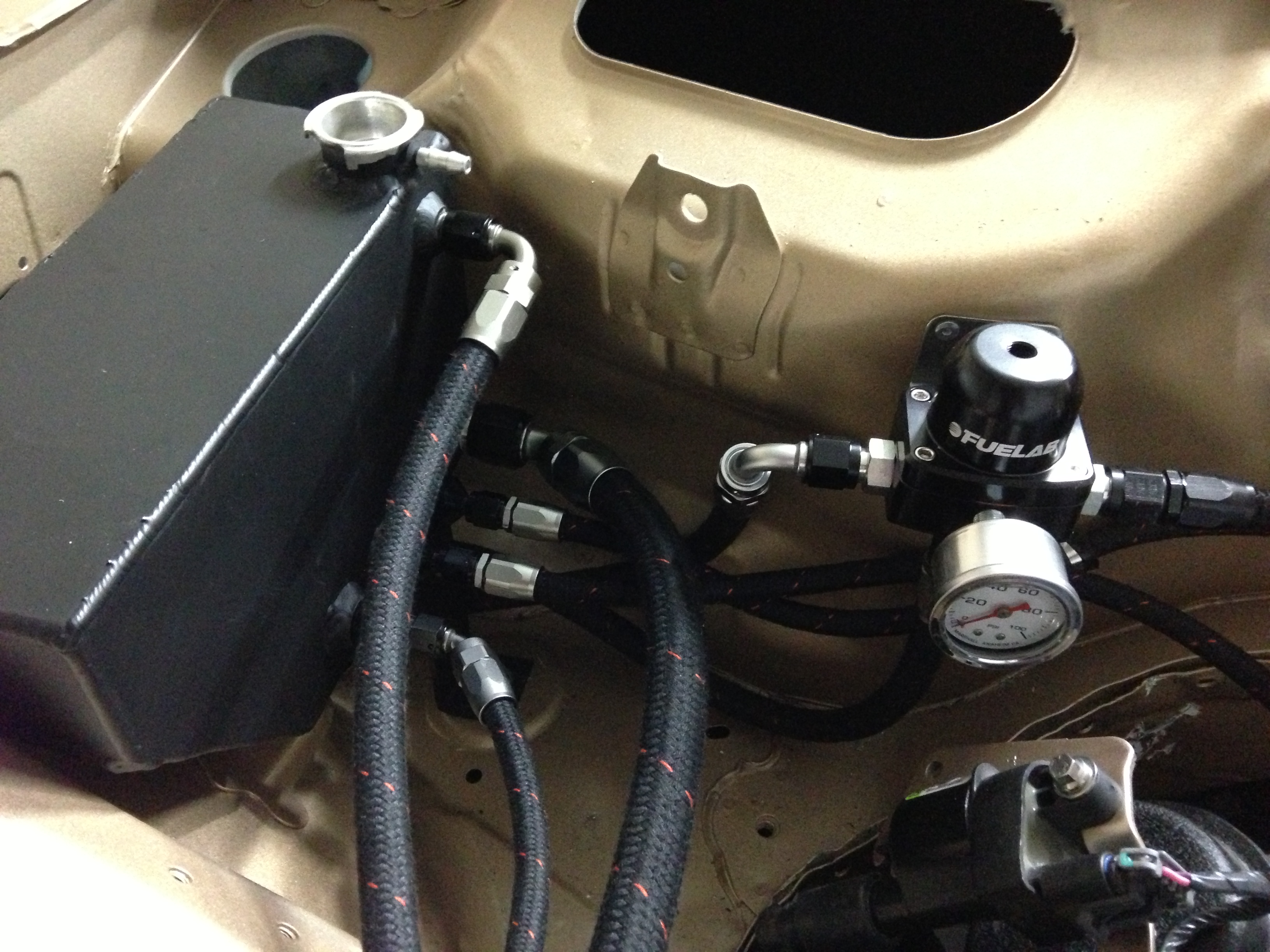

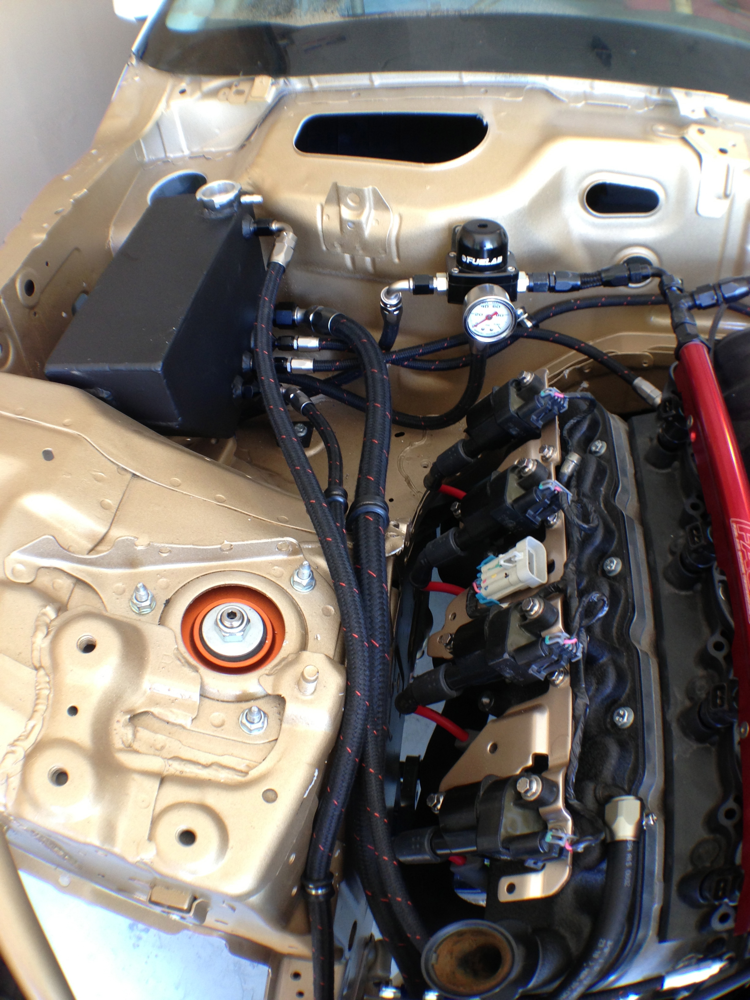

Also started to install my Fuel Pump Regulator
Old Apr 14, 2013 | 05:05 PM
  #587
Royal_T's Avatar
Royal_T
Joined: Sep 2004
Posts: 2,840
Likes: 14
From: San Antonio, TX
Installed

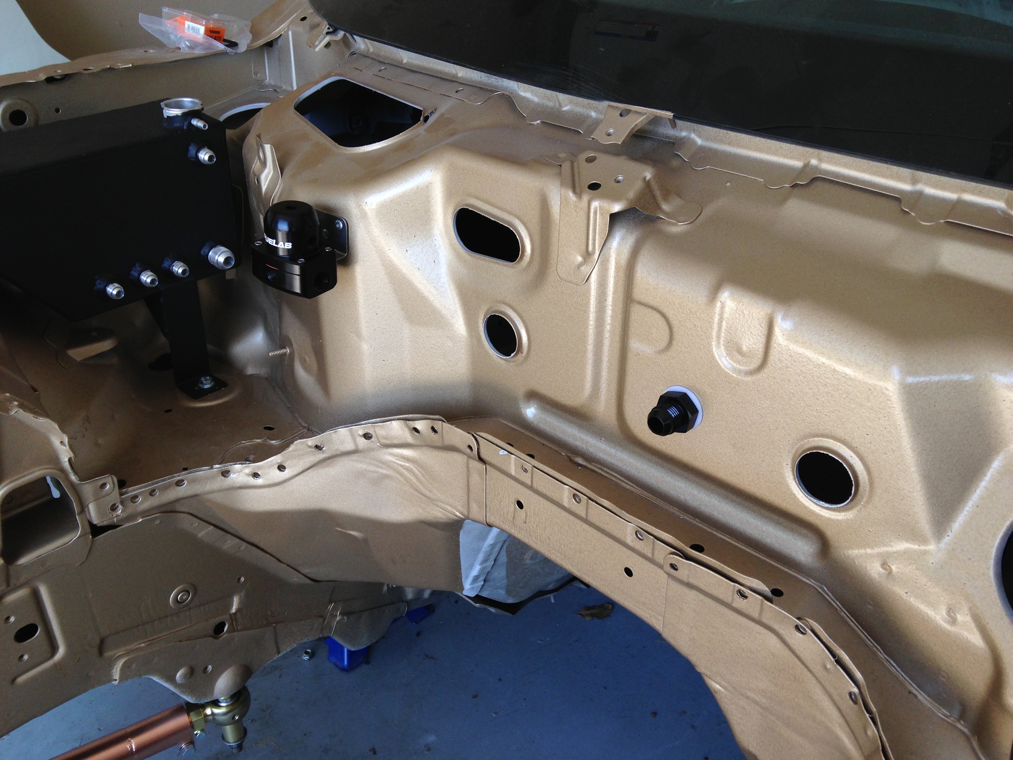

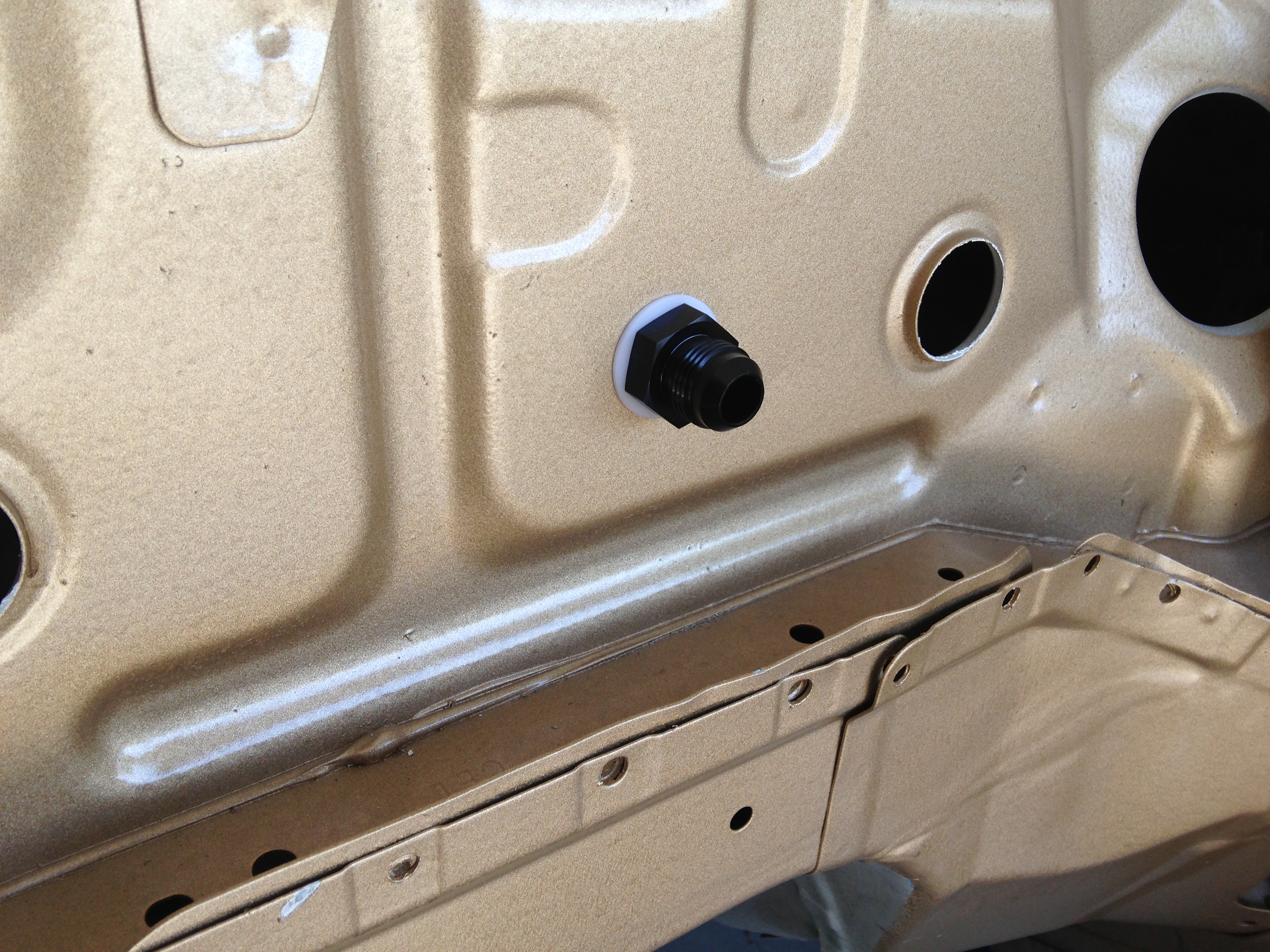

Also installed my bulkhead for my oil line to my Accusump
View of all of them installed

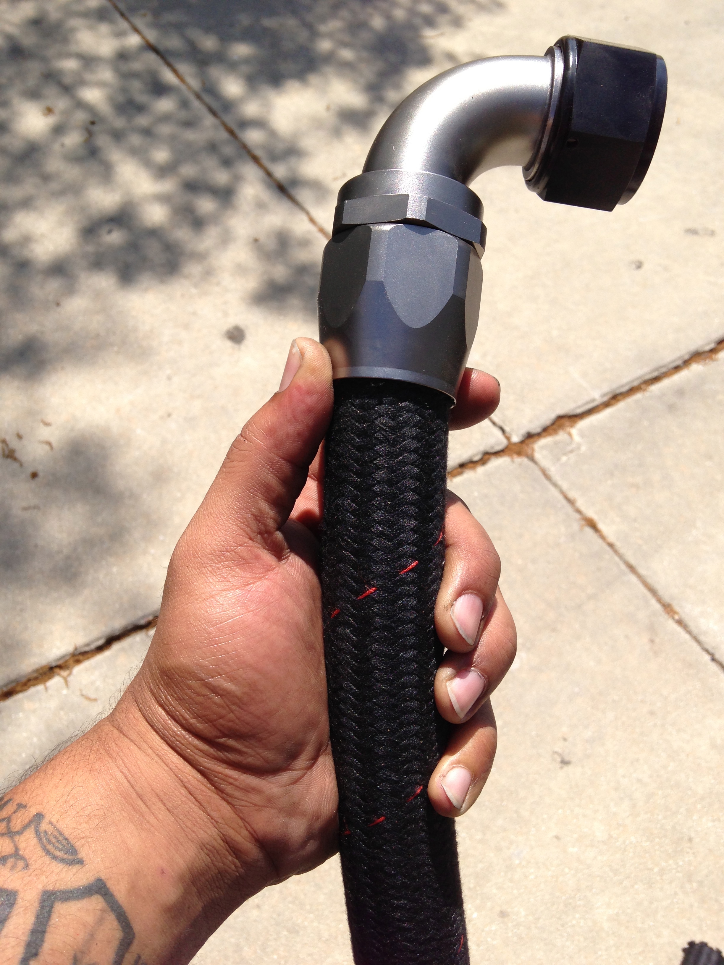

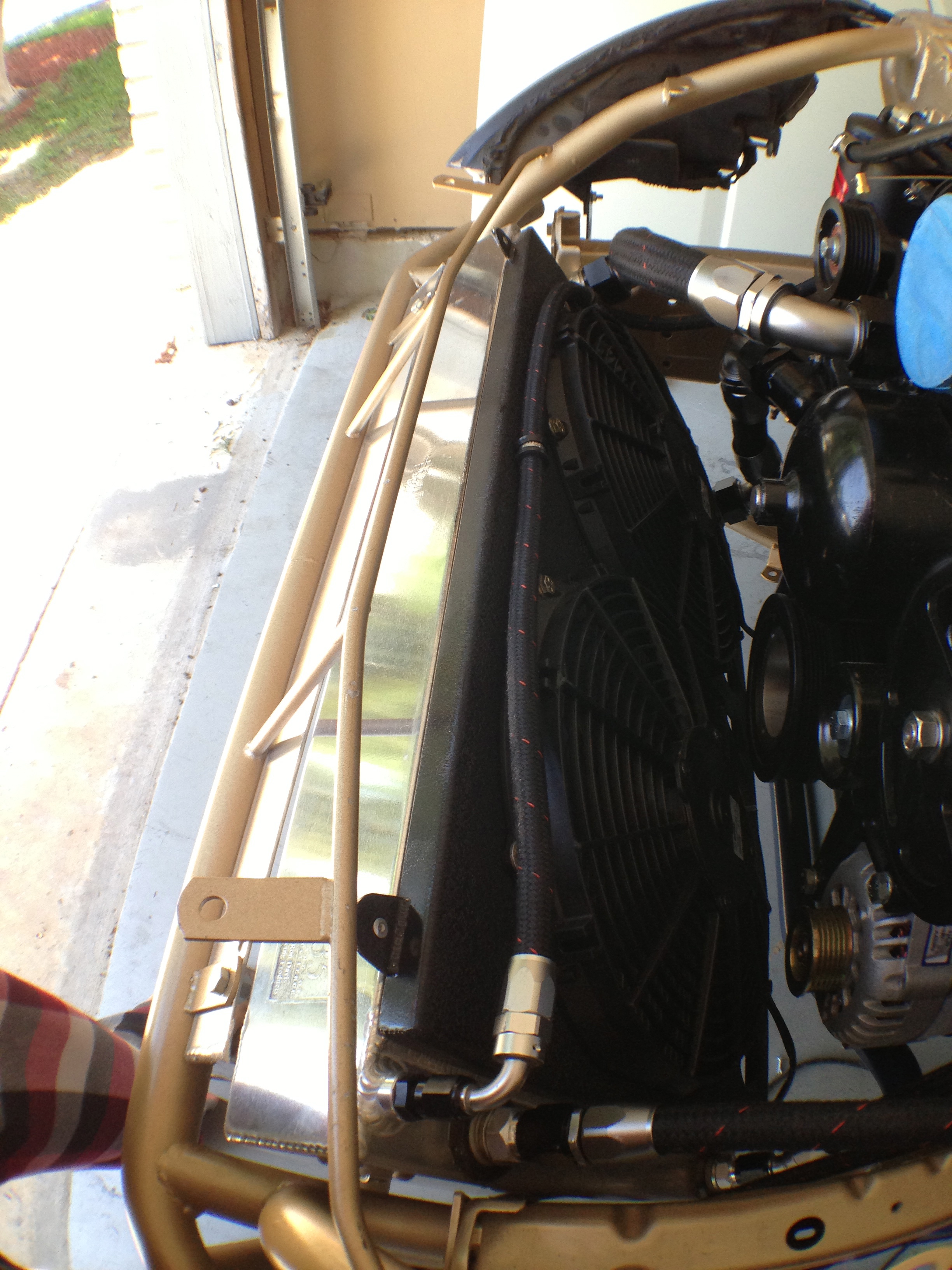

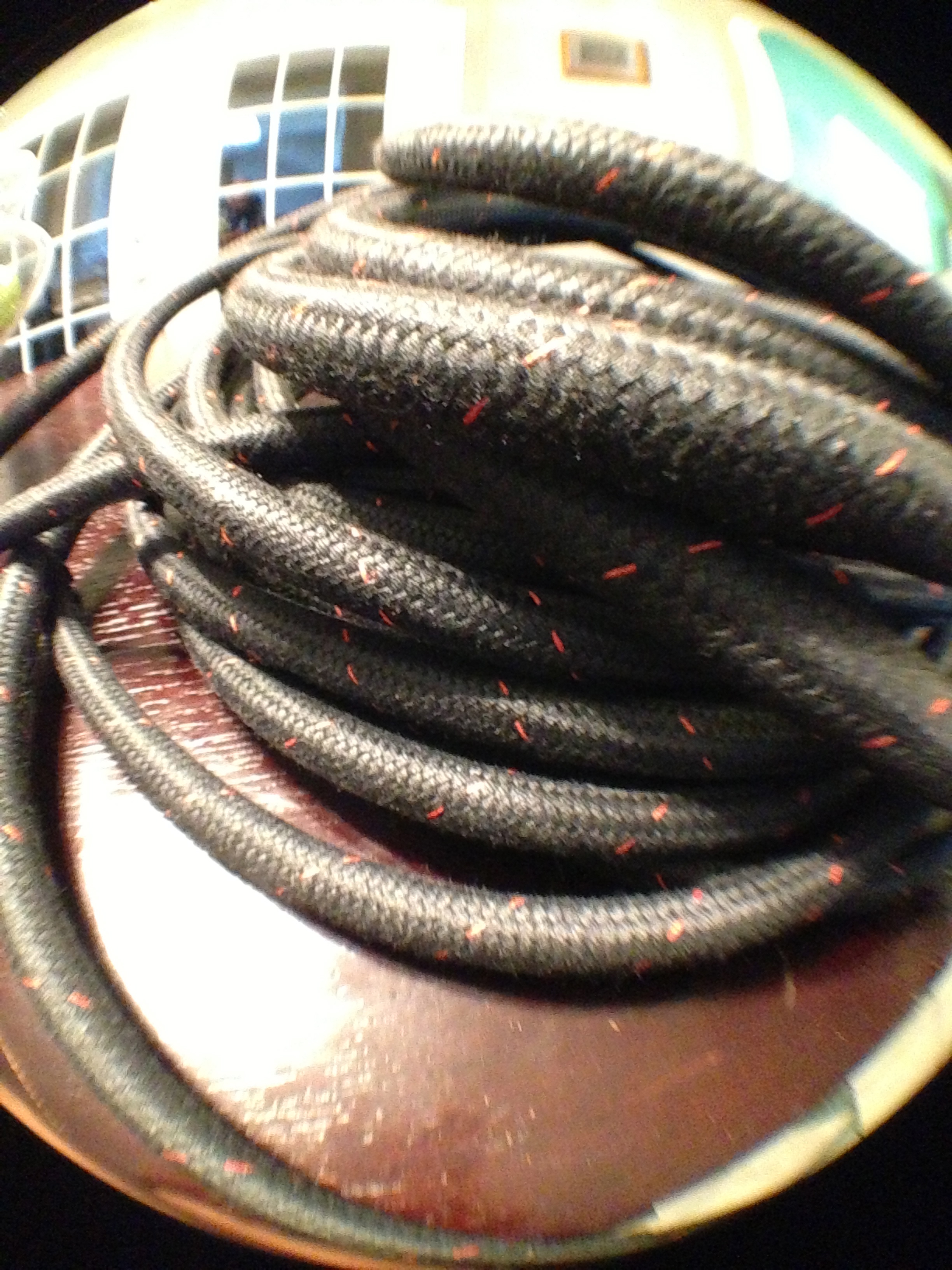

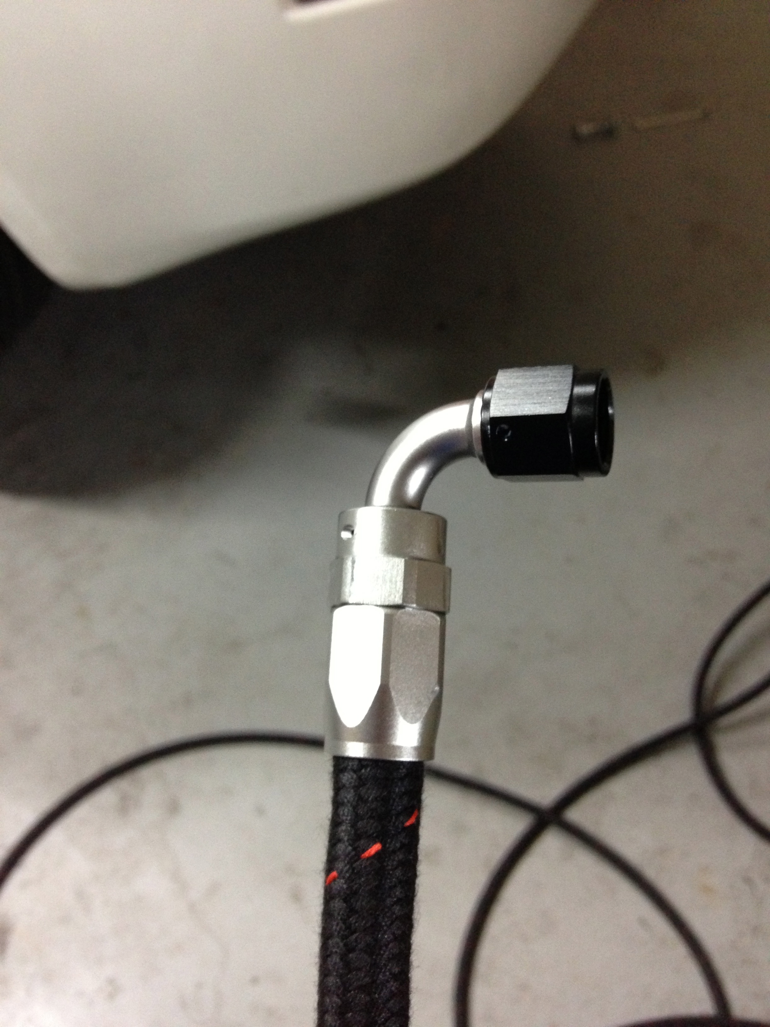

Also started getting my fittings and lines in.. This is what the color scheme is going to look like.. Keep it classy

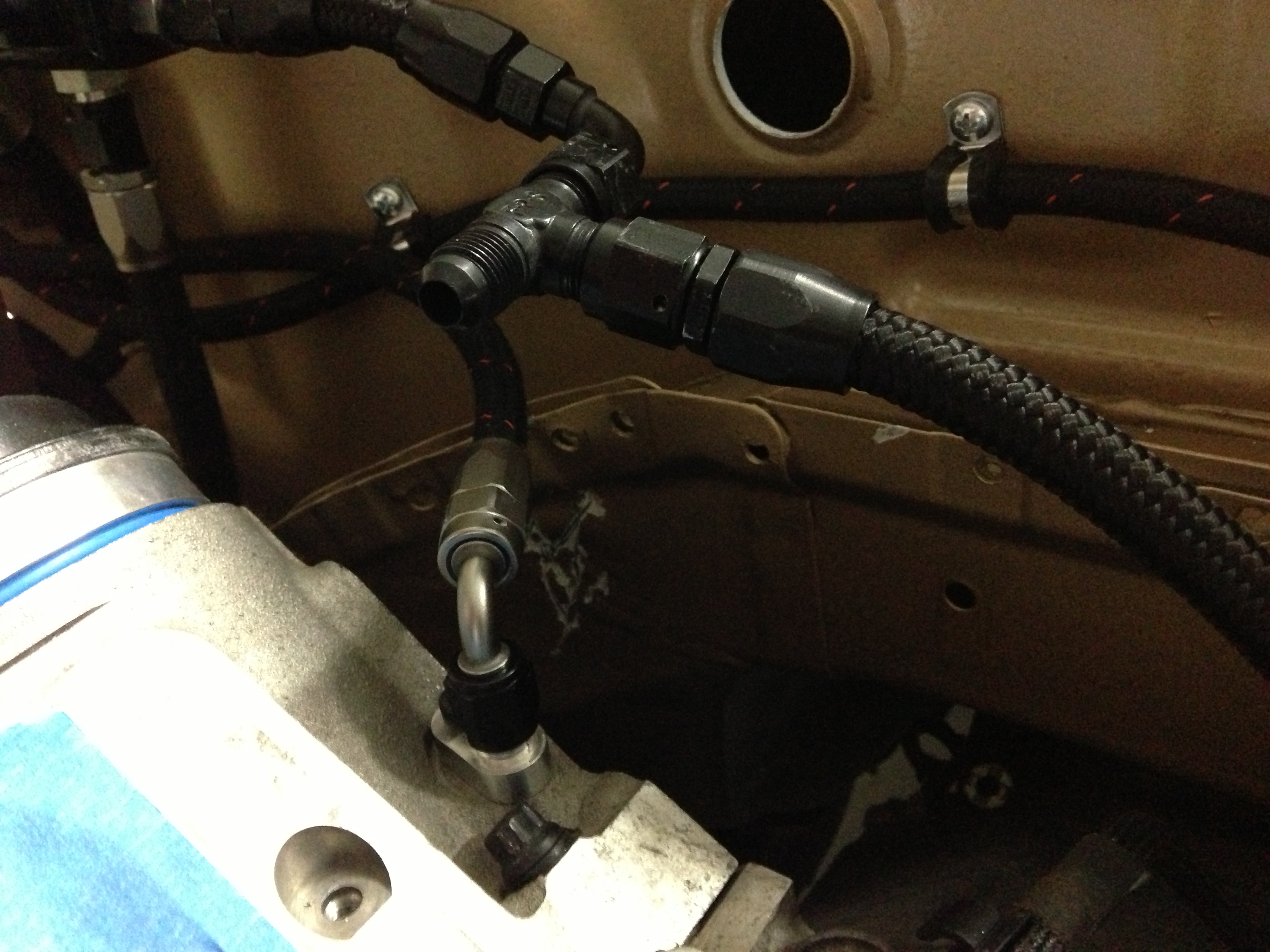

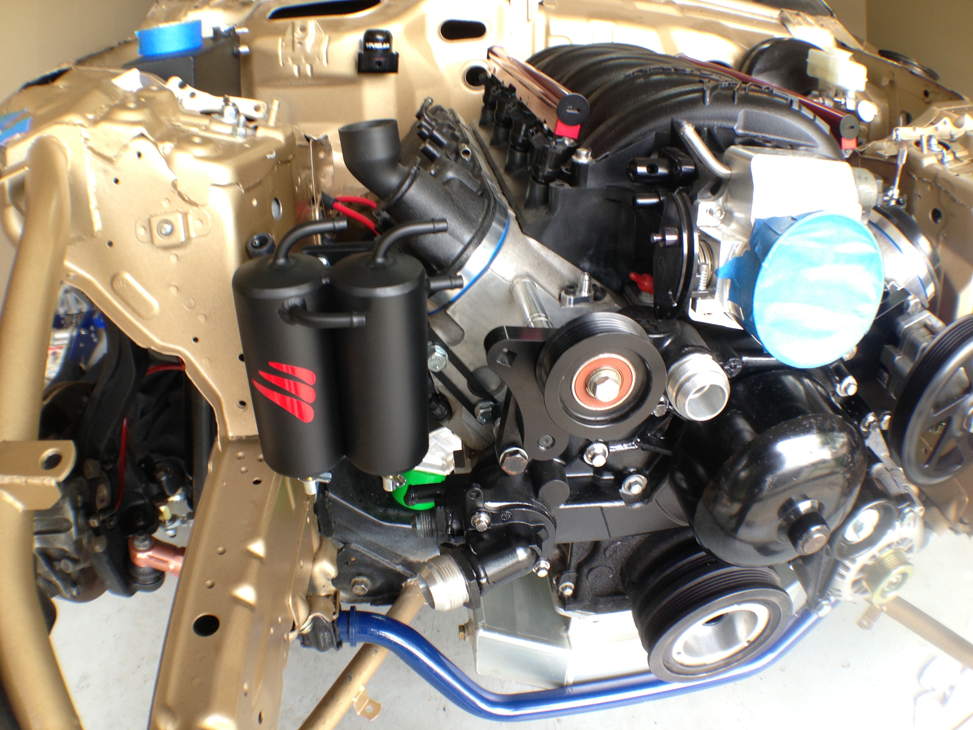

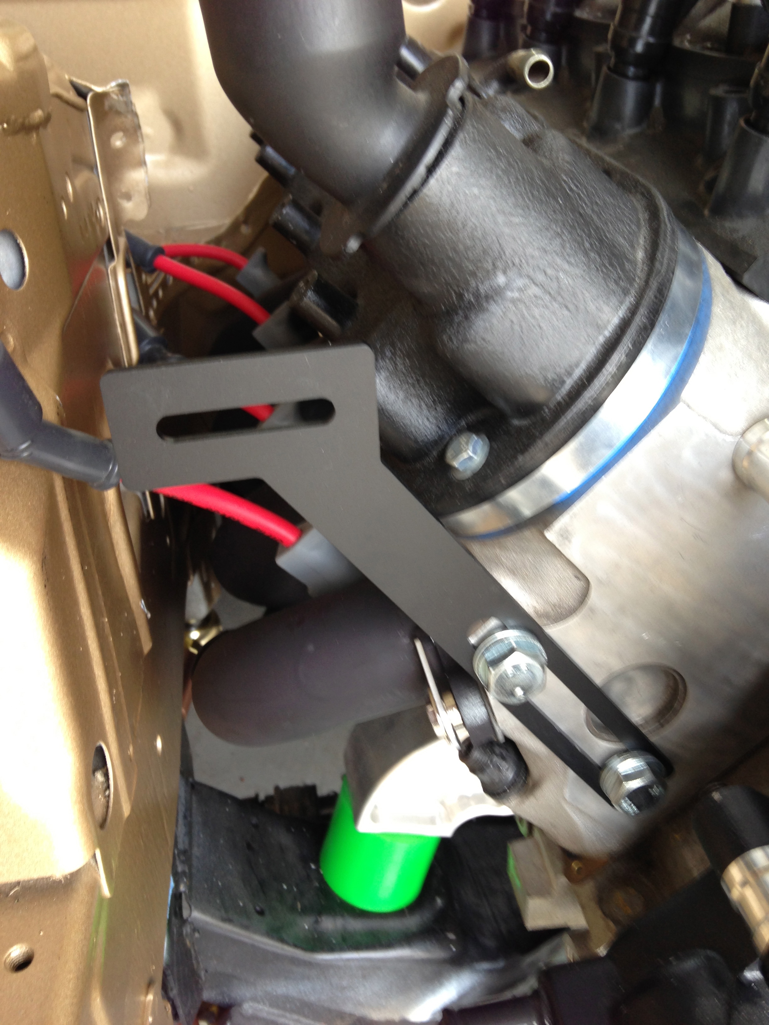

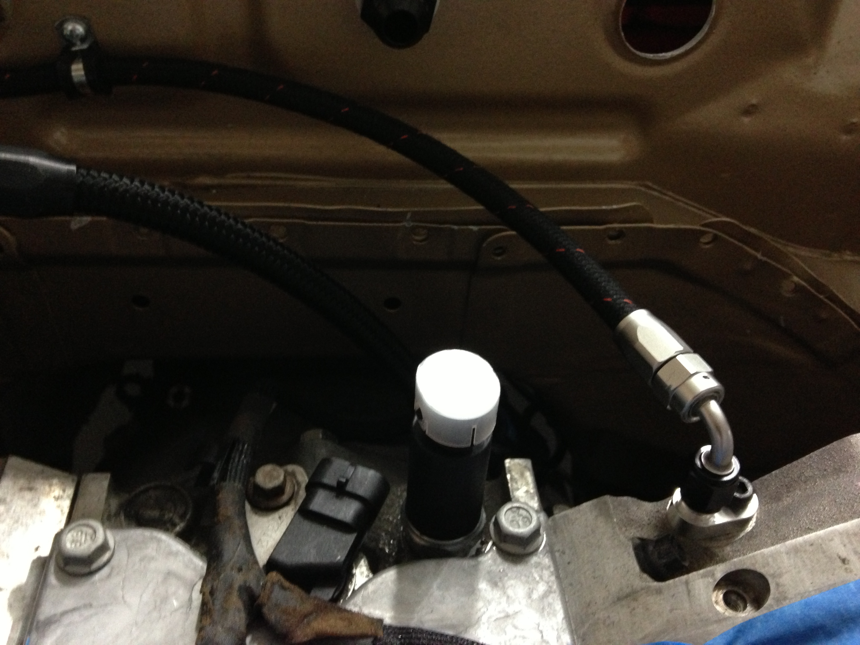

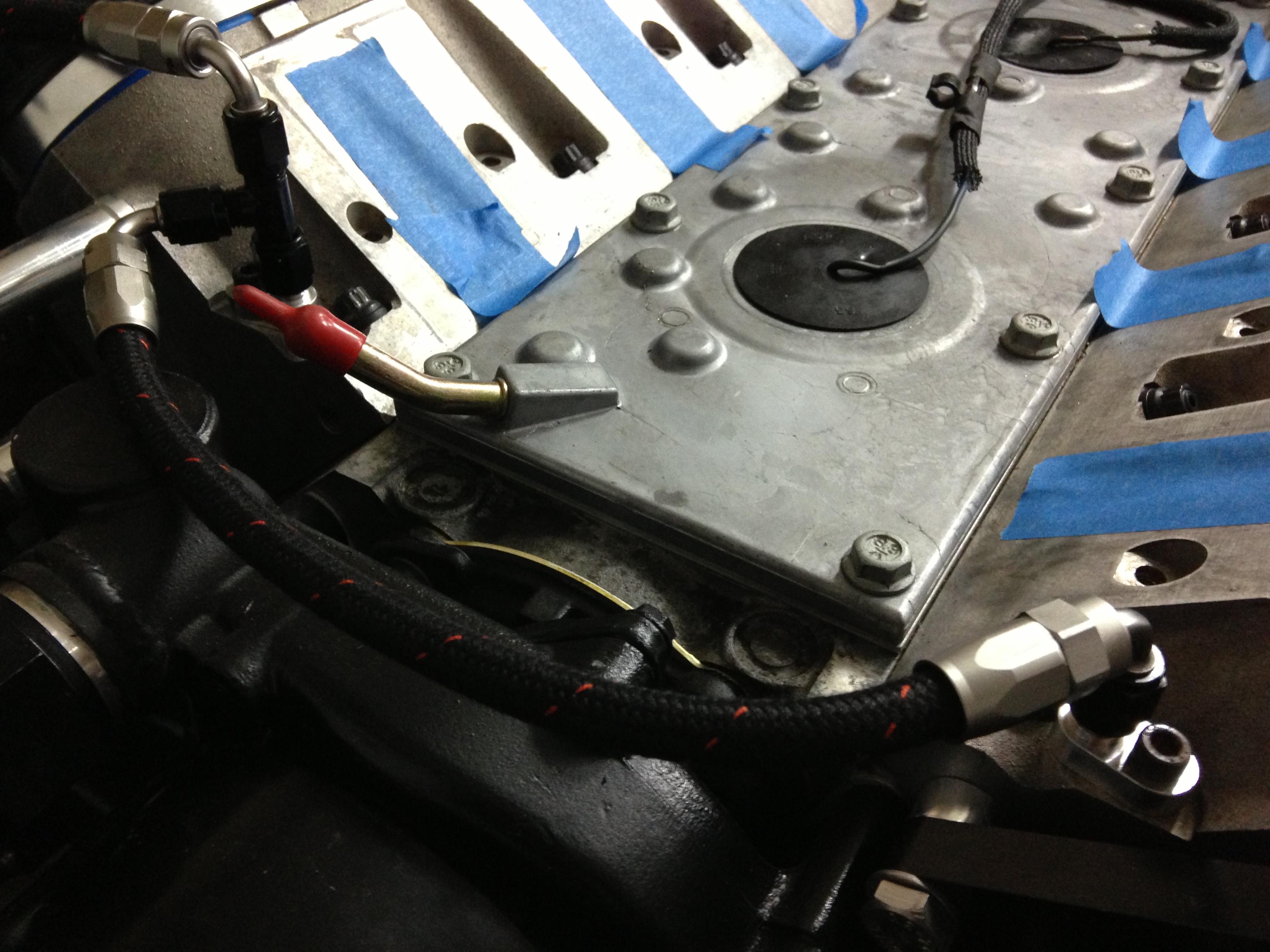

Time to install the catch can since the motor is back in..
Bracket installed
nice and clean..

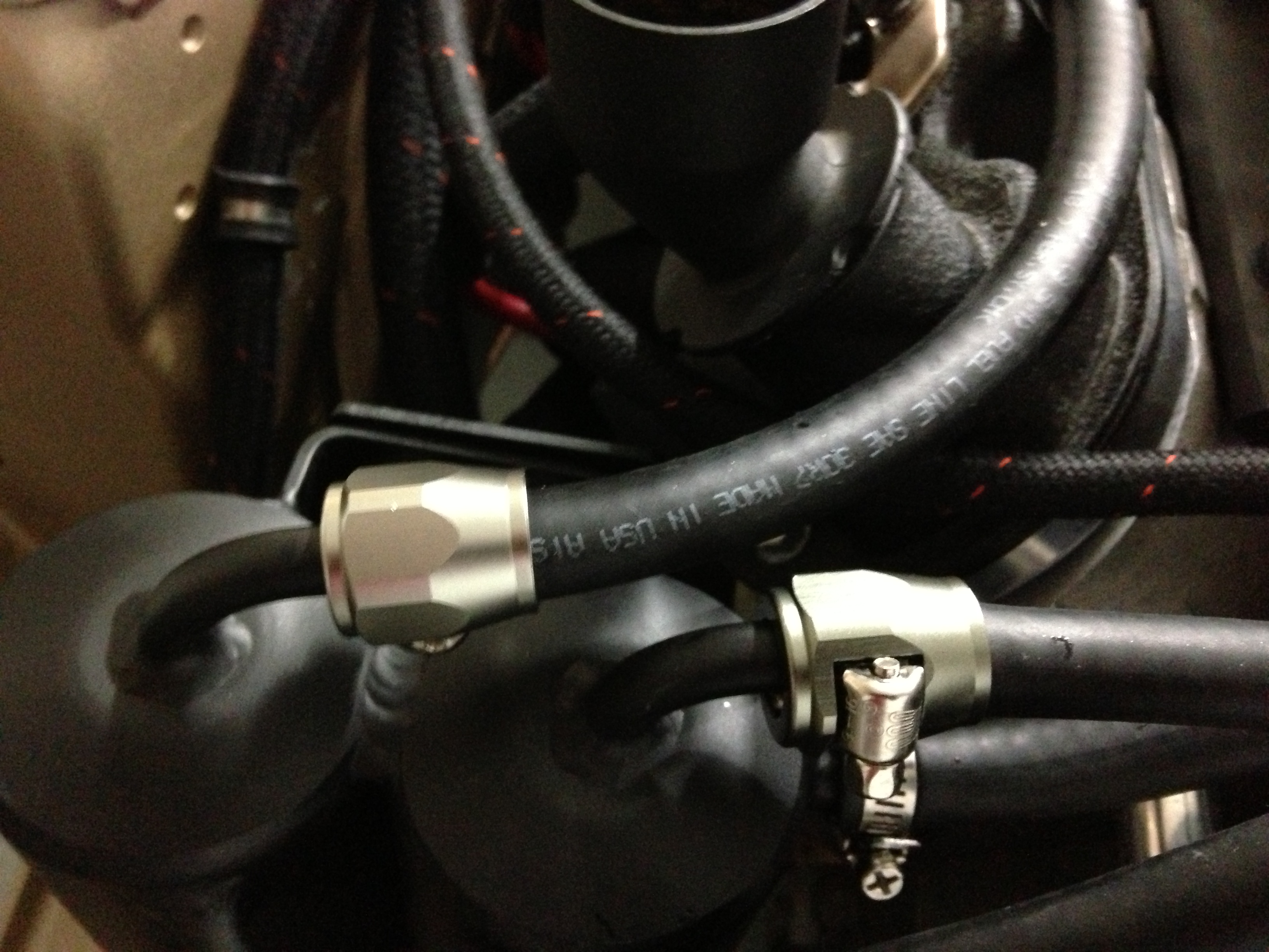

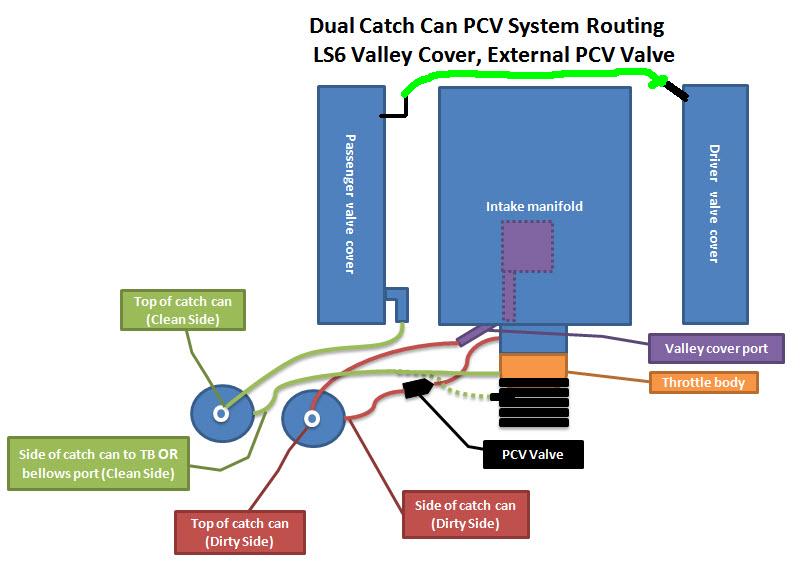

This is how I will route the catch can

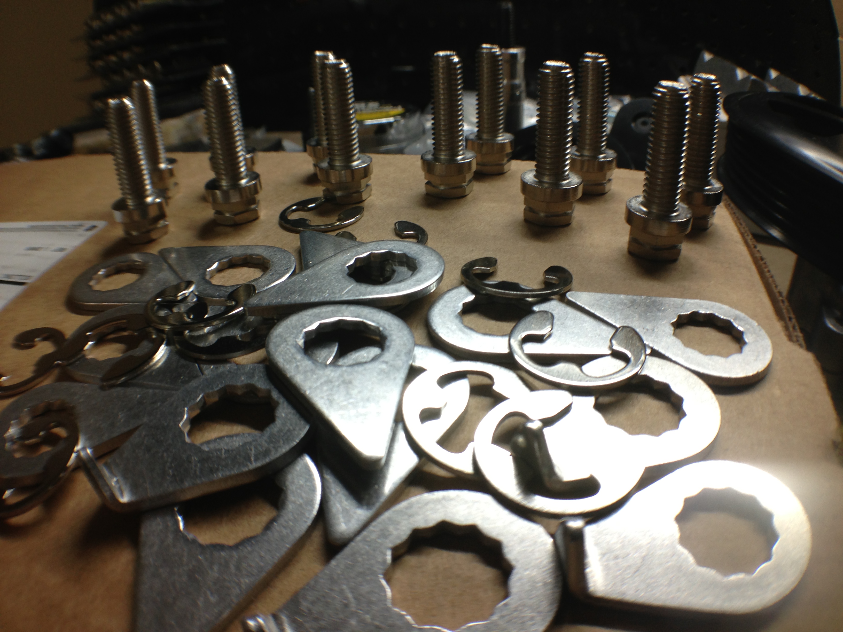

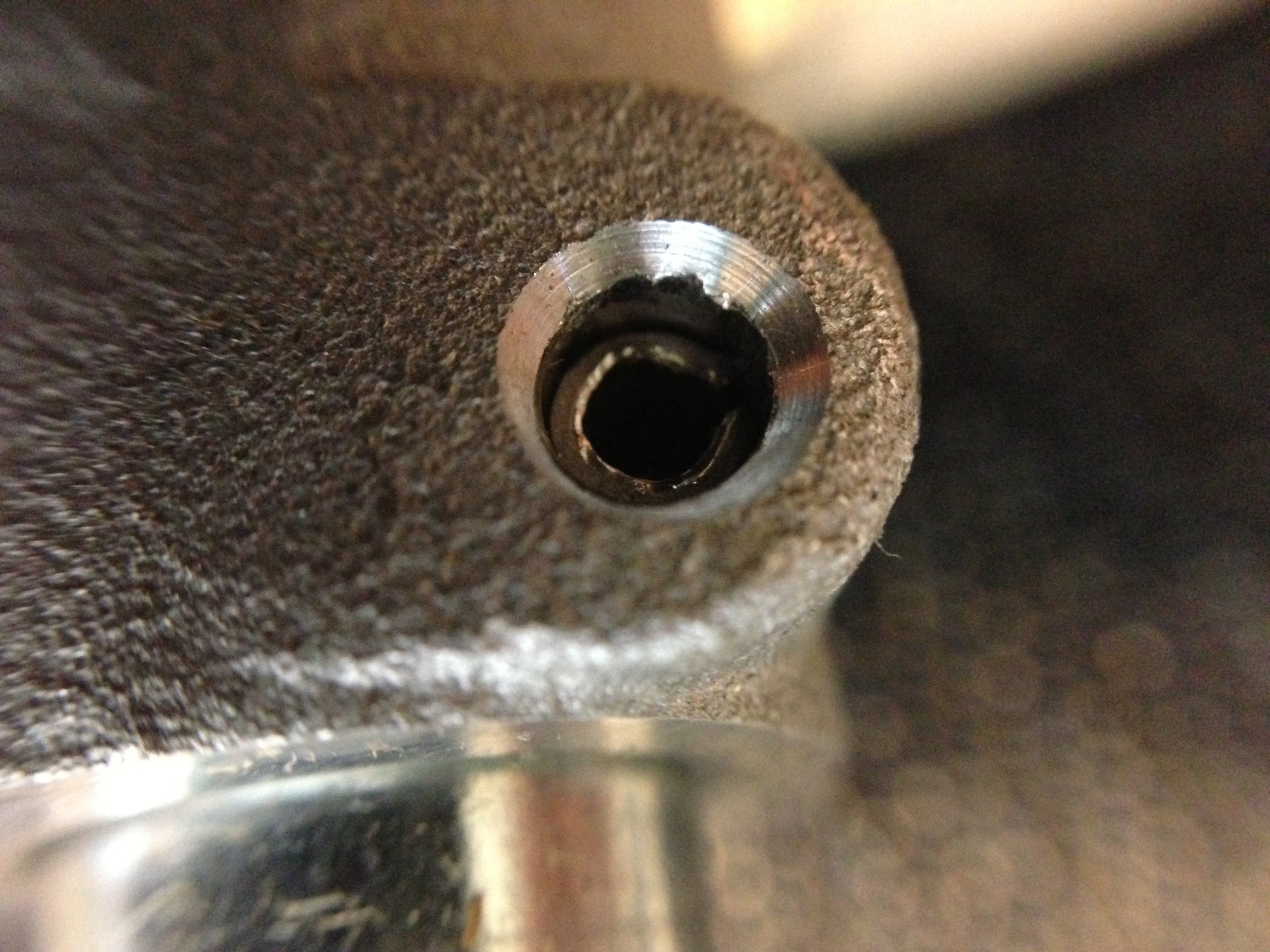

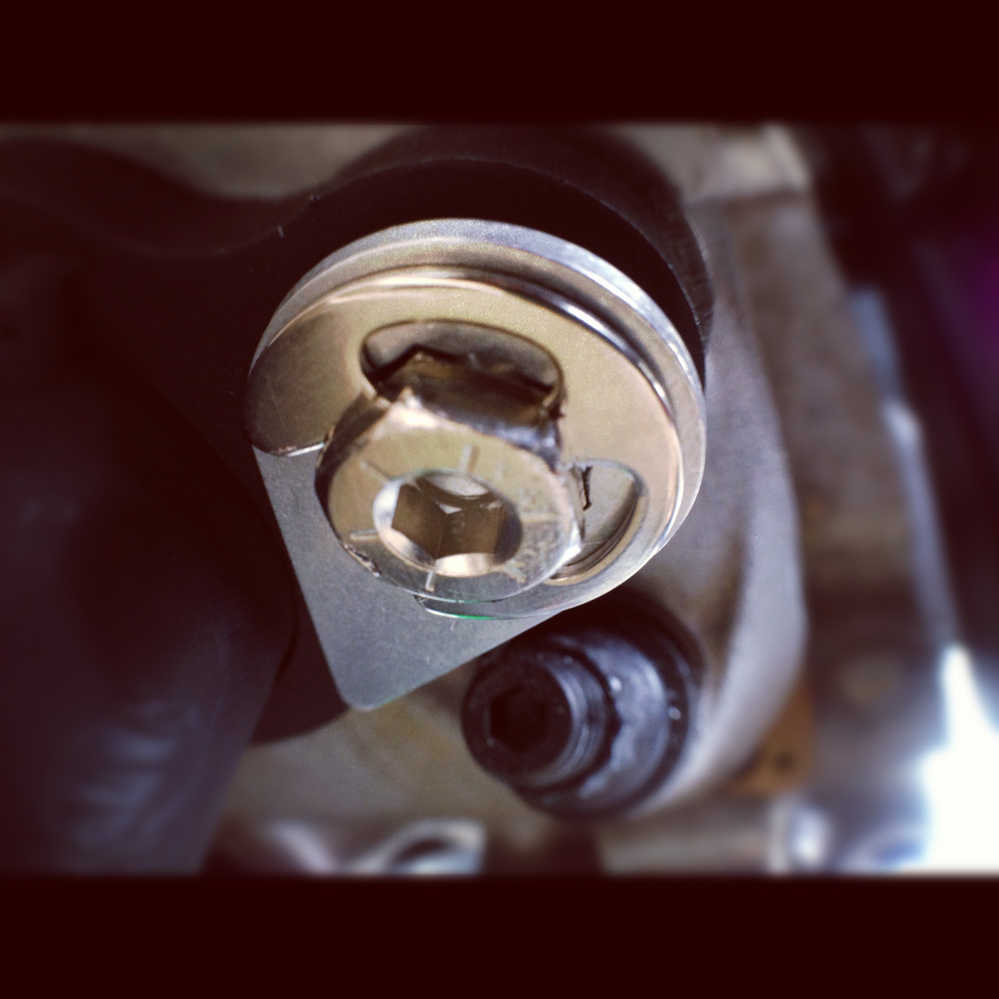

I picked up these sick locking bolts for my headers so they will not leak on me.

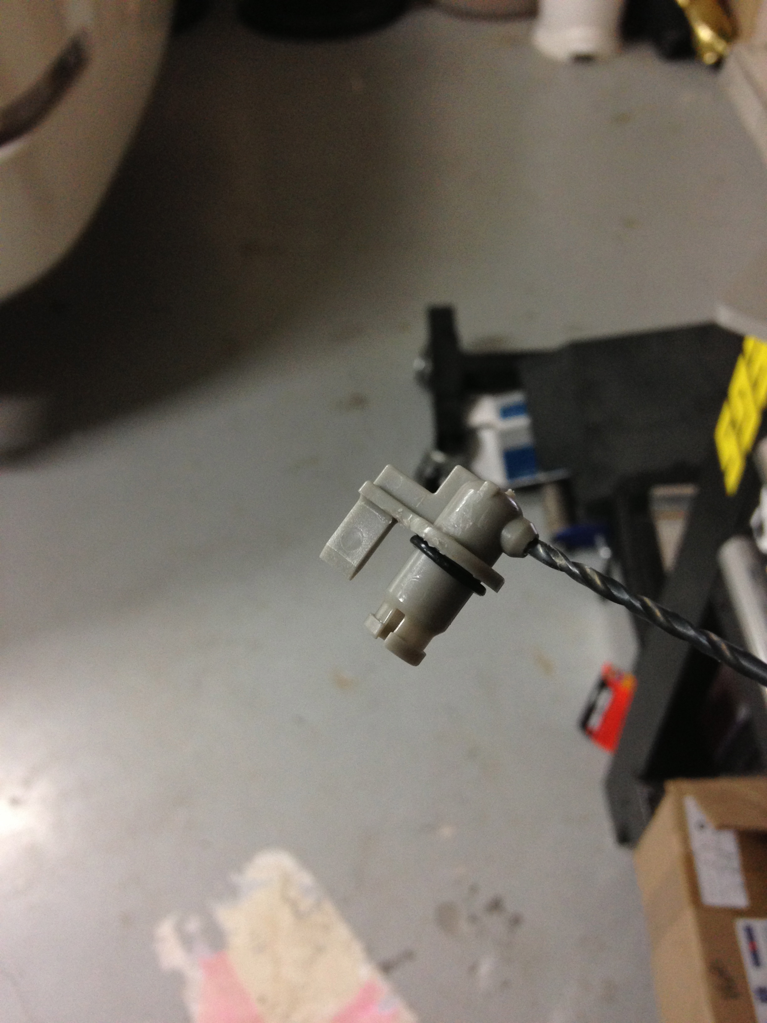

Now here is a pic of them installed BUT... this one I took a pick of had to be fixed,, as you can see it would not be doing any thing if it was not at the 11 position. But I liked this pick so posting it.....lol

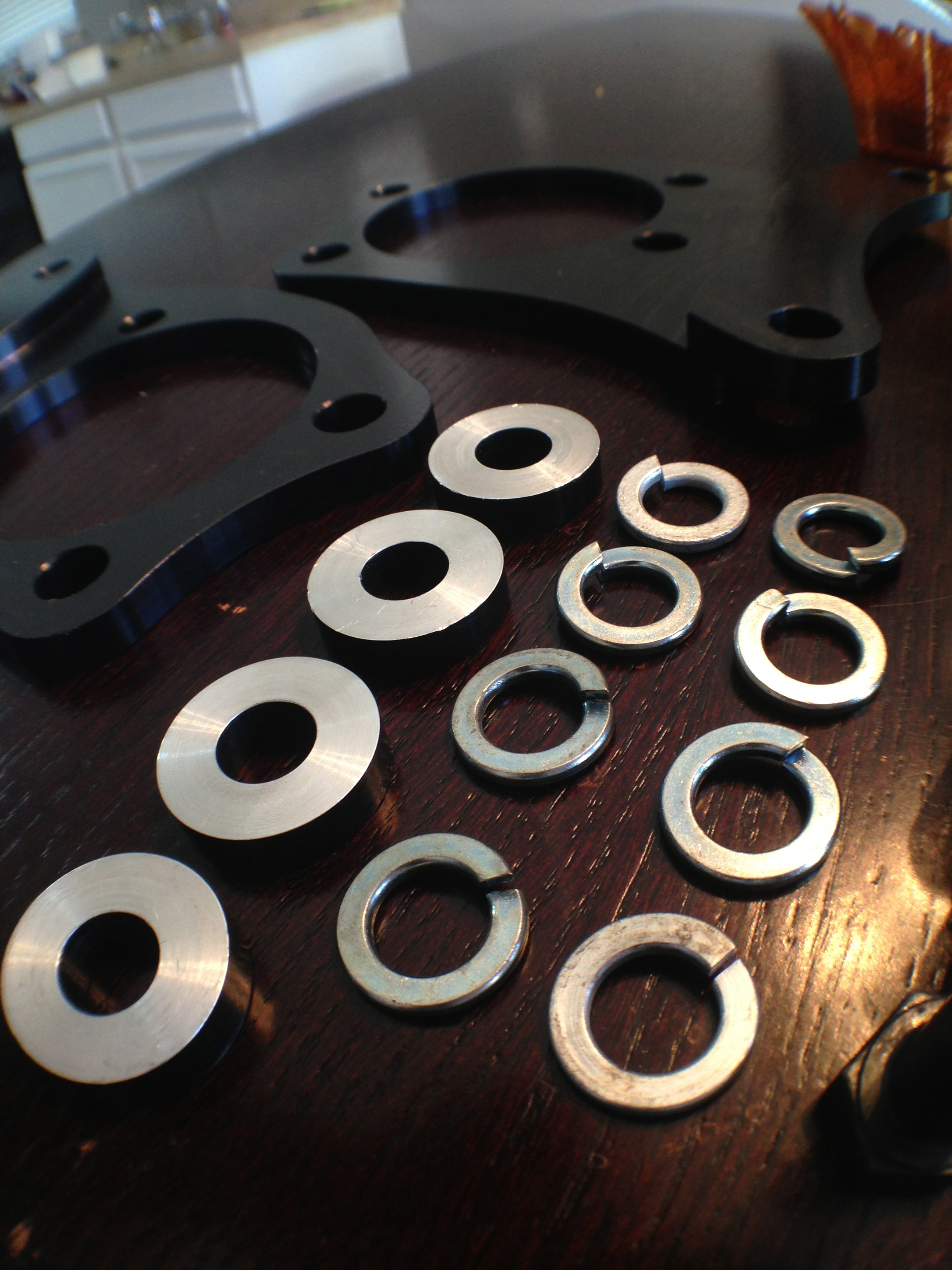

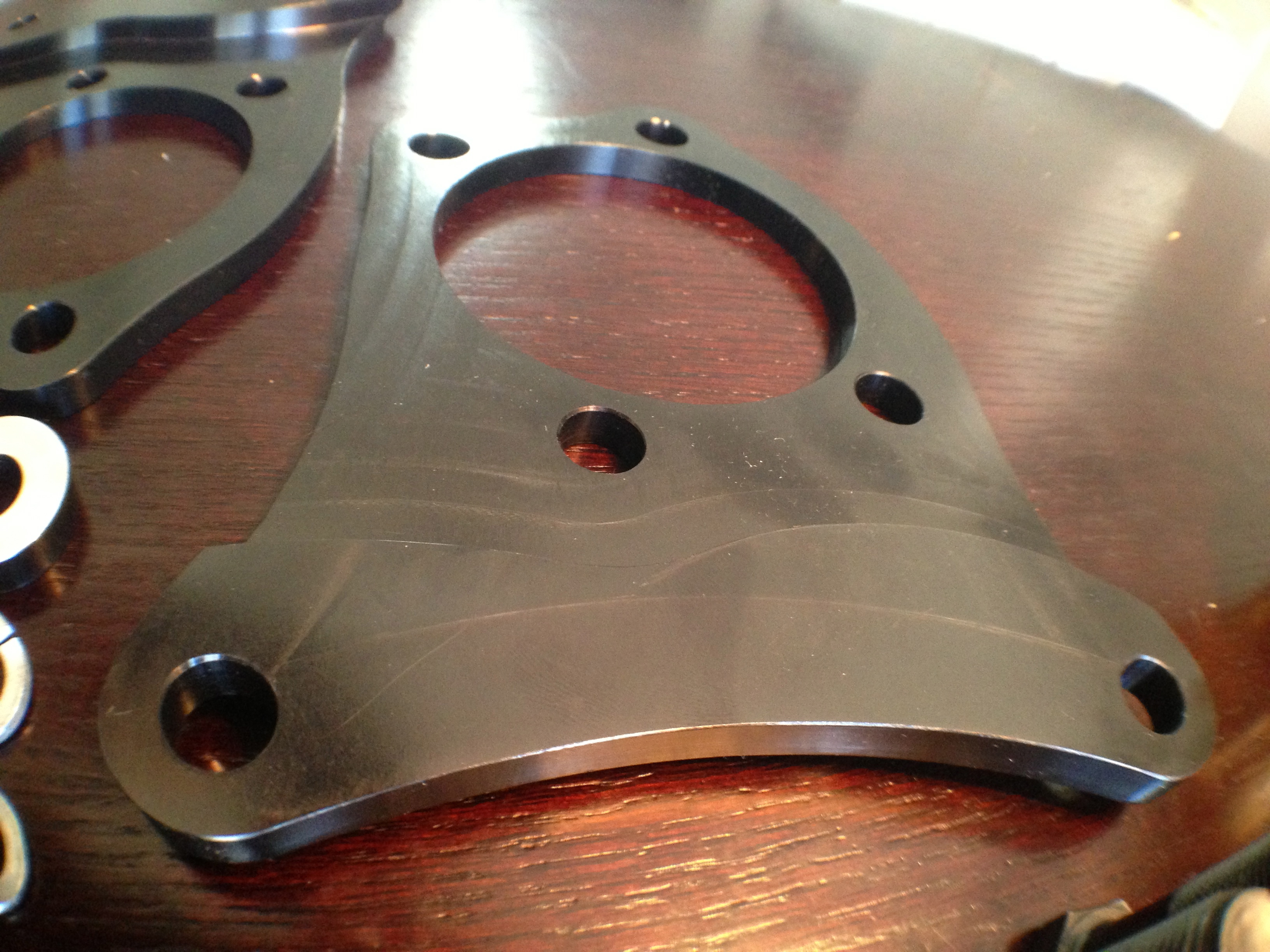

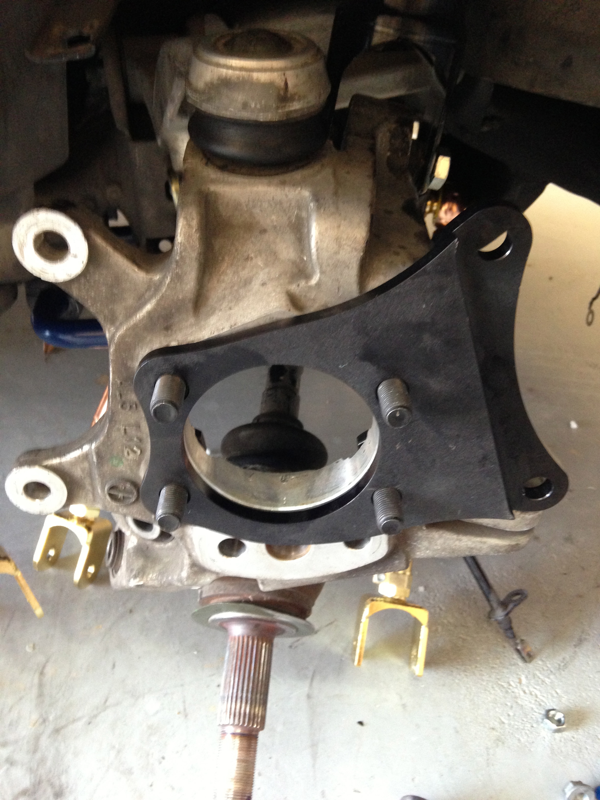

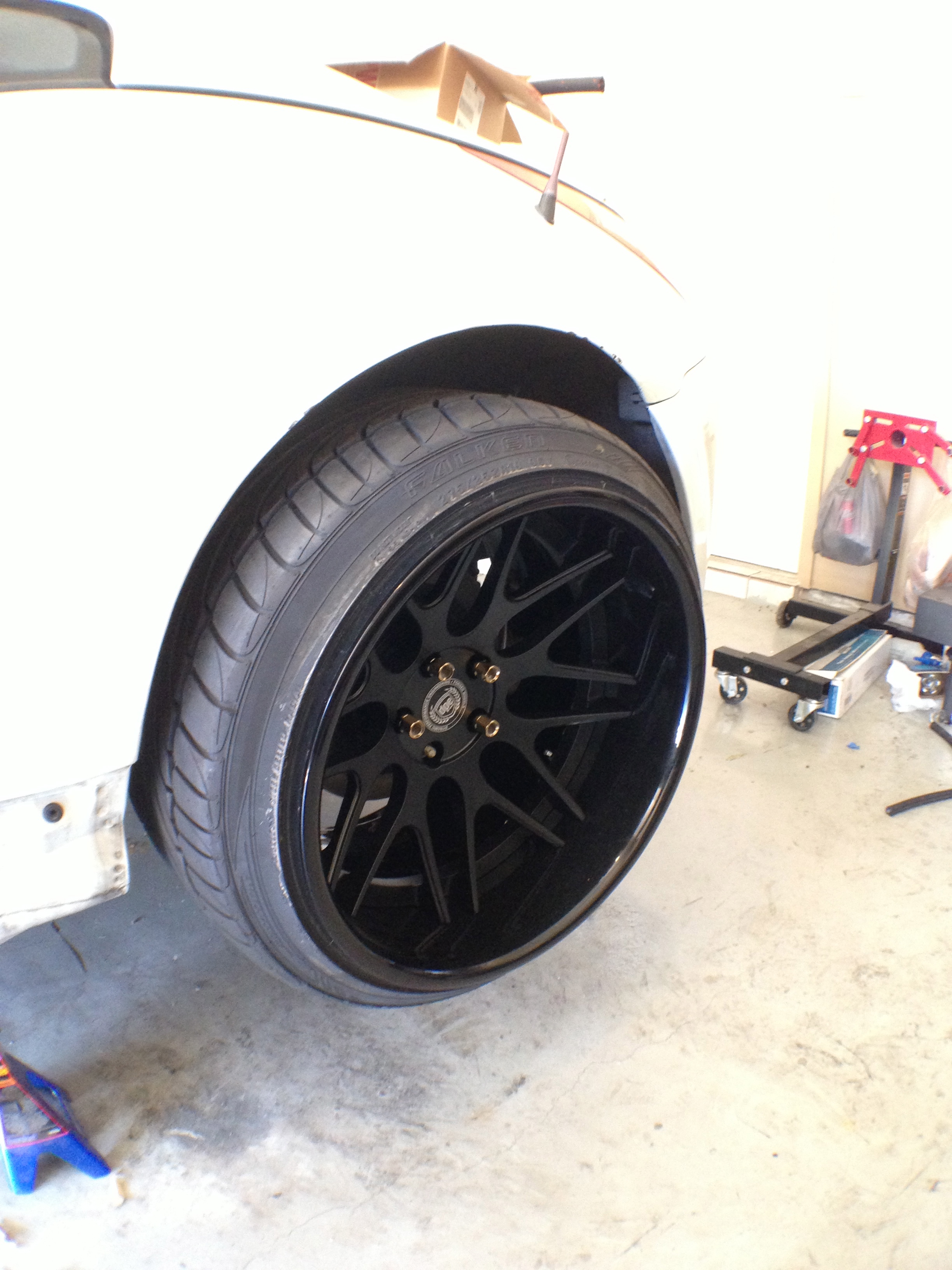

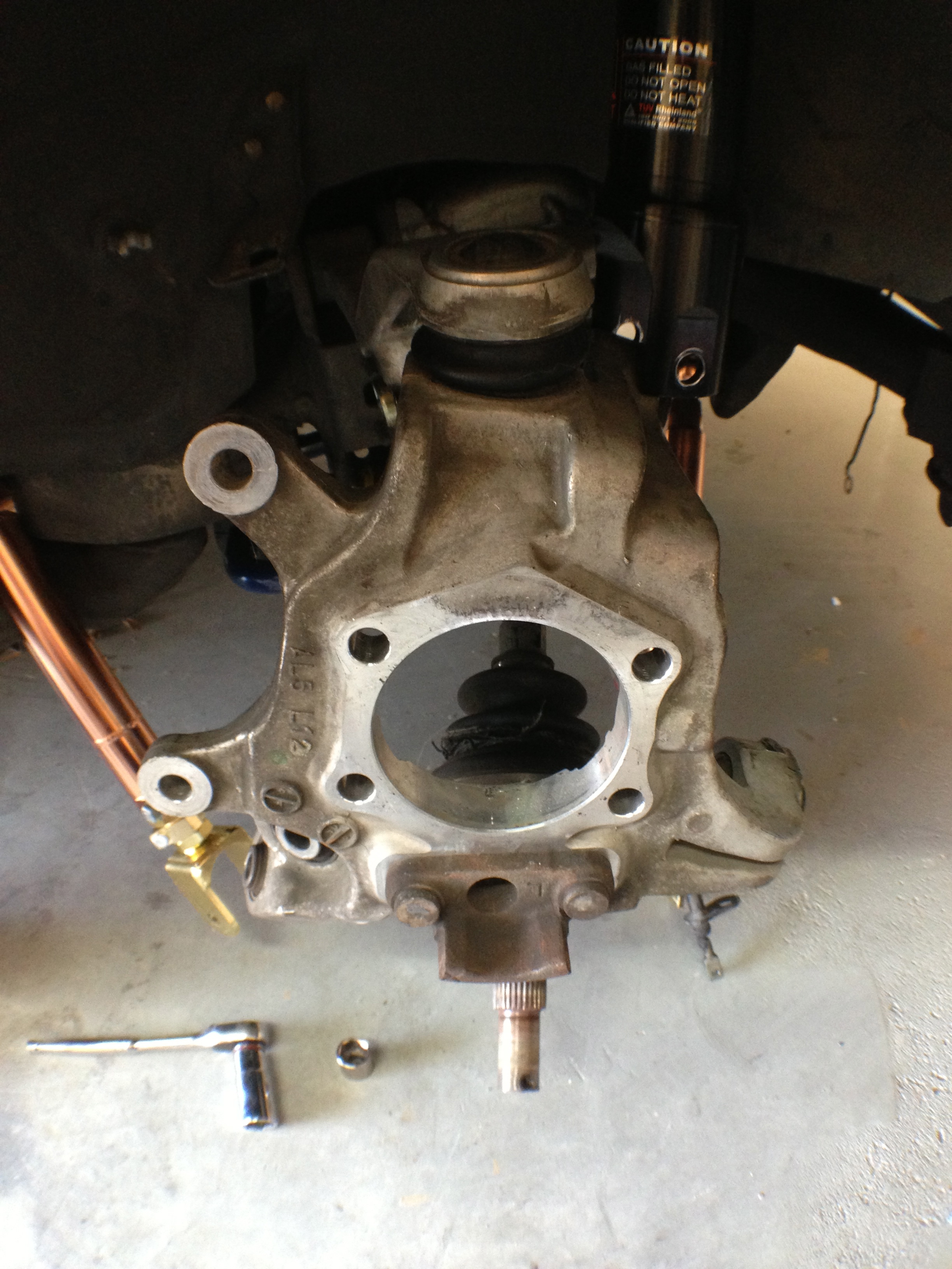

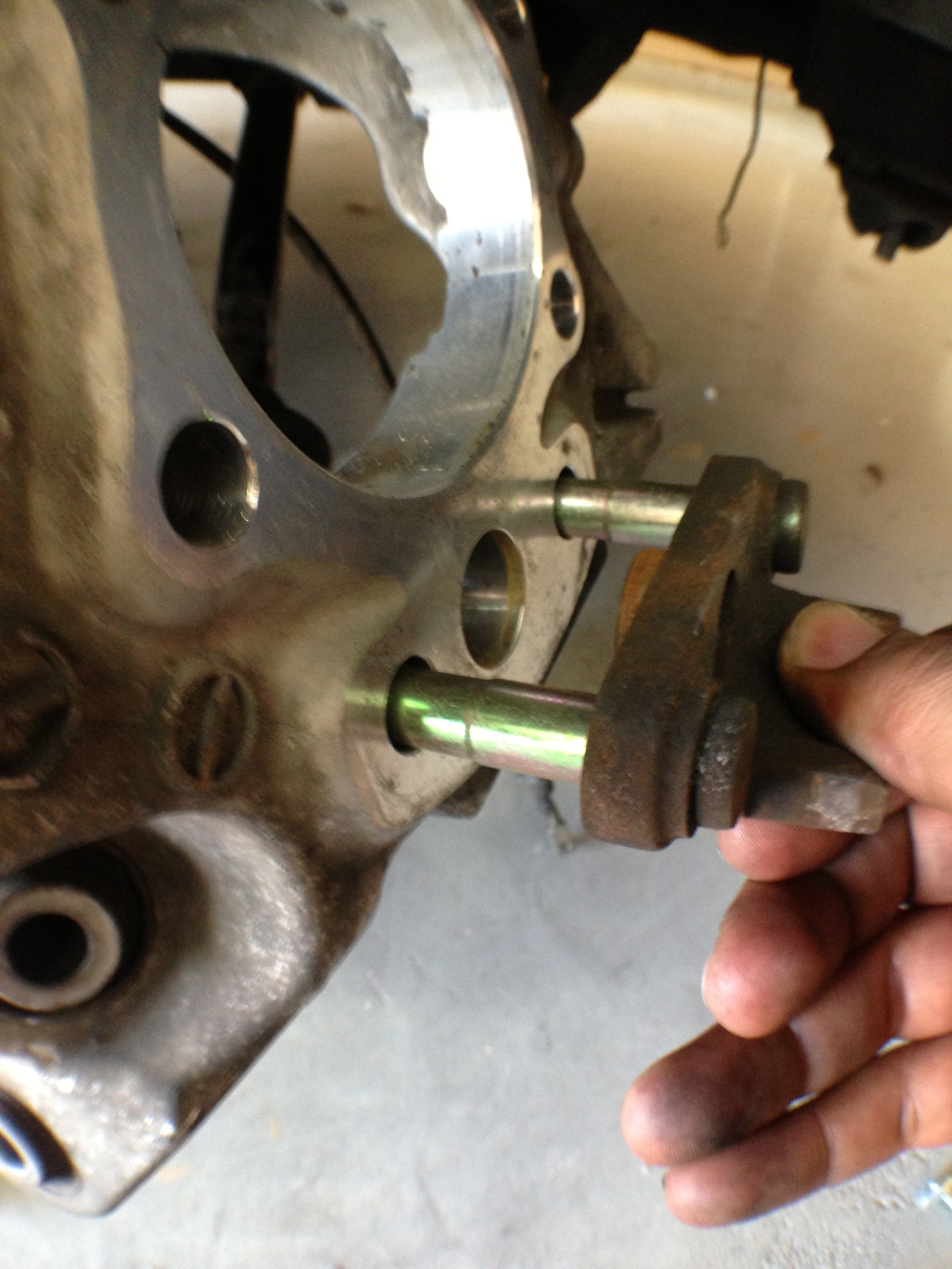

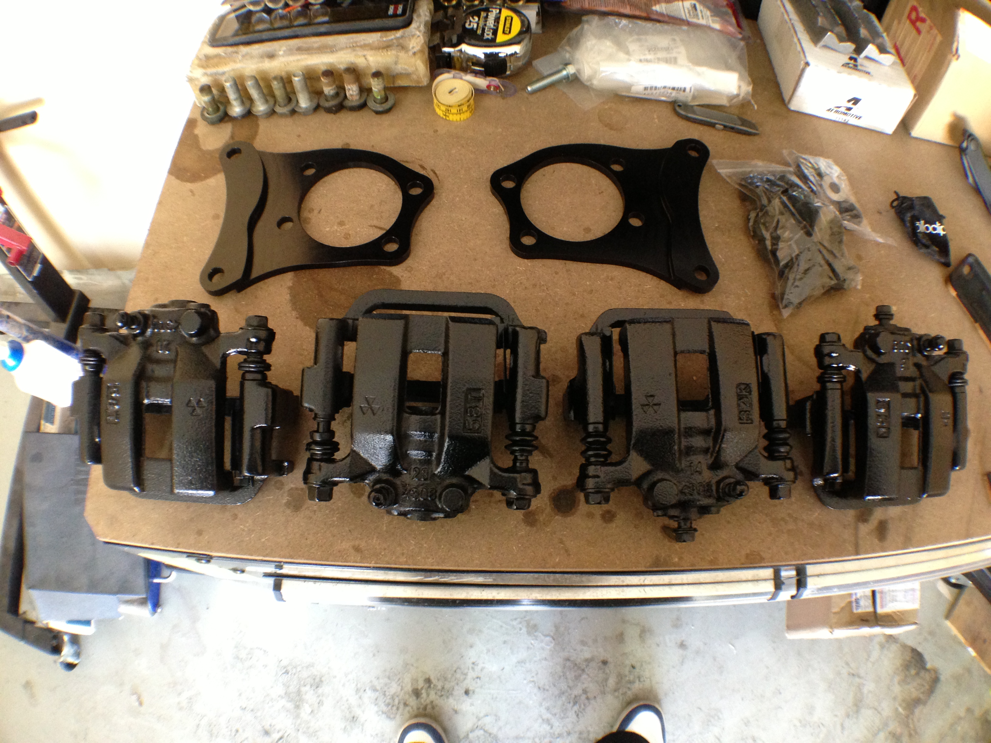

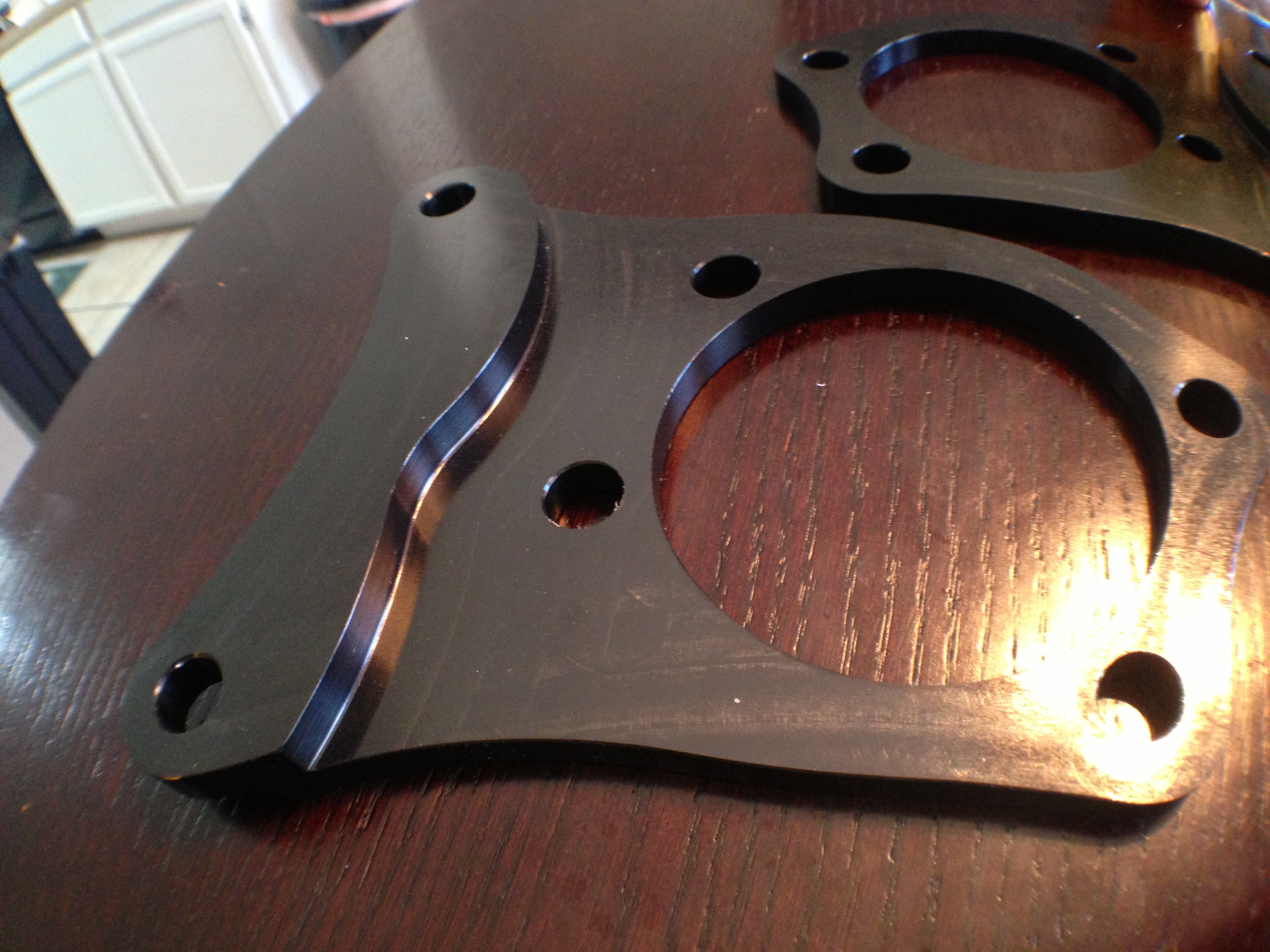

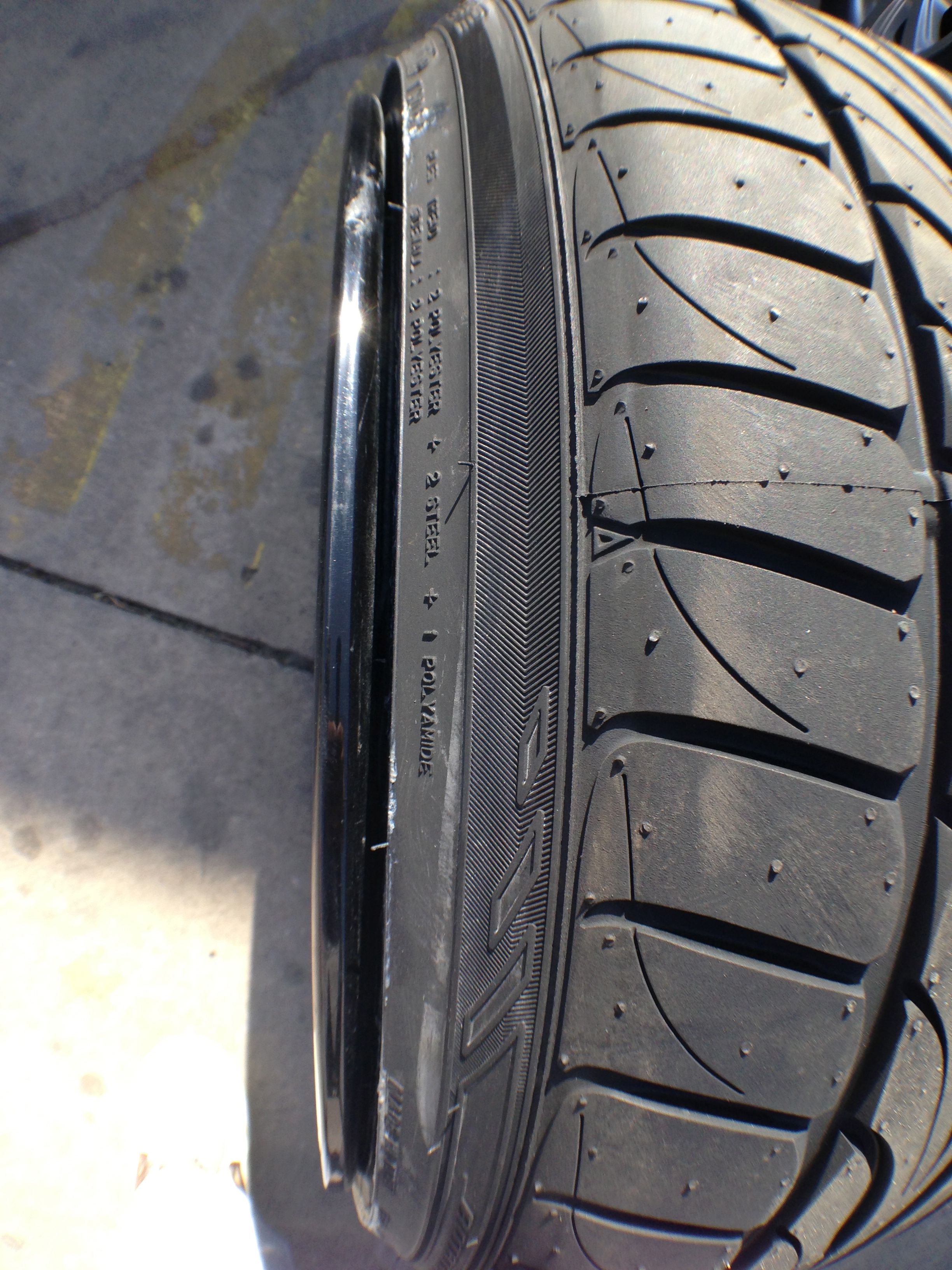

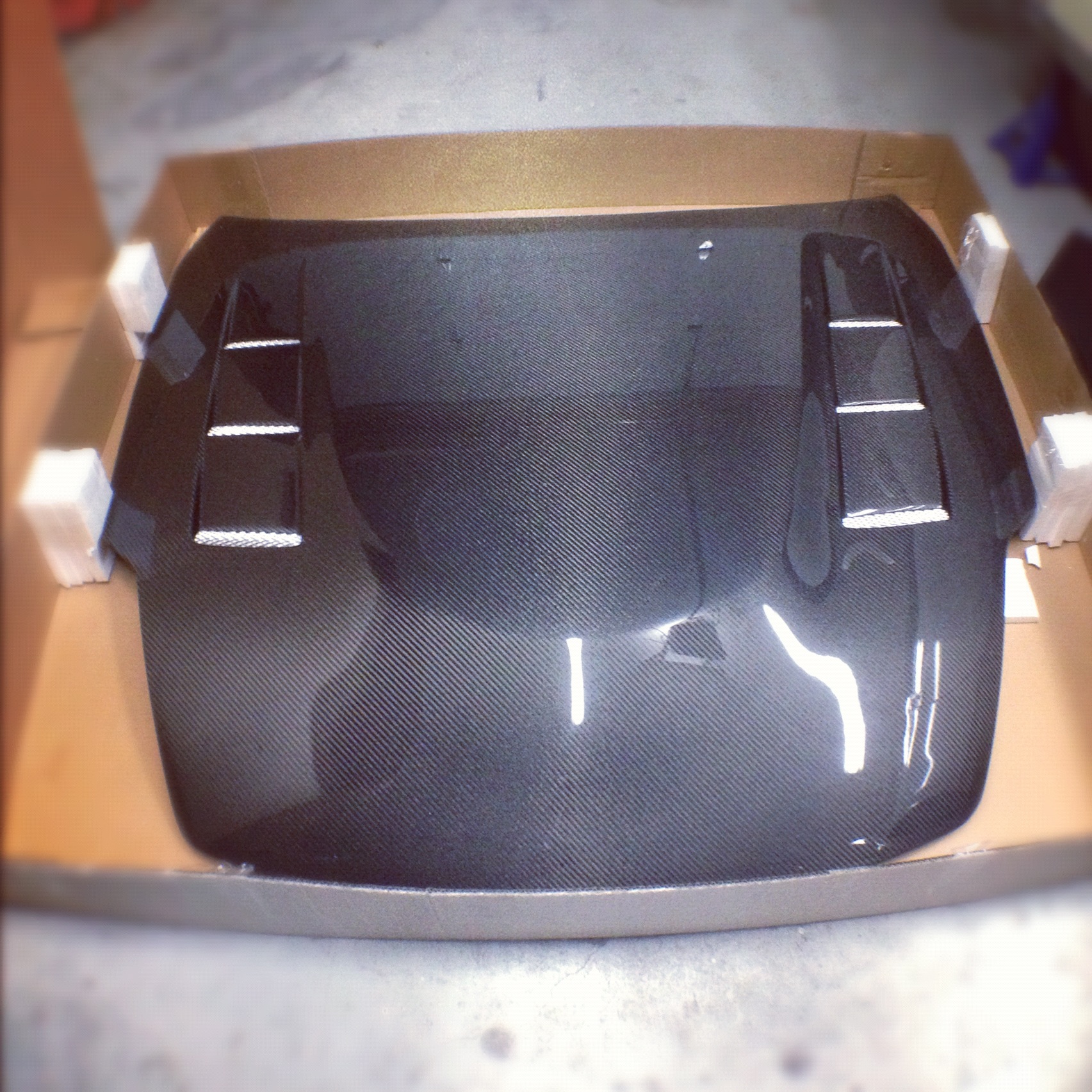

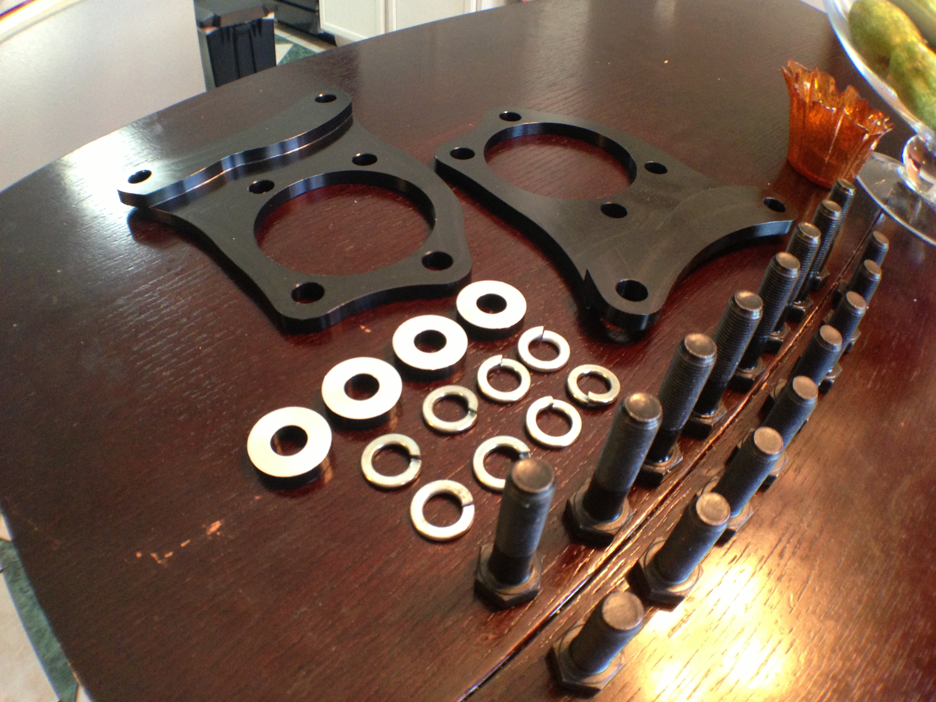

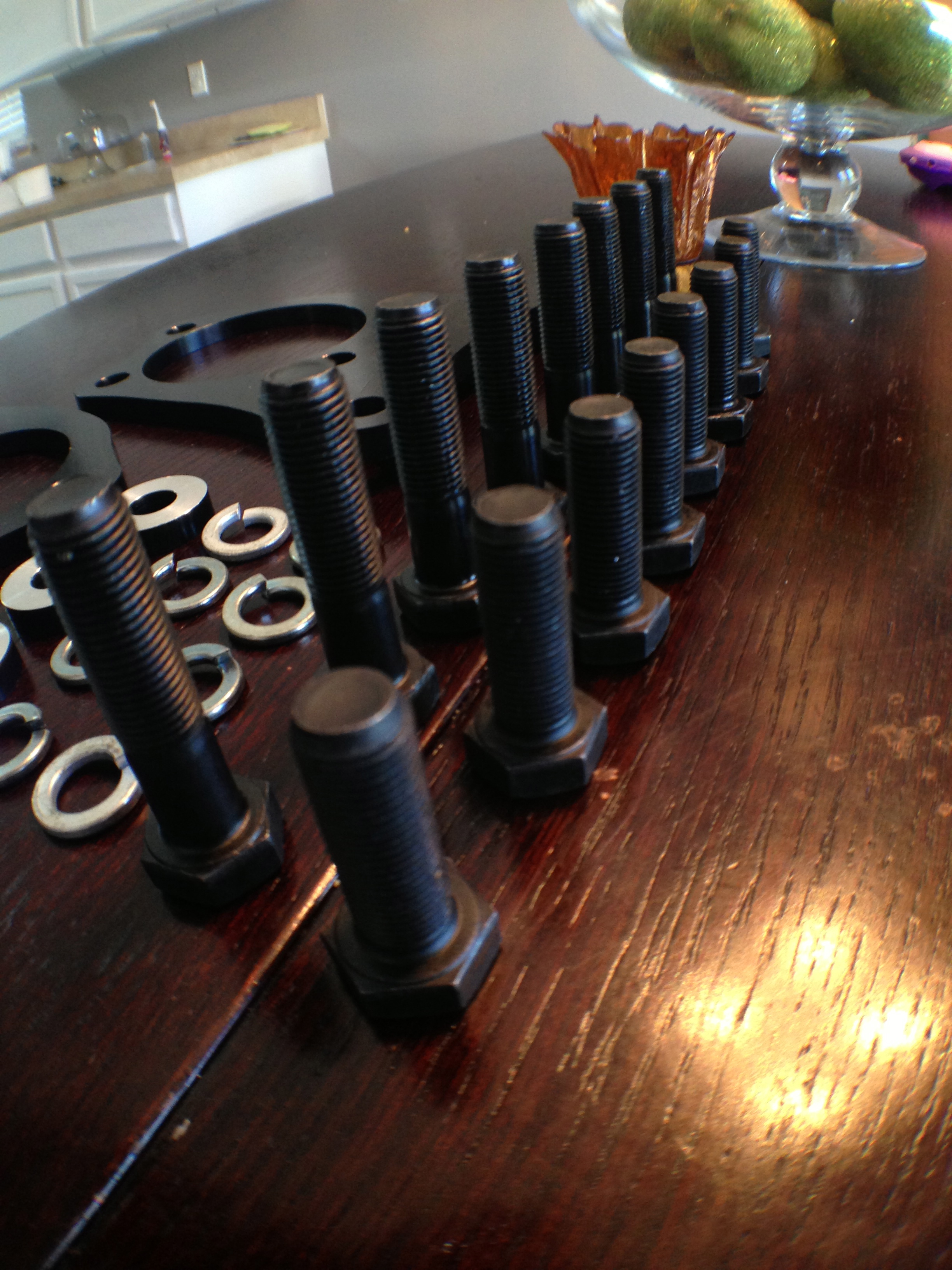

While I was waiting on hoses and fittings. George sent me the kit we have been working on for the dual caliper setup. This thing is top notch..
Bracket bolts to your hub and actually pushes your wheel out another 4mm. So def have to take note of that when getting my 18s for drifting.

So these are going to go into production soon but George sent out a small batch to some people for testing. Once that is all said and done he will start selling them like he does the S13/S14 brackets on zilvia
So for now I will only be using the OEM iron calipers.. Still bouncing around which calipers I want to run.
Hub removed
Sorry to say but you will loose the OEM e-brake with this setup. But he is working on another kit to keep it. But for me BecauseRaceCar...lol
install bracket
BAM installed and ready to rock..

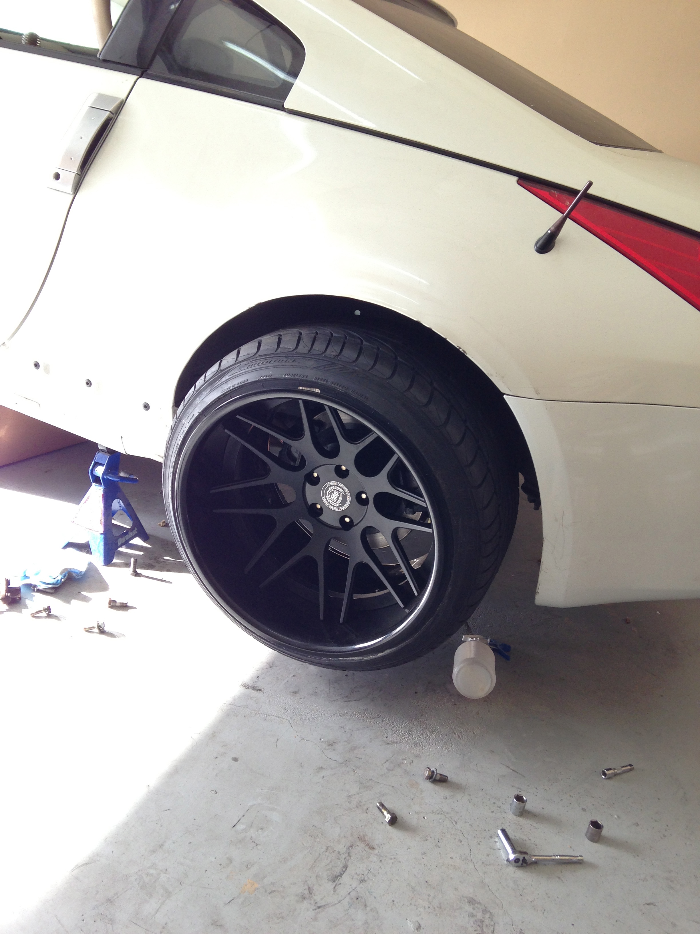

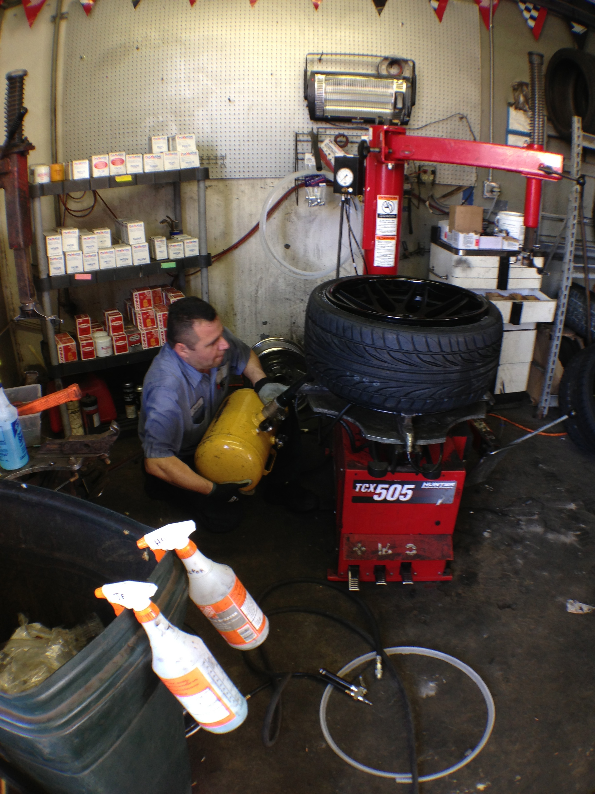

So while I was still waiting for some parts.. Lets mount some tires
Wheel specs are 19x11 0 19x13-20.. Now these are not my drifting wheels just marketing wheels.. So might be selling them after photo shoot.
Feel sorry for him..lol
11s were easy
Cheetah time
POW!!! mounting 275/35 on the 13s
11 stretched on 245/35
13s looking damn good
Perfect stretch
Back home and looking good

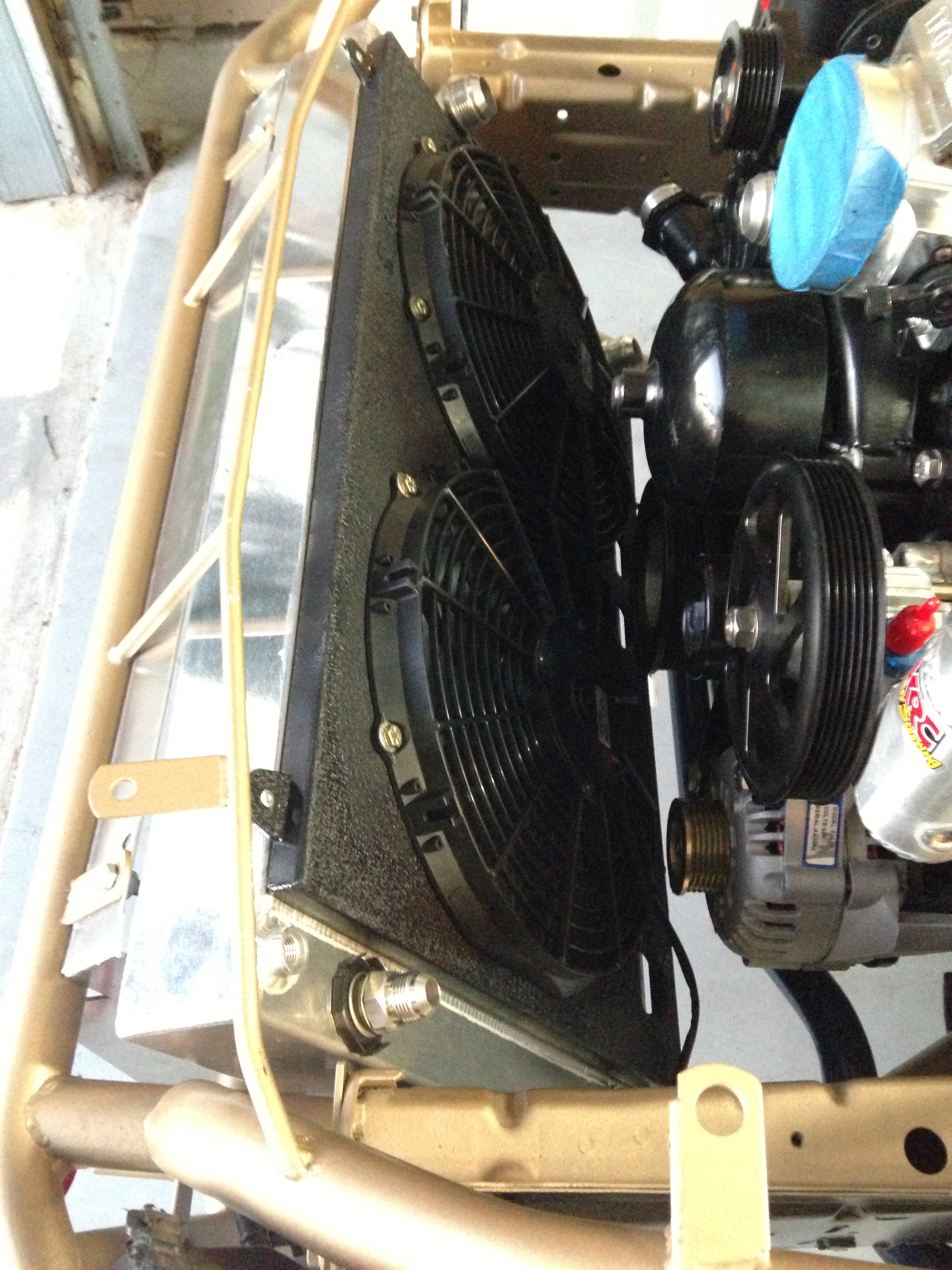

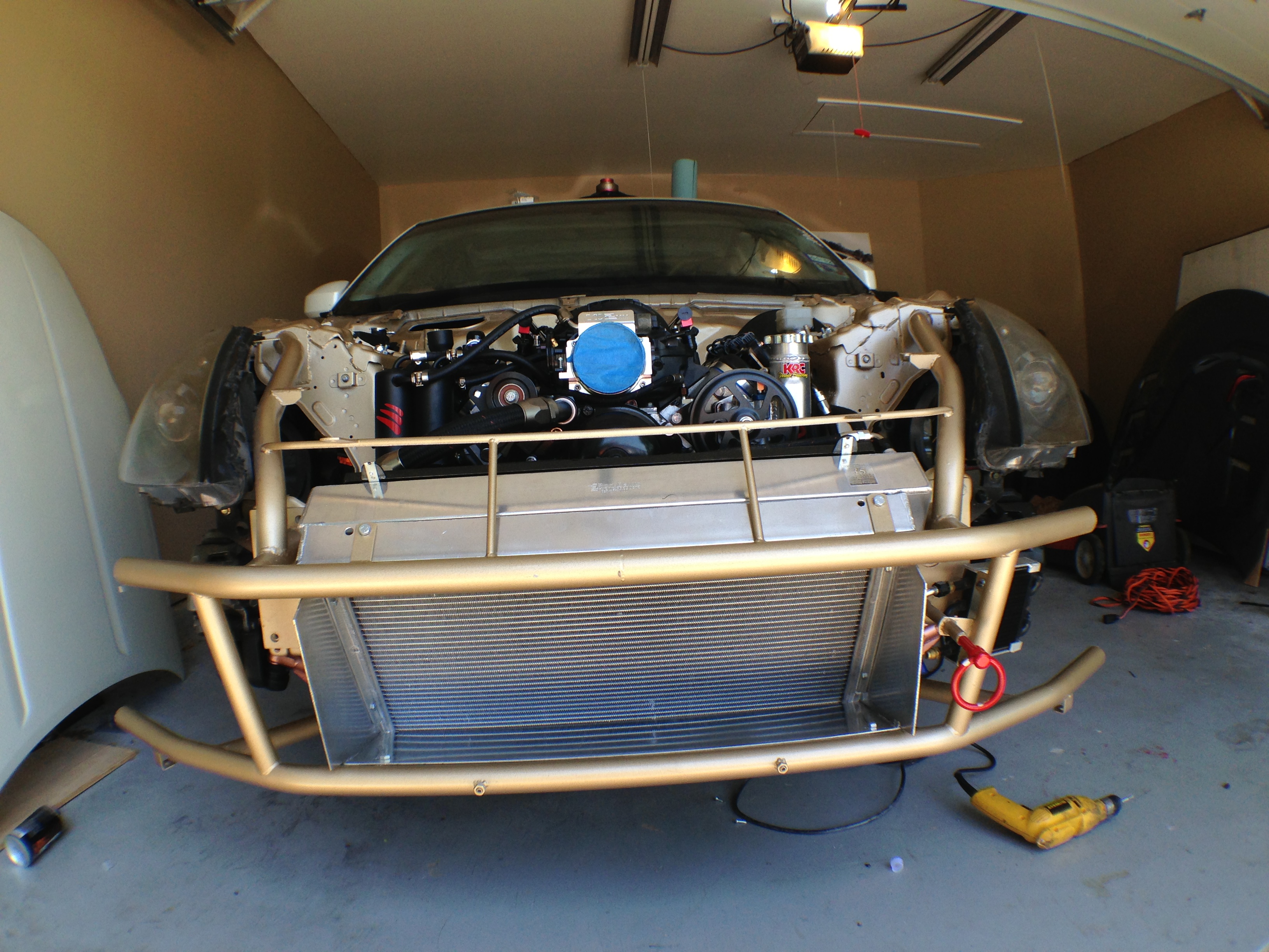

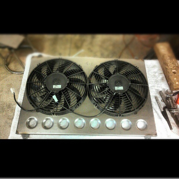

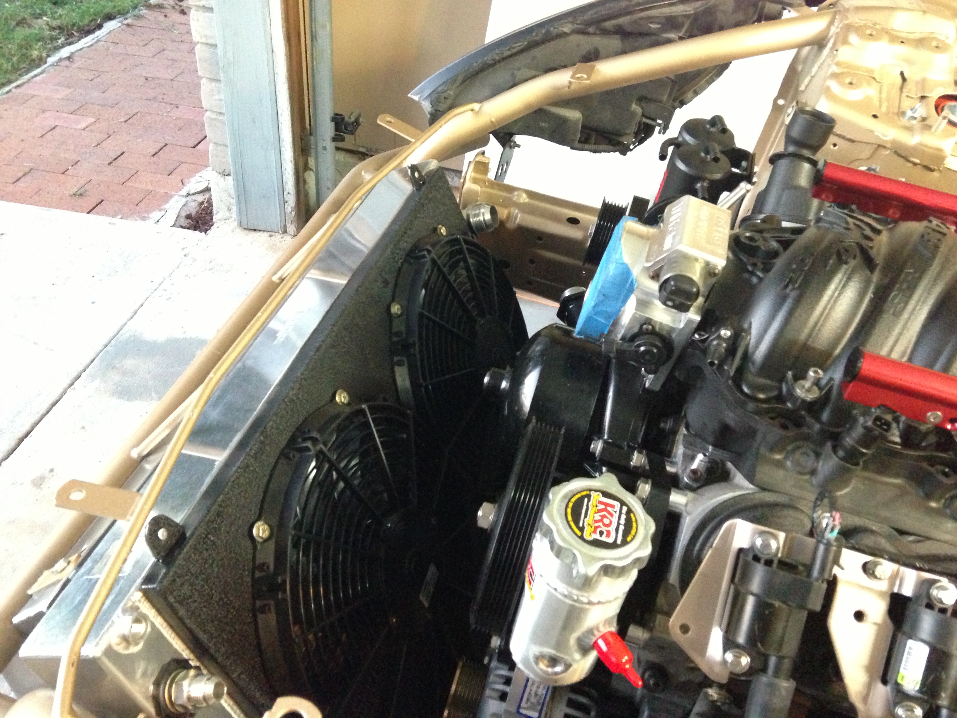

Got my Fan shroud from Blake (the one with the sick FC build) thanks buddy..

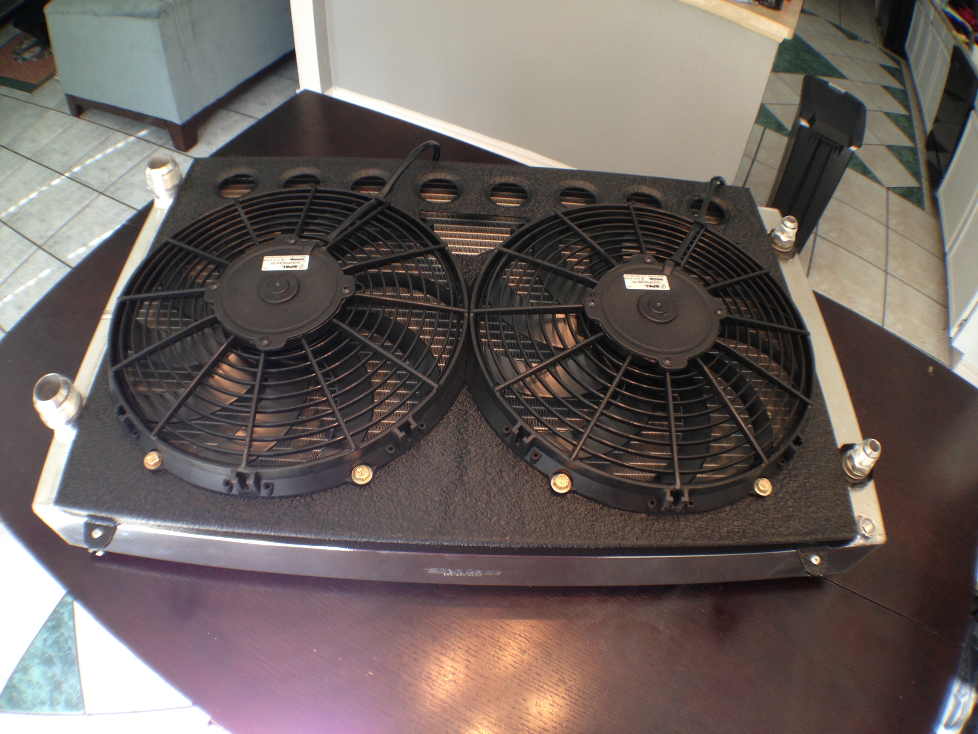

Painted it crinkle black and mounted my fans
Mounted up
Looking good..

Picked up some tools for the AN fest we are about to get in to..

Got hoses?
fittings laid out and all labeled so I know what goes where.. Lets do this
Install begins..
Good thing I have these
Looking good.. Now lets run fuel lines
I ran them were the old fuel lines went. But thinking about putting a plate over them so nothing hits them.. Thought?
Fuel setup complete
Bottom Radiator hose
My front coolant lines
They Tee off right here and head to the coolant tank
The driver rear coolant line
Passenger coolant line and some of the fuel lines
Oh yeah all hooked up
My Dual Catch can lines ran

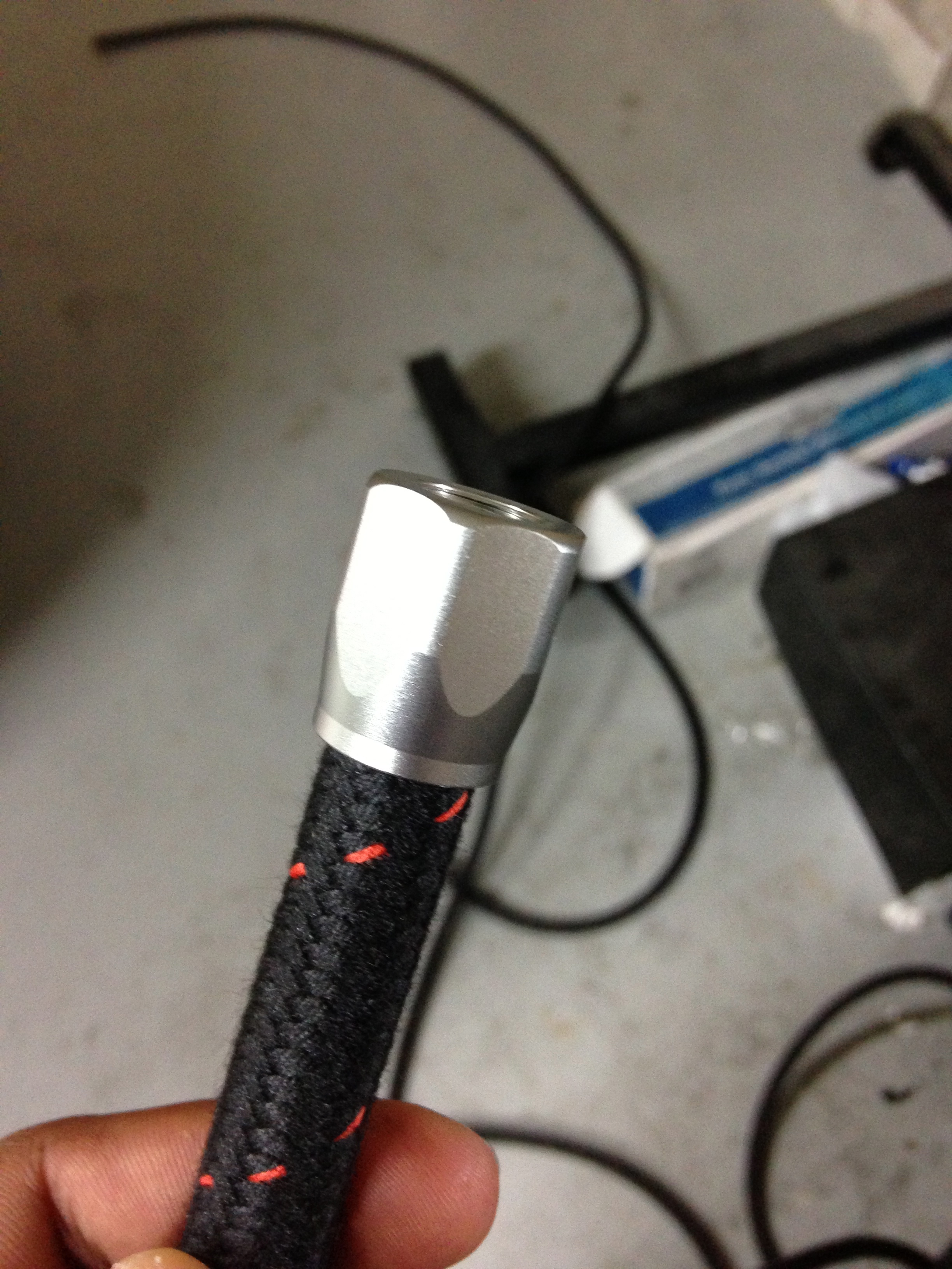

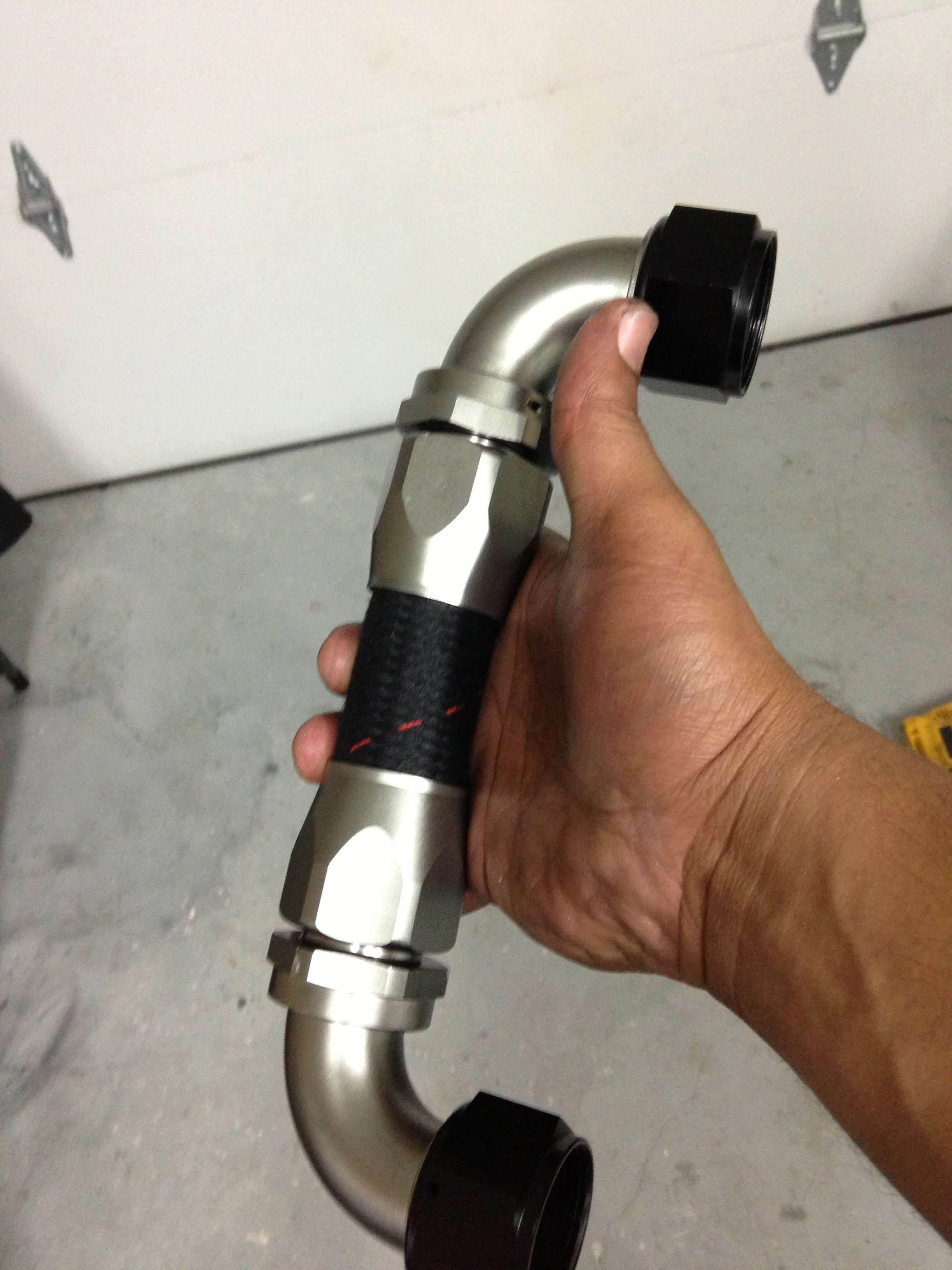

Found these sick fittings that match my AN ones perfectly
Another pic of the lines ran to the expansion tank
Line ran from the Radiator to the Coolant tank
Big *** Radiator lines

A full pic off everything ran.. Looking good I must say

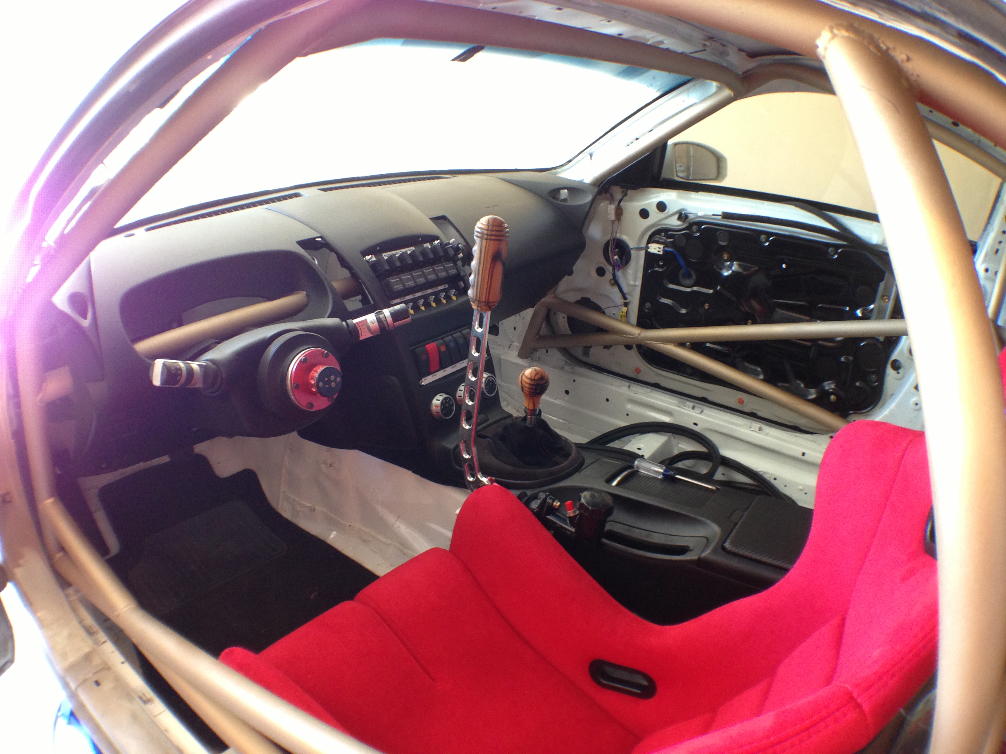

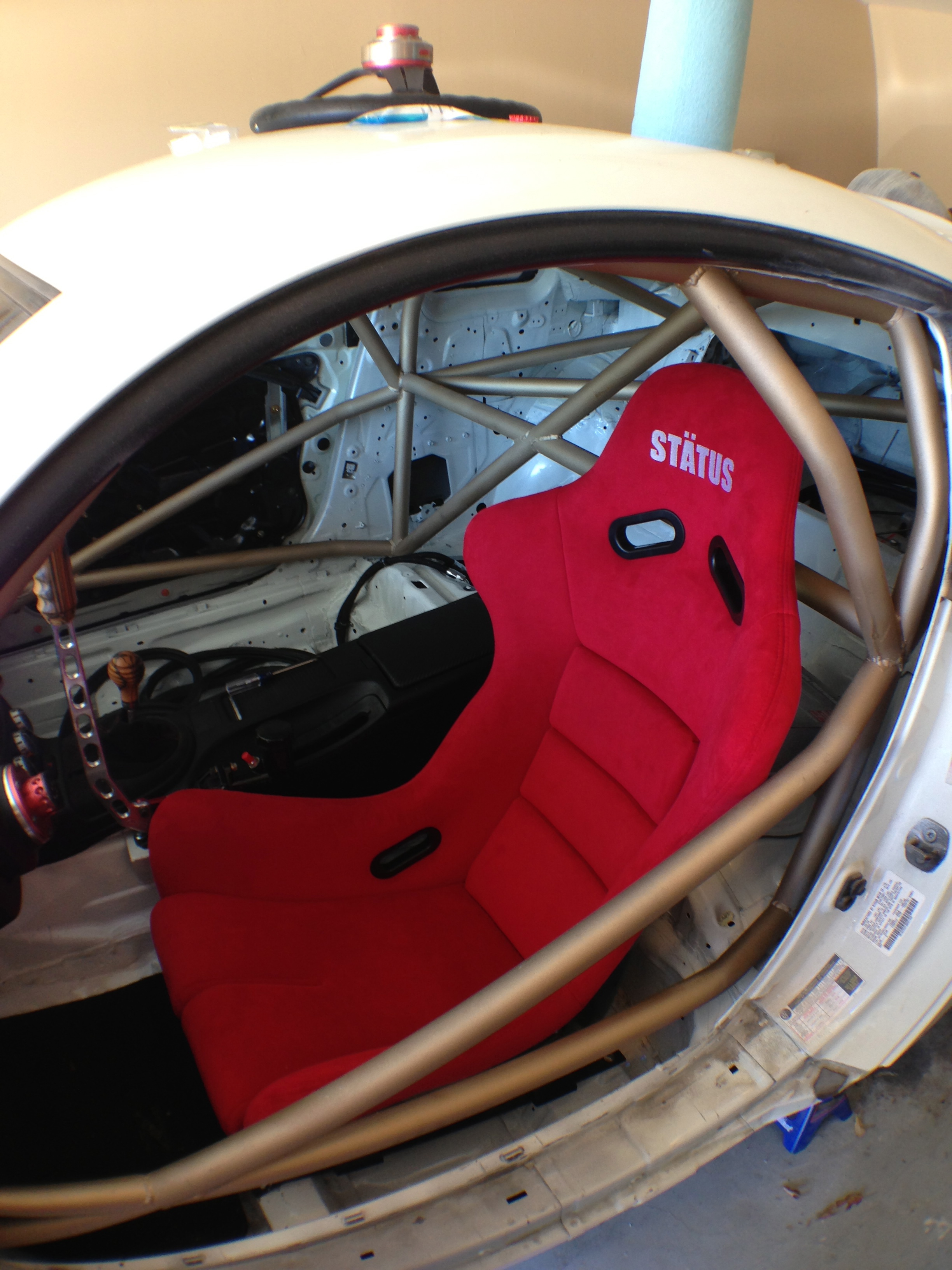

I also mounted up my Status Racing seat to check the fit.. Looks good
This view is so sick.. Next is to install my Carbon Fiber door panels and floor boards... Should look sick when done

Love this hood. went with the 07 cause I love that hump. I will color match this hood and leave the vents CF..

Definitely build a plate to cover the fuel lines i utilized the factory hard line and added a new hard line when i went to a return system vs using braided line seemed more oem and safer in my eyes and i used braided lines to go from the hard line to the different areas of the system. looks great if your belt doesn't squeak when you start her up pm me a mod list for your accessory driveline
Old Apr 16, 2013 | 03:32 AM
  #595
Quamen's Avatar
Quamen
Posts: 3,383
From: Wisconsin
Braided should be safer than hardline since it will be less affected by impact. I ran my braided line on my Z just like Royal T and we do in our Porsche as well with zero issue.
Old Apr 16, 2013 | 06:35 AM
  #596
04.350z's Avatar
04.350z
Joined: Mar 2008
Posts: 408
From: Champaign Illinois
Well that being said the braided lines are much larger in diameter so less clearance.
The stock lines are protected by the frame rail
That being said your are also right on them being affected by a impact
Old Apr 16, 2013 | 07:03 AM
Let me ask you something how did you remove the OEM lines from the damn fuel tank. there is one section I could not remove because of the gas tank so said **** it and left a bout a 3-5" line there.
I totally agree with you. I know I should be fine but since I run a little lower then most I think I might just at a skid plate just for my comfort.. doesn't hurt
