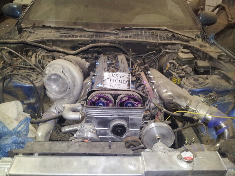

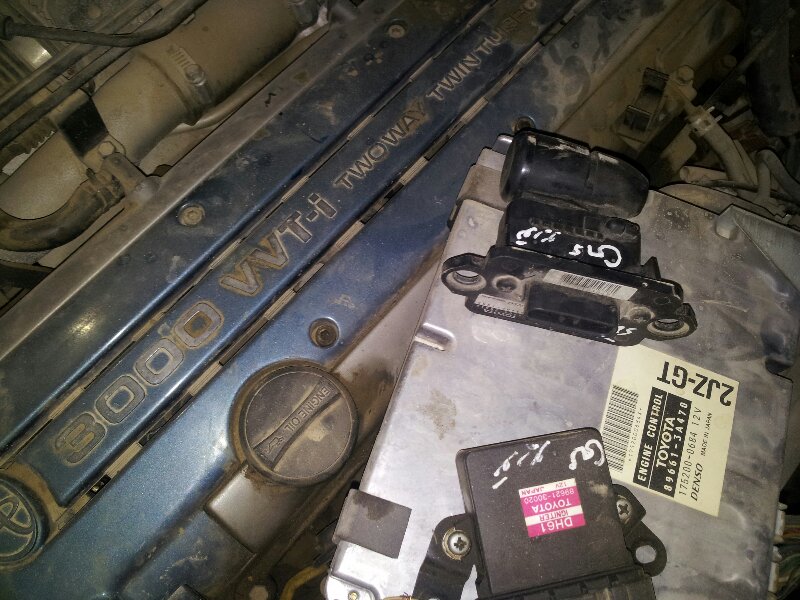

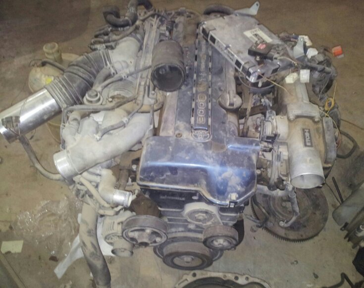

Some pics I took yesterday.
First one is the ECU and the rare MAF sensor.
Second one is my new engine.
Last one is a Lexus SC300 was at the shop.
