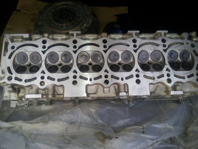

I picked up the head with the HKS 280 cams, OS Giken triple clutch and AEM cam gears.
the clutch is missing the pull to push alteration kit. I might convert it just like the W58 tranny or buy the OS Giken kit for around $500.
