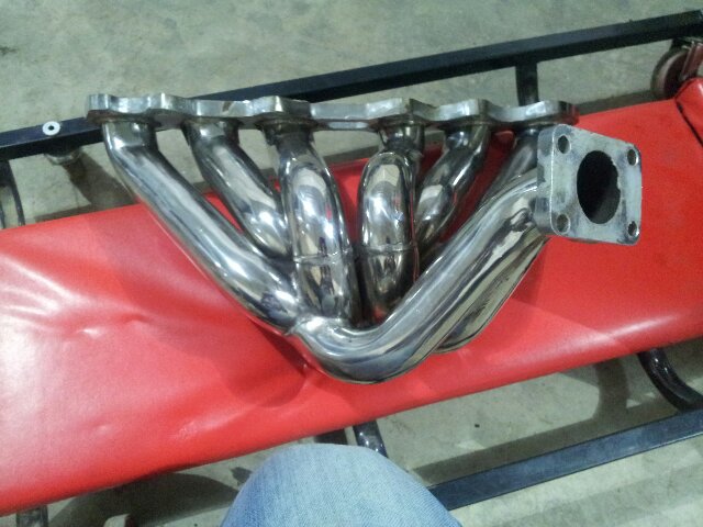

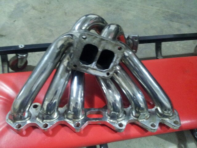

I picked up the turbo exhaust manifold and HG yesterday. The manifold turned out to be a Godspeed
It will do the job just fine hopefully.

Quick question about the header. Doesn't having the waste gate tubes merge defeat the purpose of the twin scroll?

I think its just divided not twin scroll.
from my experience your going to have a tight fit with a tubular mani like that but if you can make it fit put some reinforcing tabs from the head to the turbo otherwise the godspeed mani will crack, i went with a cast turbo mani from godspeed for clearance reasons
and look at the reinforcement rod on this mani http://rdfabs.com/pageimages/TurboManifold_NeonSTR4.JPG
it will give you an idea of what im talking about
also get your front main seal studded to the housing and weld on larger breather bungs onto the valve covers with a oil catch can because the 2jz is known for hi crank case pressure and it WILL blow out your front main in no time sorry for all the post im just trying to save you some hassle
Also run the oil feed for your turbo from the top of the oil tree, sandwich off of the long *** bolt that bolts the oil tree on and run a -4an line to your turbo, yes im aware the turbo and the oil tree are on opposite sides but that has the best oil pressure to prevent starving your turbo from oil, the stock oil outlets are kind of a mid pressure so lots of times they end up starving it for oil and you loose your turbo so just block off the stock ones
ohhh and run a -10an for the dump from the turbo back to the pan\
lemme know if you have any questions
