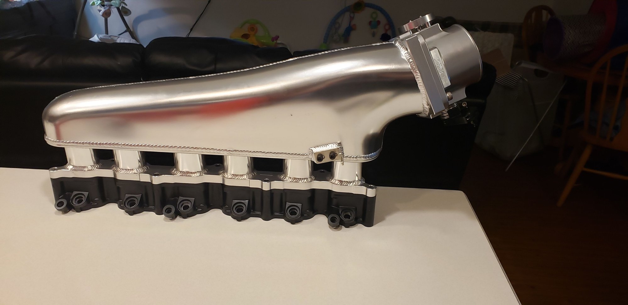

Here's some pictures of the car / parts
6 boost manifold
Collins swap kit minus shifter(was shipped separately)
