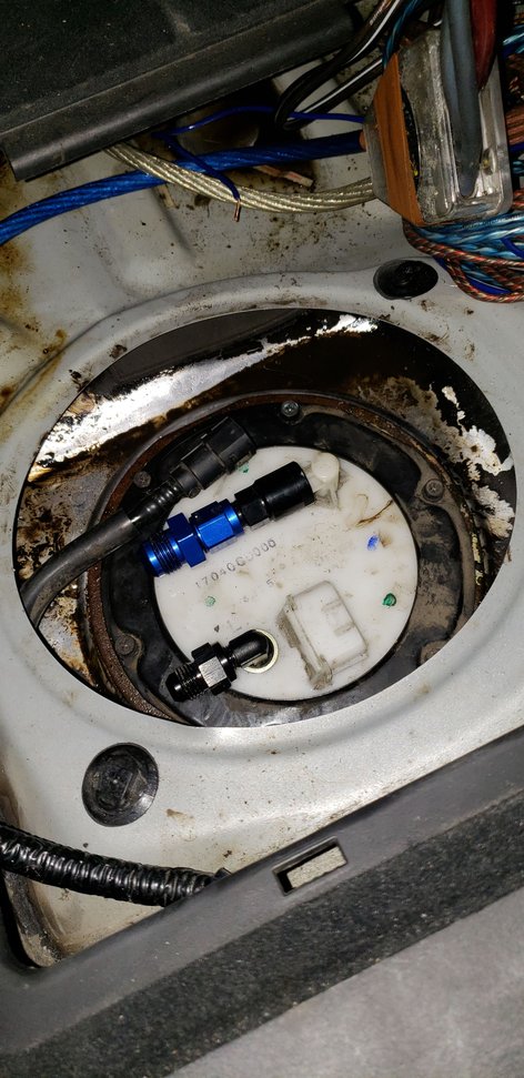

Almost finished the fuel pump/ sending unit. I was lucky enough to find a used one locally for a good price as one of my spring holders is broken. Just gotta tighten the bottom hose clamp, solder and heat shrink the wires and add a hose clamp to hold the pump in place.
The pump is a walbro 450 if anyone was wondering.
Hoping to get the fuel lines ran to the engine bay this weekend and hoping to install the motor Tuesday or Wednesday.

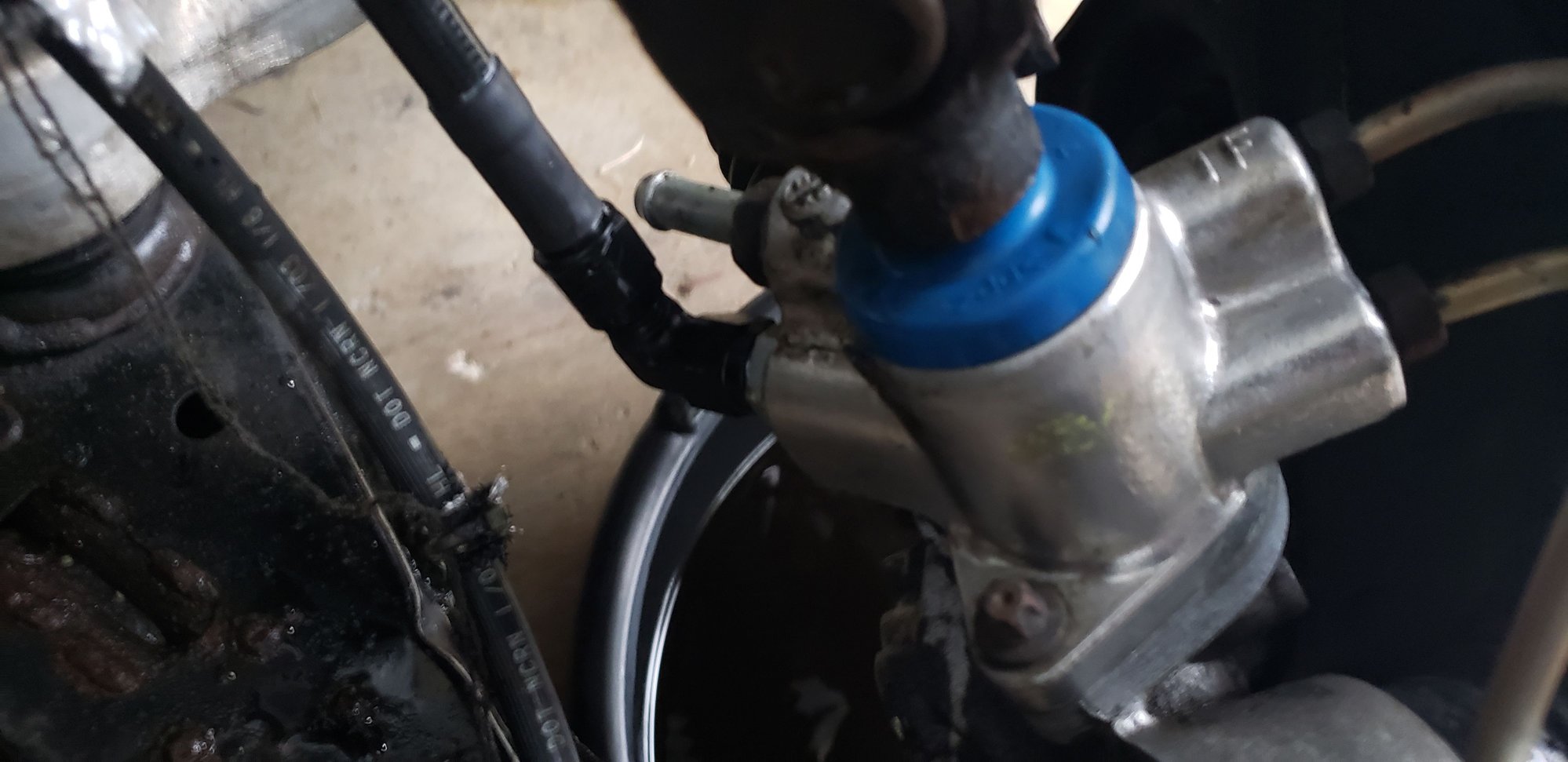

Chase bays power steering line installed

So after lots of swearing I could get the fuel assembly to go into the tank. I am so high on gas fumes.
I figured out why the last fuel tank hanger was broken, the tank was bent upwards which caused the spring mechanism to snap.
So I pounded the tank out with a 2x4 and a sledge hammer and now its straightened out and fits....but the damn gas fumes had me going crazy haha

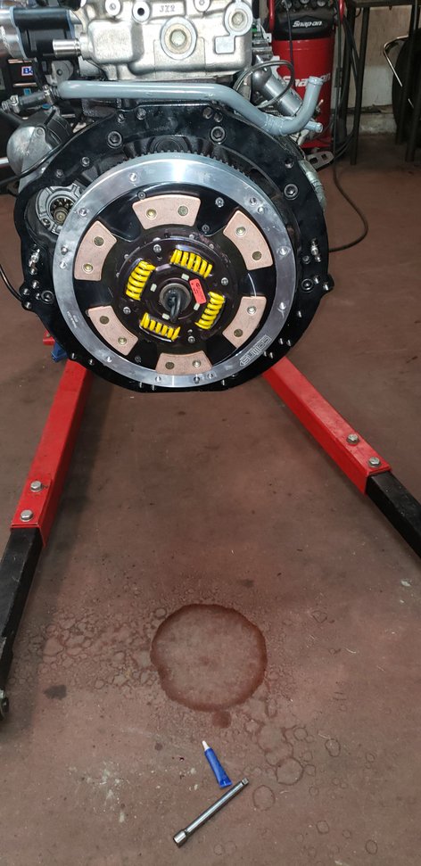

Well I bit of a hick up, I was flustered today and didn't read the torque specs on the clutch pressure plate.....bolt snapped in the flywheel.
Damn I really gotta pay more attention, it's gonna cost me a few $ to get it extracted at the machine shop.
Also I am now wondering about the stock, 350z clutch fork doesn't seem to be locking into place on the pivot ball.
It seems to lift off the ball when i press on the clutch fork, maybe I should order the upgraded one and just wait a few weeks?

Taking a break away from the car for a bit, Need to order the 2006 350z clutch fork and pivot ball.
Currently I have the 2003 fork/pivot ball, which is too weak for the ACT stage 5 clutch.
Flywheel is ready to be picked up at the machine shop.
I am just waiting till payday to order a clutch fork/pivot ball, funds are tight atm, because of the turbo payments.
I gotta slow down I was rushing things too much. It's not like I can drive it, when it's done as it wont be driven in the winter anyways.

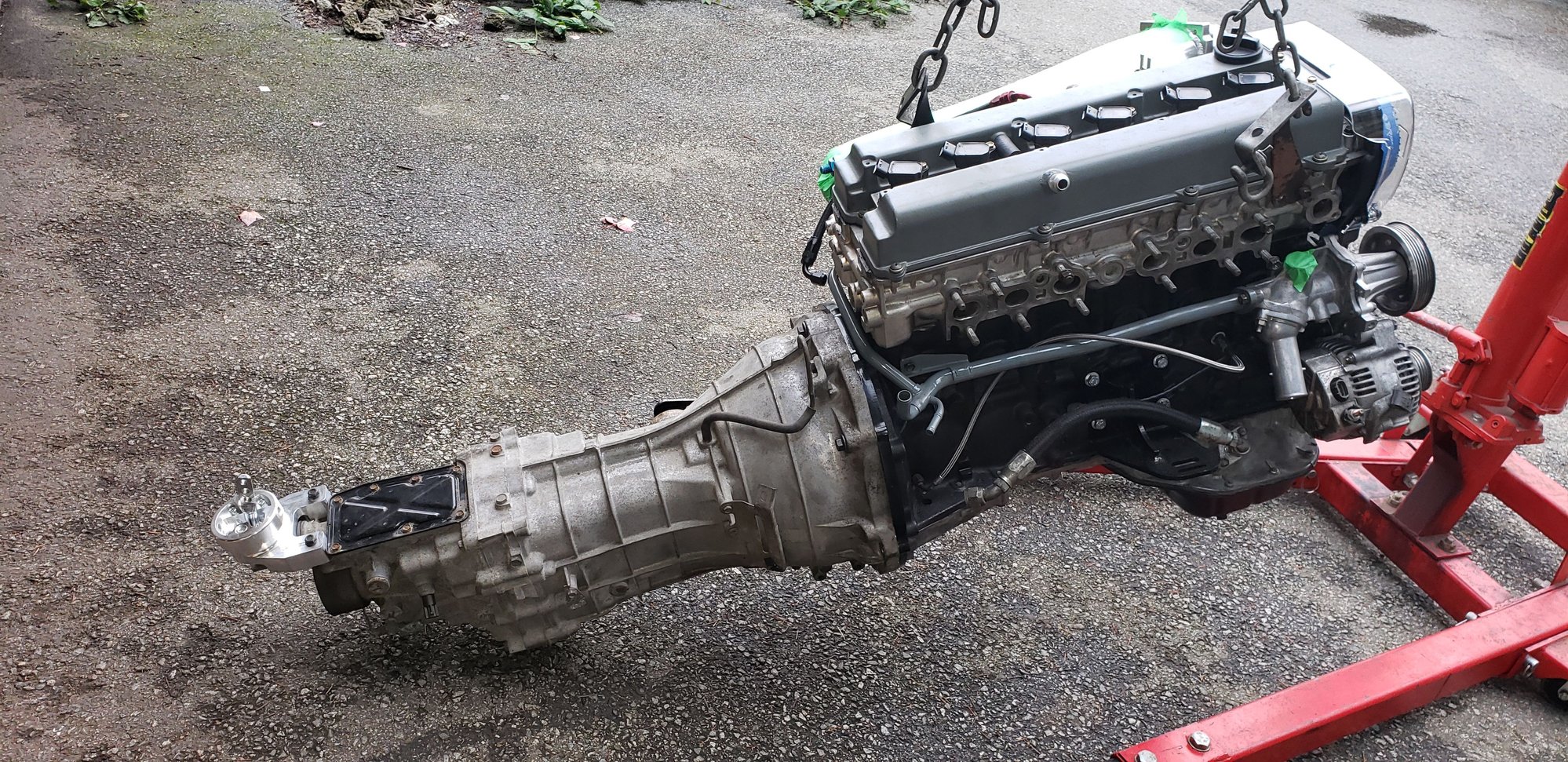

Made some progress today
Picked up the flywheel at the machine shop
Ordered a 2006 clutch fork assembly from Nissan, should be here Tuesday
Starter, clutch/flywheel, intake, cam cover installed.

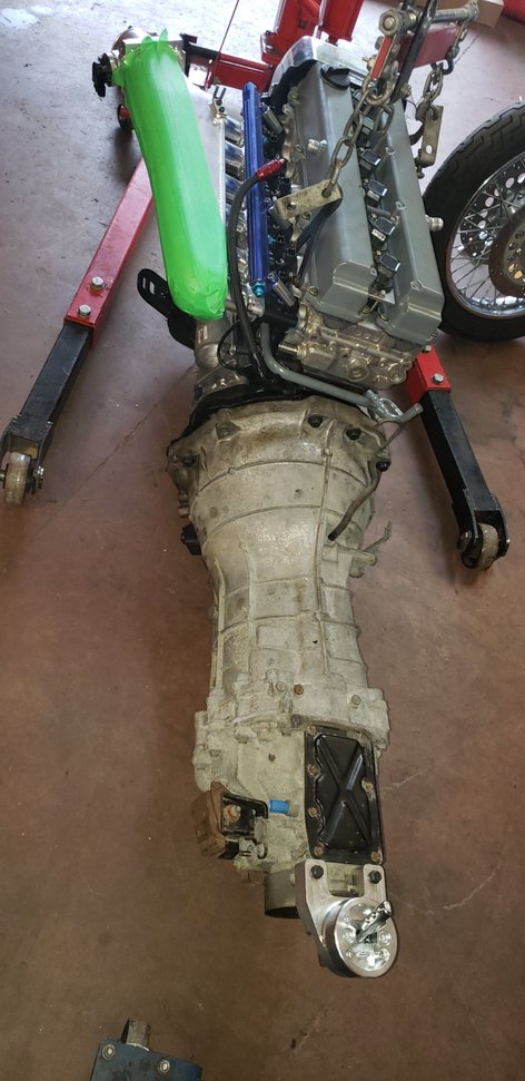

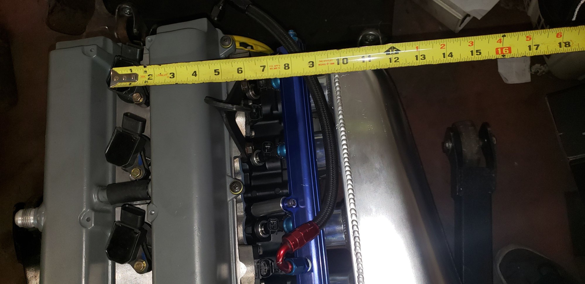

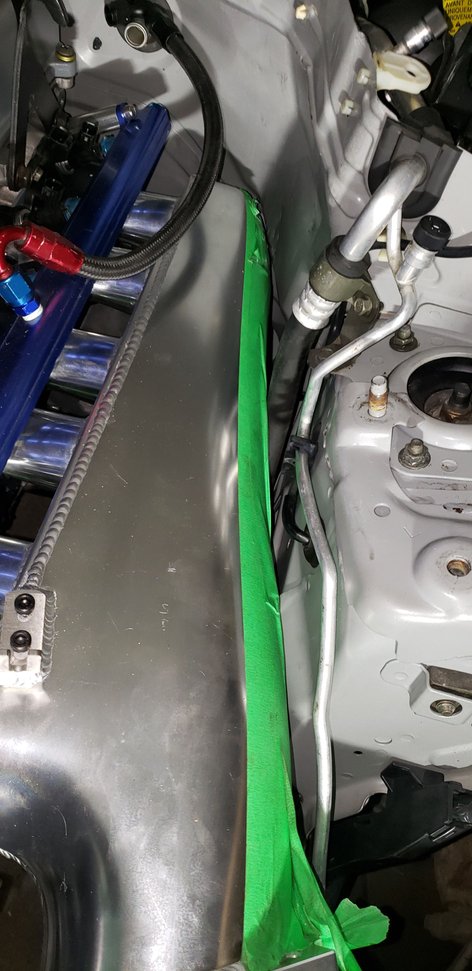

Hoping I have enough clearance for the intake- near the strut tower here are some measurements if anyone can chime in

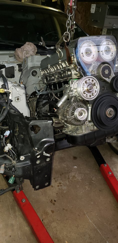

Made some awesome progress today, Engines in!!!

Raggan - please please please put solid mounts in … it will be soooo worth it. I had some fabricated but the Z1 six-shooter will be perfect and will give you more space in that area.
Hey I appreciate the input but I've had solid motor mounts in the past and they are awful for a daily driven car. The dash viberates etc...
