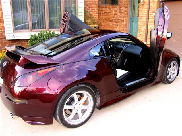

Is this what you mean by "pigeon out"?

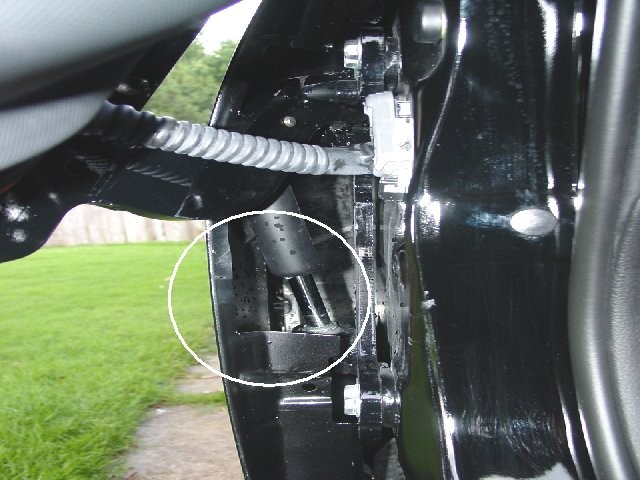

I have had them almost a year now.
Here is a pic of the "cut" area.

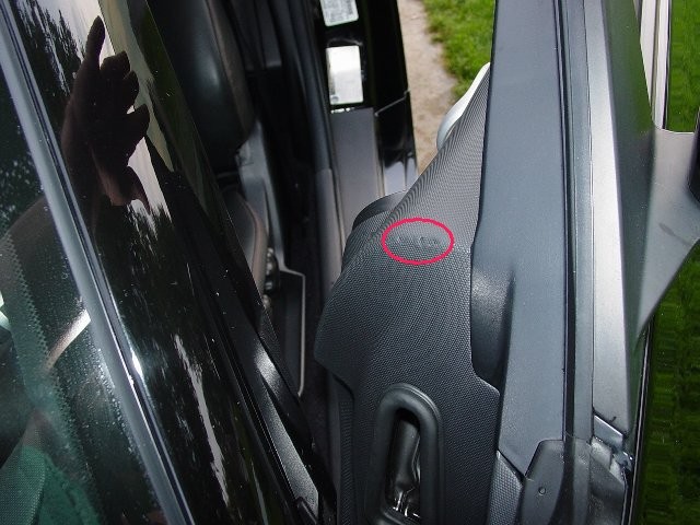

Pics 2 & 3 are of clearance issue points.

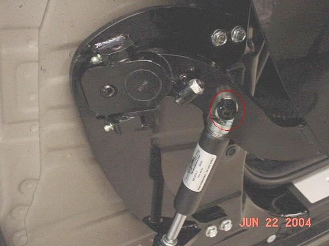

Not only do you have to cut or roll the fender but you have to grind down the shoulder bolt (the one circled on JCN's last pic) so it doesn't ding the inner fender. You also have to use spacers (washers) to get the door to align with the front and rear fenders.
