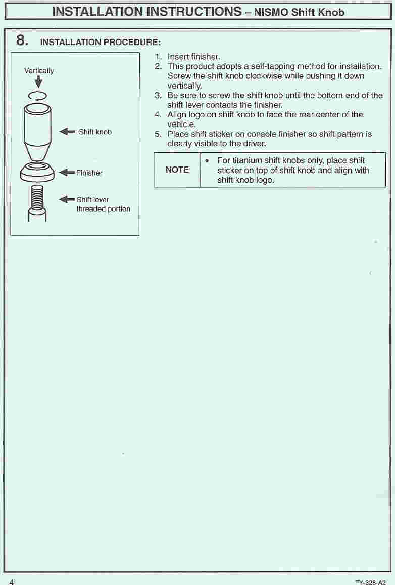

i have a major, annoying problem!! i bought the nismo shift ****....love the look! i finally got the original shift **** off which was a ***** might i add....and now im stuck there........can anyone that has the nismo shift **** tell me how get this dam thing to screw on to the grooves that the original screwed on to???????? or if that is not the way.....does anyone know the right way of putting this damn thing on!!!!!??????? so basically what it looks like right now is a big "screw" sticking out of my boot!!!!!!!!!!!! well if anyone that knows what to do to finish this...plz respond to this thread and let me know asap!!!!!!! thx ..................

ya but the original **** had thread that screwed on to the grooves!! once you take off the og ****....the "screw" is still there but the new nismo **** has no thread inside to screw onto the place where the og **** would be screwed!! so basically its a flat surface inside the nismo ****! i dont think any of you have the nismo **** because nobody really gave an answer but "screw it on"!!! i appreciate the responses but i thought also that the nismo just "screwed on" but it just doesnt!!! well if any1 does have it lemme kno asap ........thx again!!!!!

I doesn't screw on but you put it on as if you were screwing it on. You press down and continually turn the **** untill its on all the way. It goes on overtop of the threads.
I scanned the instructions for you:
Attached Thumbnails trying to install my new nismo shift knob!!!!!!!!!-scan0002.jpg

aww thanks bud.......well i dont get it ....i tried for hours trying to screw the **** on to the shift lever........it wouldnt go on!!!!!!!! so for right now i did what i seen earlier on here.....use a rubber "washer" to make it stick to the lever....works for right now.....but!!!!!!
