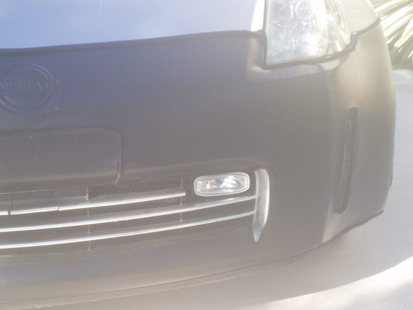

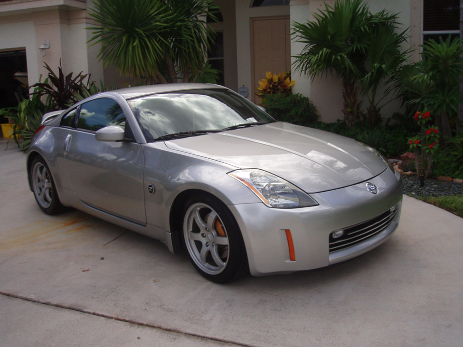

After installing my own fog lights in the OEM grill. I can tell you first hand that the grill is part of the molding of the front bumper. Like Jason said above most people just place the new grill over the OEM. IF you want to remove the oem grill:
Jack up the front of the car (both sides).
Remove the bumper from the car.
With a Dremel, Carefully cut out the grill from the inside.
Sand down any rough edges
Now would be a good time to attach the grill, as you can reach both sides.
Re-attach bumper.

zigggy56 +1 on your fogs in the grill can you post pics from front ? some close-ups would be nice .

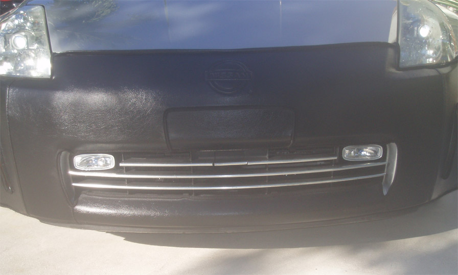

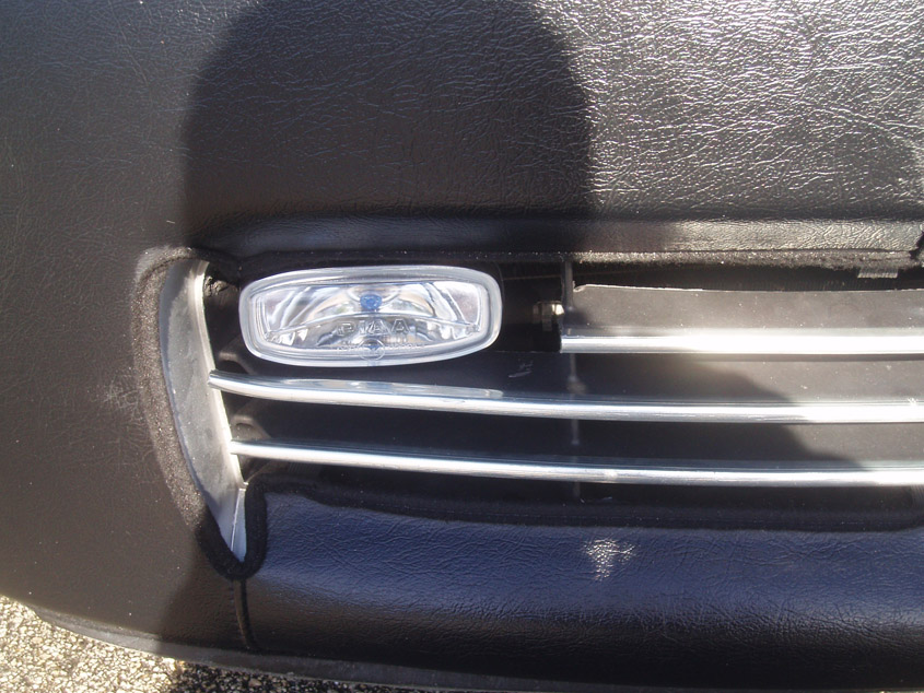

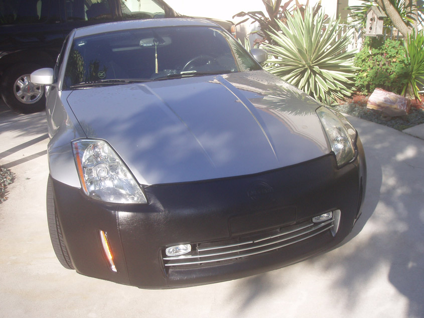

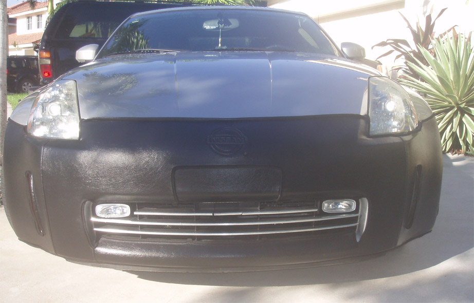

Sorry about the Bra Guys, but I drive Highways all week and didn't think you would want to wait until the weekend to see pictures.
Attached Thumbnails Removal of oem lower grill...............help??-fogs1.jpg   Removal of oem lower grill...............help??-fogs2.jpg   Removal of oem lower grill...............help??-fogs3.jpg   Removal of oem lower grill...............help??-fogs4.jpg   Removal of oem lower grill...............help??-fogs5.jpg

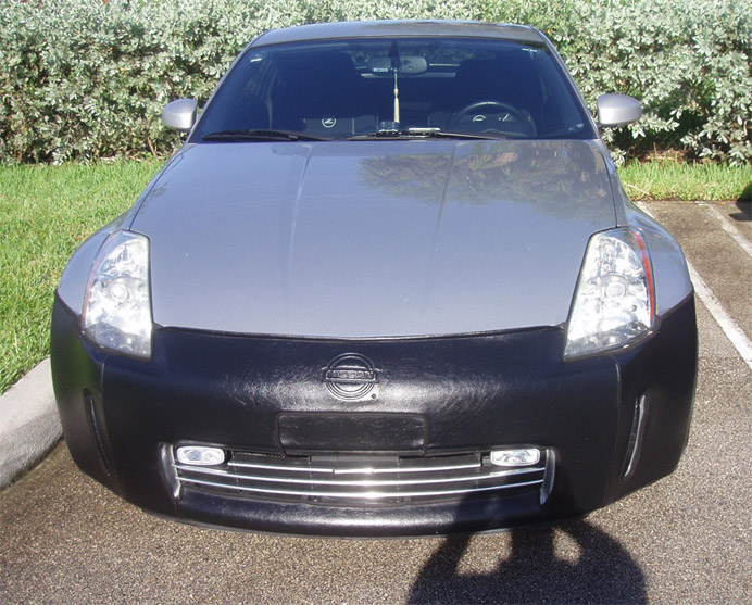

One more for the up-close shot
Attached Thumbnails Removal of oem lower grill...............help??-fogs6.jpg

Very clean install. Looks great. That's exactly what I am planning to do, except I will be using 3.5" - 4" round lights.
Did you have to remove the bumper to do this, or can it be done just as easy from the front, without removing the bumper?

Yes the bumper had to come off. 1st for the wiring, second to cleanly cut out the grill, and lastly I mounted to the metal bumper under the plastic cover which could not have been done with the cover attached.
