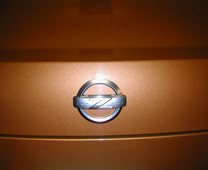

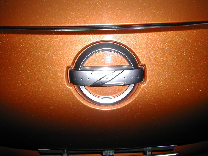

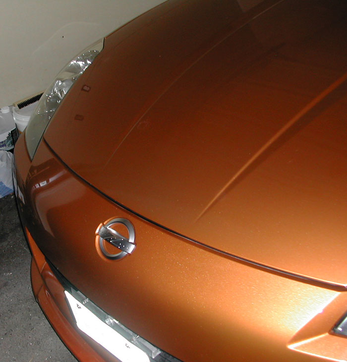

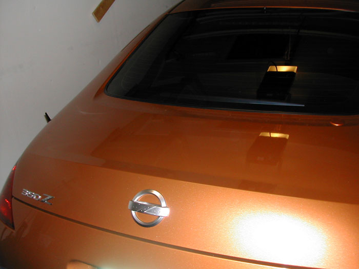

I didn't take any "before" pictures but I think we can guess what it looks like. I've attached "after" pictures though.
I think I might order the "FairladyZ" emblem. There is a small scratch on the passenger side. it's minor but it's bugging me, so I figure I'm going to remove the driver side "350Z" emblem and put the "FairladyZ" emblem over the scratch on the passenger side
I ordered the satin finish emblem to match the 350Z and the door handle finish.
On a side note, I notice with this emblems, they are identical to each other. But I noticed that the OEM ones, the front emblem is just a bit smaller in hieght then these aftermarket emblem. I guess they were too lazy to make two molds or they didn't study the two OEM emblem to notice the slight hieght difference.
