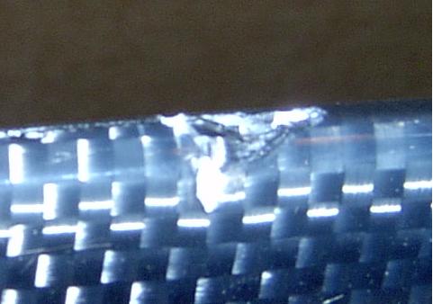

SO got my hood today and it is damaged. YOu can see the dent and chip out of the CF dead center about 1.5-2 inches above where the latch is. My body shop signed for it so I may be getting stuck with the bill----last resort. If I do should I worry about stress fractures from opening and closing if I decide not to paint it. If i decide to paint it should I just leave the intakes CF and paint the rest to match my PPW??? Give me some good suggestions to brighten up my day!

Can you post a pic further away so I can see where it's at? I can't really tell by your description. If it's on the leading edge of the hood, it should be fine structurally; you'll want to use hood pins anyway. If you haven't mounted the hood yet, you may find you have trouble getting it to latch properly, anyway; I've seen some cut the latch loop off entirely and just use the hoodpins to secure the hood (get the locking kind if security is an issue).
As for painting and whatnot, if you want to keep the hood CF and that chip is just on the leading egde, you could just have that chip patched up with resin and then paint a very small black strip accross the front of the hood on the leading edge just thick enough to cover the chip. You'd hardly notice it, the damage would be covered and you'd still have a full CF hood showing.
I'd still try to talk to the seller and/or shipping company to see if you can get the issue resolved that way, though.

I am talking with the shipper and shipping co. Shipping co I am dissapointed in but the seller is a good guy and trying to help me out. The chip is right on where it bends under. I can't post a pick because it is too large but I could email you. Where and what kind of resin would I patch it with?

You'd just patch it with a little fiberglass resin, then sand it smooth. After that, you can mask off a thin strip accross the very leading edge of the hood and spray it black with a can of spray paint. DIY will be much cheaper than having a shop do it for you.

Thanks for the advice, I may just do this, drive it for a while and if it gets worse or chips up, paint PPW to match.
